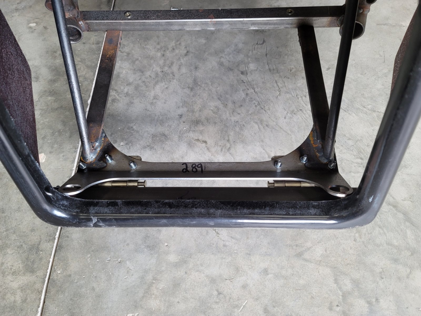

After realizing that the rear fenders rely on the sway bar end link mounting point, I sought to find a way to have my cake and eat it too...
One possible solution is to simply swap out the OEM sway bar links and replace them with a Heim joint that allows of a pass through of a bolt with acceptable length.
wherein the fenders could also reside on the same bolt that would secure the sway bar endlink, if that makes sense.
the above link describes a DIY solution for end links and shows pretty much what i am thinking of.
pic related, sourced from NASIOC forum
The links come in two different lengths, depending upon which swaybar is used. The FE1/FE3 bar has slightly longer links than the FE5 bar. I would measure mine if my Goblin was not in storage 45 miles from my current residence, sorry. But someone else may be able to get this for you. :)

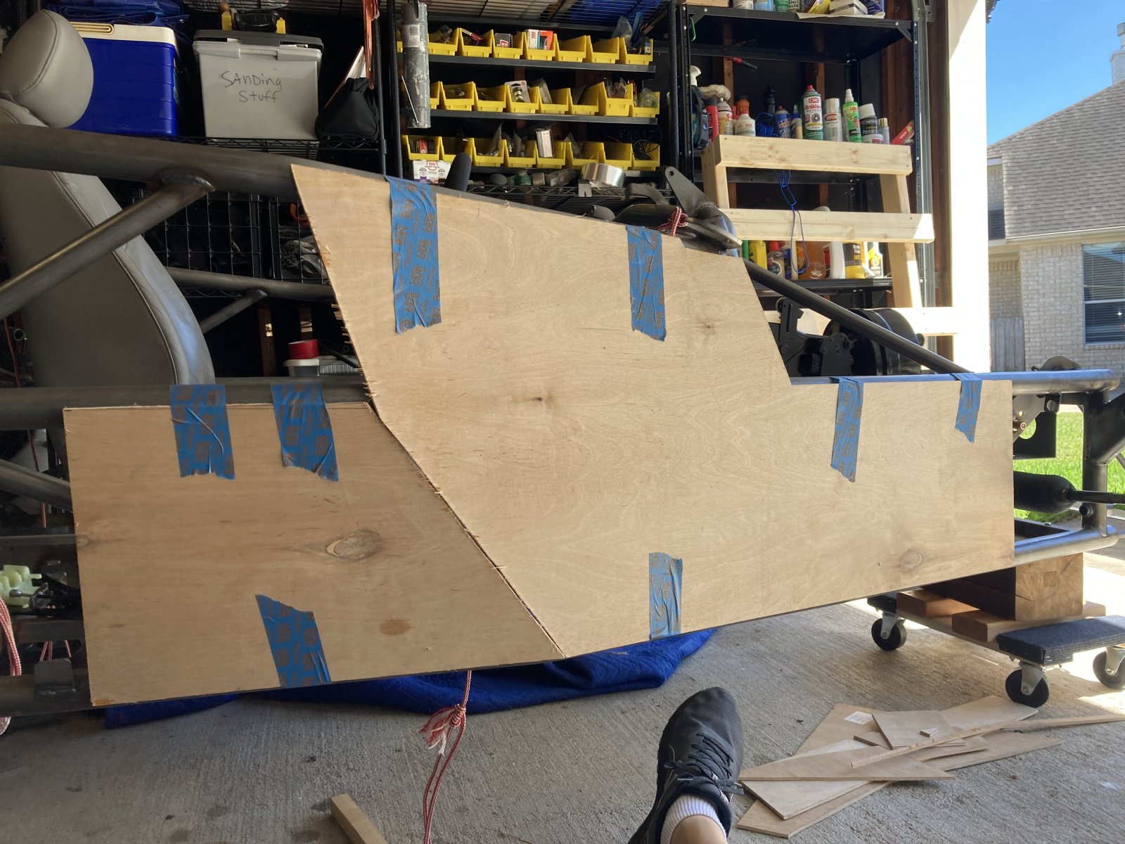

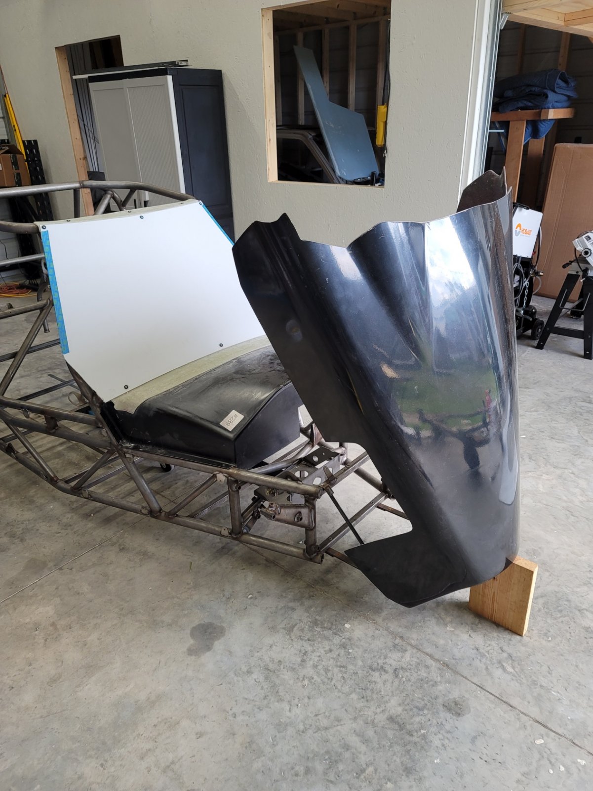

template for the Lexan "full" side panel is ready and seems to cover all the places I want it to...
now just a matter of cutting out the template on the Lexan...

I would caution about making the template for the side panels out of paper. I would follow up with a stiffer material before cutting the lexan. There are some compund bends near the roll hoop that be hard to keep the lexan close to the body without a planned heat bend. I used some 5MM underlayment plywood from Home Depot to mock up my sides. I also used them for my wiring table as I can't transport a 4X8 sheet.
Joe
25331
Joe
Or.......
you could leave the wood and make a retro Woody Goblin.......
:0
Towerdog
Joe
Got to be pretty wealthy to use any wood panel product in this day and age!! I do like the high panel up front.... Thats were all the rocks come from.
SwerveMonkey
Thanks for the heads up Joebob! great cutout work there. I considered this but sadly have no denser material to really sacrifice to the cause... Rosen Paper was idle just asking to be spent, ha ha. fortunately, I have the CAD drawing for the DF side panels and started with that as a template, so I'm ballpark i guess right now.
my overly cautious attitude in this undertaking would have me cut the lexan with about 3-5 inches overage if I can swing that from the huge sheet from "the depot."
I'm aware of the odd bend angles and thought that I can give myself more material to begin with I can always cut away more if I need to... unable to add if I cut too much from the get go:( learned that the hard way trying to cut diamond plate floor sections:eek:... never again...

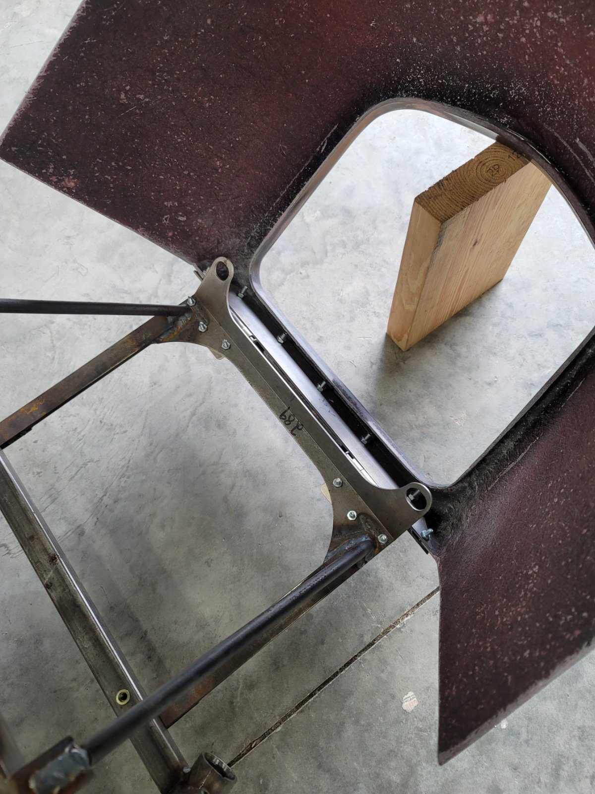

I proceeded to continue work on the forward tilting hood and have come up with a temporary solution that works well but will need further development to make it more suitable as a permanent fix. I've fabricated my own intermediary hood mounting plate that will connect the hinges to the fiberglass nose. I've also sourced a couple cables stays that will hold the nose vertically open; only catch though is that the hood needs to be slightly squeezed to fit past the bulbous round headlights I had chosen. maybe a new bracket is called for... maybe later.
