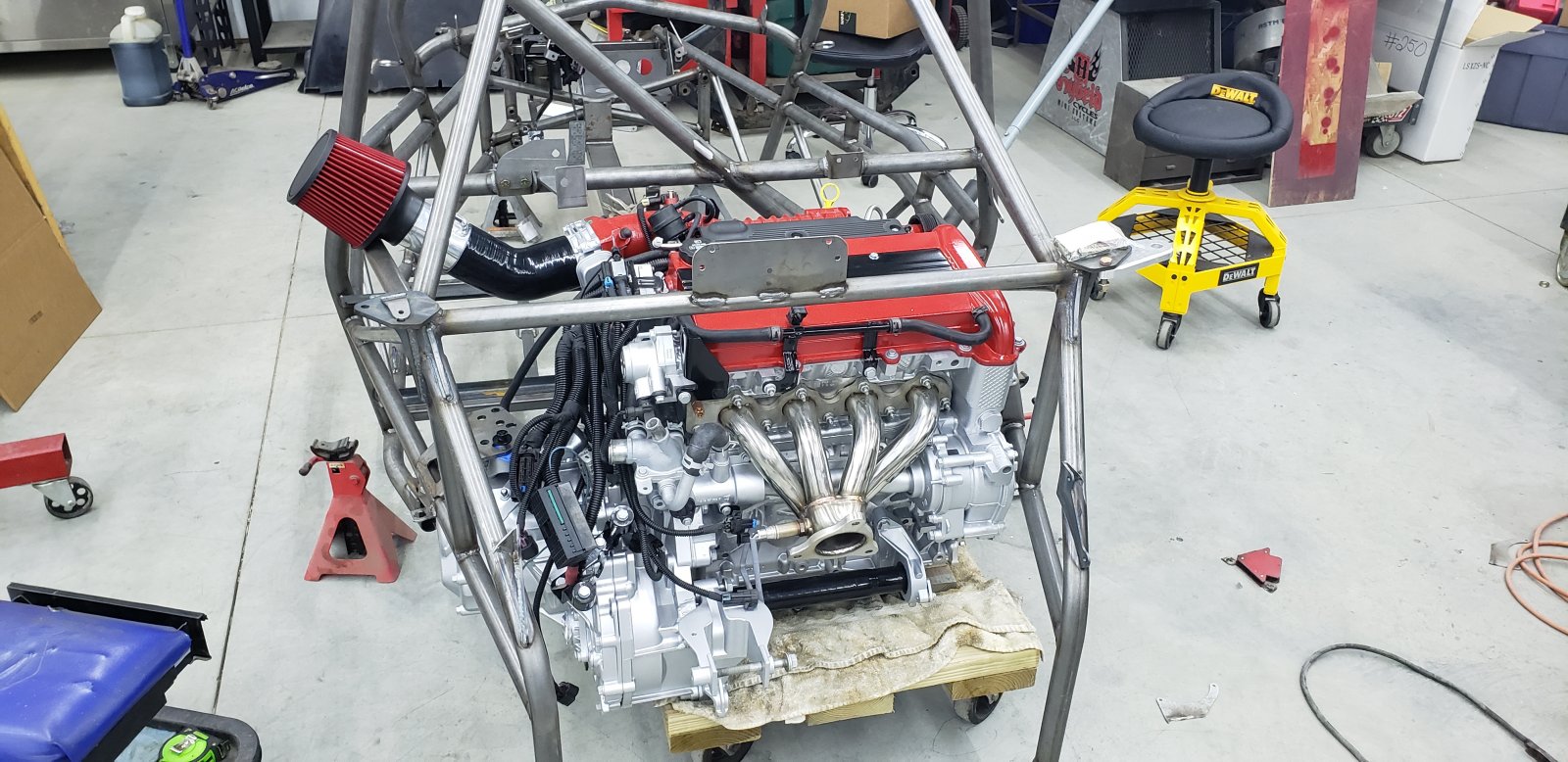

Where are you SC guys positioning your air filter?

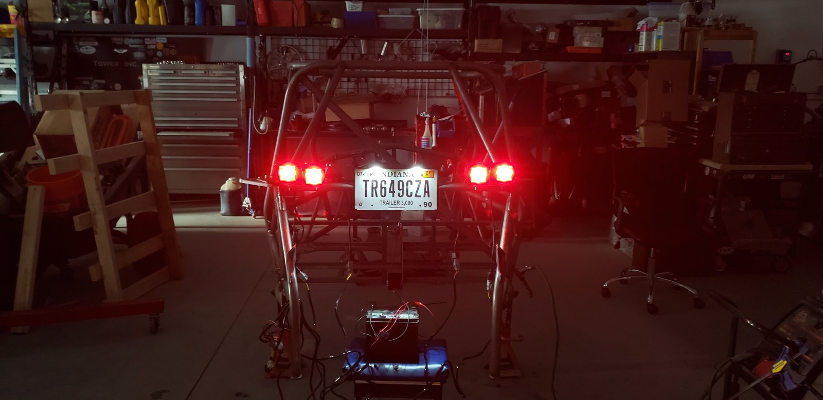

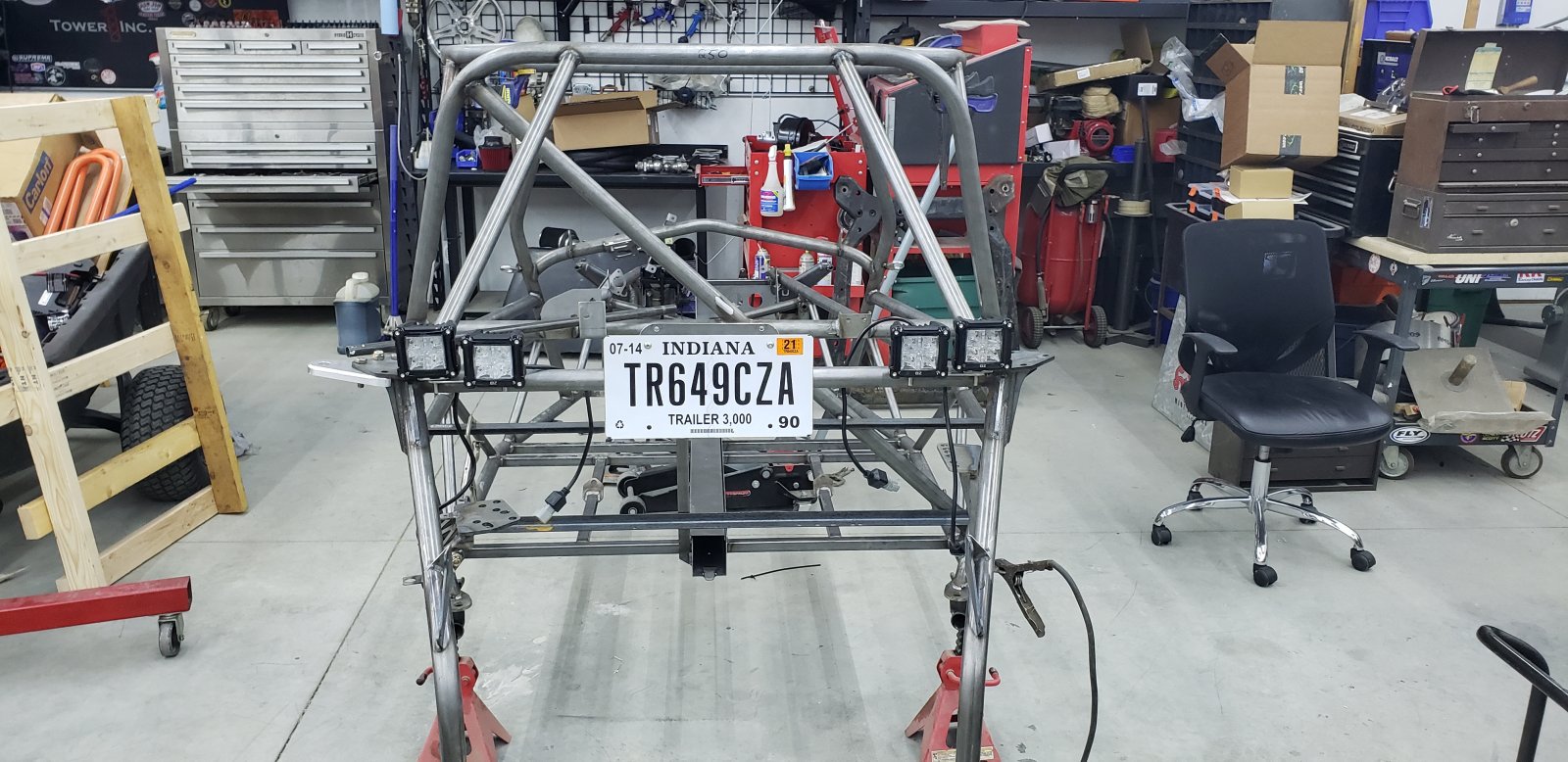

So after hours of moving these around I finally think I have them where they work best. Where I really wanted them would not comply to Indiana laws. Don't love it but...
I would had to mount a flood light somewhere to light it up. Indiana requires the plate to be lit and visible 500 ft away.
Plus I am going to eventually build a custom exhaust for it.
Wow, those Indiana State Troopers have some really good eye sight to require a plate to be visible at 175 yards away. I have to assume this open to interpretation and ambient lighting conditions. :rolleyes::(

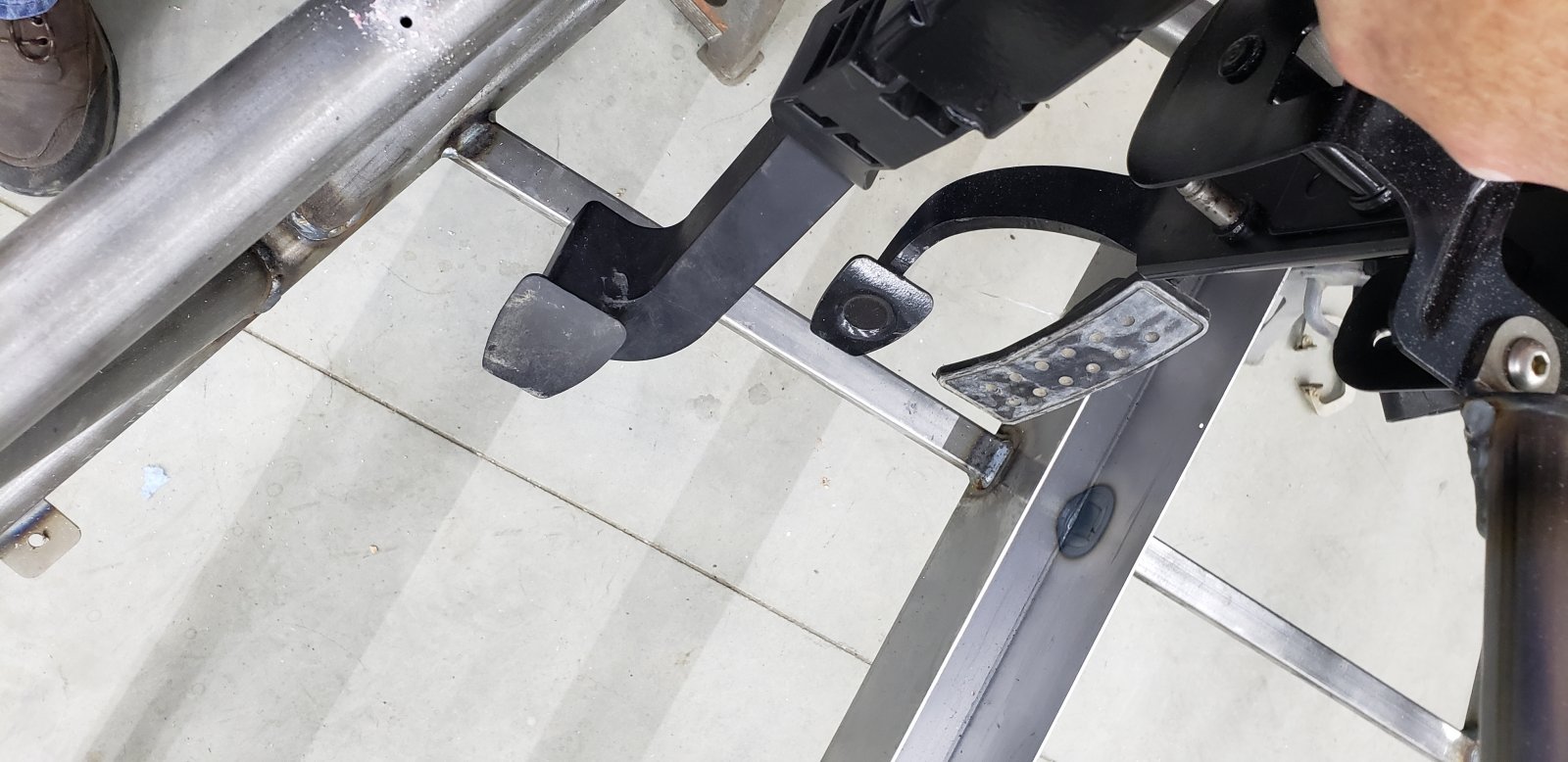

Is it normal for the clutch pedal to stick out so far?
Actually yes, but your brake pedal looks to be too far toward the front. Did you install the aluminum spacer between the brake booster and the forward face of the pedal box? If not, the master cylinder could be slightly depressed and may cause the brake bleeding and brake calipers not releasing syndrome that has been discussed several times on the forum in the past couple months.
The pedal box is the only thing attached and im holding the brake pedal where it will be when it is all the way out/against the switches.
Not sure what year the brake switch got changed from the old to new type, but there is discussion on the forum about the need to adjust/bend the mount to better position the brake pedal and avoid the partial depression syndrome. :)

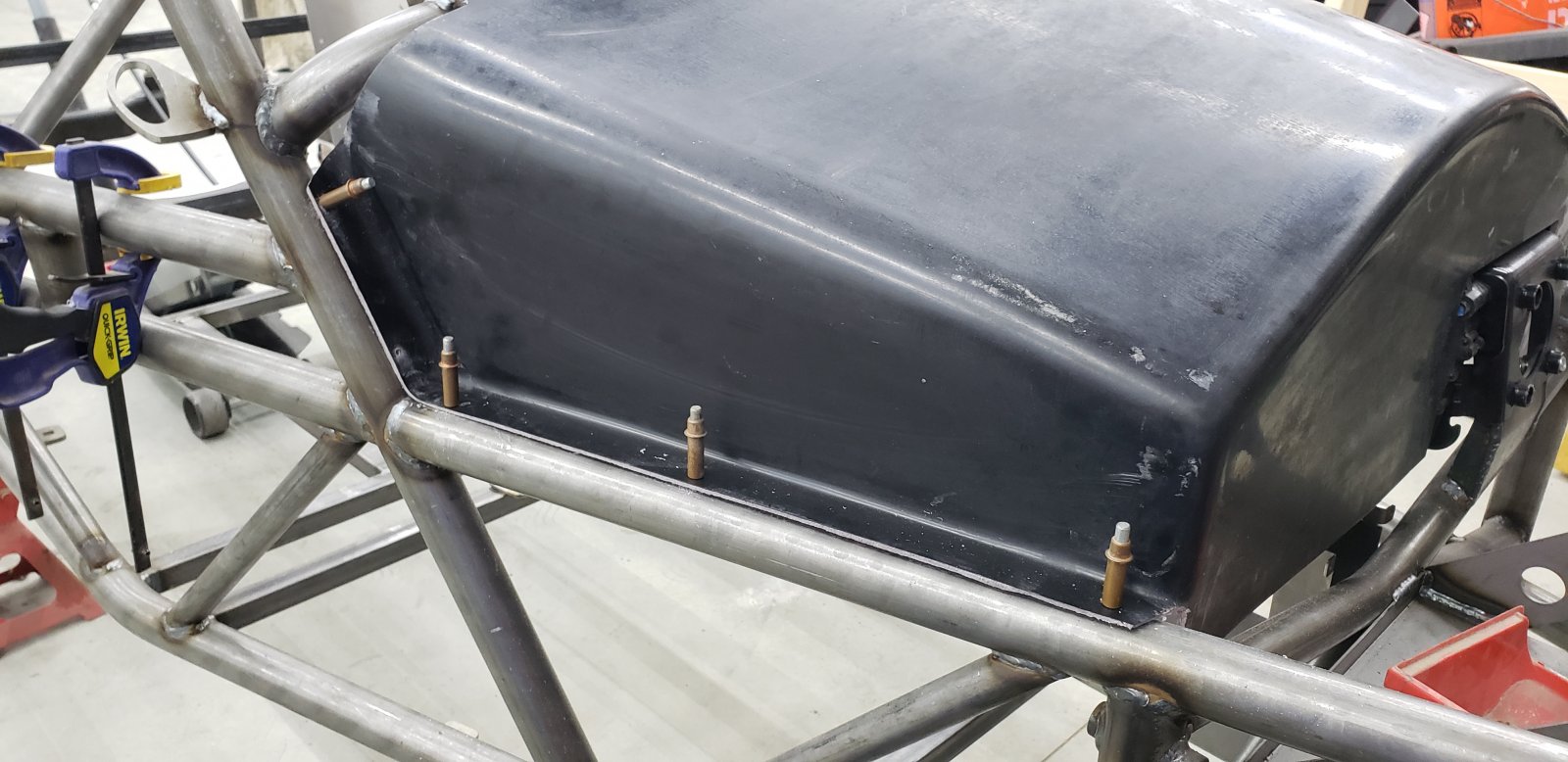

This has been the hardest thing to do so far! It has curled in making it about 2" too narrow in the back..... a lot of clamps were involved.
