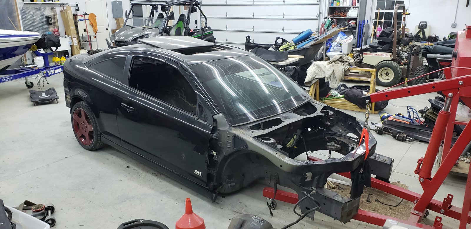

So the weather here has made a turn for the worst, High winds and rain are putting a stop to the new building project so I started back in on the teardown of the donor last night and this morning..... And of course I have questions!! I dont like the way the wheel bearings feel and I would not mind leaving the rear hubs on to make it easier to get out of the shop.
That being said can I order new front/rear hubs w/o ABS (mine has 4 Wheel ABS)
Can the rotors be reused? I have ZZP drilled and slotted 11.5 front and 10.5 rears?
Are the stock steering ball joint ends reused?

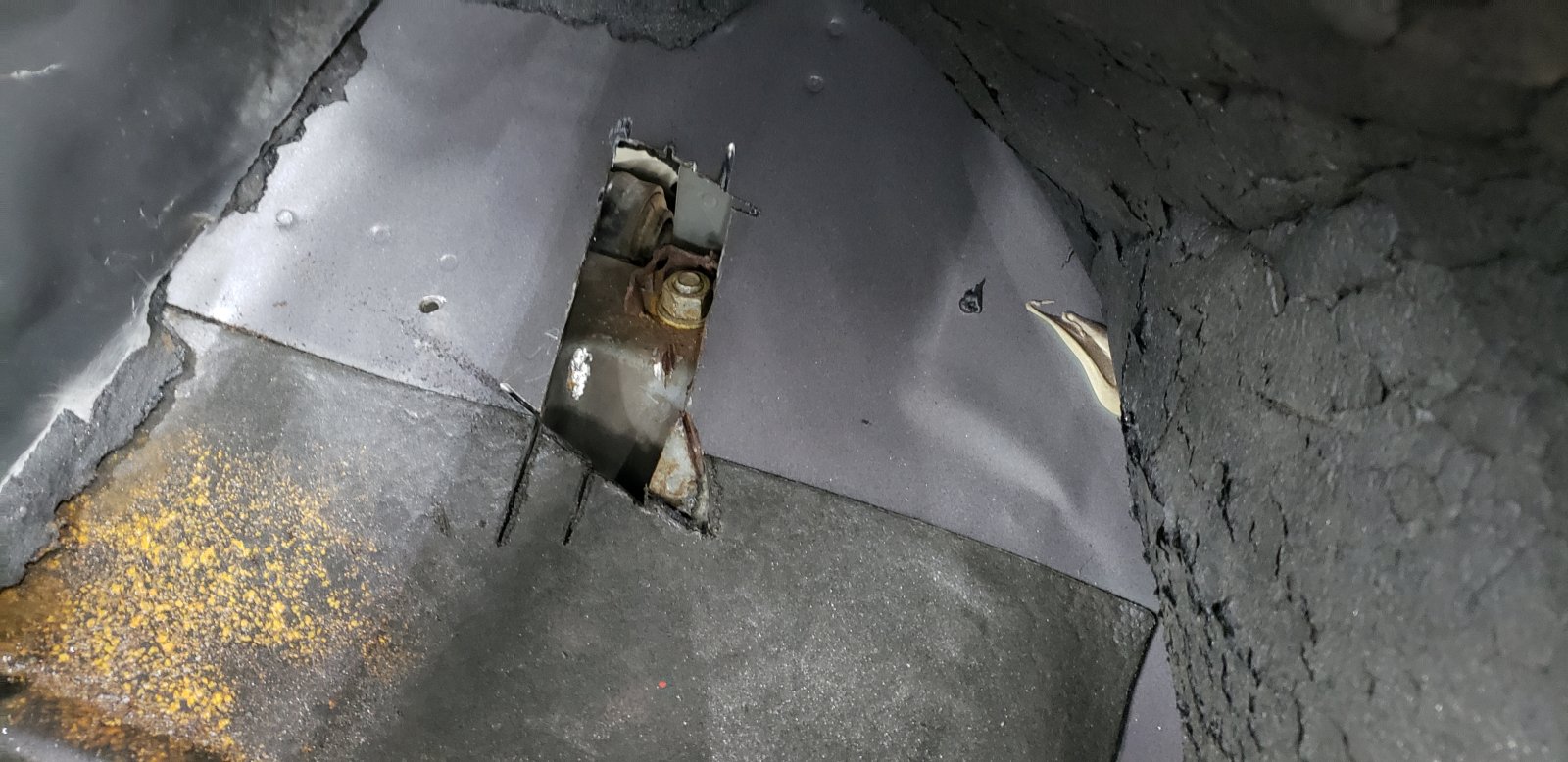

So I was about to quit and go on a man hunt for the mechanic that worked on this car! Torque specs people! The lug nuts where so tight I had to put a 4' cheater bar on them and put all 255lbs of me into them to break them loose. Then I get to the passenger side control arm (replaced recently) cheater bar on all those..... Then the rear subframe bolt was spinning! Well somewhere on here a saw that guys had cut holes in the floor and at that moment it made sense as to why! Well low and behold I lift the insulated mat and found this! Not so mad at that guy anymore!!

DF suppliesthe rotors.
Yes. Most replace the entire lower control arm, though, because the control arm bushings are fried along with the ball joint.
your outer tie rods will go in the back of the goblin and df supplied outer rods will go on the steering rack. Just an FYI

Thank you.
I was planing on replacing the control arms anyway as mine are steel and one is new so they don't match.

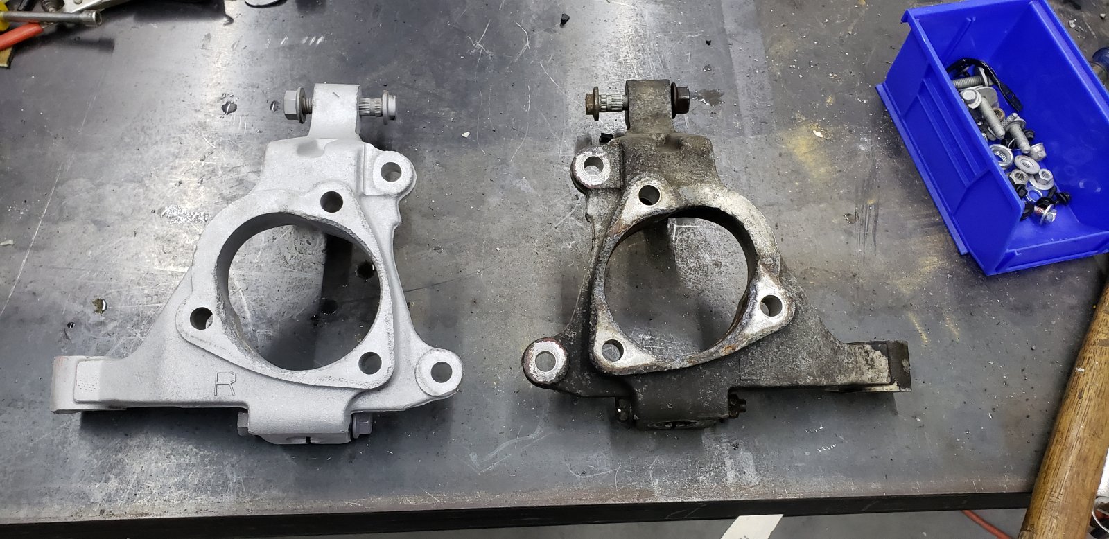

Started cleaning parts last night. Found that the Brake reservoir aux fitting for the clutch was cracked $$$ new master and reservoir.
Trying to decide if I just go with my old faithful Dupli-Color brake caliper paint or get a powder coat setup. Anyone else do there own powder coating of small parts?
I powder coated my front uprights, steering arms, upper rear suspension mounts, and some other bits in my garage using the Eastwood dual voltage kit and a toaster oven from Goodwill.
That is the system I was looking at and just getting a used elec oven. Just not sure if I would be saving any over having a shop do them..... Although I have always wanted to have the ability just not sure I want an oven in my shop.

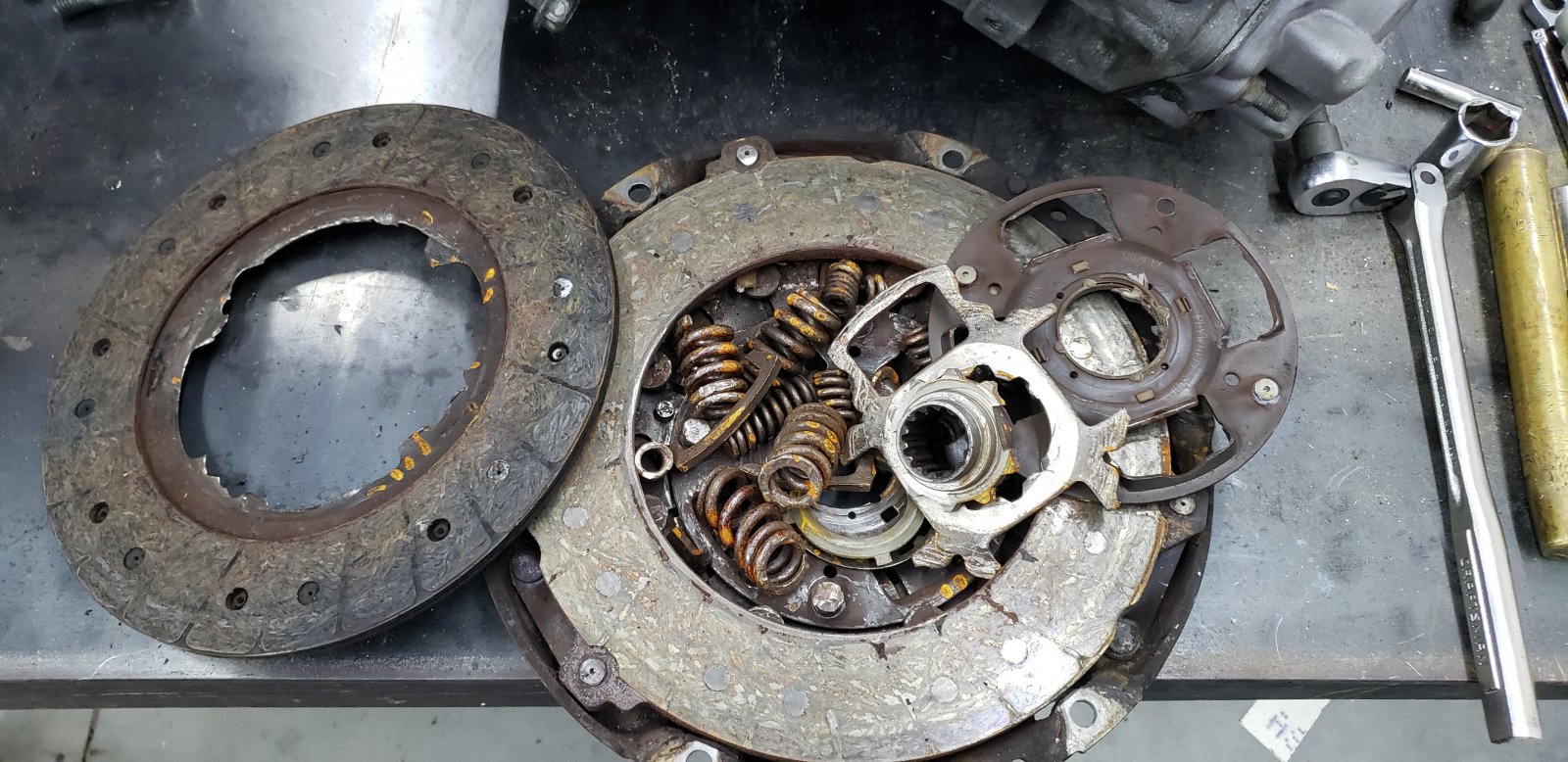

I'd be willing to bet that made a really nasty sound when it let go. From the imprint on the pressure plate that disk probably got pretty hot before it seized. I'd be worried about what other driveline parts got stressed because of this catastrophic failure. :oops:
Tranny runs (by hand) through all the gears smooth but I caint find reverse.
