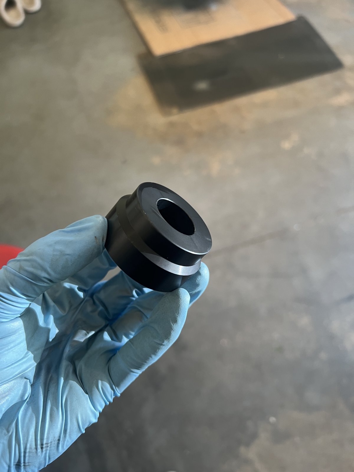

Are these the rack limiters?
They were packaged with the rear clovers but don’t have a label on the bag and aren’t shown in the pictures for the rear coil over install.

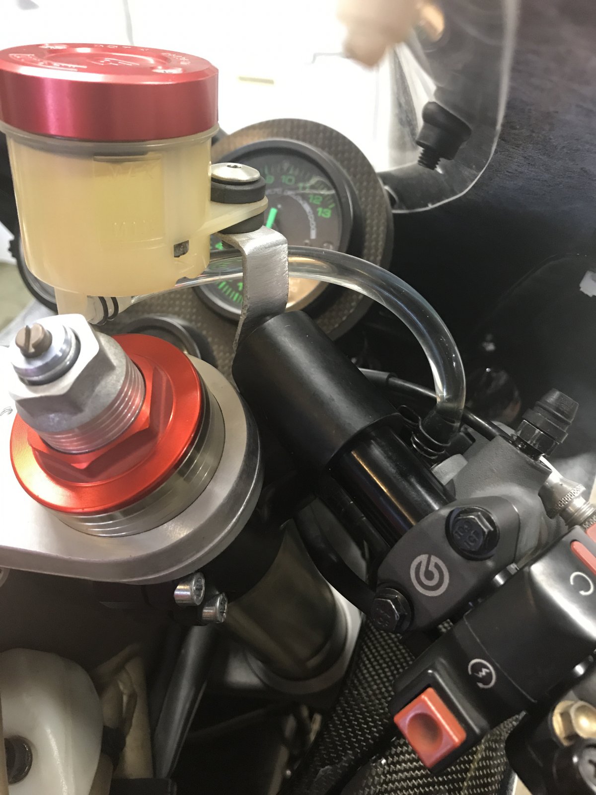

Is CPE hose compatible with brake fluid? Im finding mixed answers online.
I don’t have enough nylon tubing for the clutch master cylinder. I do have some leftover fuel line that will get me there.
When in doubt with brake fluid, don't. Even without the safety issue since it's not brake related, it makes too much of a mess if it does leak.
A lot of times when fluid compatibility issues for hoses show up, it means that there is a difference in quality of hose and you would want to confirm compatibility with the manufacturer. Which means no bargain basement lines from Amazon.
I agree PTFE is a better choice.
Traé
I know this is motorcycle stuff, but it’s rated for brake fluid and no it’s not a porn site :D
Thank you, do you use their products on your bikes and goblin?
If so, how flexible are the lines?
I have CPE on my fuel lines but after a bit of research, I'm second guessing my choice in fuel line. I may replace it with the Tygon fuel lines from this site when I order brake lines.
yes I use the brake hose on my bikes. They have remote reservoirs (clutch and brake) so it’s easy to cut and splice in as needed. I have used kurvygirl over the years for a lot of my bike stuff.
If you are using fuel line for pressure, make sure it’s rated over 60psi for your system. I used gates part# 4219bf

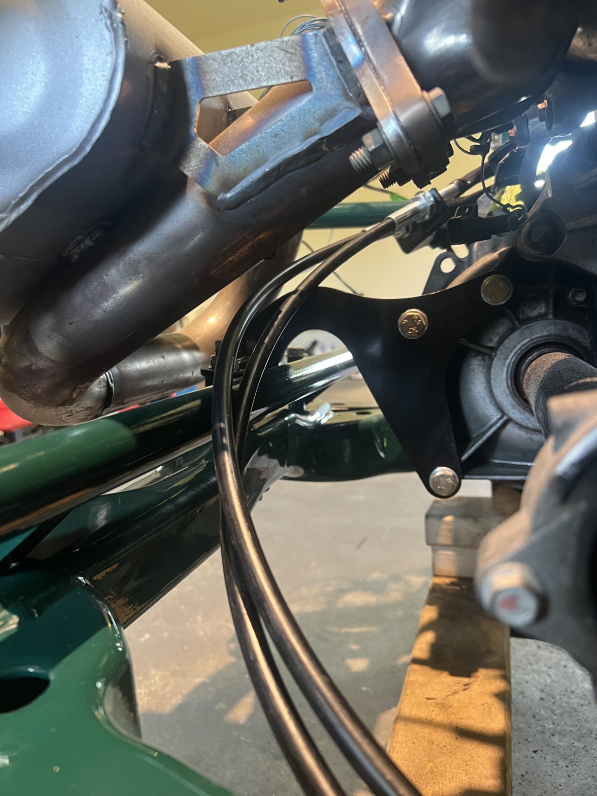

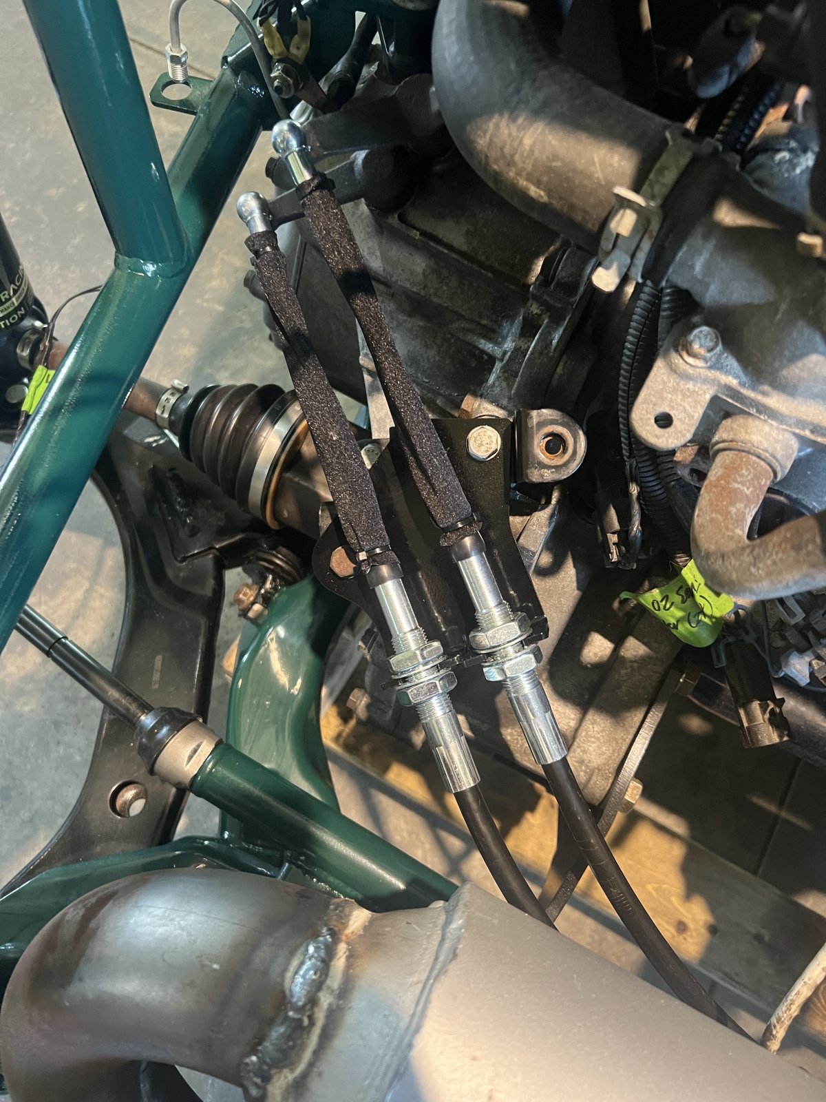

Is having the shifter cables this close to the exhaust going to be an issue?
I may get some kind of heat shield to wrap around them.
47277
47278
I have had a ton of problems with mine. I think my rear defuser is making that area an oven. I have shields everywhere now and took the defuser off.
Traé

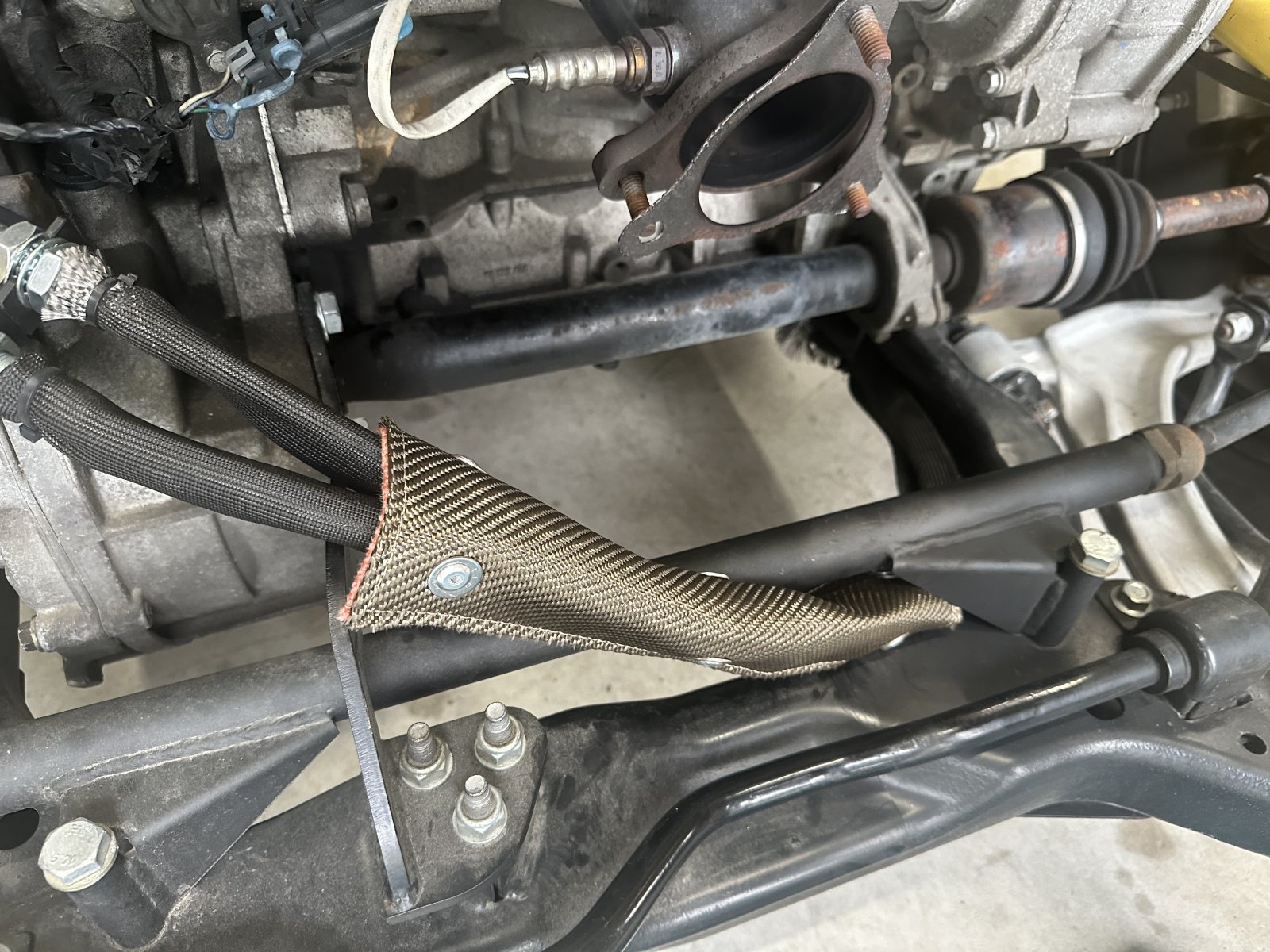

I used these on my shifter cables and haven't had any problems. I don't know if they're needed but saw them on someone's build log when I was building and figured they were good insurance for the price.
Perfect! I’ve seen other build logs and their cables are nowhere close to the exhaust as mine. @Rttoys was one picture I found. I think my cable mount in the rear is a bit different from other F35 mounts I’ve seen

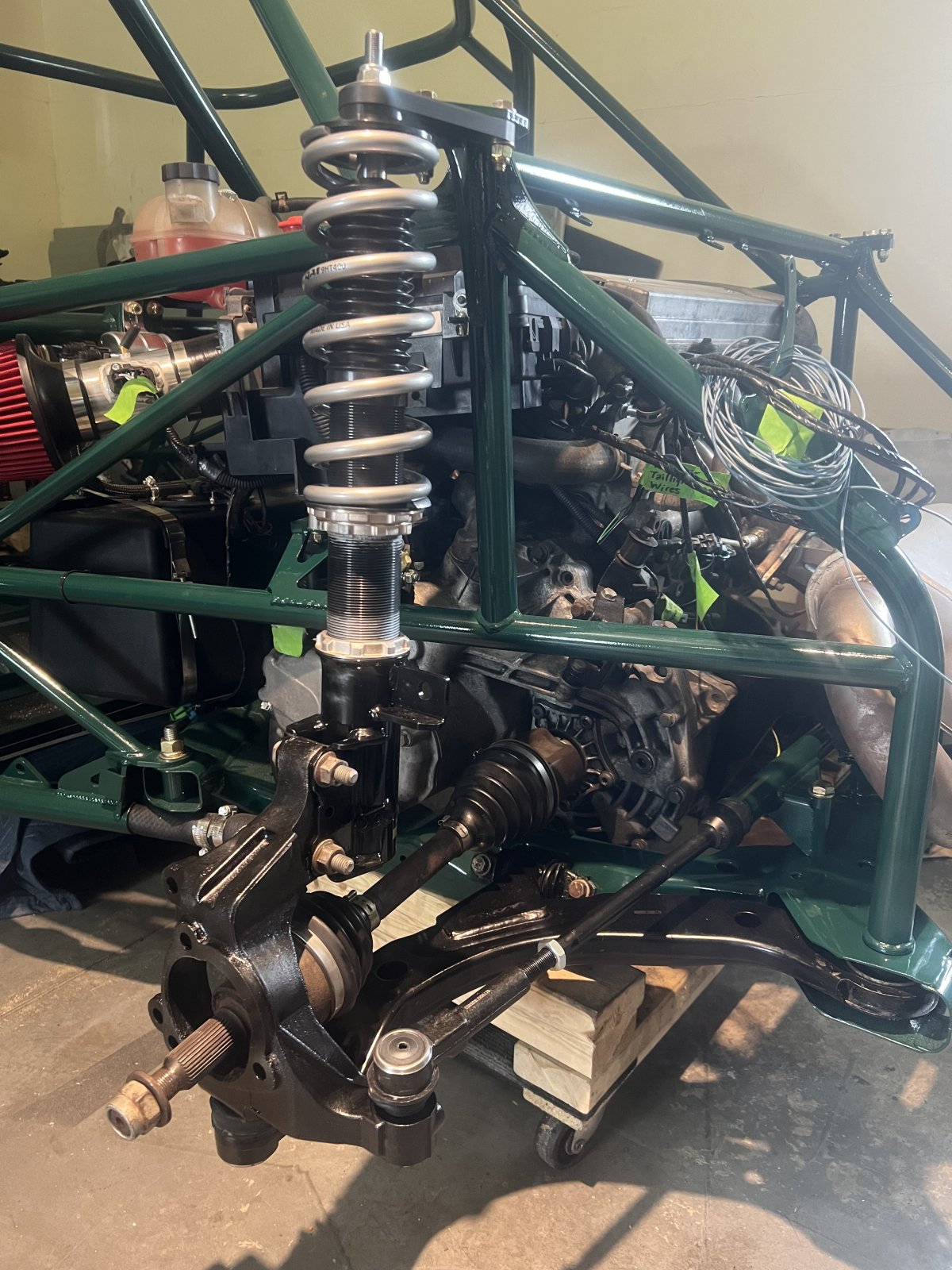

Got a lot done the past few days;

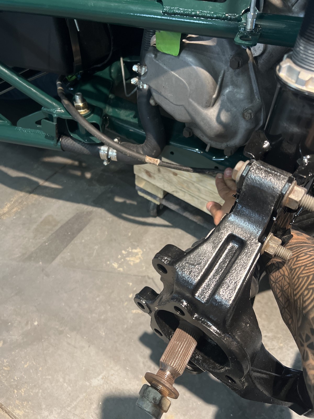

Rear suspension on the drivers side is installed, waiting on a CV boot to get the passenger side put together.
47297

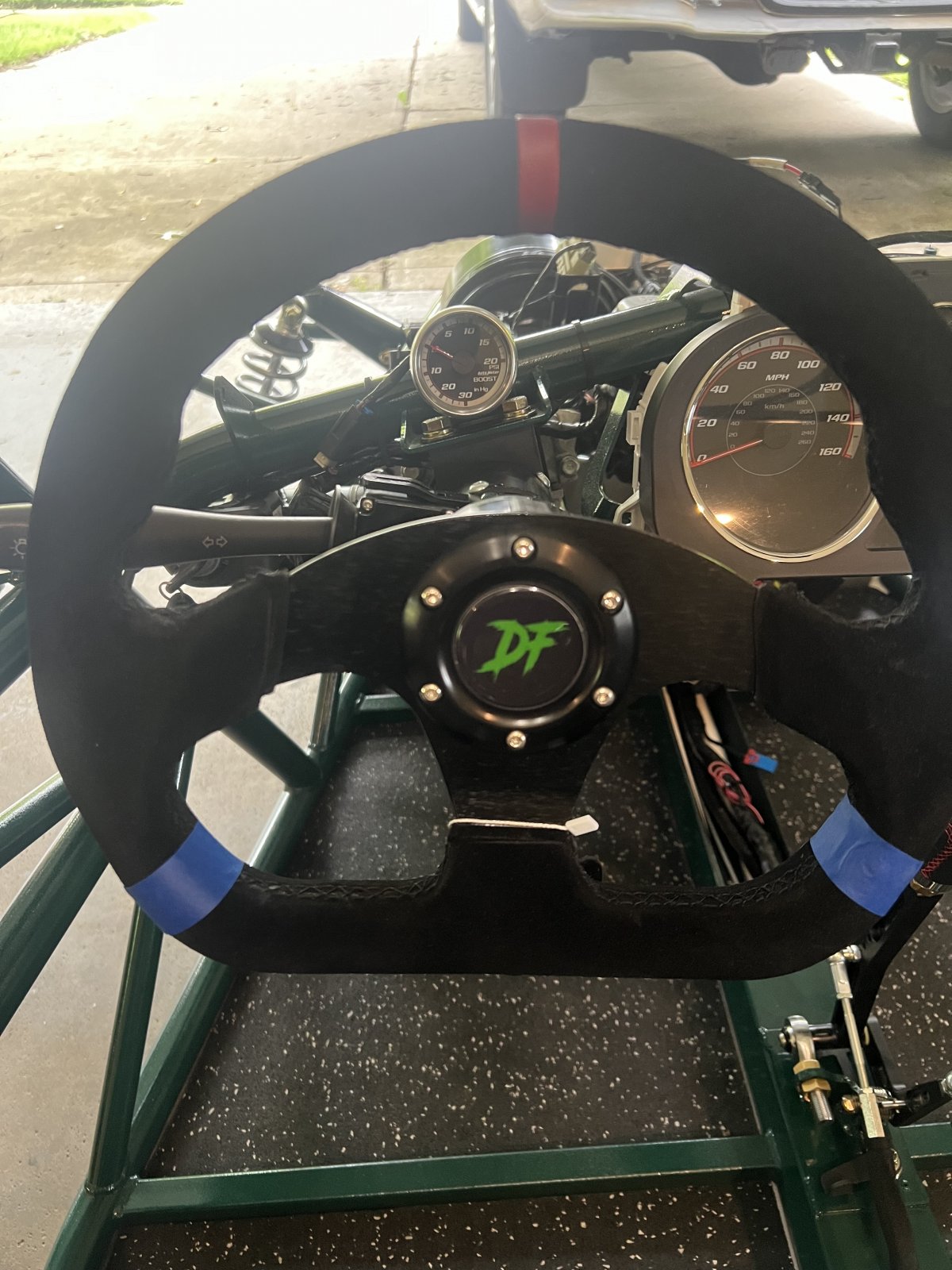

Steering wheel was set straight and boost gauge installed. Mirrors got wired and look great with the smoked lenses.

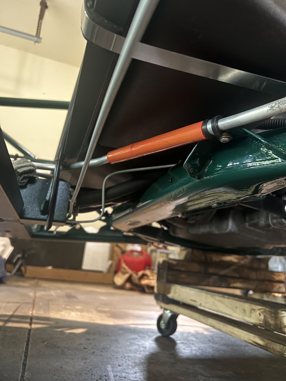

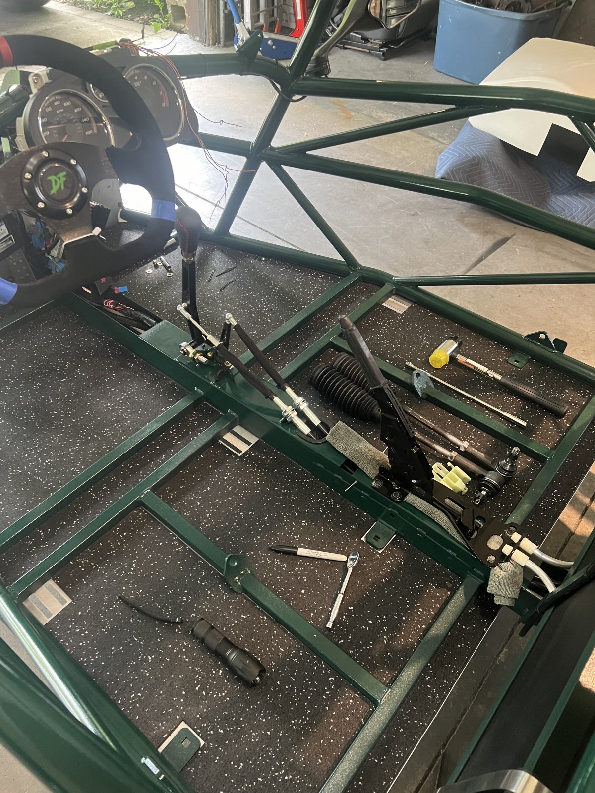

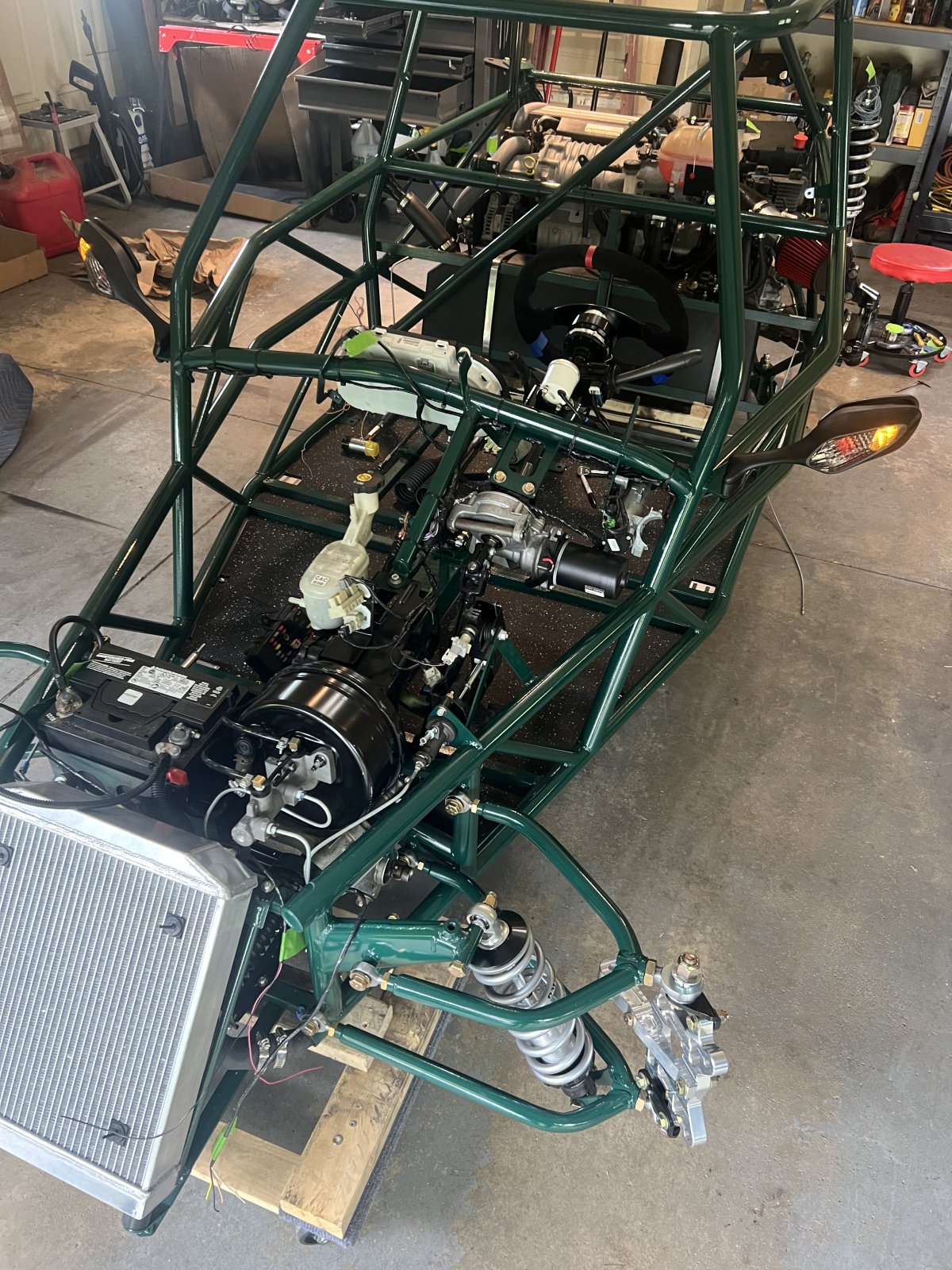

The floor mats are glued down, need to grab some Velcro for the driver and passenger side so they are easily replaceable. Shifter is installed and hooked up, I love the look of the billet shifter. I cannot WAIT to try it out other than moving it back and forth in the garage. Parking brake was temporarily in place to get the tubes and cables installed. I ended up taking the 2nd bend from the lever side almost completely out and attached it to the radiator mounts up front. The cables run just outside of the front subframe bolts and I’ll attach to the subframe where I’m holding it. I wasn’t able to find many photos on the forum of how other ran them but it seems to function so :cool:. It doesn’t look great but will be blocked by the wheels.
47298
47299
47300
