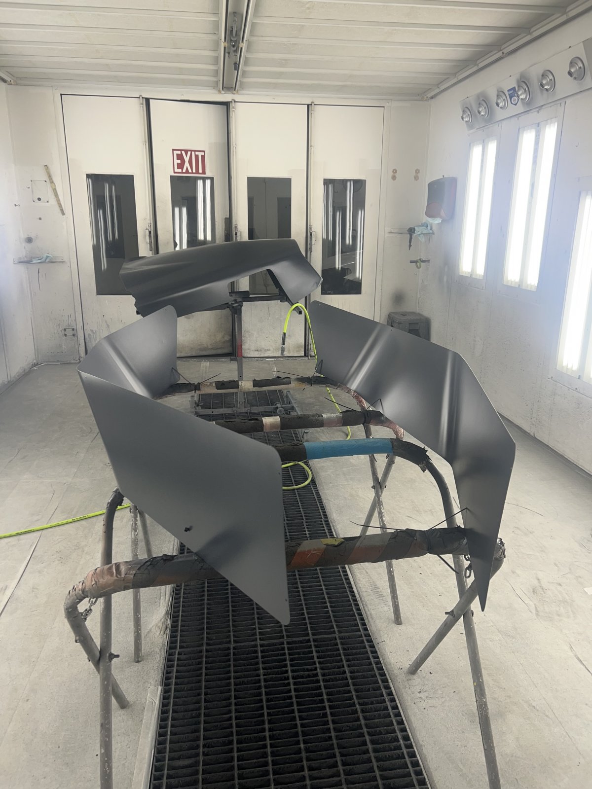

Hood and side panels are painted. This is just a good 4 coats of primer, I actually like the color and will probably run it for a bit until I decide on if I will attempt a wrap myself, plastidip, or get it painted to match the frame. Once the paint sets up in a few days I can work on getting everything installed. Still need to get holes marked and rivnuts installed for the side panels. Should have done this before but…oh well.

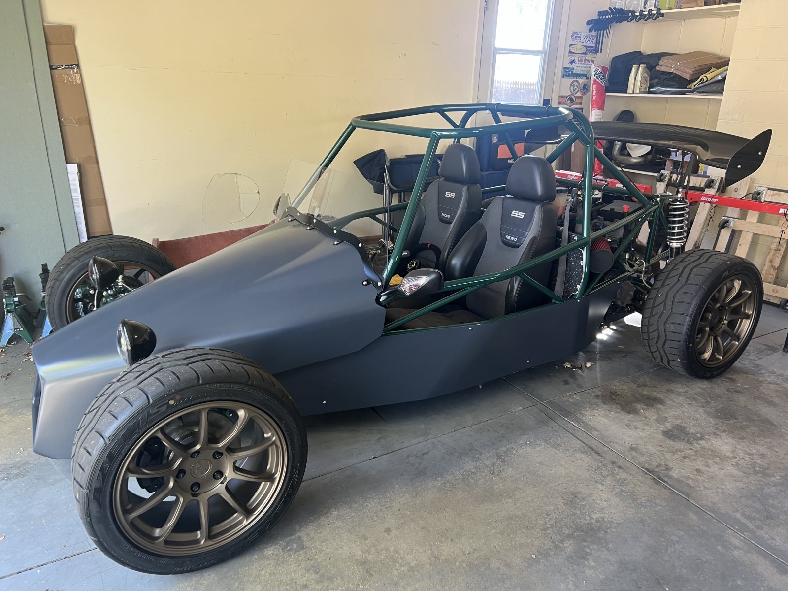

These side panels are whooping my ass, are there any tips or tricks to get them lined up correctly? It seems like it wants to fall as it goes towards the rear and not be centered on the bar the length of the chassis.

I used a combination of my child, clamps and thick painters tape to get my side panels lined up well. I have these decent ones but I'm sure cheaper ones can be had at the Freights of the Harbor. I also used rivnuts so that I could attach the panels with M4 button head screws so that they can come off as needed. Which has been very rare....

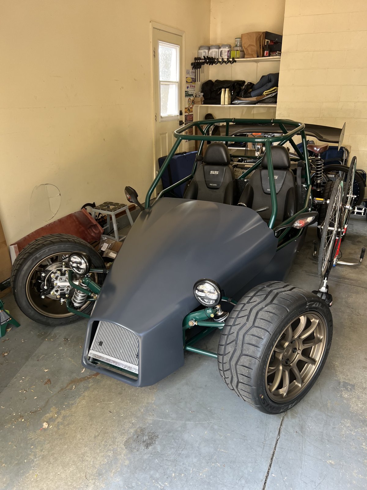

Getting everything buttoned up and ready for inspection. E-Brake cables will be here tomorrow. I got the windscreen installed this afternoon and did not realize how short it would be. What wiper…if you needed one…did you install? I can’t seem to find one that will be short enough to not extend past the top of the plexiglass.
