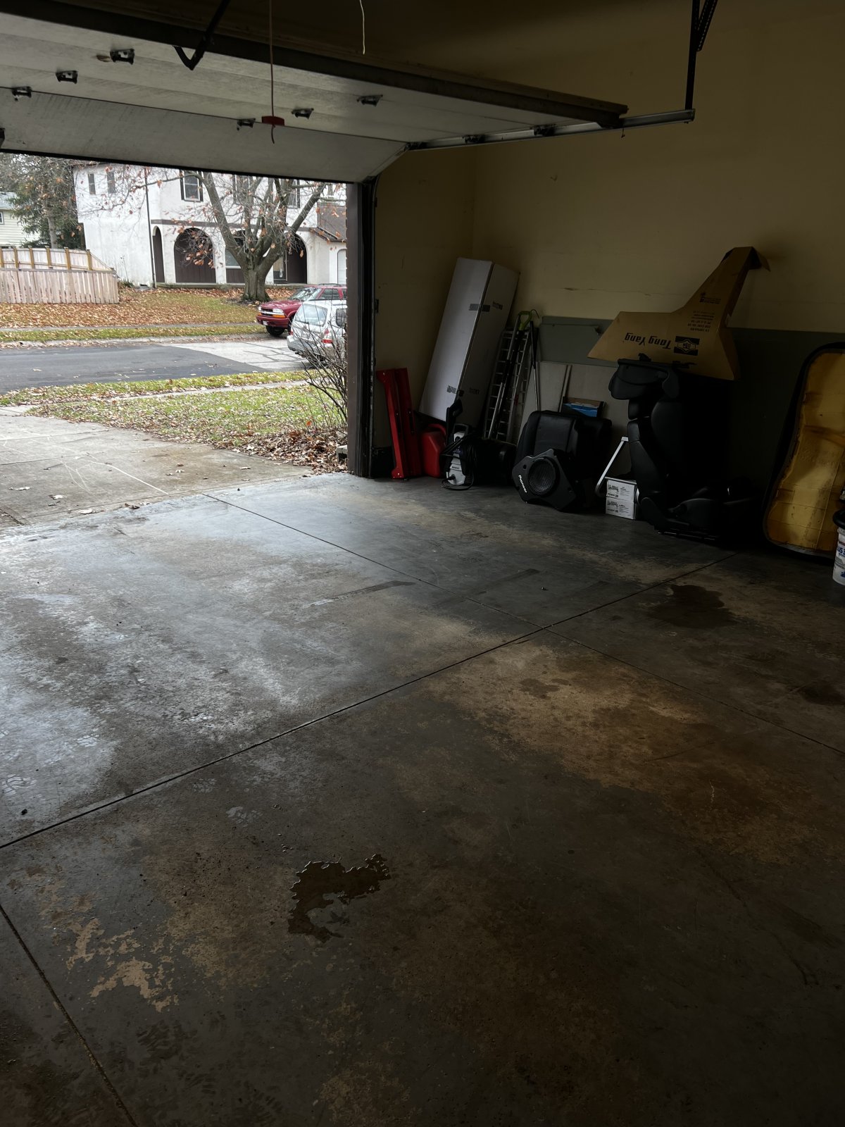

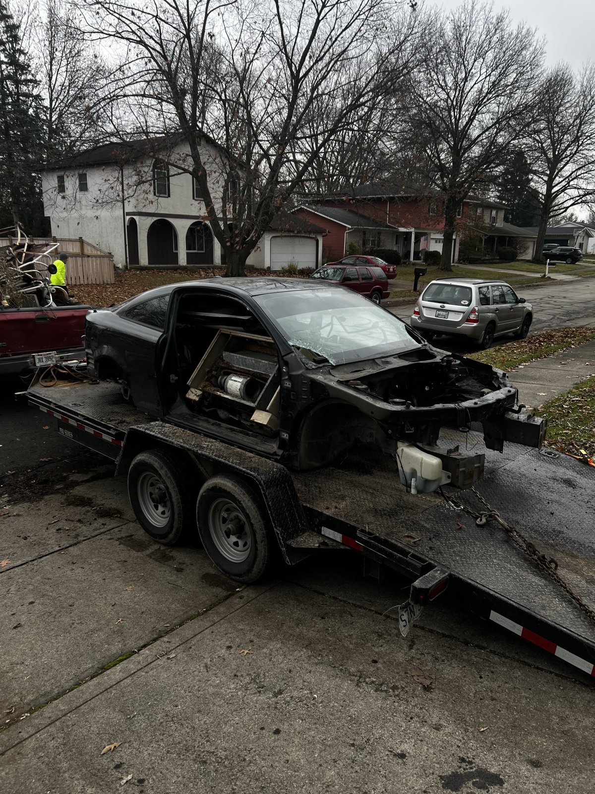

Shell is out of the building. They even took all the trash and junk i didnt need that I filled the car with. So much room for activities!

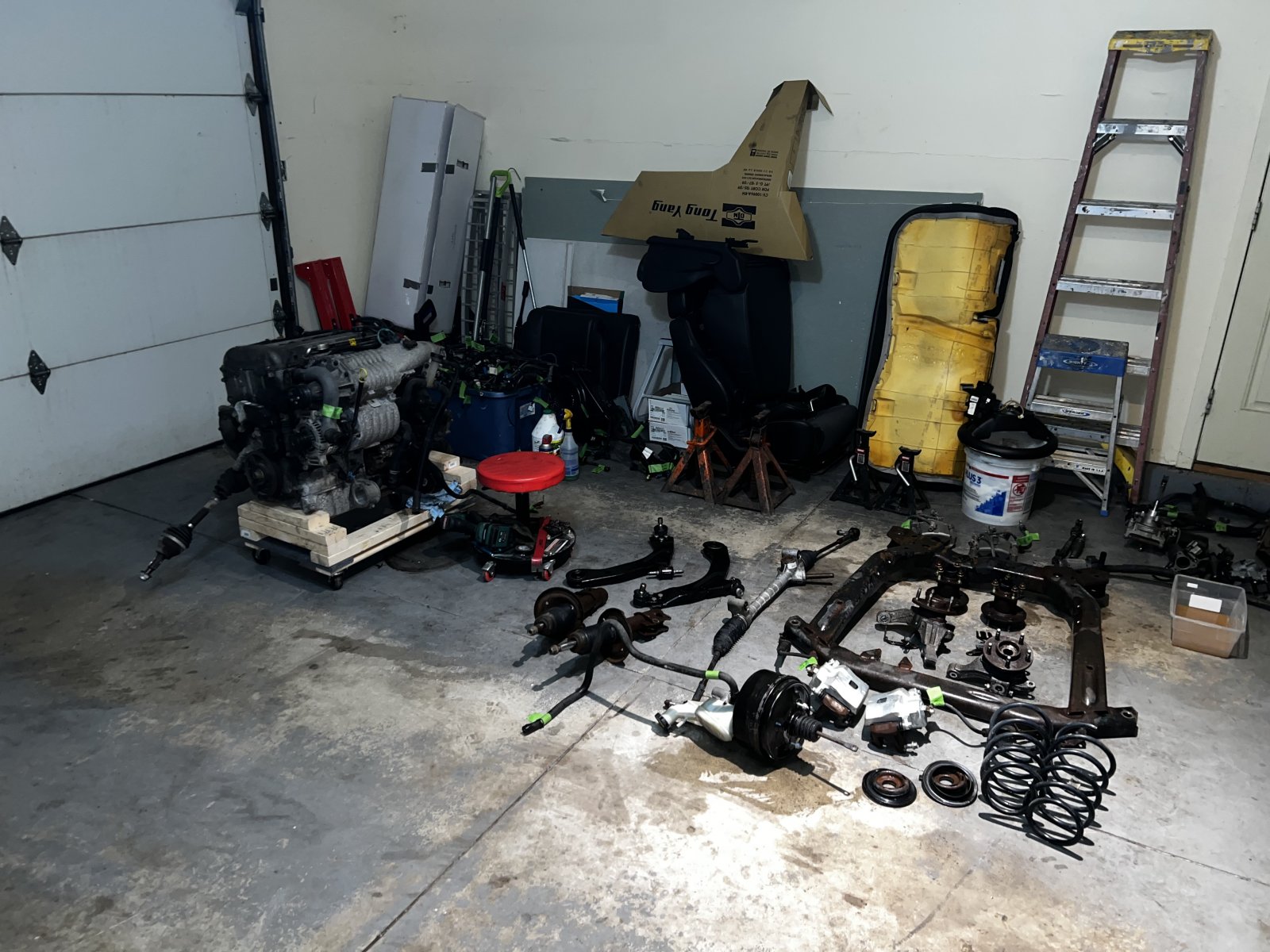

Pretty successful weekend, donors gone, parts are cleaned and somewhat organized. I stripped the engine of the wire harness to make me feel better about cleaning it. I plan to tape over all electrical connections and I have to think of a way to seal the exhaust ports since I got rid of the header. may do it the old fashion way with some elbow grease.

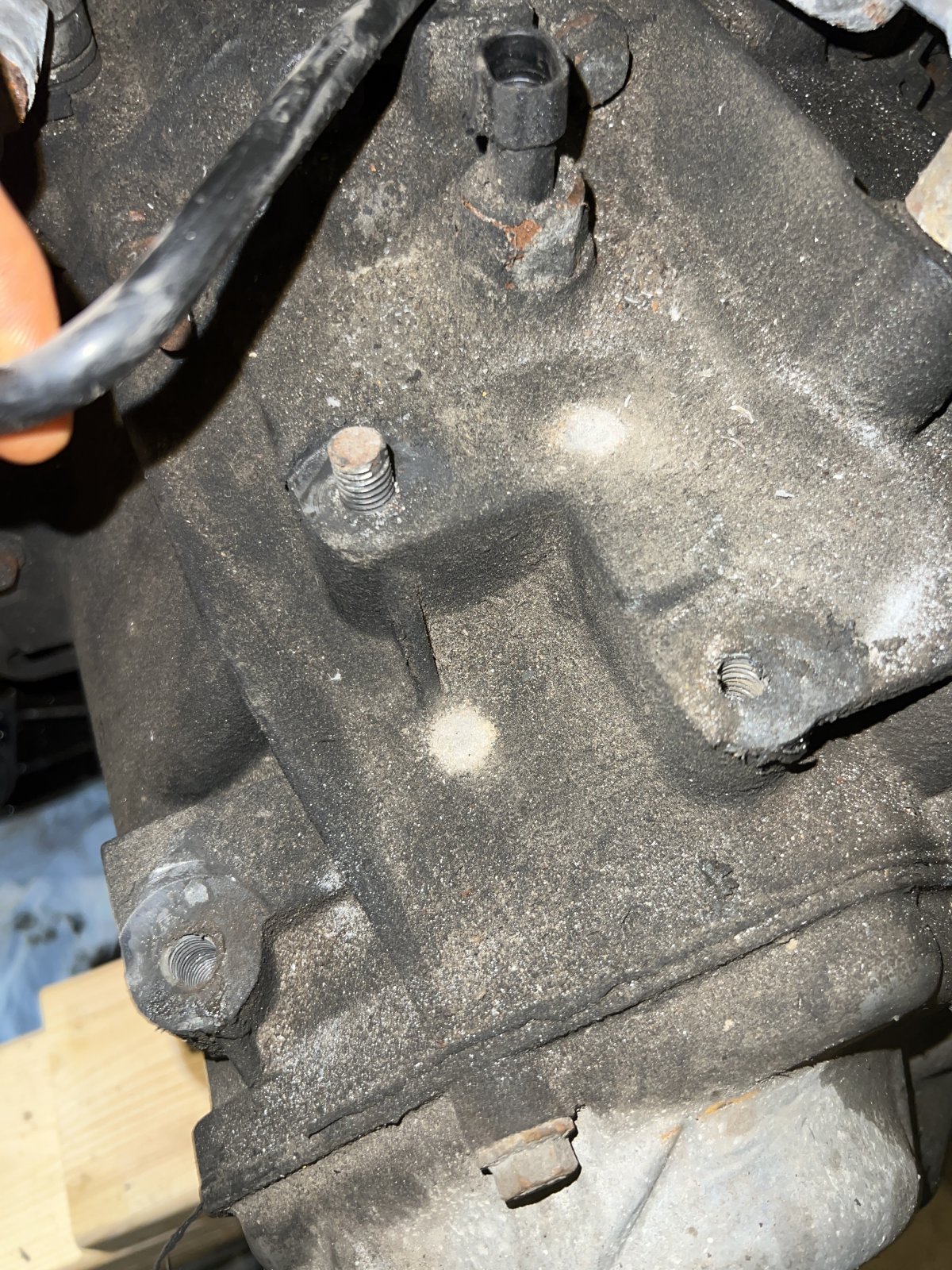

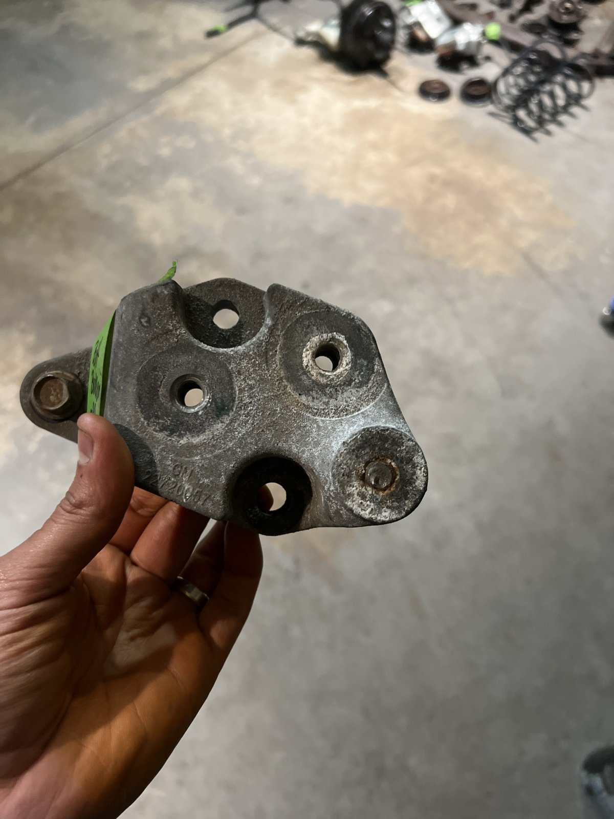

Thank you all so much for the help so far! I’m officially done stripping the donor! So far I need a new clutch master cylinder and sway bar links if I find using the sway bar necessary. I also need to extract a few bolts, one out of the transmission securing the mount and one out of the mount. While test driving there was a nasty sounding clunk and after getting the engine pulled a bolt was broken off and the mount bolts were not fully tightened. The transmission bolt looks easy as there is still a decent amount sticking up. The mount bolt I’m worried about. May need to source a new mount.

That transmission mount is for the F35... I thought Lonny was welding up a metal mount, but I can't find it in the DF Store. Ask Lonny if he offers a replacement part.
My transmission is a LSD, did you use the sway bar from the cobalt? when I order I will email about the mount.

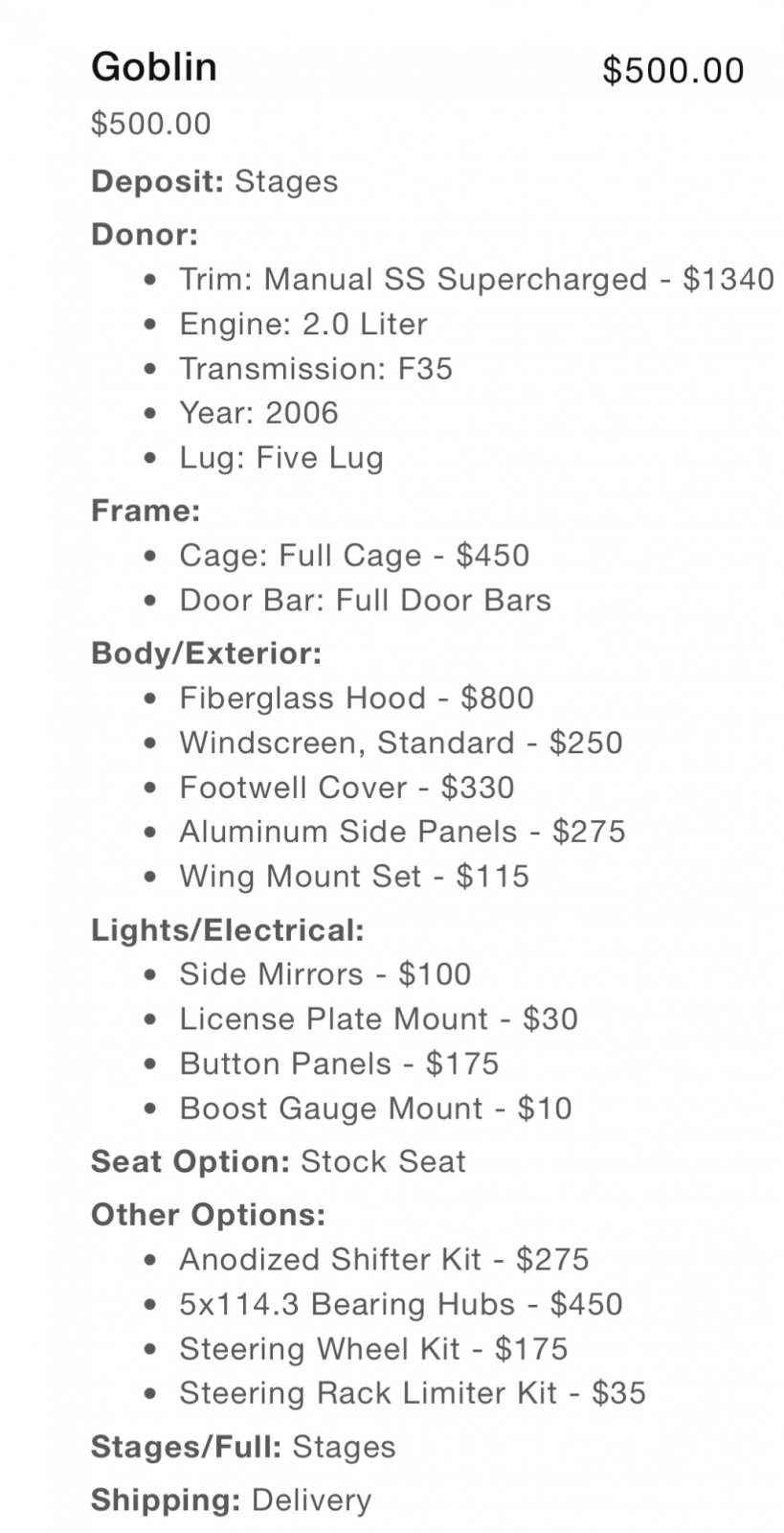

Attached is a screenshot of my cart. I’m not ordering right this second as I want to think about a few options I have selected and not selected. Does anyone see anything missing that you regretted not ordering the first time around? or see anything I have selected that you found unnecessary?

I sourced an 18mm sway bar off of a non-SS Cobalt, along with the rubber mounts for it.

FWIW, several of the gurus convinced me not to do the redrilled hubs. I plan to use adapter plates to get to the 5x114.3 pattern. Using redrilled hubs means not being able to run to the auto parts store for a replacement. Other than that, your order sheet looks a lot like mine!

Only items I didn’t get from my previous cart were the button panel and redrilled hubs. I’ve been looking at other posts for button panels / steering wheel controls and like the idea of spacers to convert and move the wheels out more.
