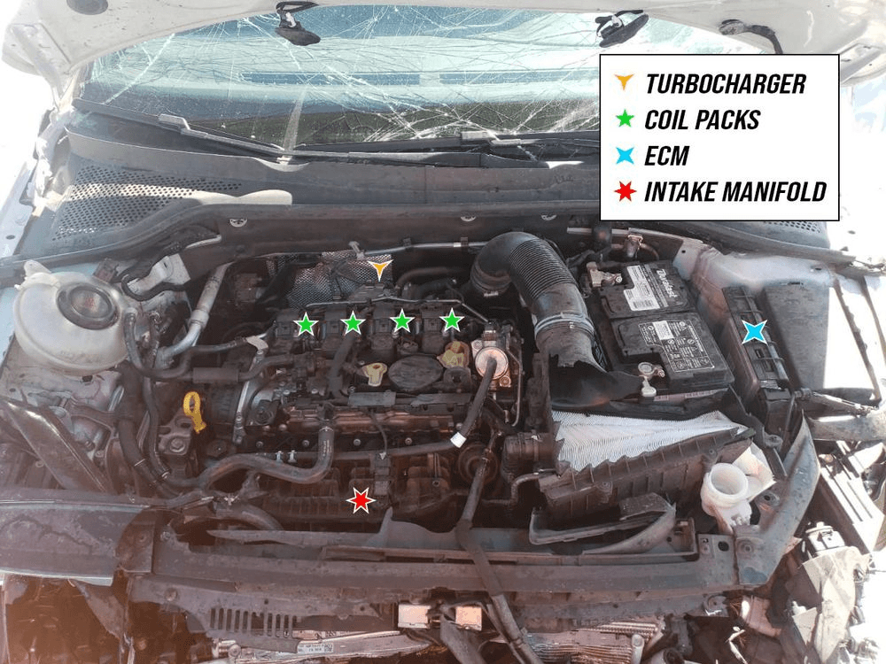

Visually verify:
  • Turbocharger present and intact
  • Coil packs installed
  • ECM still installed on the driver side of the engine bay
  • Intake manifold not cracked or broken

Mk7 Golf GTI engine bay with labeled components including turbocharger, coil packs, ECM, and intake manifold to help verify completeness and identify damage risk after a collision.
This damaged donor still has critical powertrain components intact. Confirm that the turbocharger, coil packs, intake manifold, and ECM are present and undamaged before purchasing.

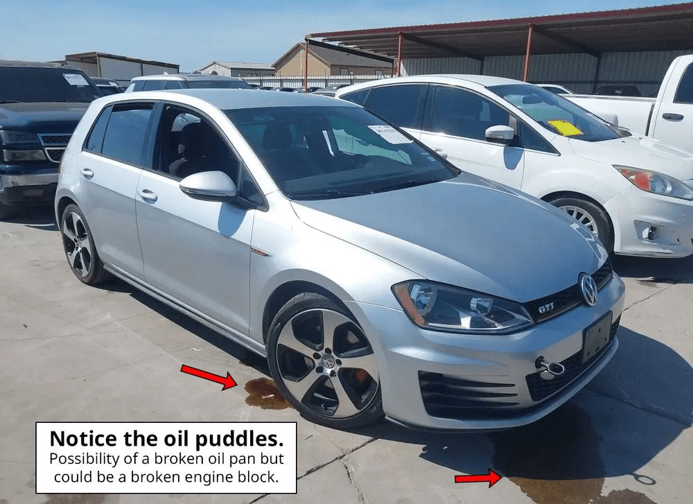

Silver Mk7 Golf GTI at a salvage lot with visible oil puddles beneath the car, indicating a potential oil pan or engine block issue.
Oil puddles under this GTI may signal a cracked oil pan or more serious engine damage. Watch for fluid leaks when evaluating potential donor cars at auction.
