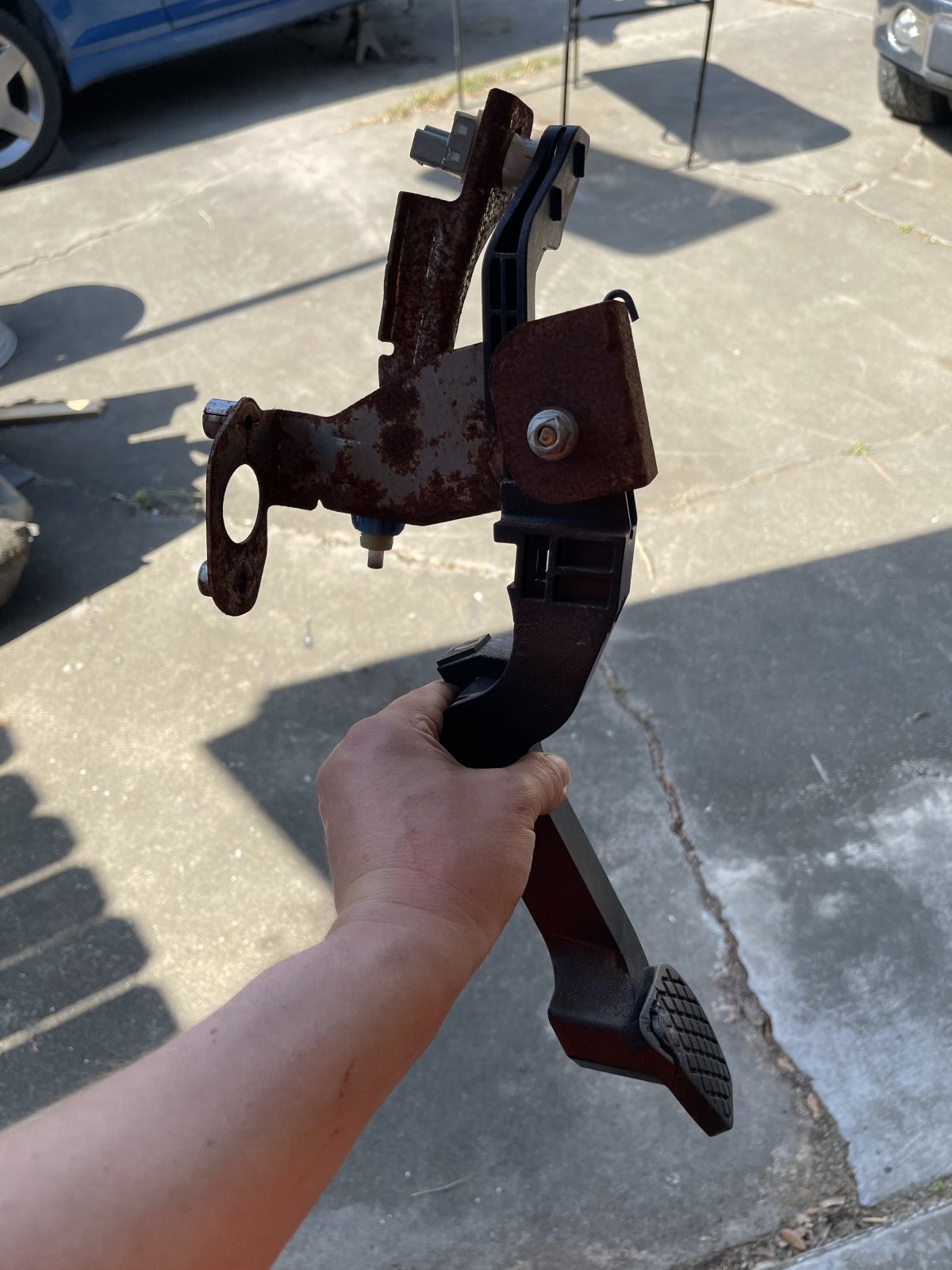

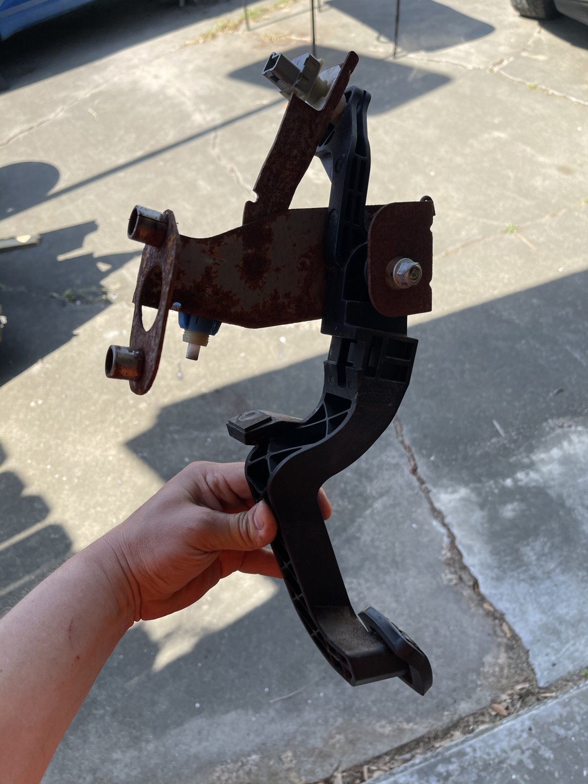

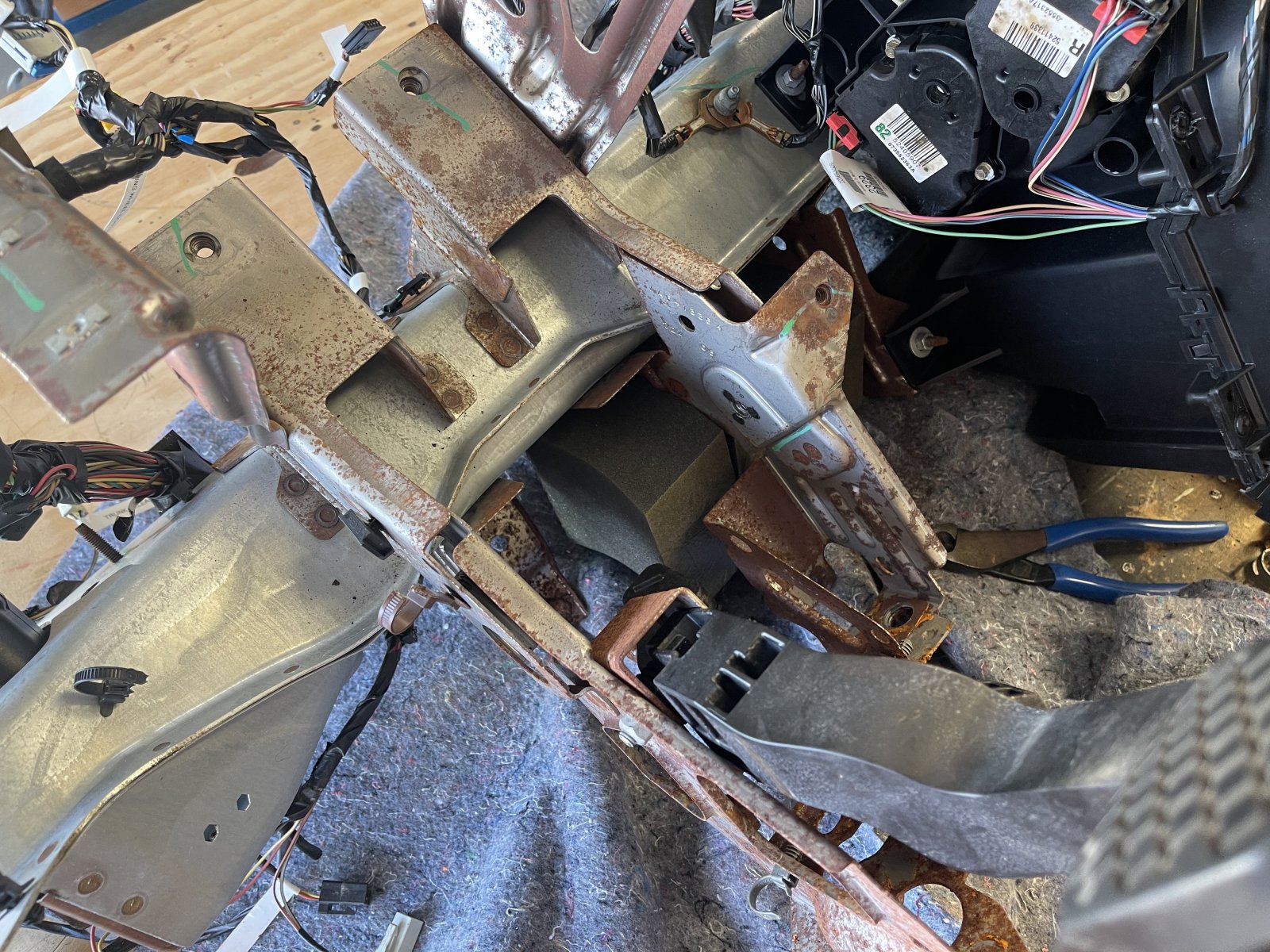

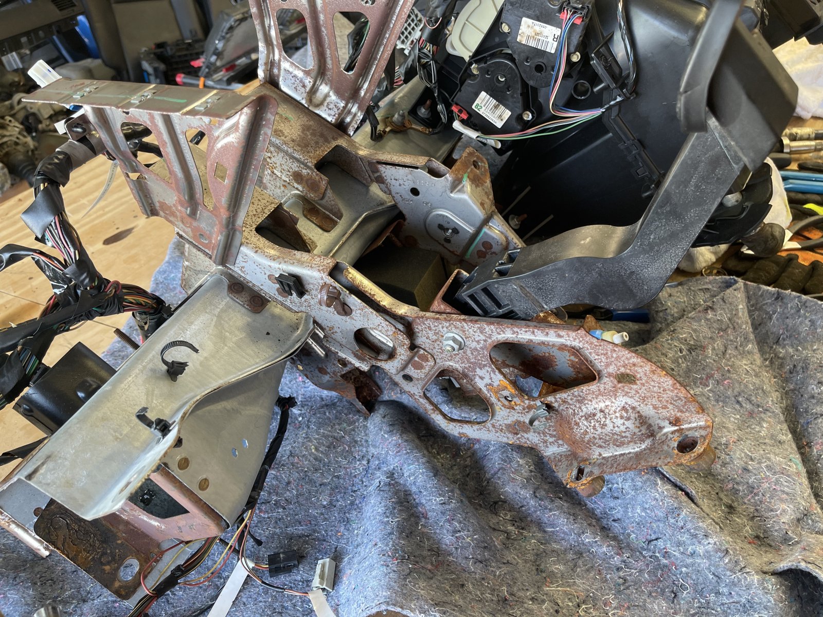

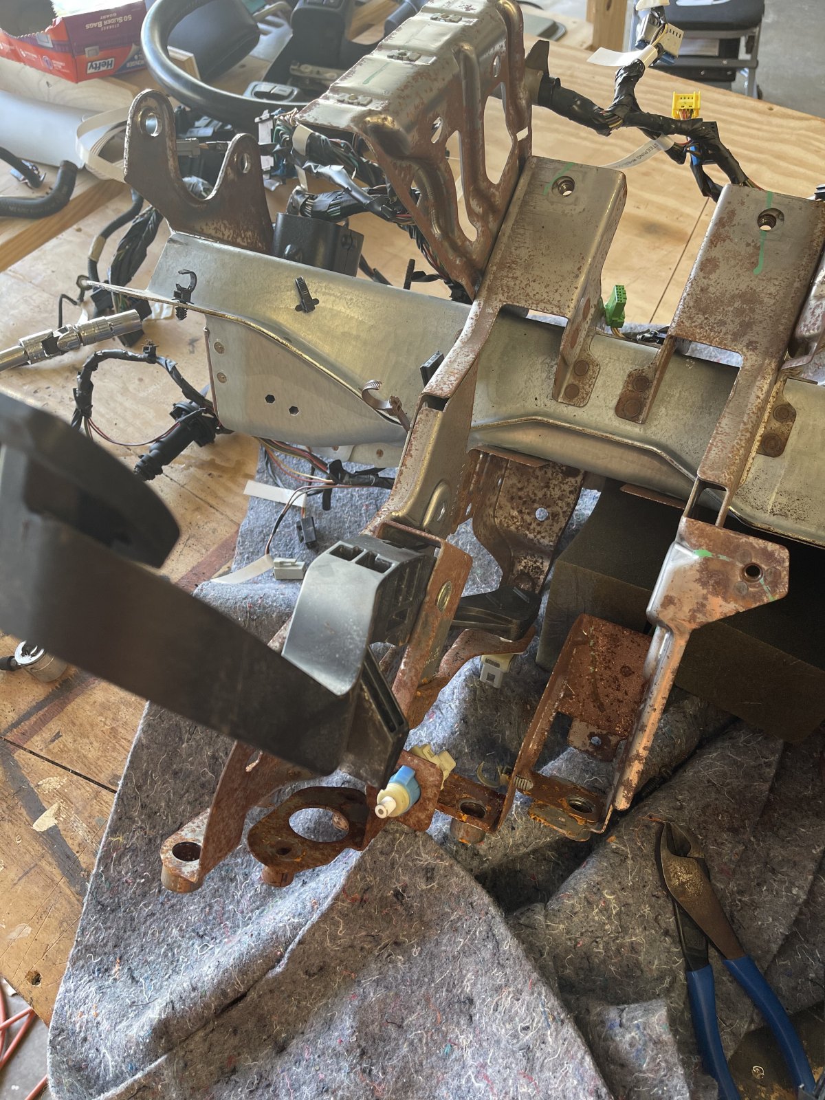

Do I need to save the frame from the clutch pedal? Or do I just remove the clutch pedal? There's no info in the videos about it. It's all welded together so I'm wondering if I need to cut it all free?

No, you just save the clutch pedal box, no need to cut it up.
*edit* Oooof .... wait. My early-model donor did not look like that. I'm confused.
CodyP
The brake and gas pedal came out as one sub unit. This "box" holding the clutch pedal is all spot welded in different areas essentially a part of the whole frame. :(
N
Here’s a nice pic from Ross that shows the small half frame
CodyP
If you take out the bolt that runs through the middle of the clutch pedal, it should let the small frame piece come loose so you can take it out.

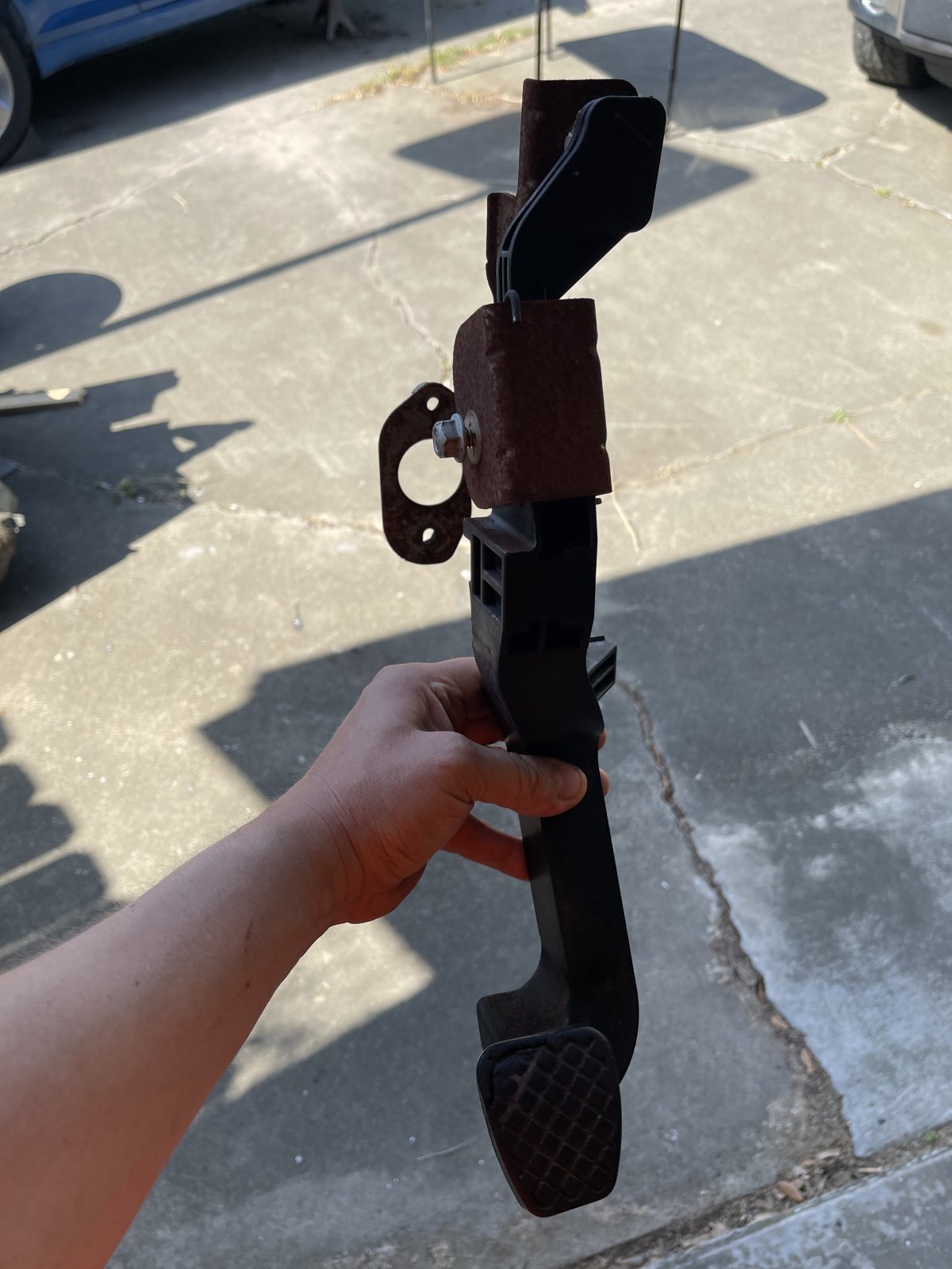

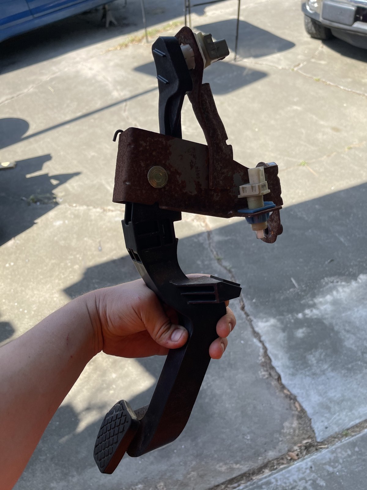

Good call. Thank you! Don't know why I waited to remove every nut and bolt before assuming it was all connected. Here are some pictures for future reference of the clutch pedal box assembly.
