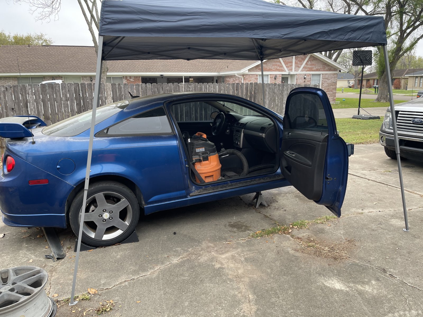

What rain?

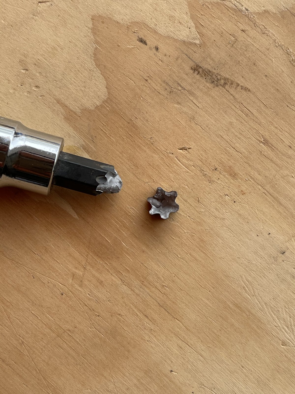

Didn't realize I had 2 more T50 torx bolts to remove. Thought I was out of the woods. Looks like another trip to the store.
R
Honestly, those bolts aren’t reused unless you’re reusing the stock seat belts. I’d save the torx bits and effort and just cut the plastic around the bolts.

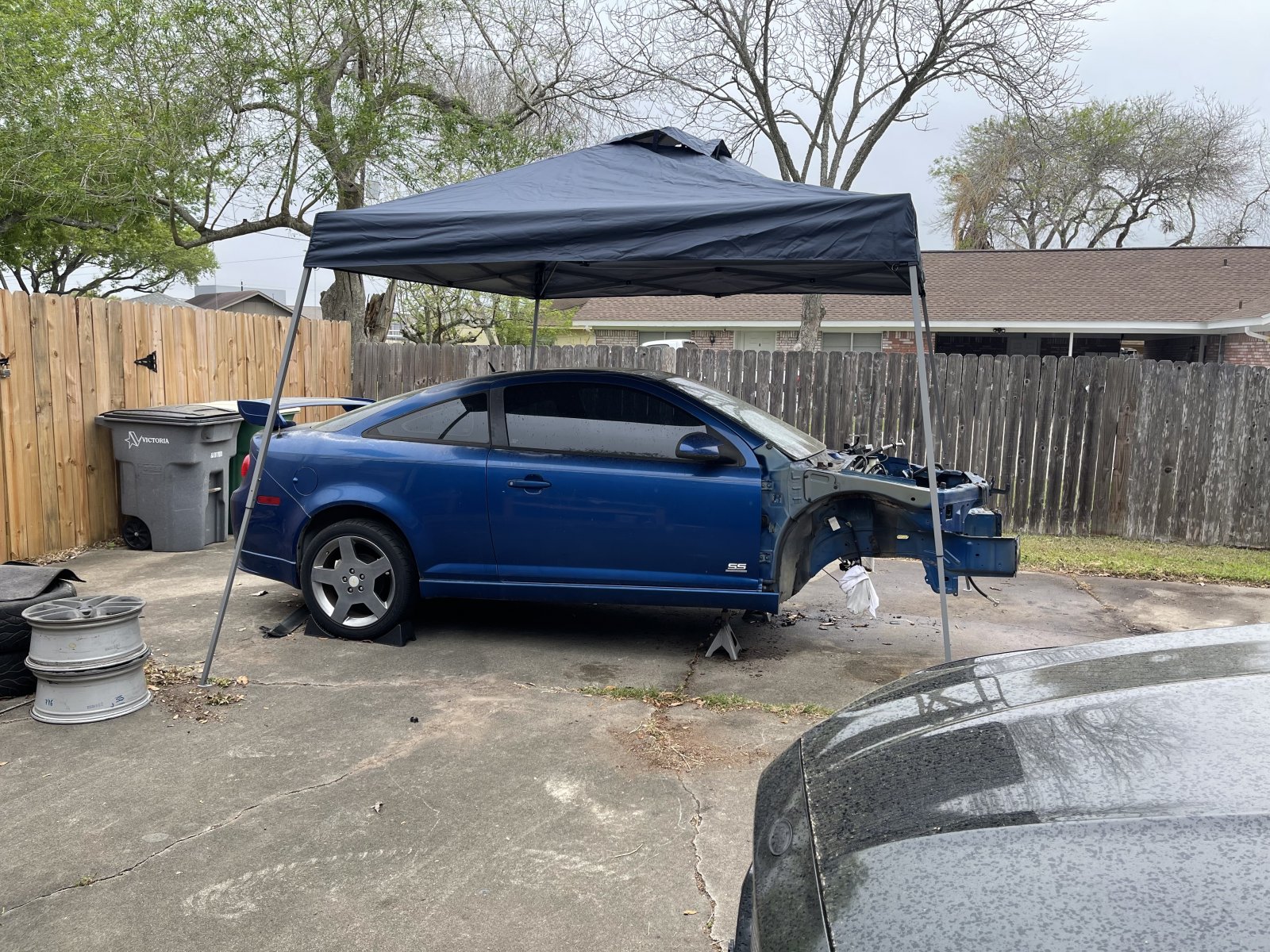

Milestone, maybe? The heart of the beast has been removed! Got the engine dropped and pulled out tonight. Hopefully the rest of stripping the car goes as smoothly if not more so. It'll require some cleaning, but things are looking pretty good. It's funny how much bigger the engine feels once it's removed from the car. Definitely had a fun time dragging it up into the garage.
Looking good!
If you plan on keeping those axles, you may want to support them so the bearings and cages do not get damaged.
Wanna know why you are breaking them? You are using the wrong t50. There is a seat belt T50
post 4
CodyP
post 4
I saw that when I was looking through that post originally. However I didn't want to order and have to wait for a special tool that'll never get used again for anything else. I only broke one and it was harbor junk. Got a new one for 3 dollars from Home Depot. I ended up stripping out the last bolt on the seat belt reel and taking the cutting wheel to it. All good now!
