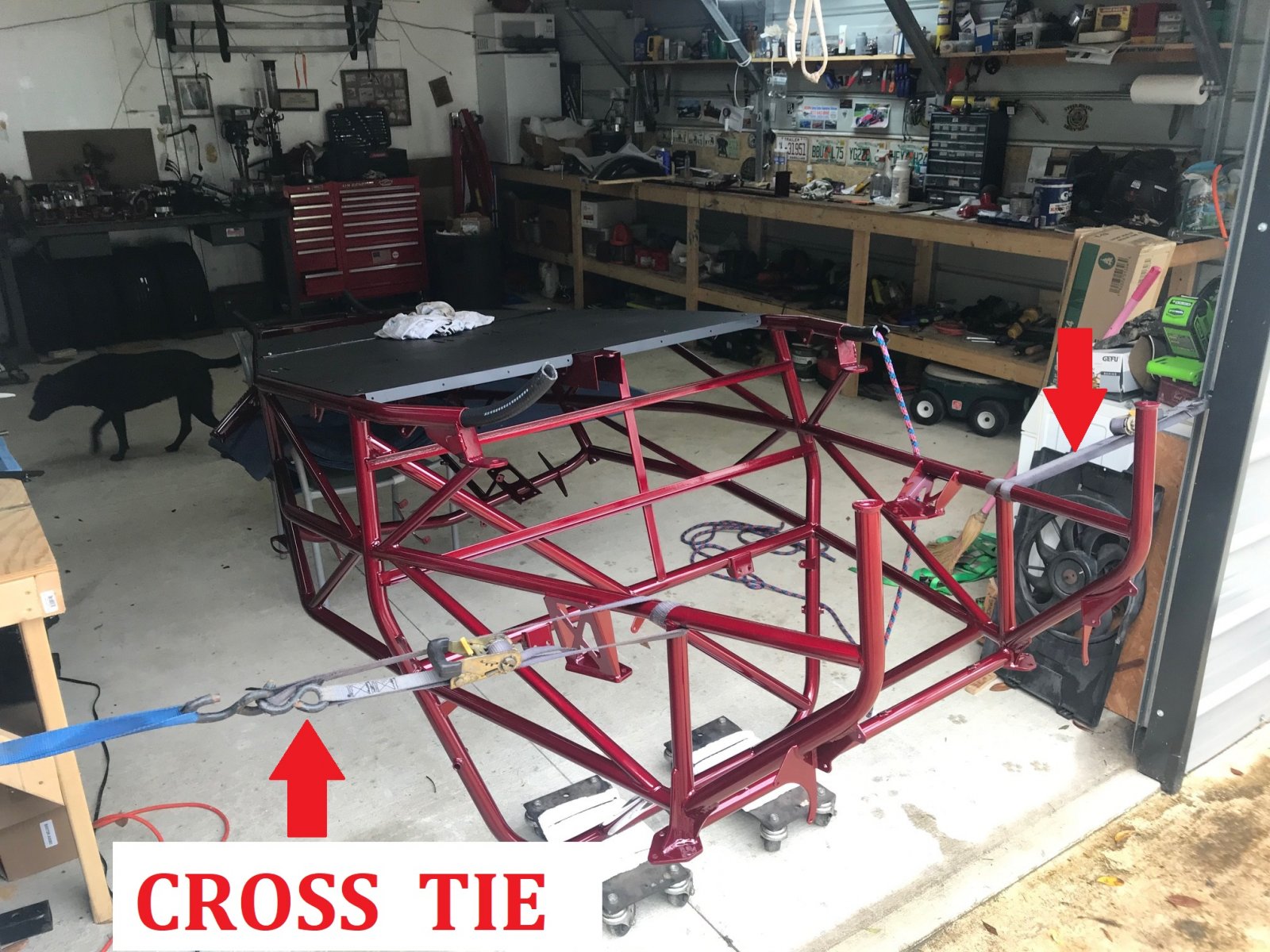

30 second, 4 step coolant hose install - 1.) Cross tie frame 2.) Prep hose 3.) Attach to Kubota 4.) Back up .... DONE

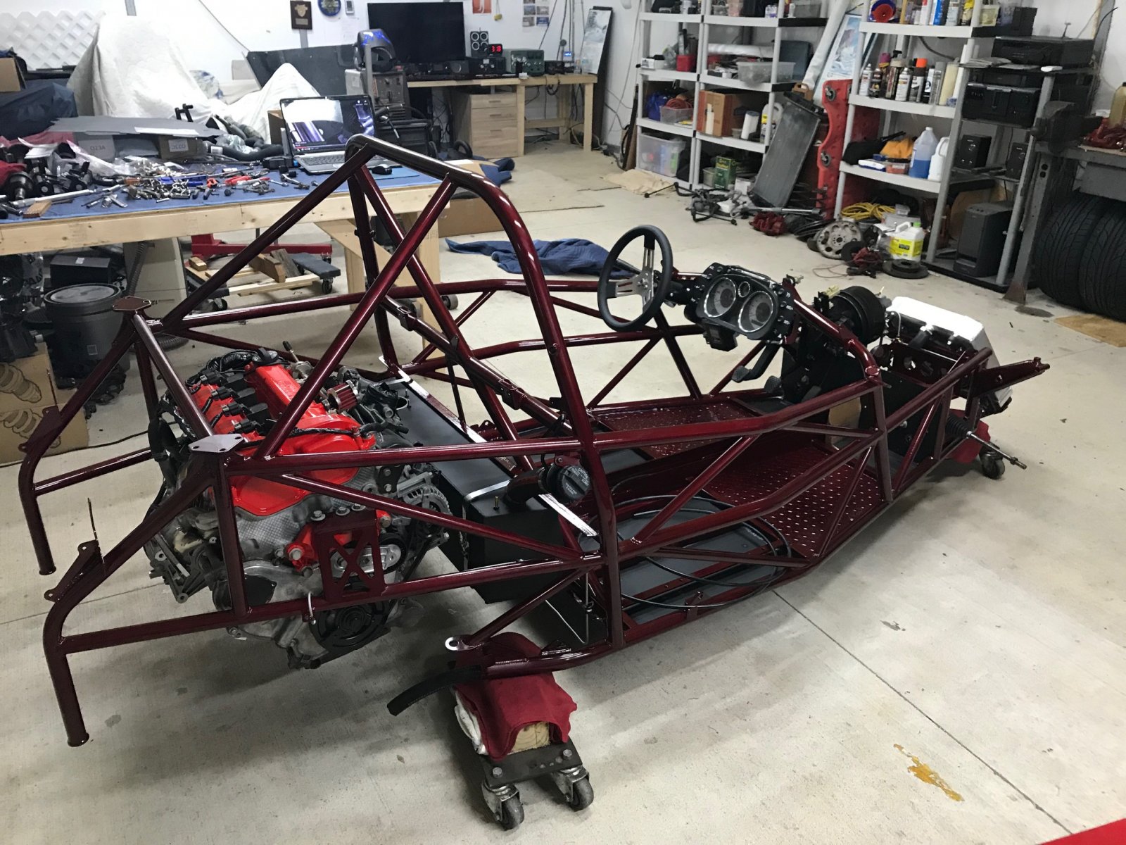

Build Day 1 - First day is in the books. Only a few minor issues to deal with. I have to jump ahead a bit since my wiring harness is still at DF. Hope to have it next week. Will probably put in the engine before I get the harness. Lonny says it's not a big deal.

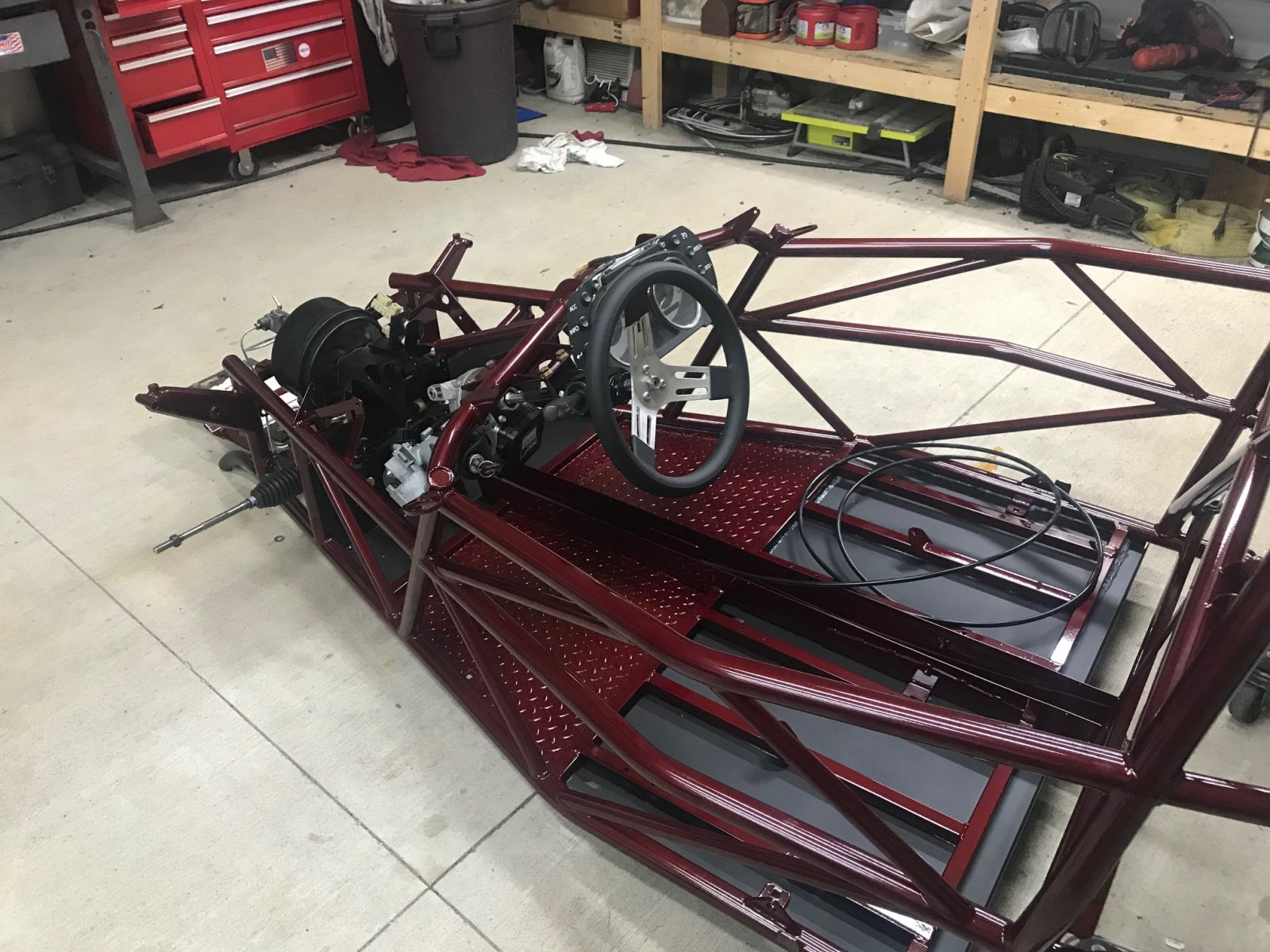

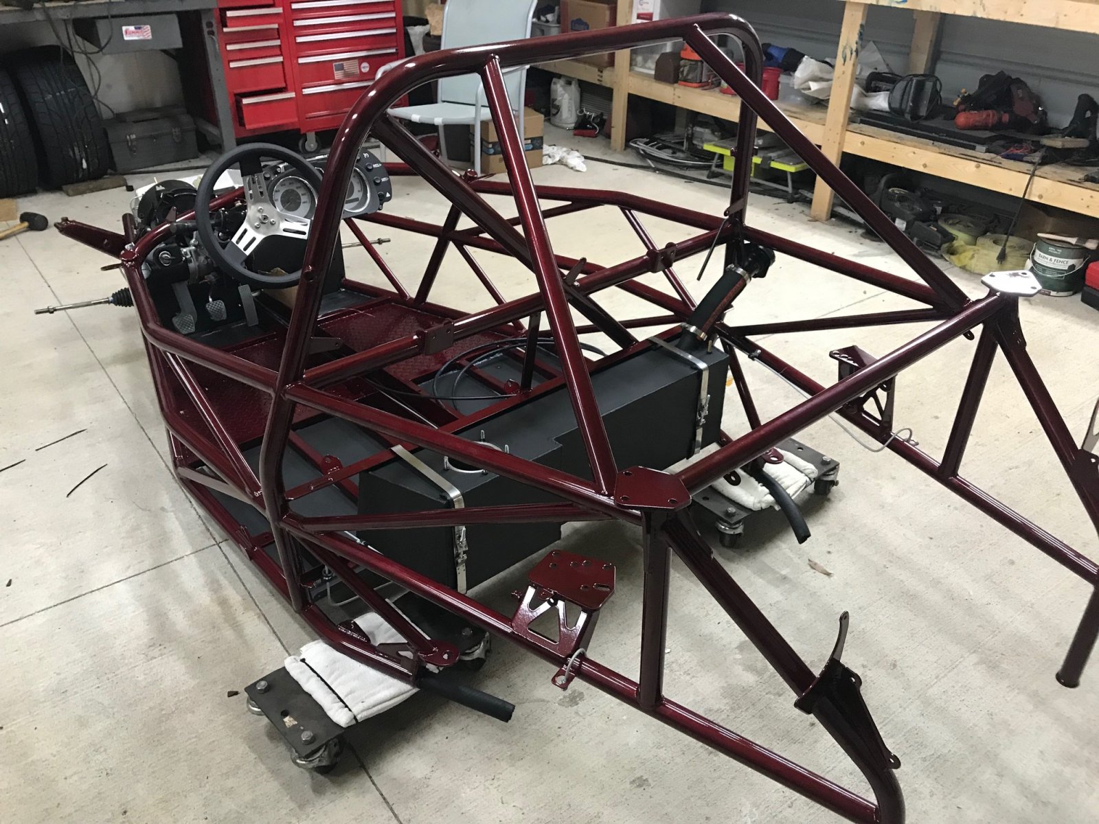

CaptFrank2001

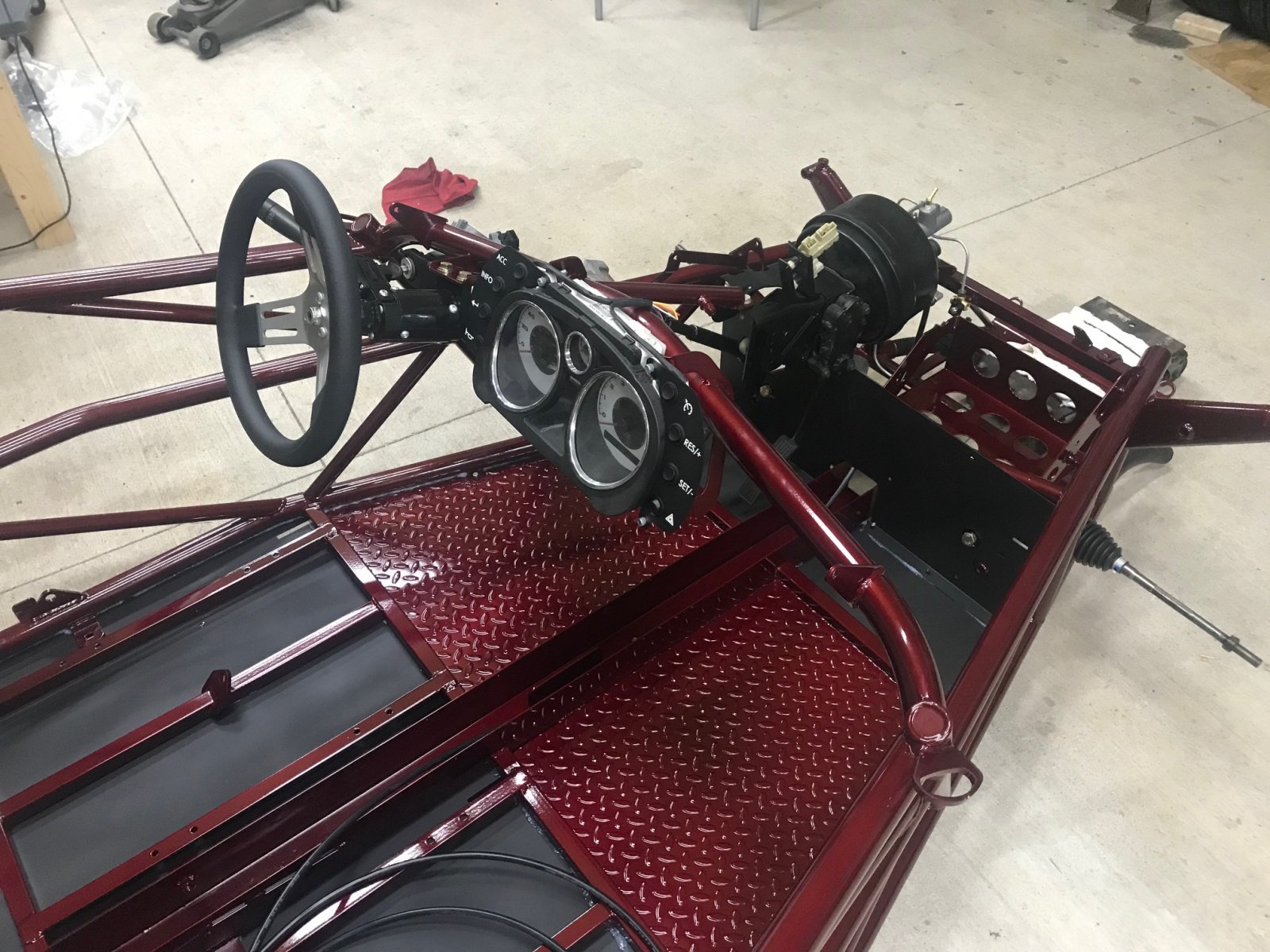

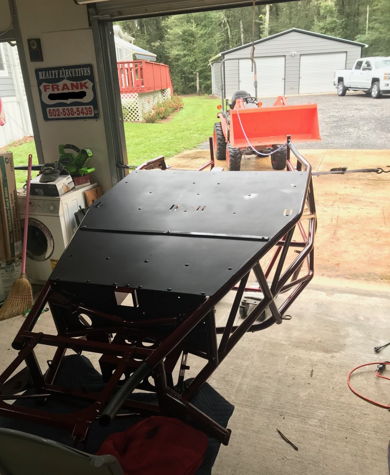

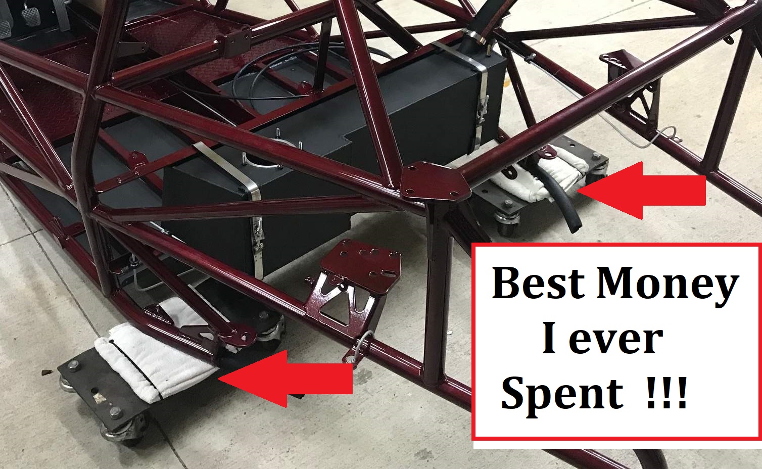

Build day 2 - I think I better slow down. I may work myself right out of a job. Actually three month's of prep work is paying off. Everything is ready to just drop in the car. I'm a one man show so I use a lot of jacks, dolly's & lift's to move things around.

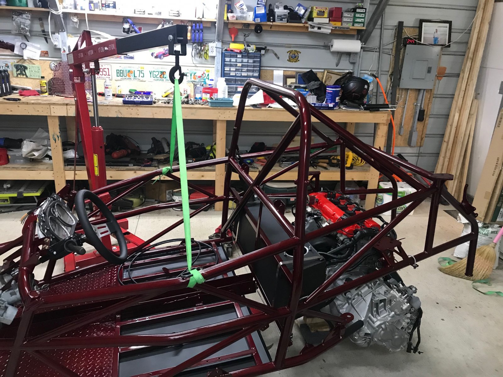

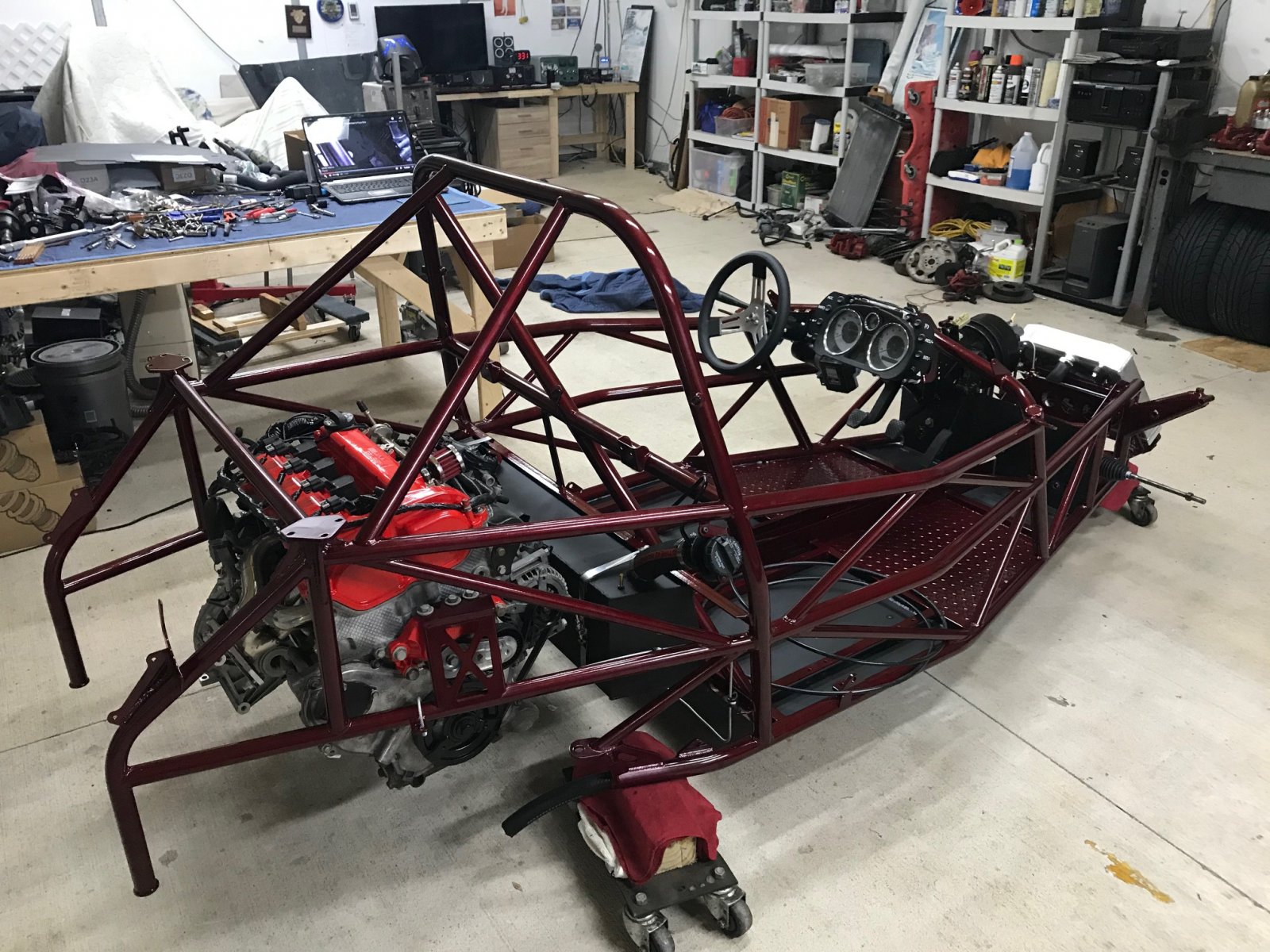

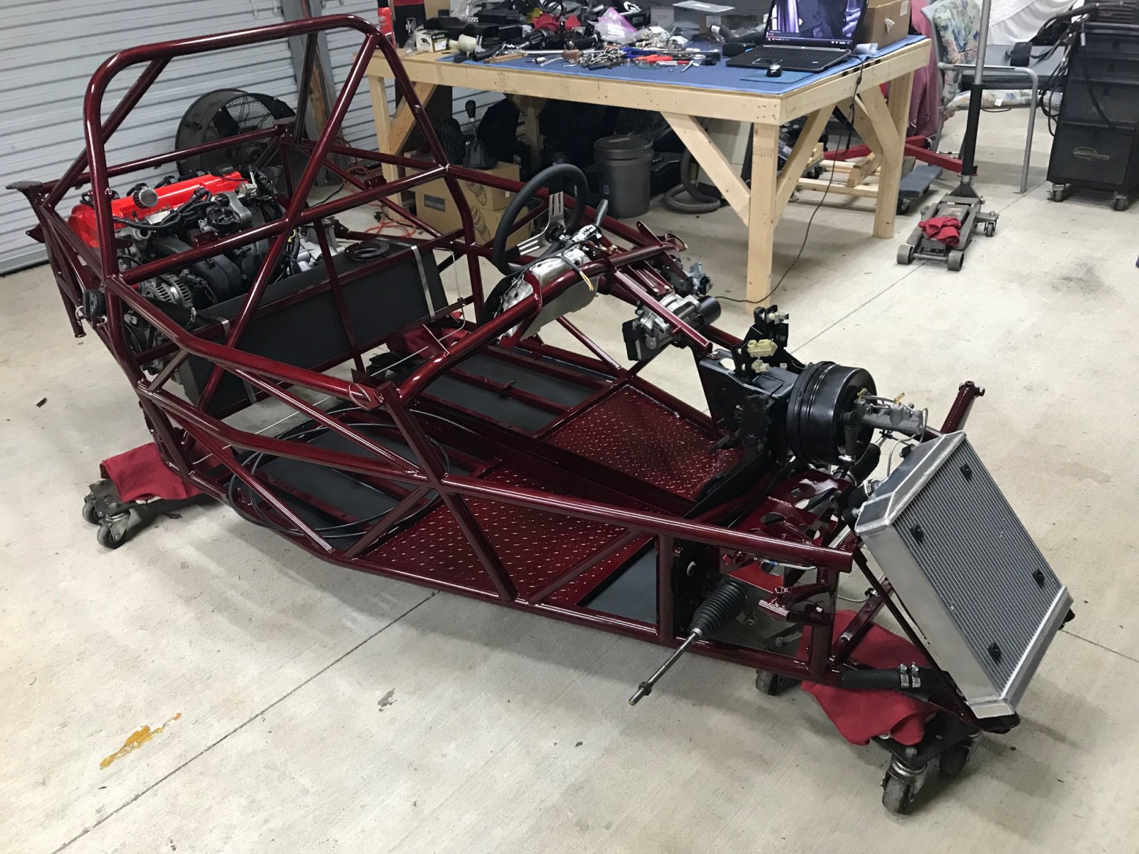

CaptFrank2001
30 minute motor install. Had the motor on a wheeled dolly. Used an engine hoist to lift the frame. Went in like butter. Actually it only took 15 minutes .... I spent the other 15 minutes searching for the engine mount bolts.

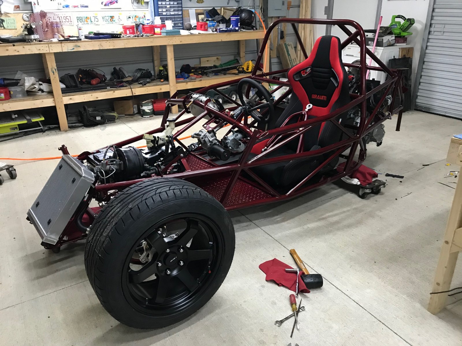

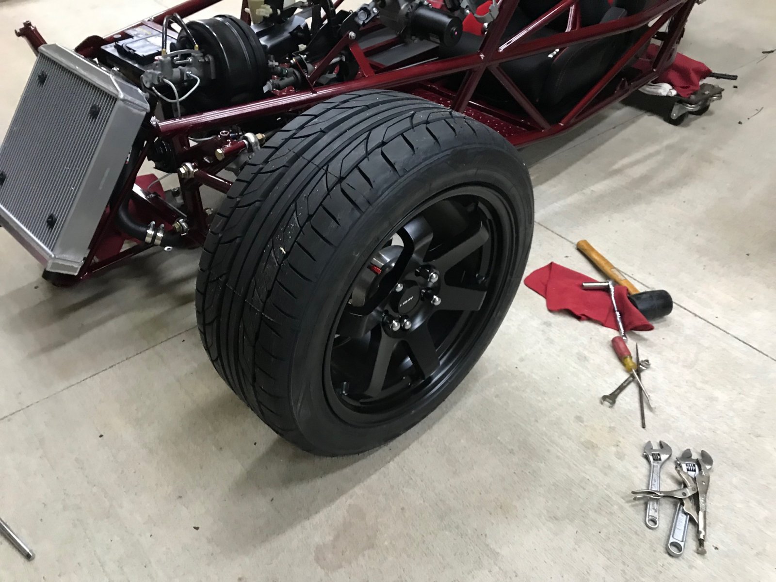

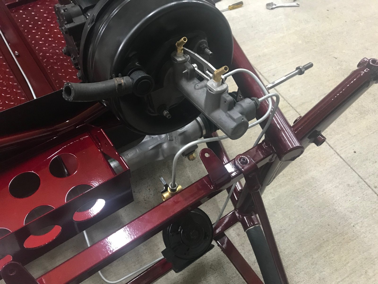

CaptFrank2001

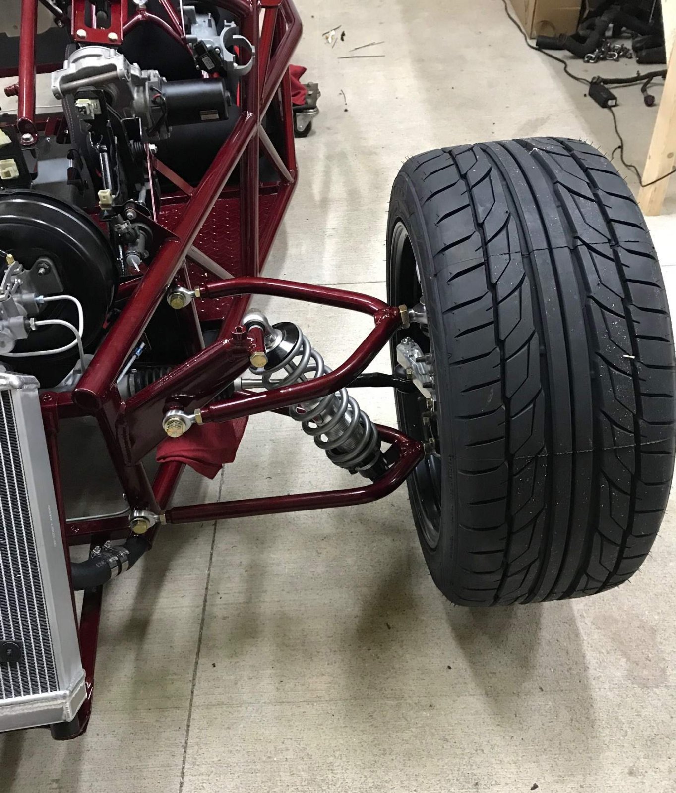

Build day 3 - Working on the front suspension today. Finished up all the coolant lines. Mounted remote brake/clutch reservoir. Put in fuel pump & filter. Had to drop in a seat & put on one wheel (no brakes) just to see how it's going to look.
