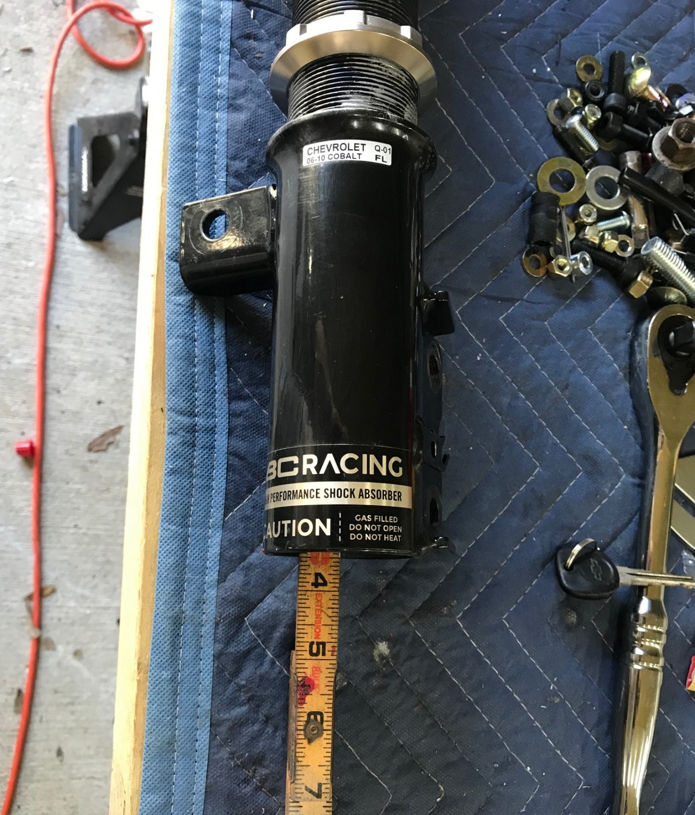

BC COILOVERS (REAR) - Trying to figure out the best height for the BC Coilovers on the rear. I was adjusting quite a bit and was worried I may adjust them too far. Called the BC guys and spoke to Tek Support. They said the minimum thread contact on the base (which would be the maximum height for the shock) is 80mm or 3.15". I removed the shock from the car, took off the base and measured the threaded section & found it to be just over 3" so he was 100% correct. I needed a way to check that once the shock was on the car so as you can see in the picture the threads end is 3-1/2" from the bottom of the shock. And you can measure this once the BC Coilover is on the car. Just put in a ruler inside the bottom of the shock
(see picture) and If you are over 3-1/2" you are exceeding their recommendations.

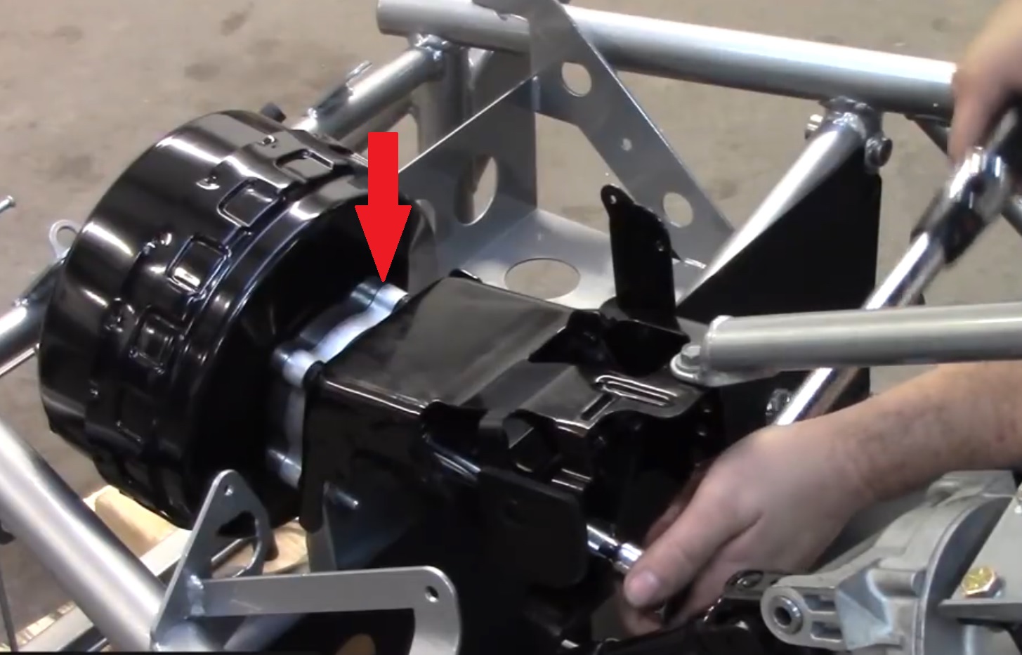

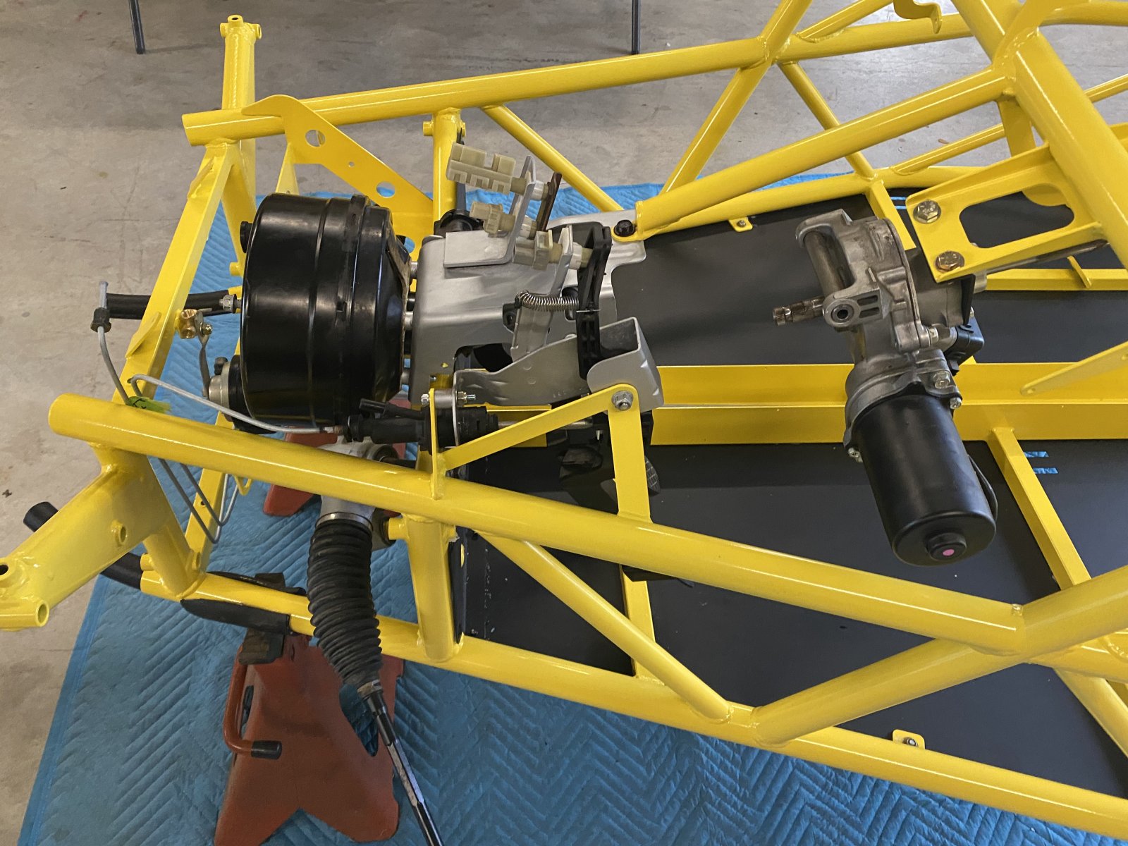

Missing or not. My car did NOT Have this spacer attached to the Brake Booster. Now I am having all kinds of trouble bleeding the brakes. Anyone else have this issue?
No “spacer” on mine, like in your pic, but there is a space in between the two, which would have been the area it mounted to the bulkhead on the cobalt.
Does the brake pedal move freely? Make sure no binding from the paint/powder coat on the pedal box.
other than the engine, yours is an early model like mine, so I’d assume it’s the same.
JPas914
I used a Motive power bleeder at the reservoir. Used it to push fluid through while pumping the clutch/brake pedals a good bit to bleed the master cylinders. It was a lot easier than i had expected.
I suspect that there s a clearance issue between the pedal mount and the booster/MC where as a small spacer should be added like you mentioned earlier. I think the spacing is off some from that of the OEM set up. I and others like you have all had this issue and doubt all of us have accidentally bent our switch mounts requiring it to be bent back. But in the end, bending or readjusting the switch is quicker and easier than fabricating a spacer. I haven't actually confirmed this is the case but seems very plausible.
Disconnect the brake pedal from the booster pushrod and try to bleed it. If it still doesn't work then you know it is not a spacer problem.
