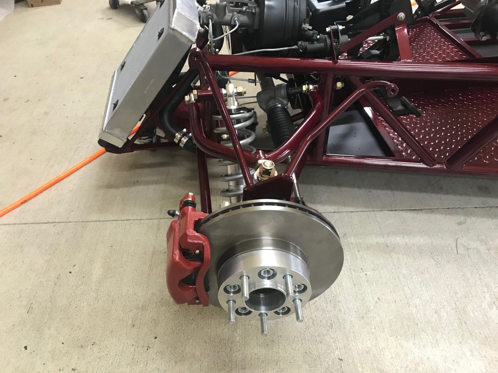

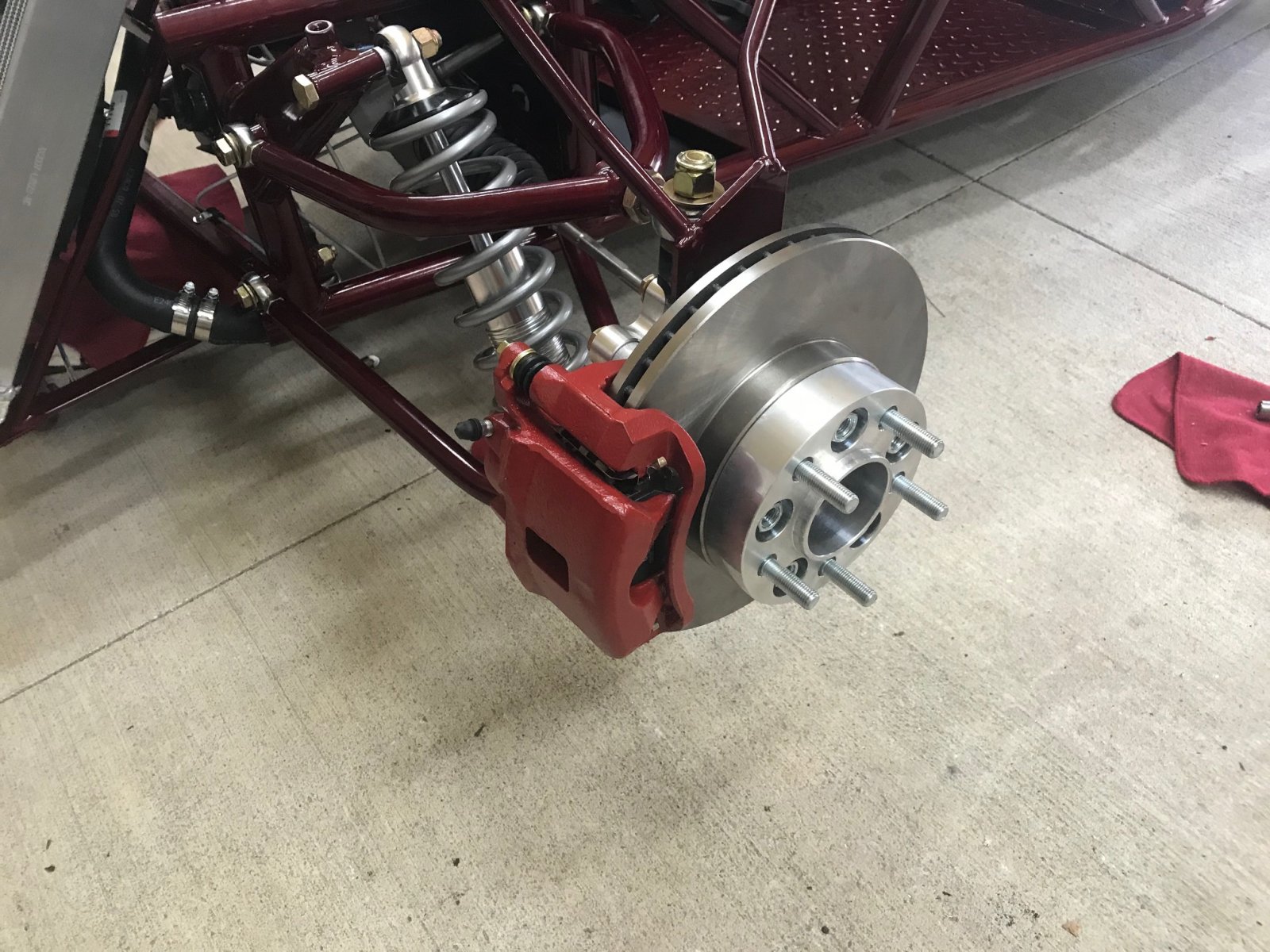

Capt, looks fantastic and you are moving along nicely. Make sure you try the wheel to a-arm spacing at full turn lock, don't want that purty paint job to get rubbed. Can't wait to see what your finished Goblin will look like,, it's going to be a classic with that frame color. Also don't forget the tires you have are directional - that should be a passenger side you have mounted up in your photos. :)
WYGoblin
Also remember to check your spacing after your alignment also. I checked mine before alignment and it was clearing but after I did my alignment I rubbed just a little bit.

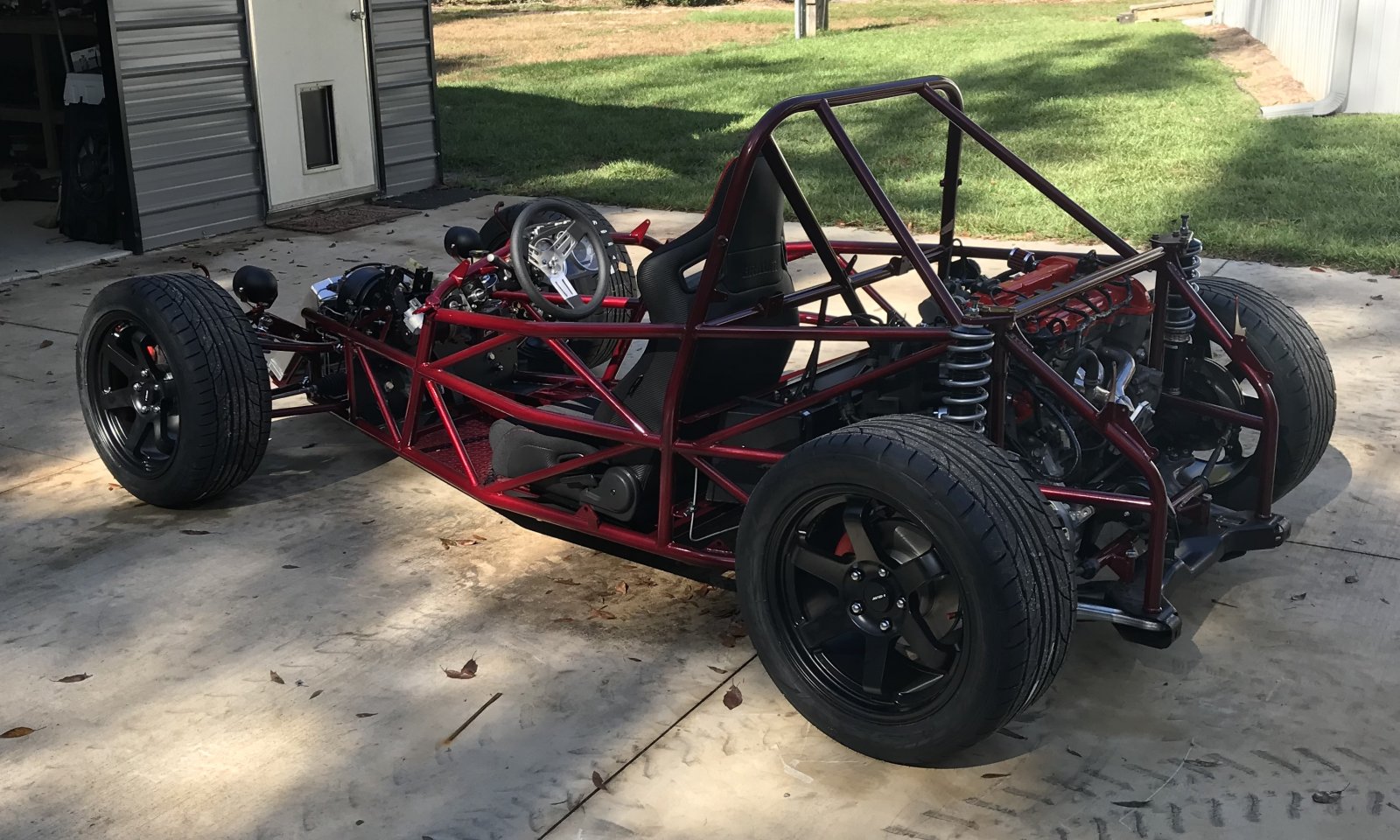

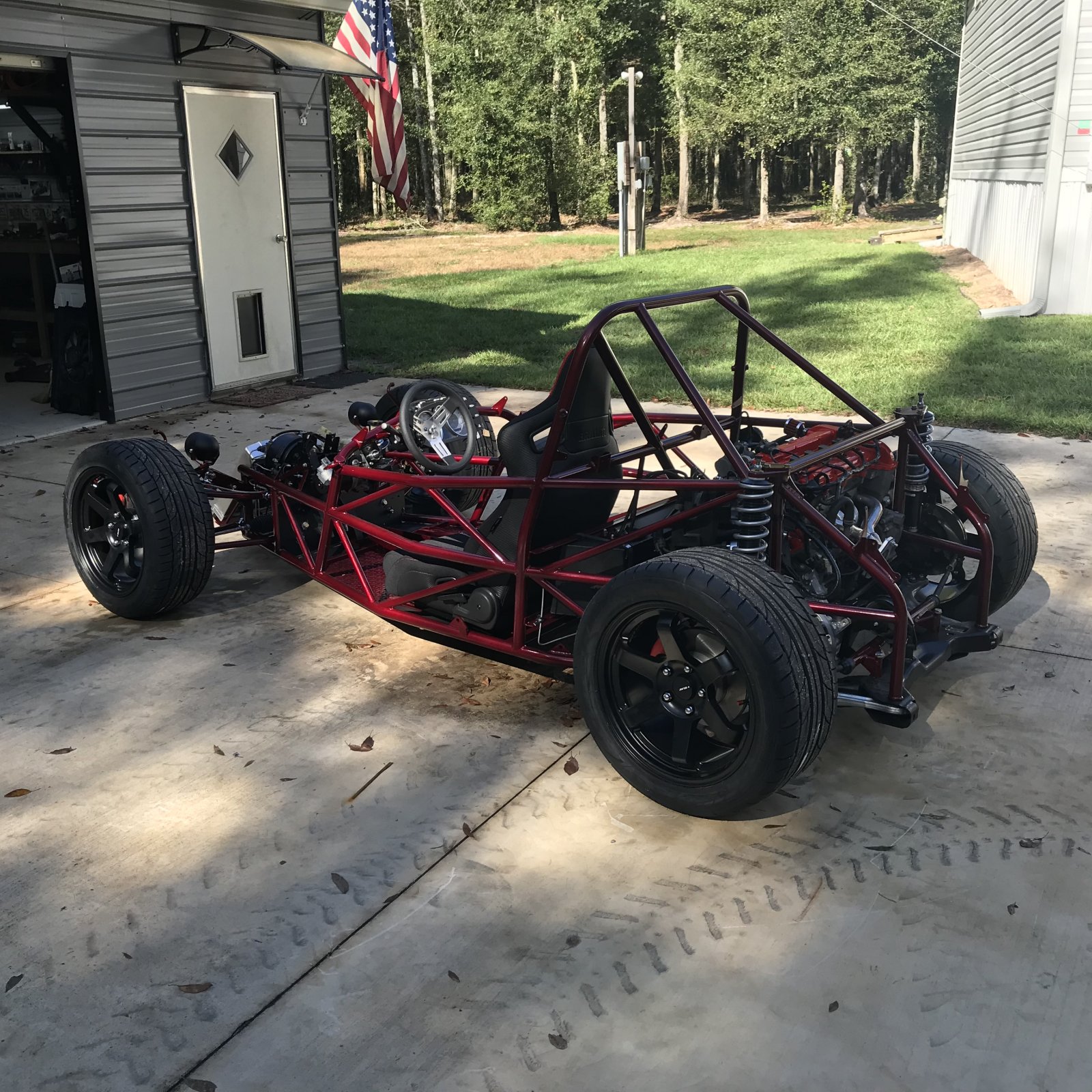

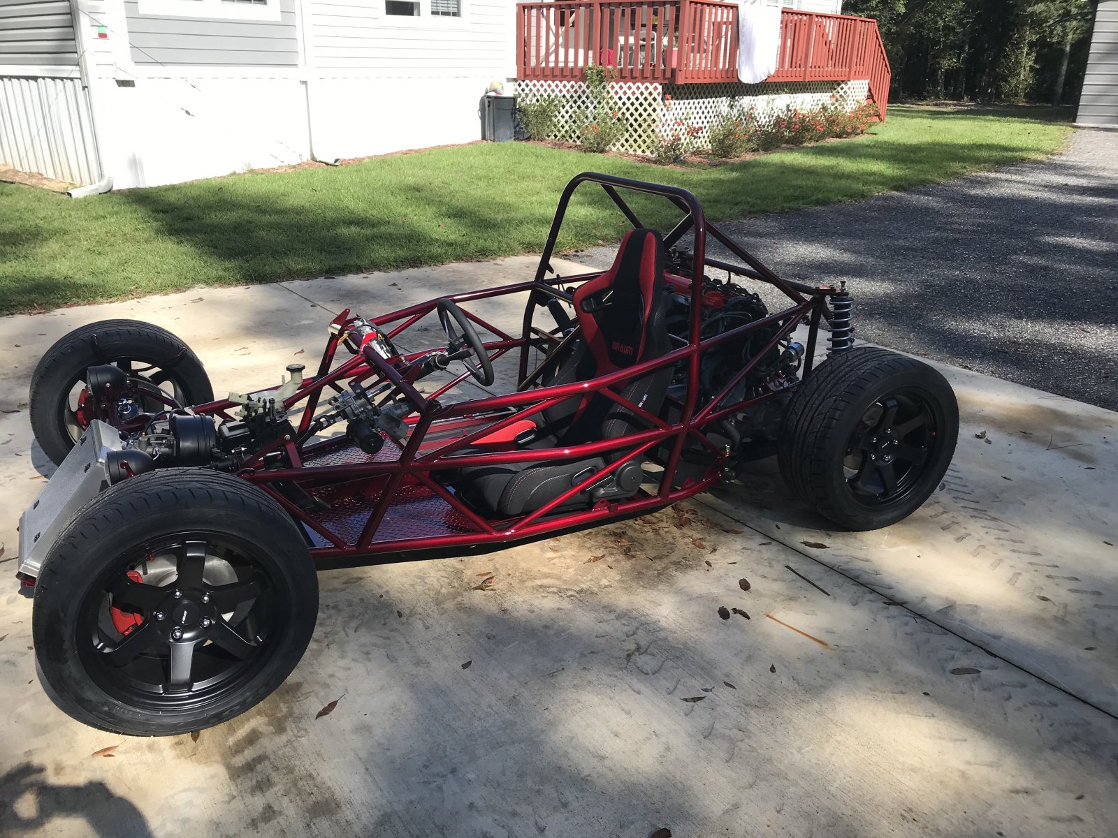

CaptFrank2001

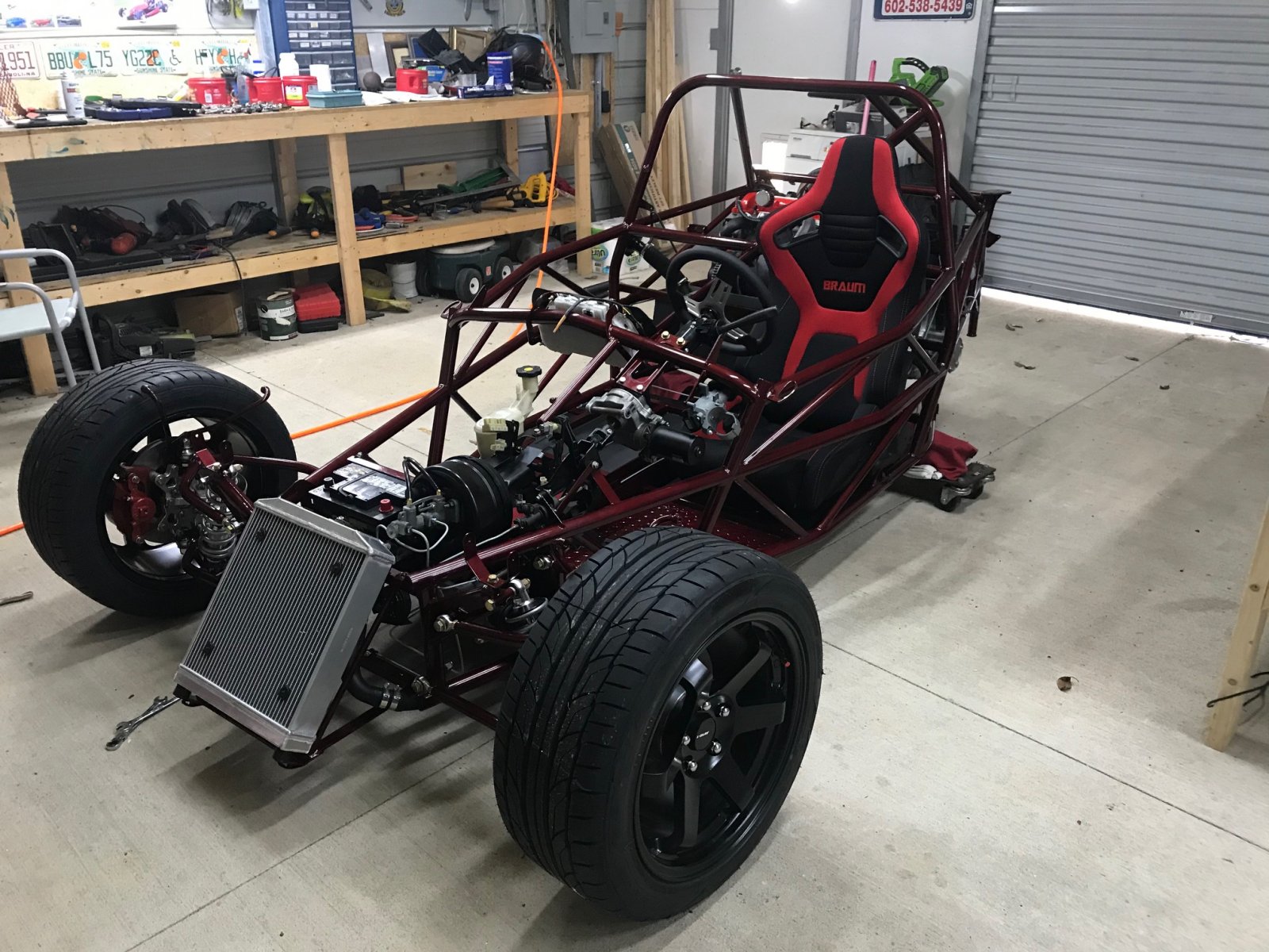

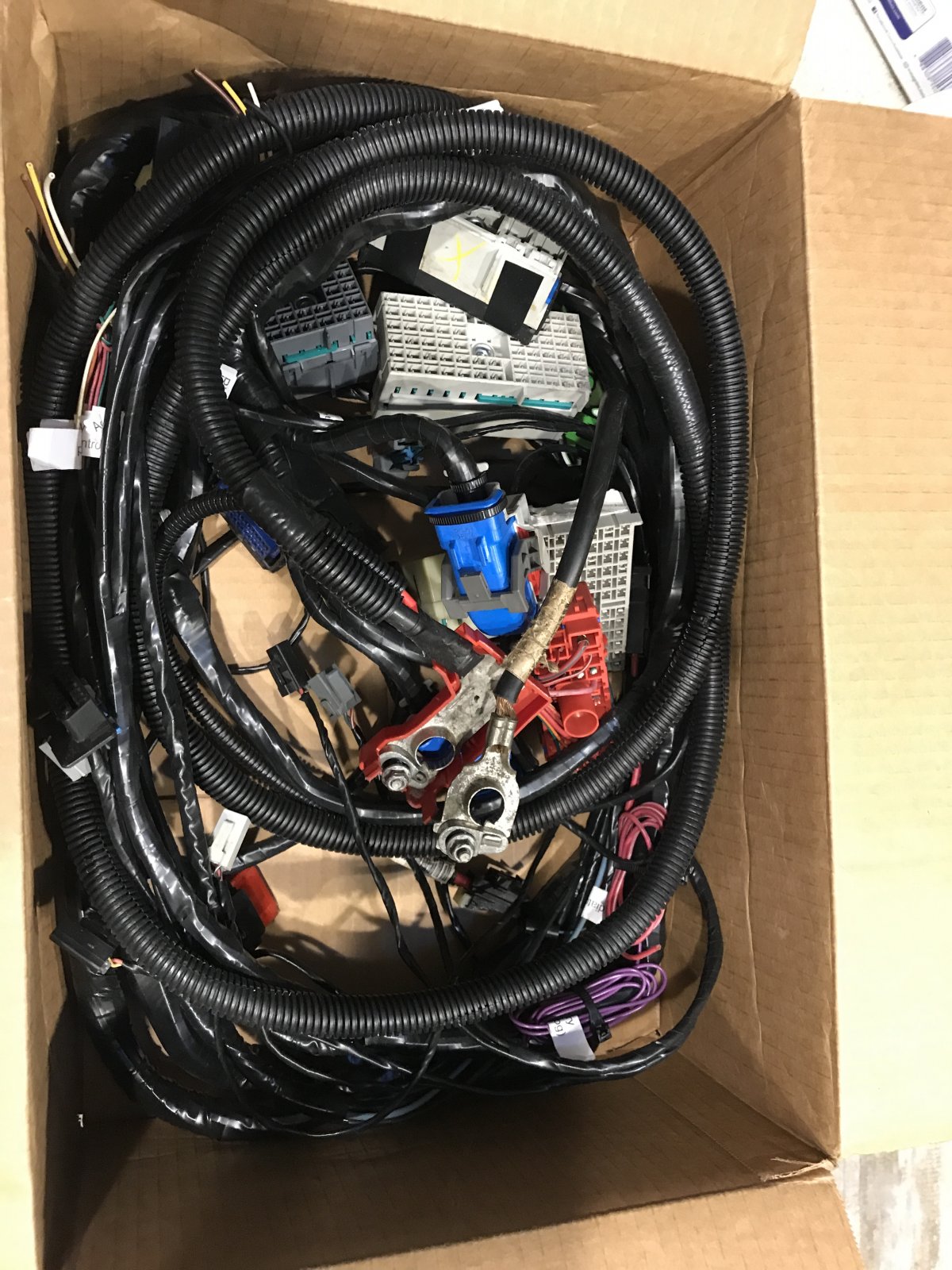

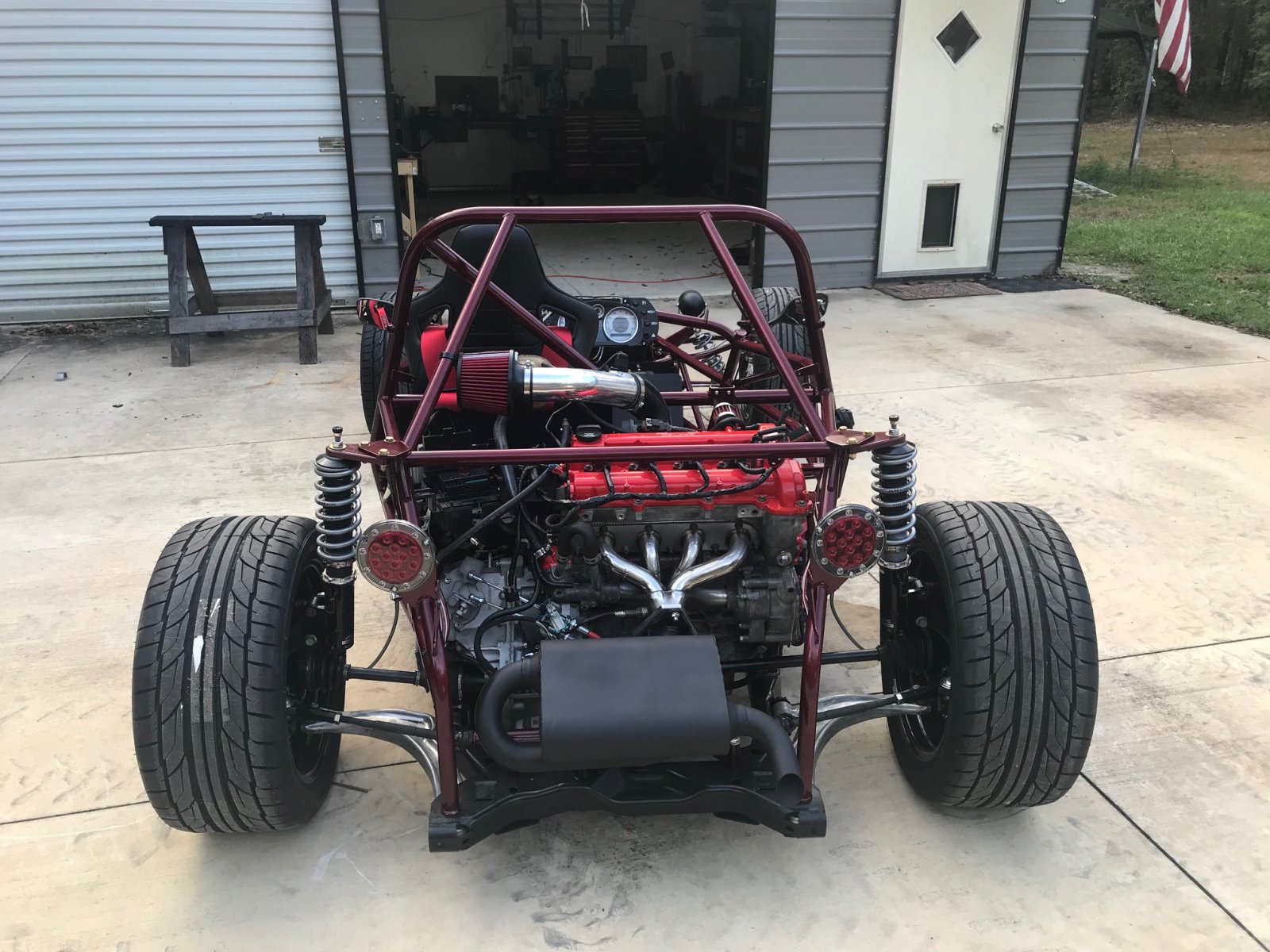

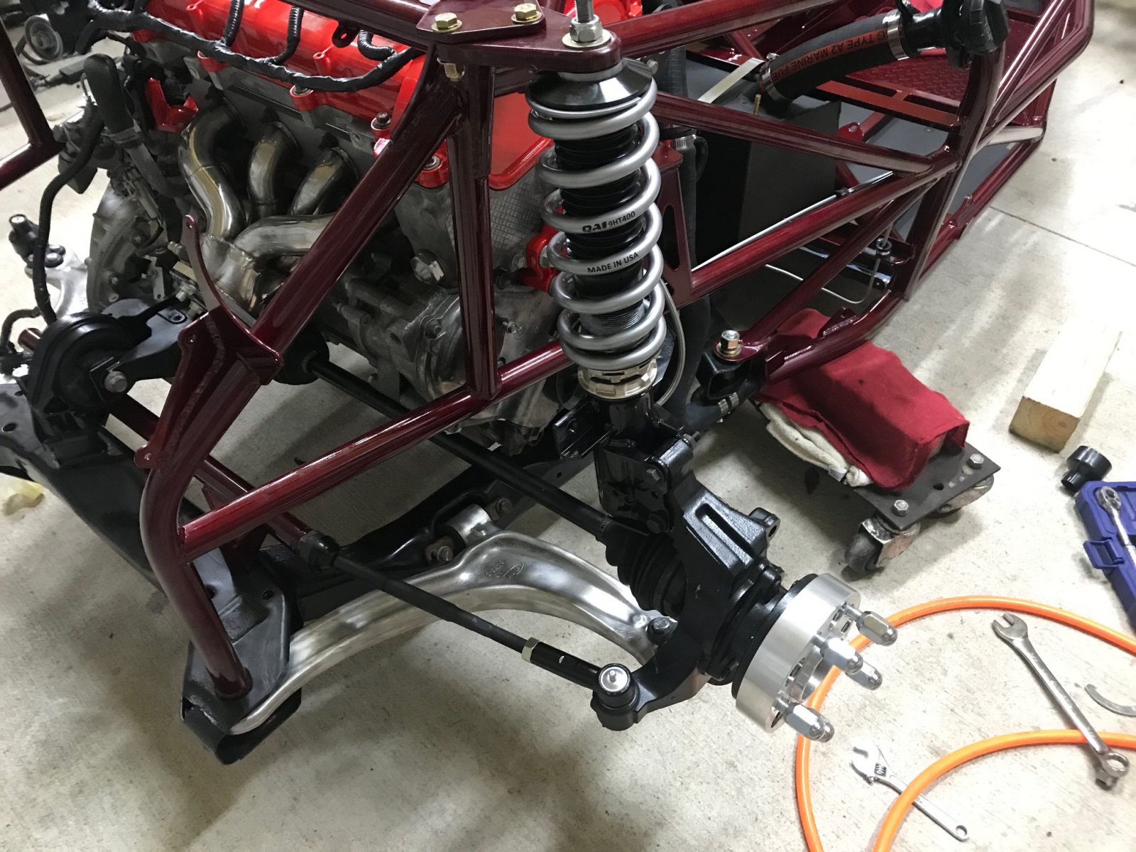

Another day in the books. It does look like a slingshot. Still having to do a lot of things out of sequence since I am waiting on my wiring harness. Also not sure everything on the rear suspension is correct. I put things where it seems to go since I can not find a build video for the rear suspension. By the way some bolts are finger tight, some are loose & nothing is torqued down yet.

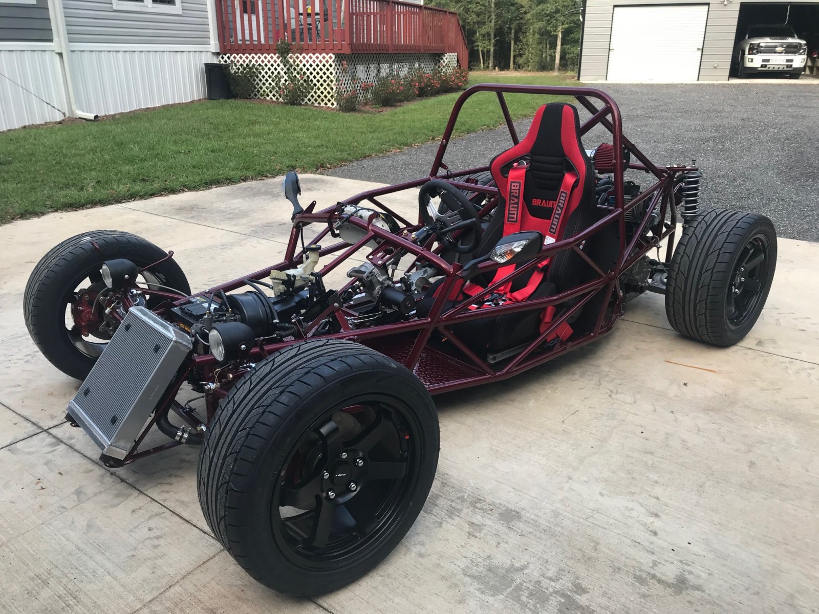

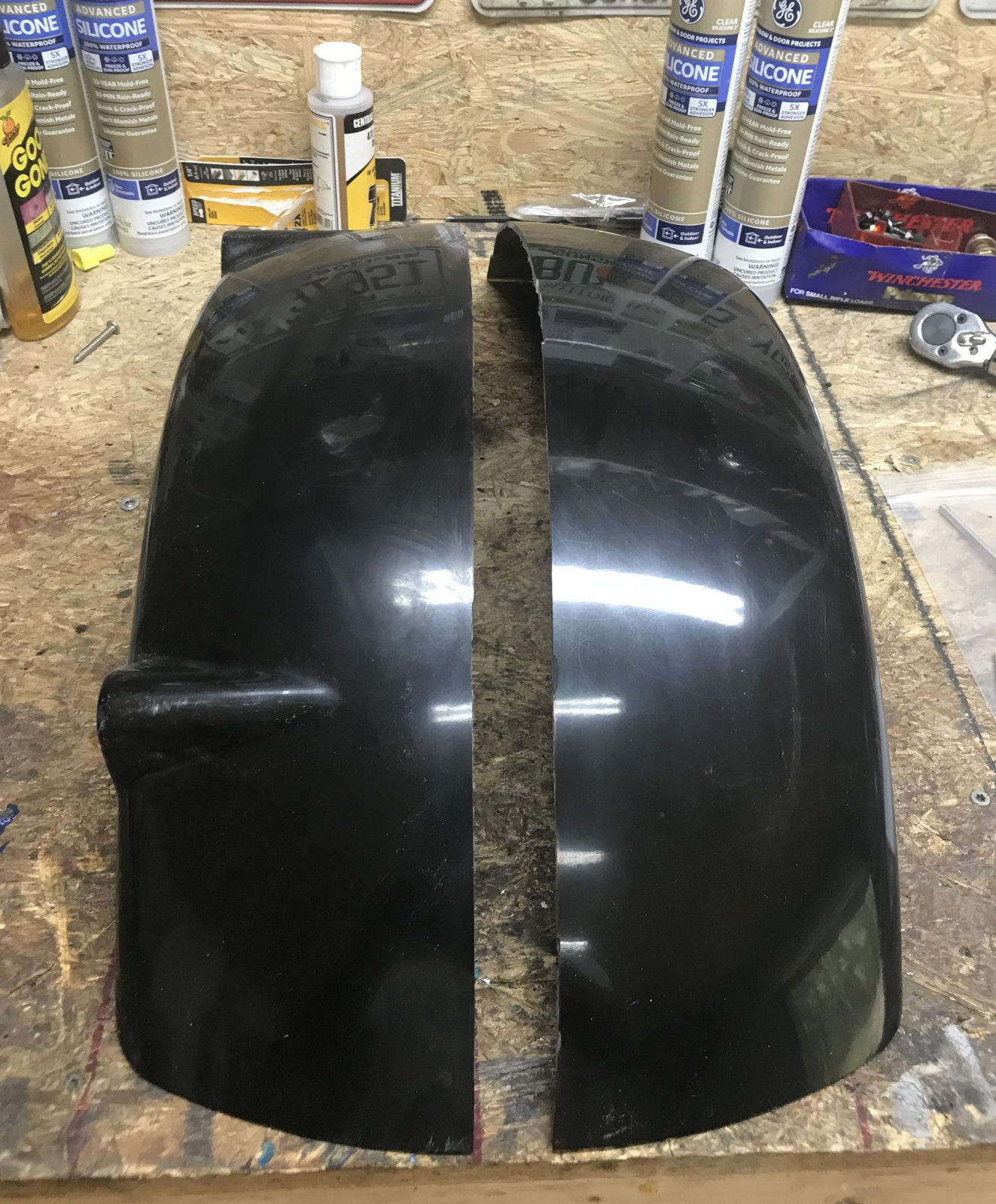

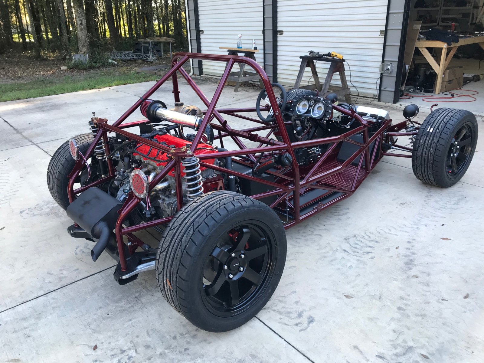

They look great (FAT). Suspension is still not adjusted. Will have a bit of a project widening the rear fenders.

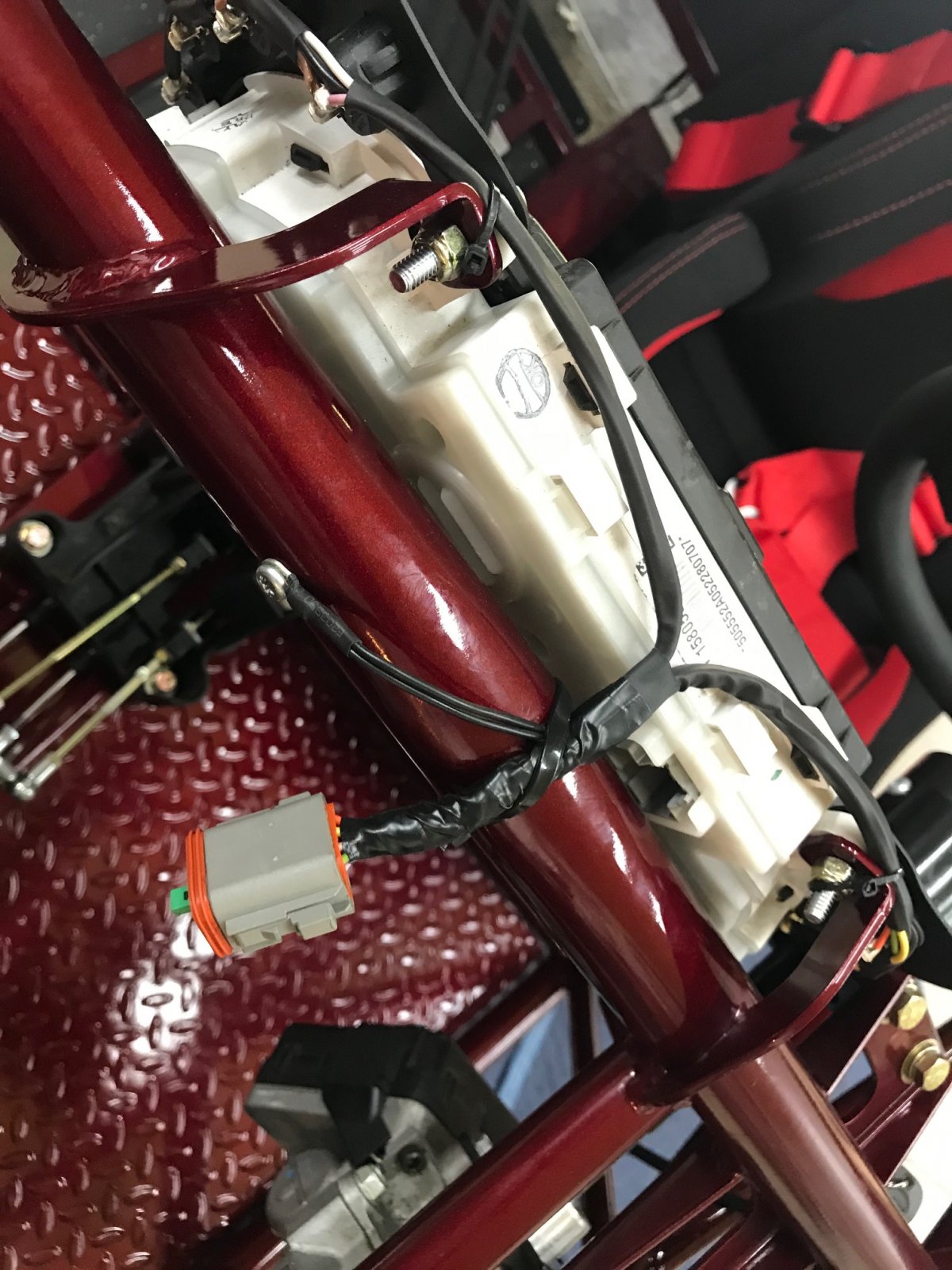

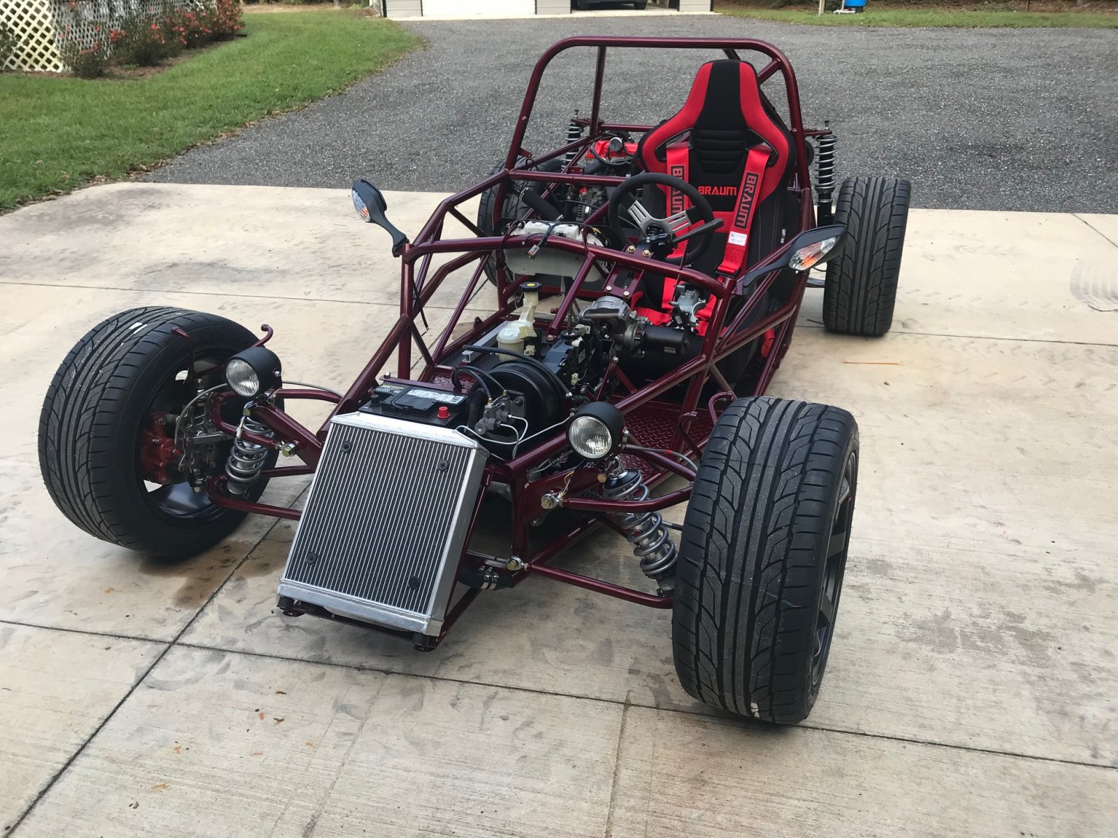

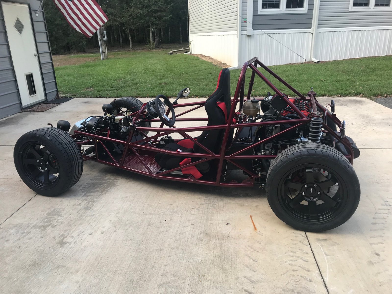

Misc picture update. Tried vacuum bleeding the brakes today. Never did it this way before & not having much luck. Of course a quart of DOT3 went somewhere. Need to get some more tomorrow. Put on a nice, waterproof 8 pin (female) connector to the dash panel. Have to do the (male) to the wiring harness which will be here tomorrow night. Installed the driver seat & wound up adding another 1-1/2 "U" channel to raise the seat up. Installed one set of 5-point harness(s).
