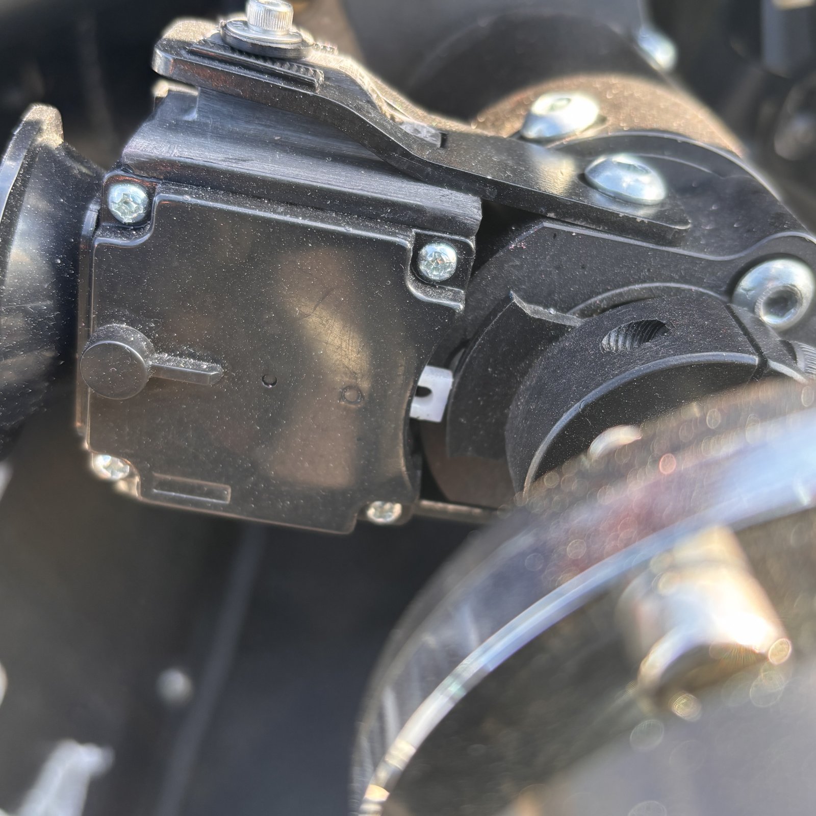

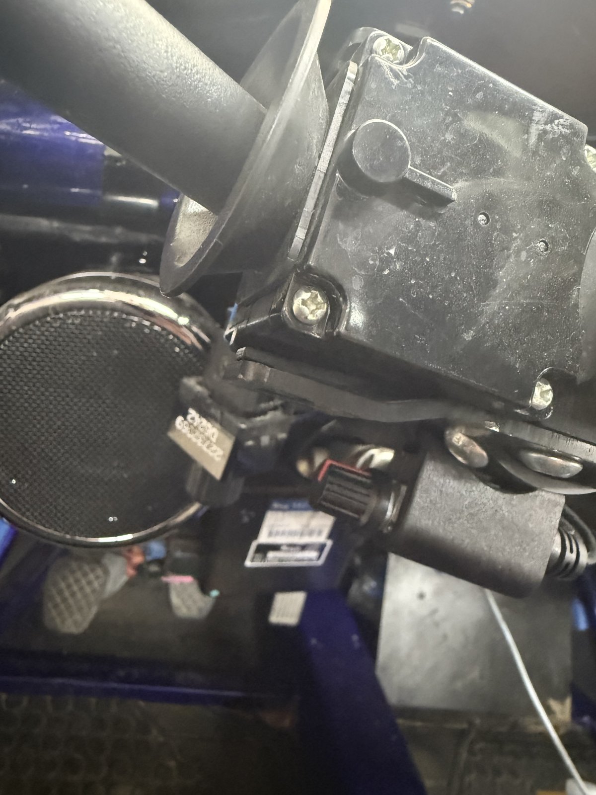

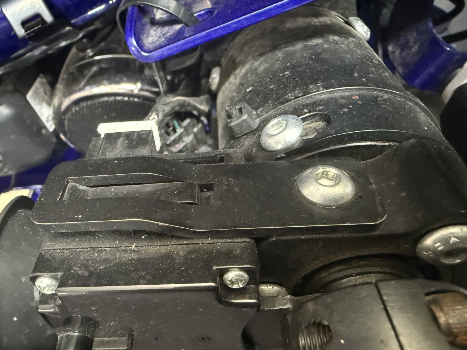

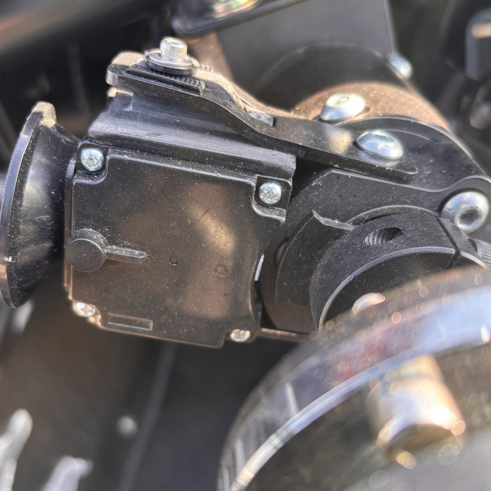

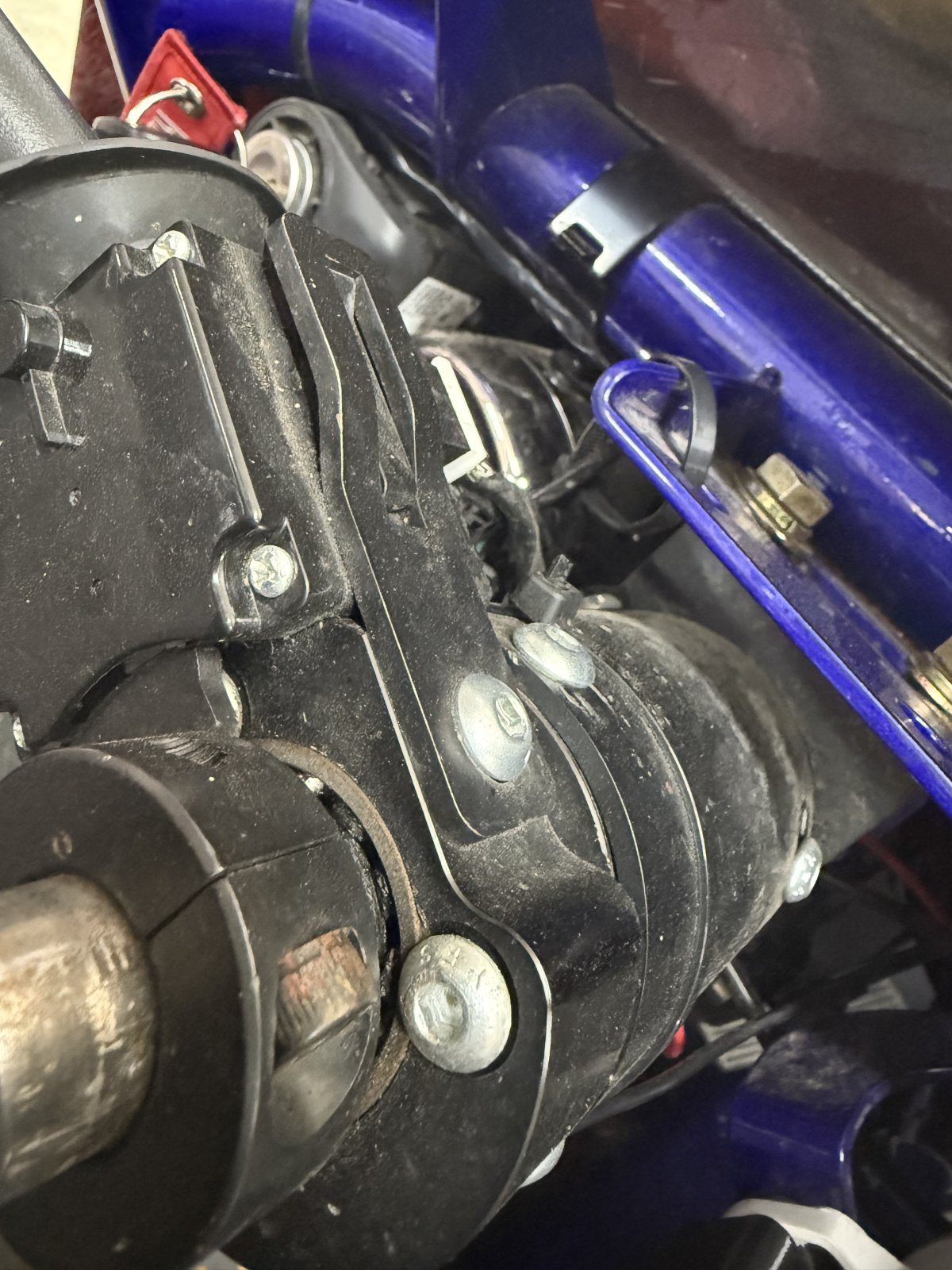

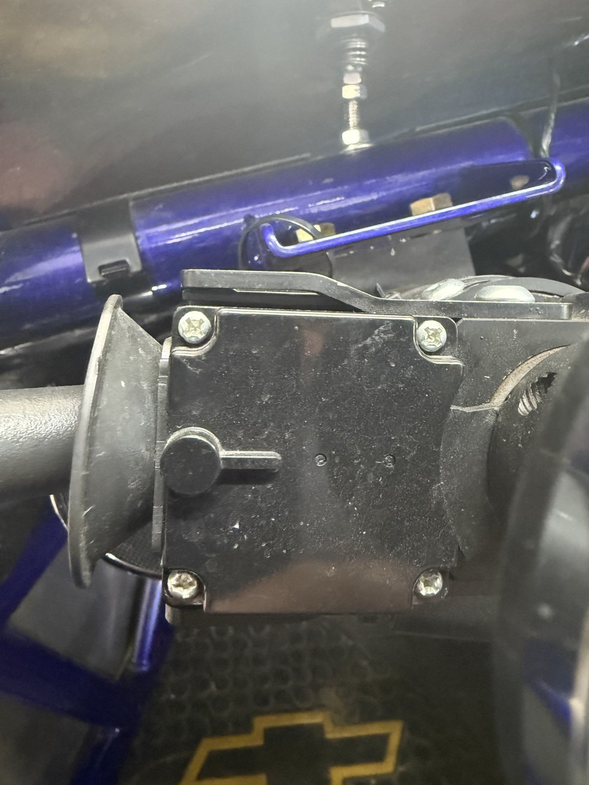

Also side question... My blinker doesnt automatically shut off. It looks like the metal cam thing on the steering wheel doesn't quite hit the white tab on the blinker body. Do I just need to add something to the cam to make it "longer"?
Thanks for all your input guys.
L
Here’s my blinker cancel. The cam basically just touches the surface of the white part.

The switch needs to be pretty much flush against the column and the retaining tabs on the switch should clip into the slots. Your switch is definitely too far away from the cancel cam.

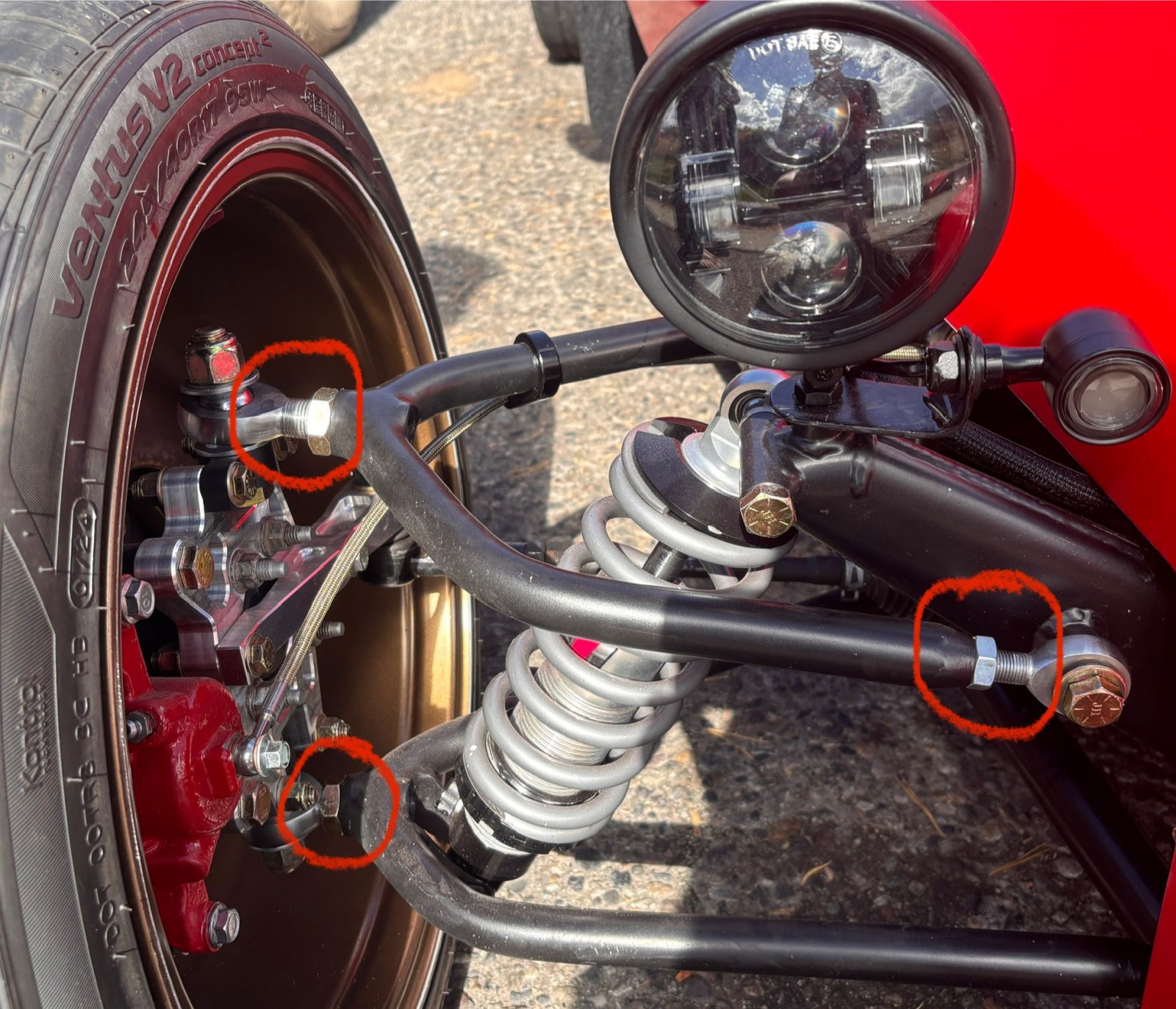

So my boss followed me to the alignment place to have them take a look at the job they did. He noticed that I have a pretty negative camber on the front, he thought my rears looked too towed in, and the car looked like it was crabbing a bit. They can’t see me today so I just took it home. I’ll try again tomorrow. I did take a pic of my front wishbones. You can see that the bottom hiem joints are all the way in and the top ones are out maybe a 1/2” on the inners and outer. Does this seem right? Even with people in the car, it doesn’t seem like it would correct the camber as much as it would need to.
I had to buy a replacement lever from amazon. My OEM was broken. Maybe the design is different? I'll have to check when i get home.

Agreed. We are wondering if they just gave up part way through. I thinks it’s worse than when I brought it to them. I measured my front wheels with a protractor and it looks like I have -4 degrees camber. They are visibly leaning out. The rear tires look like they have maybe .5” toe in? Is the rear track wider than the front? Or is the Front and back the same?
You want negative camber, not positive camber. That's why your tires are leaning out and that is incorrect. This shop has no clue if they set up with positive camber and you gave them numbers for negative camber. Probably why everything looks wrong - because it is - and your handling is off.
