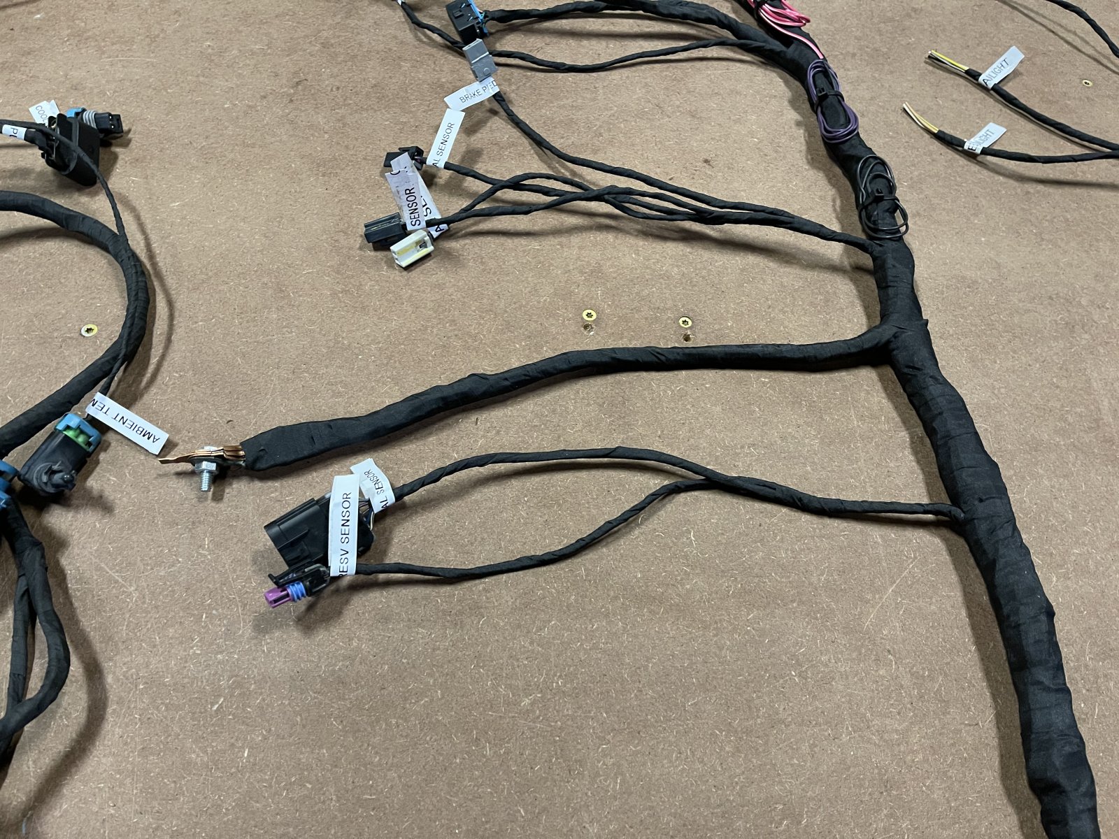

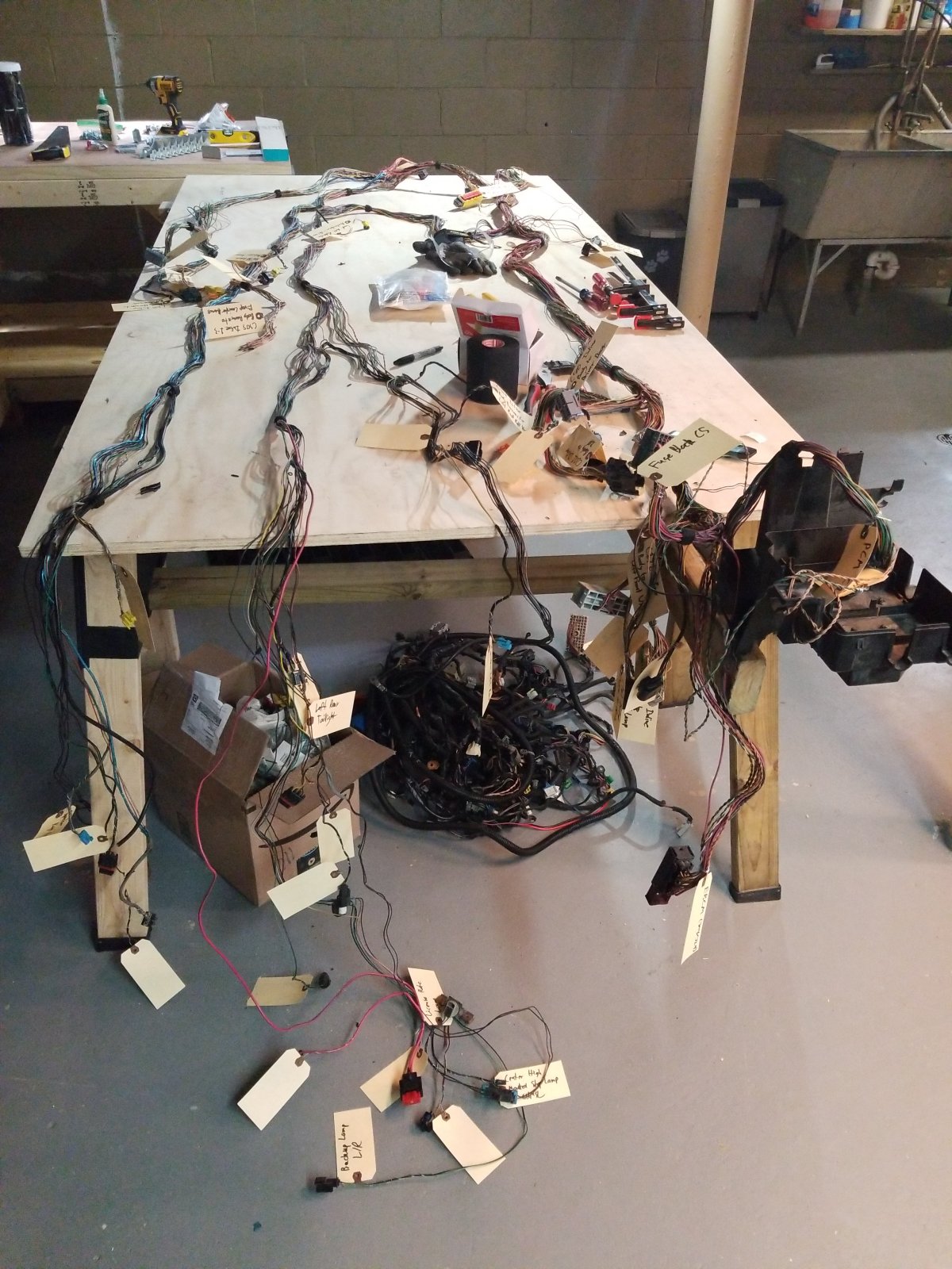

Main body wiring harness connector tagging complete! (excluding a couple two wire connectors that I can't find in the service docs for some reason). I made a spreadsheet with pins, housing & wire color of all the connectors for my year and options, then went one by one down the bundle and looked up in my sheet how many pins and which wire colors to get the right connector.
Tedious for sure, but I feel like I really know the layout of the harness much better now.

Got most of the way through wiring video #4 yesterday, up to thinning unlabeled wires from the I/P connector. It was mildly annoying to unwrap some of the just-wrapped fuse block and ECM plug bundles because they had the thinned accessory power red/white and some of the thinned I/P wires. Overall, it looks so much more manageable now than when it was just the entire unwrapped harness on the table.

Wiring video #10 and part of #11 complete. Connecting and testing some grounds, taping up the rest of the bundles, and that should be it! (assuming nothing went wrong) I will be glad to have this process behind me, and if I had to build another Goblin I'd probably pay for the harness service.

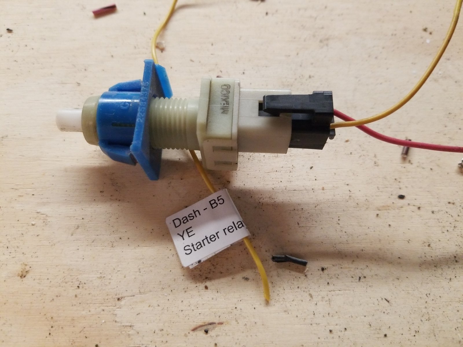

One thing that I have not figured out yet is where the starter relay connector gets taped into the harness (see attached photo). I have both labelled yellow wires and an extension to connect them, but I didn't see (or maybe I missed) a spot in the videos where the yellow+pink wires to this connector get placed and taped up into the harness. Anyone else know where this gets taped in?

That looks like it came from the clutch pedal. Starter relay would tell me it needs to be engaged for the starter to work, so it’s most likely the bottom switch on your clutch pedal. There should be 2 plugs on the clutch pedal

Not sure what that is but don’t look like a relay to me. It looks like some sort of switch. Not something used on the turbo that I recognize.
Thanks for that help, guys. You are both correct, it appears to be not a relay itself, but a starter relay control/enable switch. The GM Service Manual says B5 is:

I'll go back through the videos to find the clutch wire section.

Just up from the grounds, I have 4 connectors. 2 are clutch pedal switches and other 2 are brake pedal switches. One of my clutch pedal switches are the same as yours I believe, and has to be depressed in order for the car to start. I have a 2007 SS/SC.
Hope this helps.

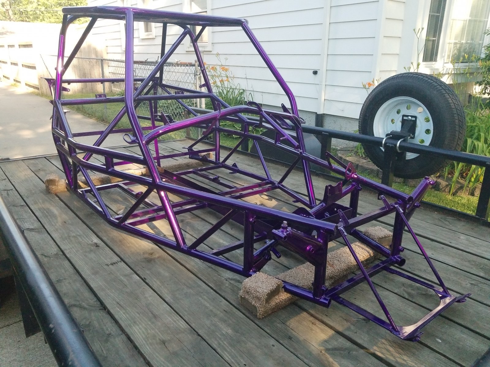

Frame is still at the powder coat shop, but he sent me a photo of the subframe in the final color and it looks great, probably even better in person I assume. I'm partly done with the preventative maintenance on the engine. It's really nice having it on an engine stand to work on. So far:

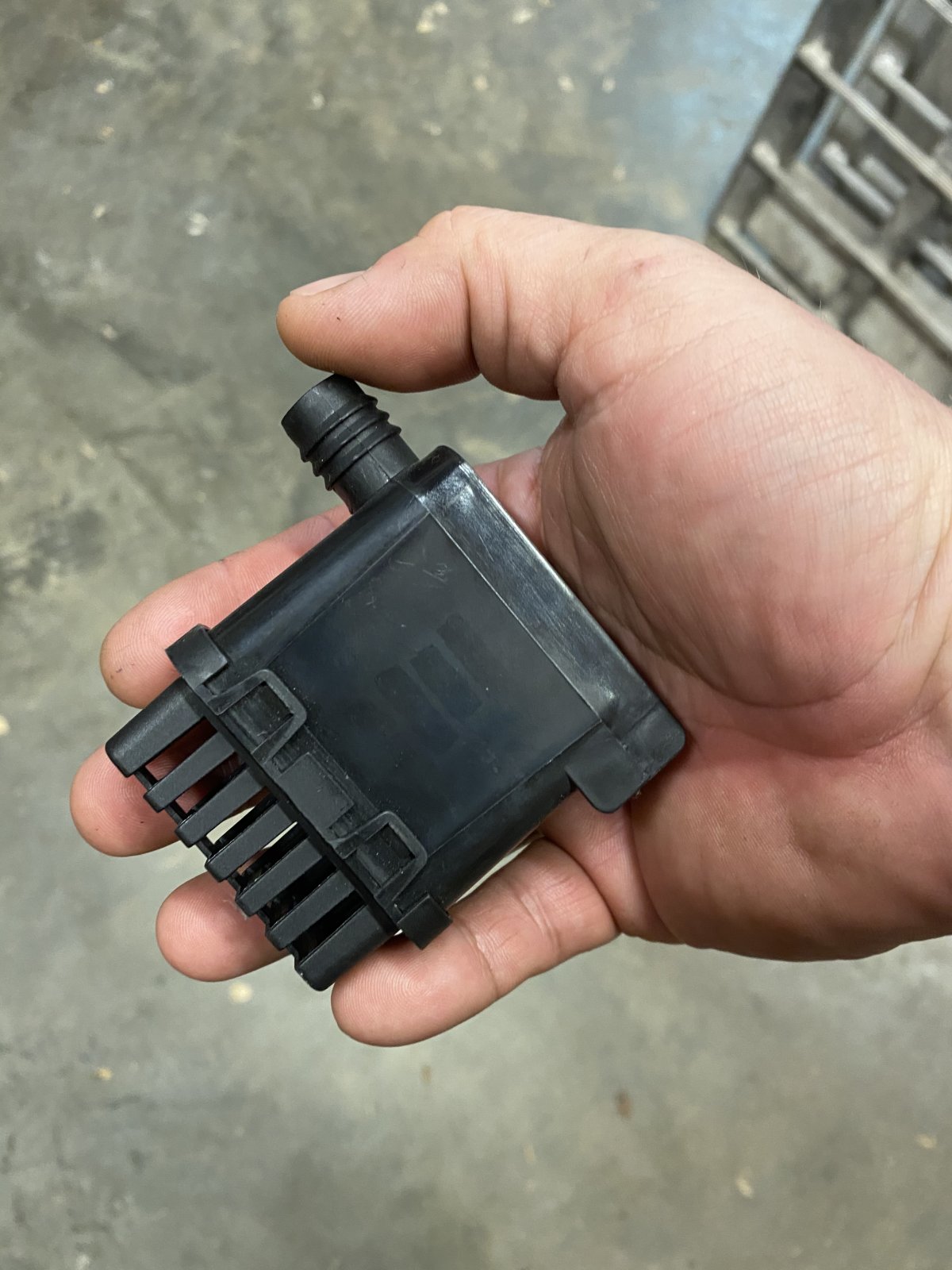

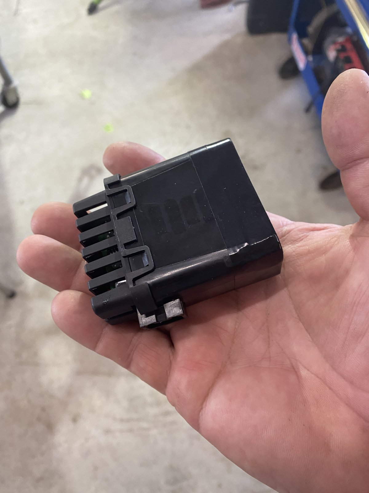

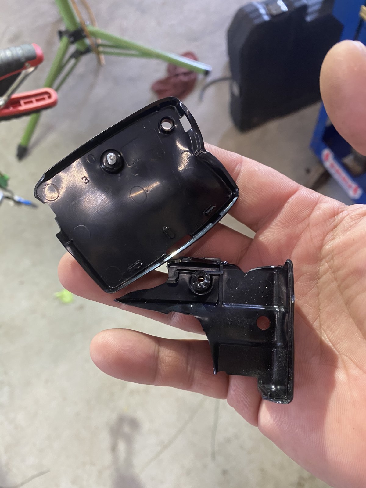

Putting the TPMS box in, the whole plastic enclosure started cracking in my hands as I handled it. The retention tabs snapped off immediately, even the corners and edges of the box started to come apart. For now I duct taped it back together and zip tied it to the bulkhead. Maybe I will find a junkyard or eBay replacement, maybe it'll just be left there.

My TPMS cover turned to dust when removed it from the donor - the base was still intact. I bought a small electronics 'hobby' box to install it into. I think this is the one I bought, but any one similar will work. :D
neodied
Yep, that just about describes it. I saw that it had cracked from my disassembly and so I was trying to be careful and it still just disintegrated. Some plastics just aren't meant for long term exposure...

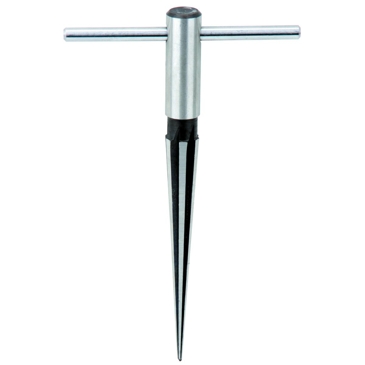

Now attaching the harness ground lugs to the pedal box tube ground stud, and none of the lug holes are large enough to fit over the stud. Tried enlarging the hole on one lug with a drill bit, but when the drill bit caught it tore the lug out of my hand and off the harness wire. I can probably solder that wire onto its neighbor in the lug bundle but need to figure out a better solution for the remaining too-small lugs.
Edit: I think a manual reamer is what I need to enlarge the lug holes. Shouldn't be too tough.

Yeah, after tearing one of them off accidentally I don't want to push my luck too far. I'll pick this reamer up at Harbor Freight and give it a go. Pretty sure this is a perfect use for it.
Edit: Reamer worked perfectly.
