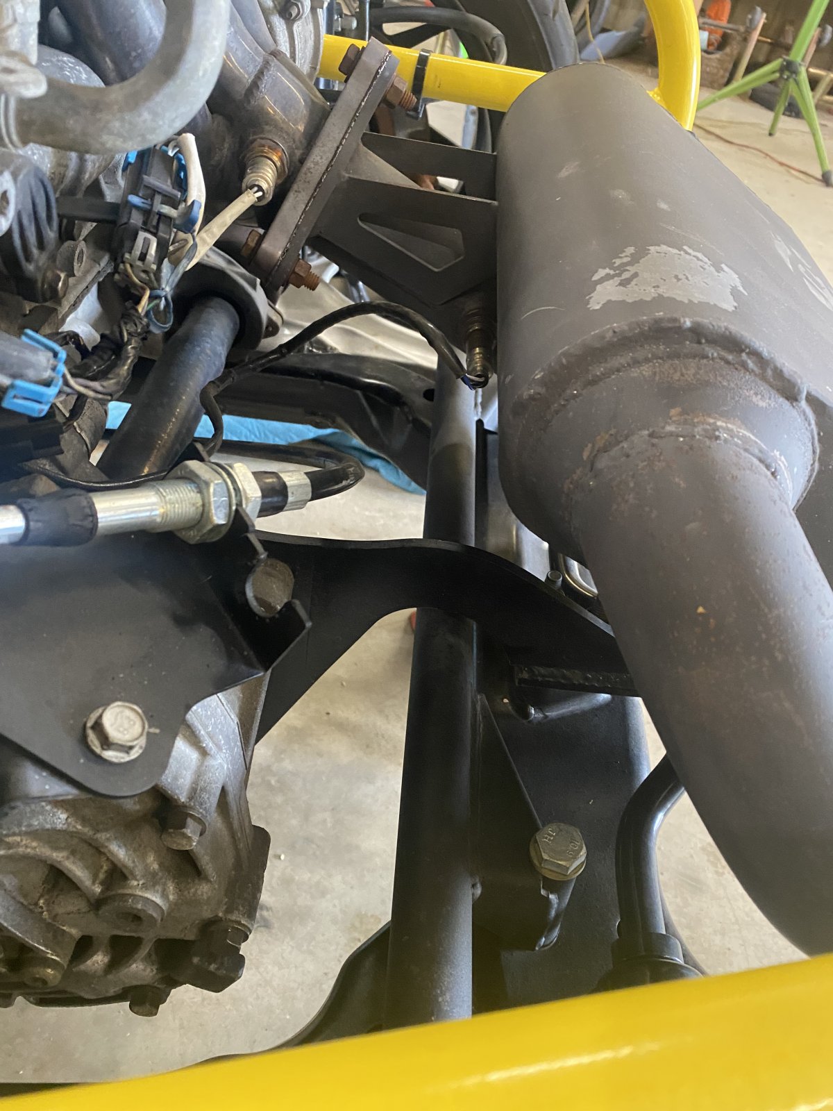

Yeah mine go behind the toe link bar and subframe. Definitely wrong on my end, but I think I got nervous about the bend radius and the extra length dragging on the ground under the engine/trans when I test fit them running forward of the bar and subframe. I should have been more nervous about the exhaust obviously.
Anyway, I got almost all of the Stage 3 parts today, just missing the button panel kit (and my add-on quick release steering wheel) which are backordered. Installed everything except the boost gauge and the wiring all works, which is a huge relief.
