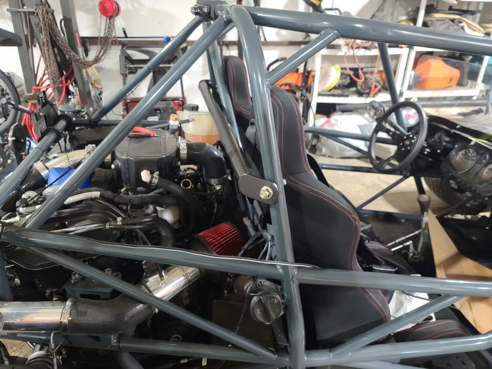

All I need for a 'round the block trip is steering and finalizing the seats. I seem to be missing some part of the "normal" steering wheel assembly but I decided to order the quick release wheel and connector anyway with Stage 3. I am a big fan of the dual overhead frame bars which helped me getting in and out, and adding the detachable wheel will help even more.
I am a 6'3" dude and felt strangely small but also huge sitting in the seat. I had to move the buckets all the way forward on the stock seat brackets just to get close to my preferred leg position, and I feel like it would be even better a bit more forward. But then my head had maybe 1" clearance from the top of the frame, no way it would pass a broom test with a racing helmet...
Once I get the seats fully mounted and do a few shakedown runs I may want to move it more forward and lower if possible. Lower will be tough because it looks like there are mounting point bumps on the bottom of the seat that are nearly touching the floor already.
Final note is that the height of the harness shoulder belt cutouts appear to be several inches higher than the frame behind the seat. I think the cutouts are supposed to be in line or slightly higher than the harness mount point. I remember messaging DF support before ordering, and asked about that positioning and was told it would work. Not sure what to do about that, I really really don't want to scrape off powdercoat and weld another bar in at the correct height.

I had the same problem. Harness bar is too low. It should be just below the opening in the seat back.
I'm 6'1" and wouldn't pass the broomstick test, so I welded a raised X Brace.
Mahkoi
I made a bolt in bar from some scraps that were hanging out in the garage. Same idea as the one above but a little different.
My driver's seat has a 3 point and a 5 point in it, so I don't have to mount the 5 point harness when racing. The passenger side only has a 5 point harness.
Mahkoi
I'd have to double check but I may have enough pipe for a second bar if you're interested. Its pretty ugly looking but a flap disk and a rattle can make it presentable. No idea what it's original purpose was but the previous owner of my house left all his scrap steel in the garage so I'm fine donating it to another Goblin. It's some pretty thick walled stuff. I just held it in place. Used the eyeball method to draw some lines on it at the angle I should cut it then welded on some 1/4in flat stock (also left by the previous owner). Couple of holes and a hardware store run for grade 8 hardware and it was good to go.
