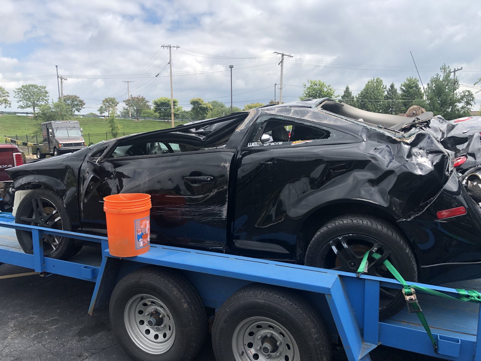

What’s up everyone! I’m home from Philippines and missing my goblin, what can I do about it? Build a new one!
Going for pure stupidity this time 350-400hp 50shot of nitrous.
My brother picked up my donor today 102k miles already stage 3 dyno at 380whp on the sheet.
The donor is a little rough but for 1000$ what can I say!
Look forward to being active and building 2.0, looks like you all got it easy these days
Nuker-

Just noticed in the picture, I recognize that weird Harley logo converted step van in the back ground. You pick up that car in O'fallon MO?
It's nice that people go out of there way to supply great donors for Goblins.
