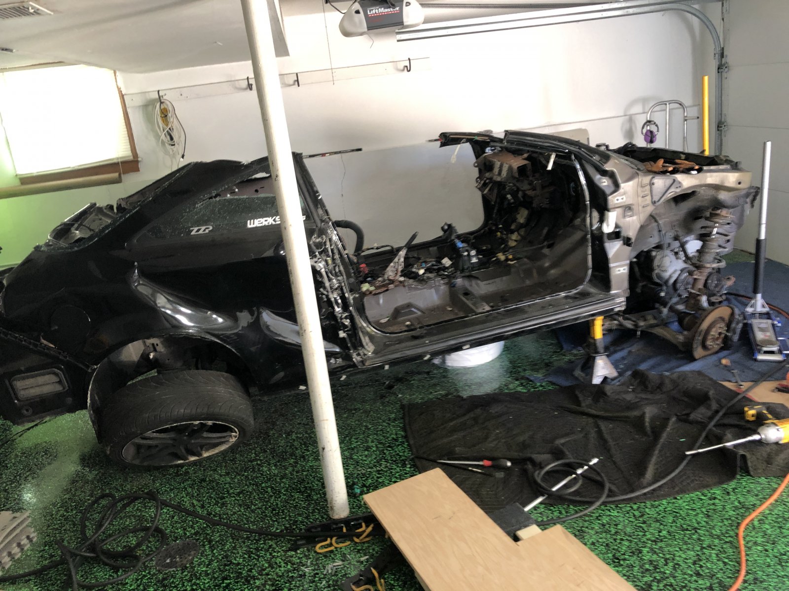

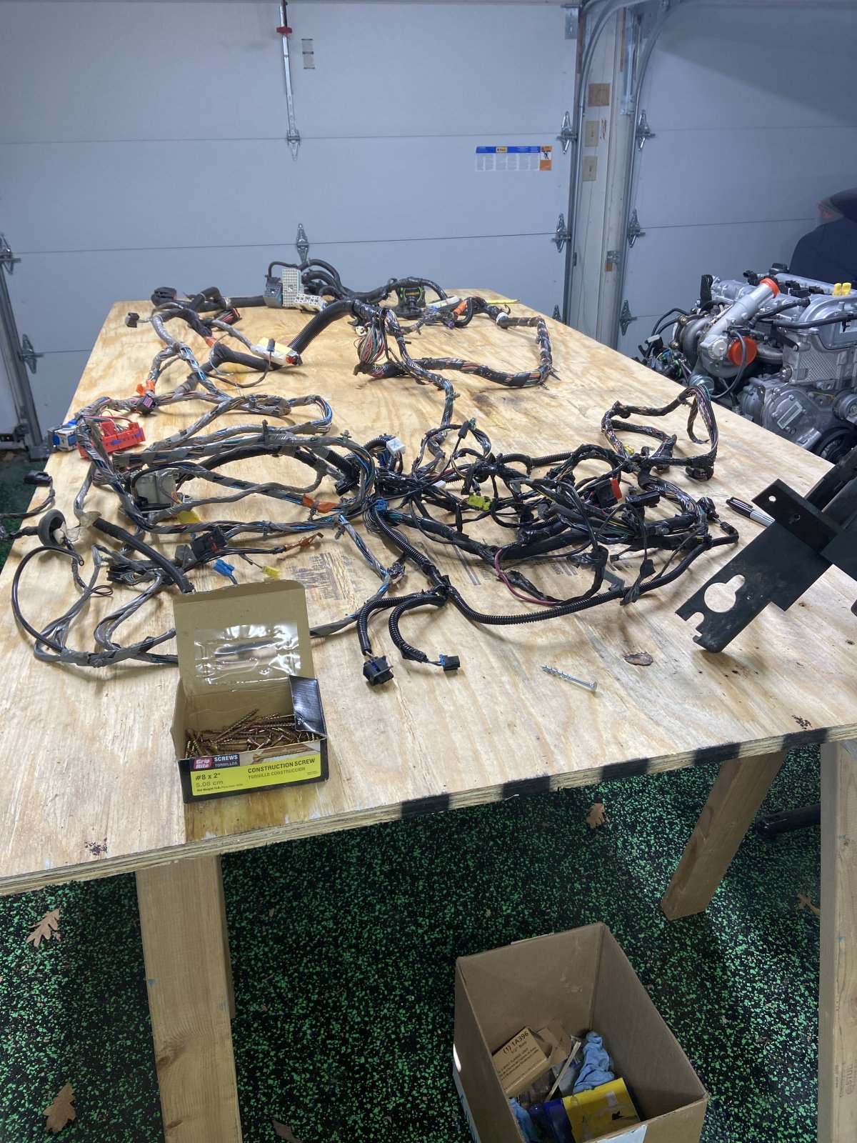

2 Days of take down and we are basically done! Adam where is my frame!!! hahaha

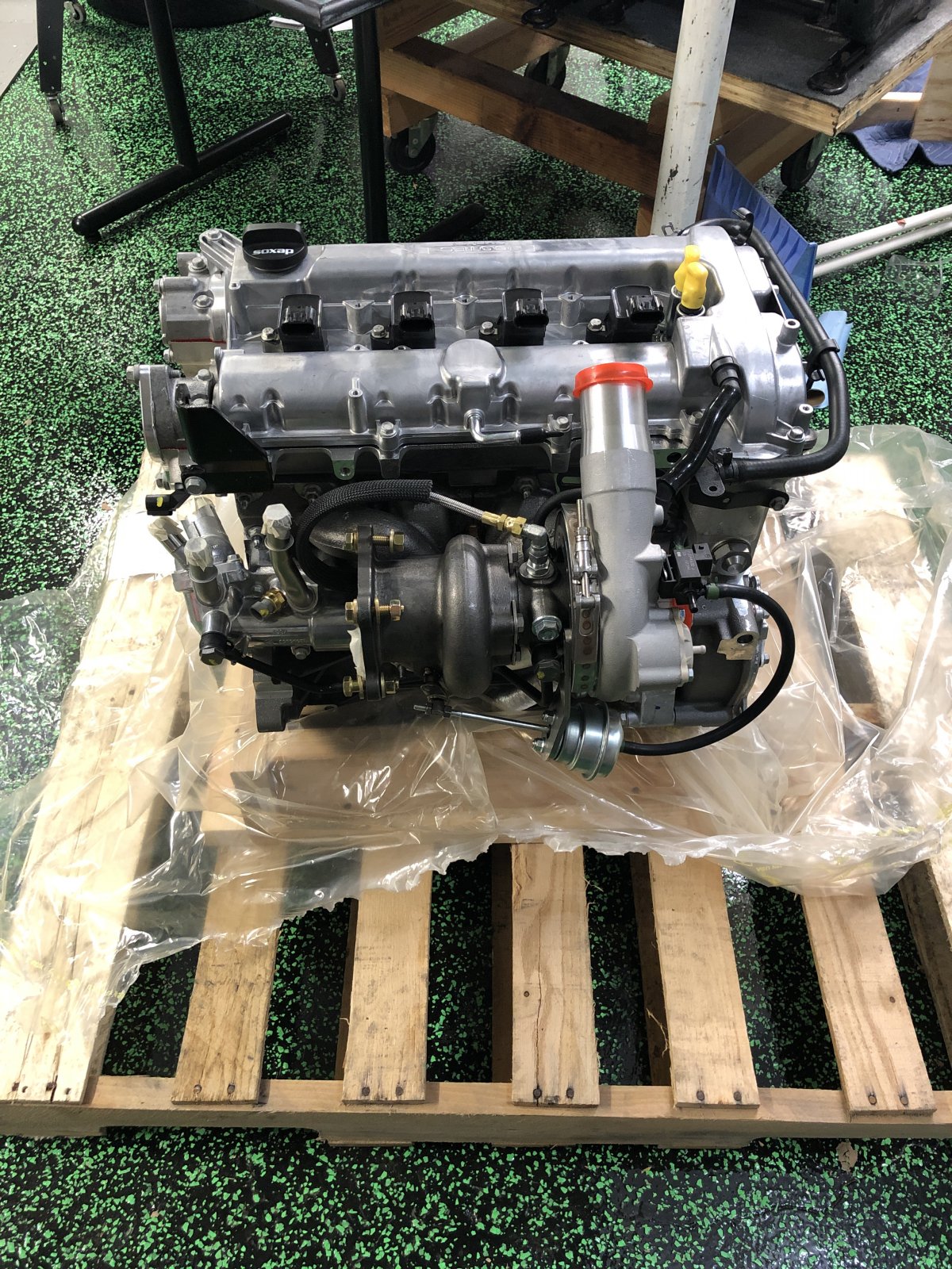

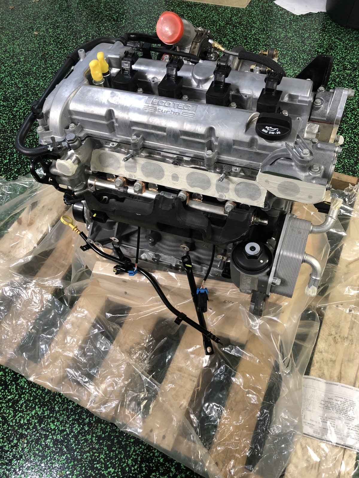

Any idea what I might be able to sell my donors full LNF engine for? It has like 102k miles Everything except the wiring harness for the engine. No transmission, As I need that.
Nuker-
Without trans, they seem to go for about 500 (assuming the engine is healthy) on FB Marketplace. You might be able to get a little more, because that's not terribly high mileage.
*edit* I believe that was mostly for SS/SC engines. Could start at $1k and come down from there if you need to. Don't worry, if it's too high, the 20-something male demographic on FB Marketplace will let you know, post-haste.

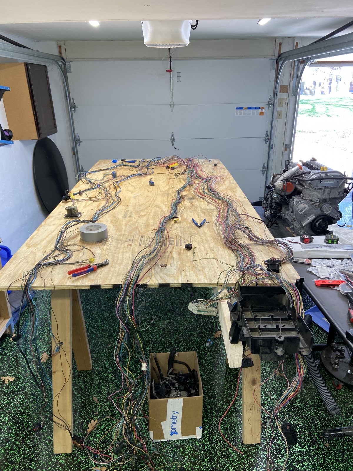

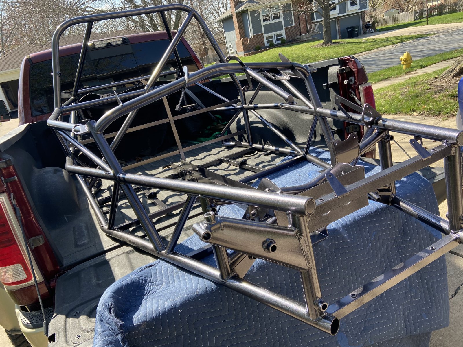

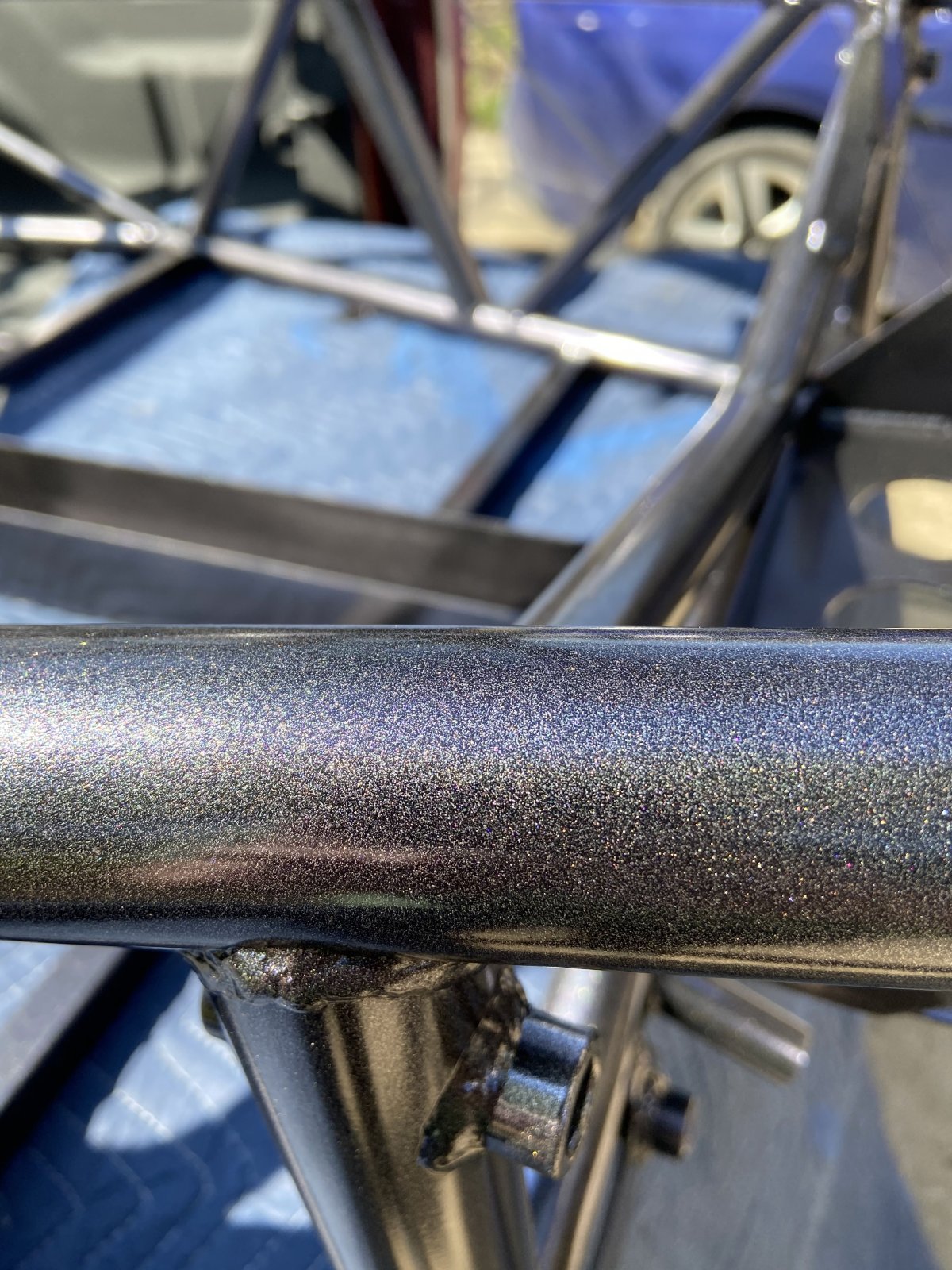

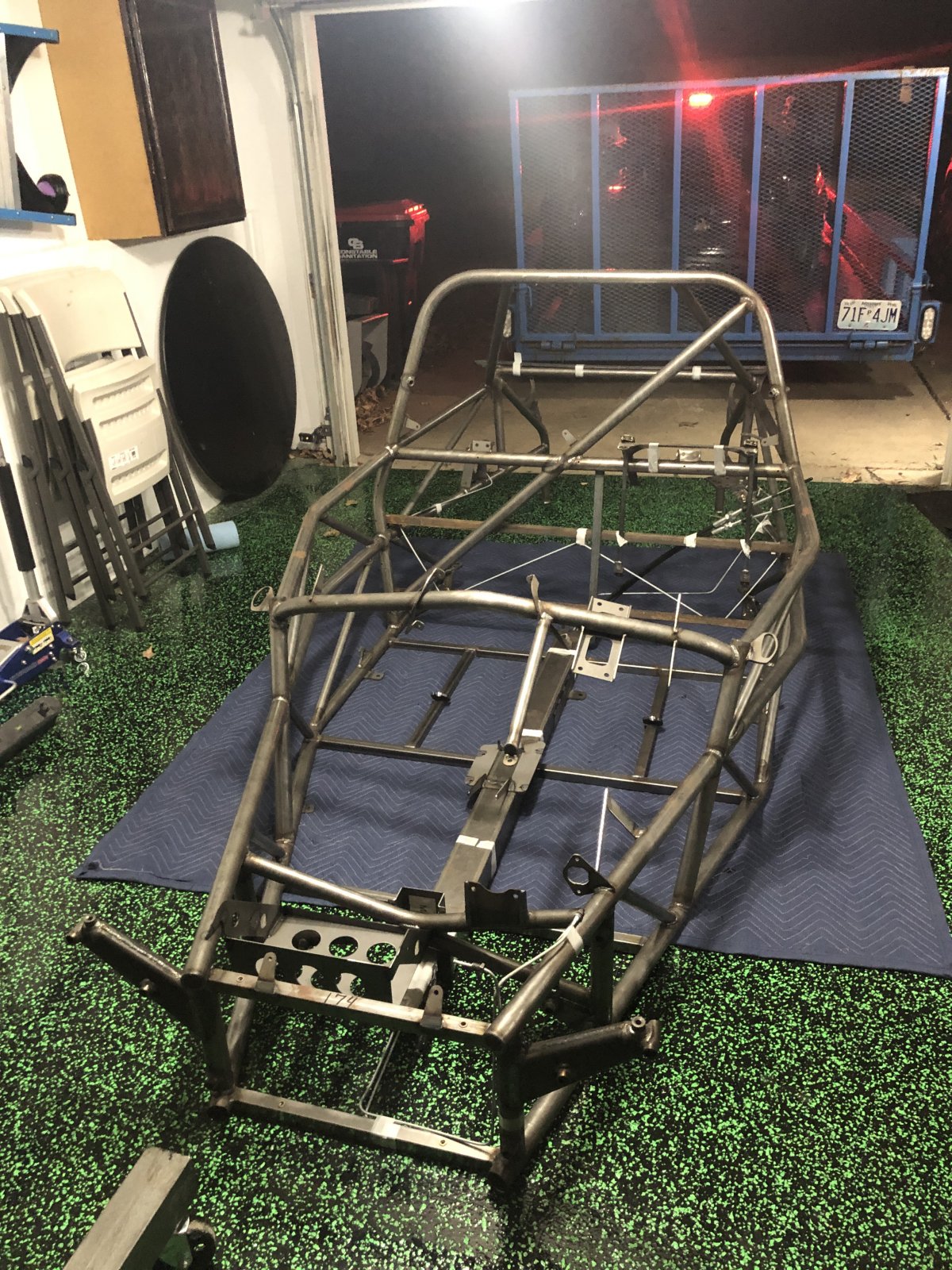

Got the frame back from powder coating today! Looks great. My brother and I got about 1/2 of the wiring done. Hopefully can finish it tomorrow.
Its a prismatic powder cosmos black
455$ for the frame/motor mounts foot kick plate and about 8 other misc parts with sand blasting.

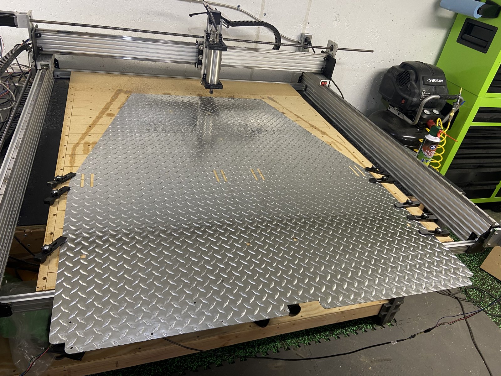

OK. You can not post that picture with out details on the CNC table.
Haha It started as a workbee that I never liked. So I cut some new aluminum plates and upgraded to all linear rails much larger motors a 1.5k watt water cooled spindle and 1/2" acme rods vs the 8mm that come with the workbee.
I'm really happy with it can do about 40 inches per minute at .3mm per pass in aluminum and 250ipm and 1/4" passes in woods.
