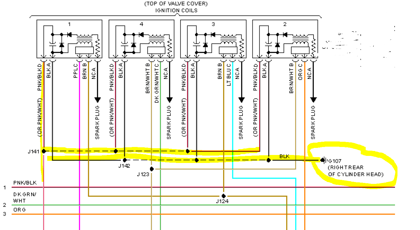

To test for spark, use a jumper cable. Clamp the metal body of the plug in the jaws and the other end to a good ground point on the engine. Then have someone crank the engine while you watch that plug for spark.Okay I'm going to plan to attach a copper wire wrapped around the spark plug to a bolt in the block tonight and see if it sparks. If it doesn't what should I look for next? I tested tons of points with the multimeter on tone mode all over the head to the block and it seemed solid. This is the craziest thing. Fuel pressure was reading about 75PSI on the Schrader valve so I think that is all good. I have no way of measuring the HPFP side.

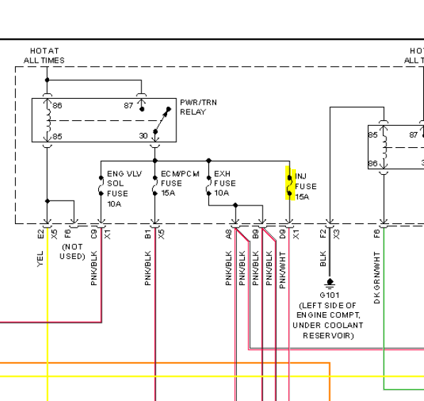

Check the 15A INJ FUSE. If I'm tracing the diagram correctly (it's hard to read), that should be power from the powertrain relay. And that goes directly to the coil packs. They should have 12V on them when the PWR/TRN relay is turned on.@ctuinstra
Next update, I have put pins into the black/pink and black ground wire on 2 of the coil packs and neither are getting 12 volts while cranking.
I have checked continuity between the black ground in the coil pack and 5 random spots on the head/block and it is giving me a solid tone.
