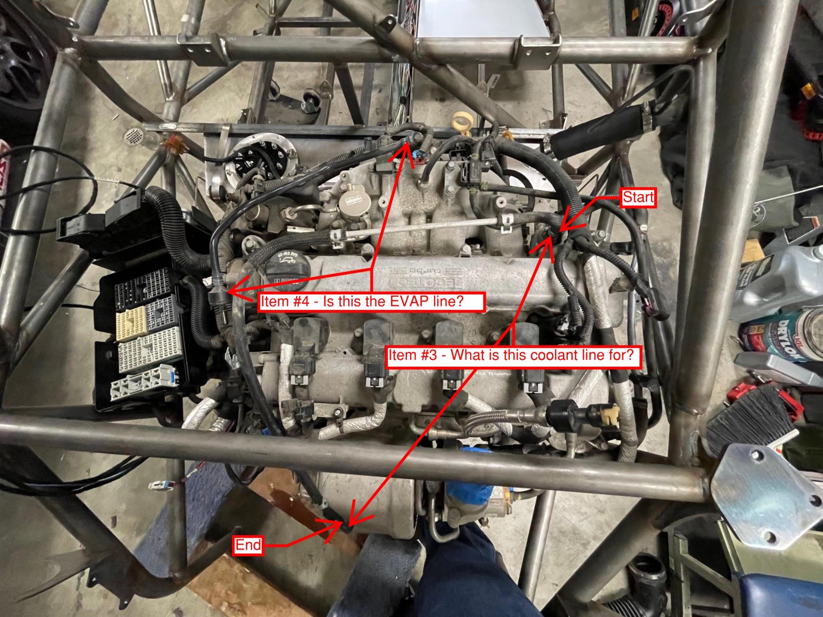

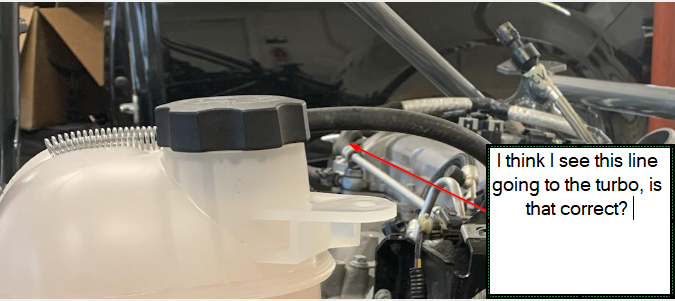

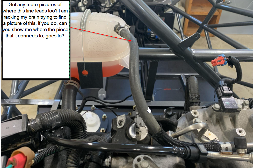

Do you happen to have any more pics of the coolant tank setup? Side note, did you order a new one, (link if ordered please)? It looks great! Or did you clean it (what did you use)? This was as much as I could find:
this picture should help http://dfkitcar.com/forum/index.php?threads/coolant-mounting.4077/post-80950
the coolant reservoir part number for lsj and lnf cars is 15218663 if you want to search around for a new one, but it looks like a lot of places are currently out of stock.

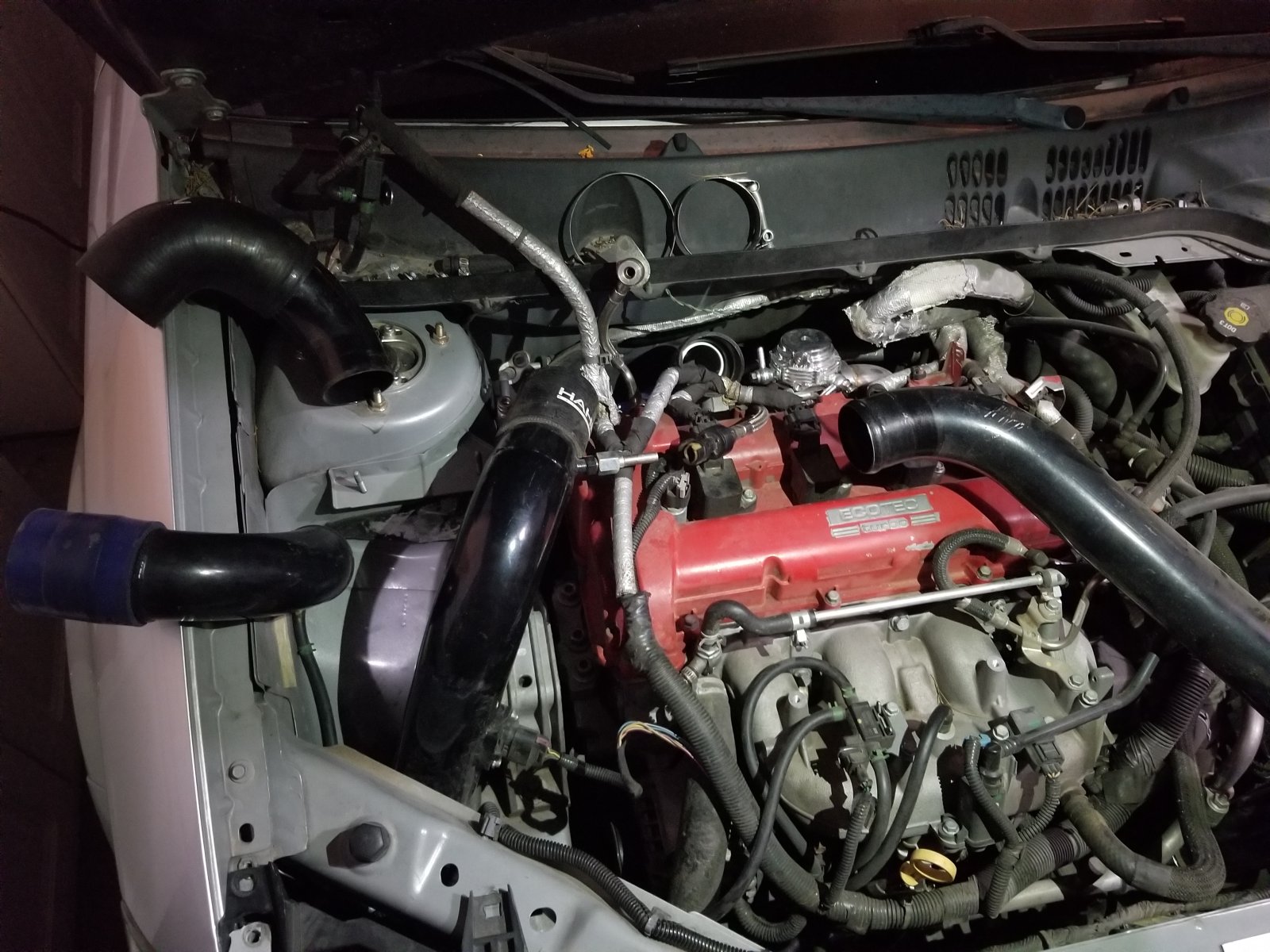

this picture shows where that coolant line goes to pretty well. #3 in the labeled picture.
