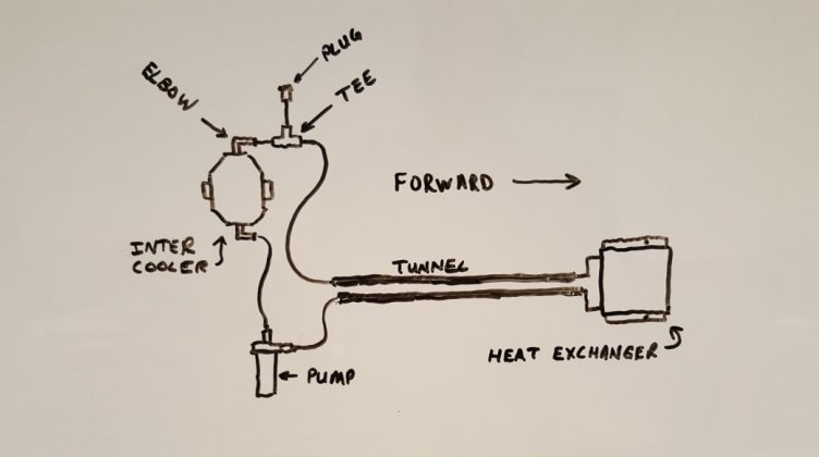

  1. Anyone have directions/pictures of the intercooler pump mounting and hose layout?

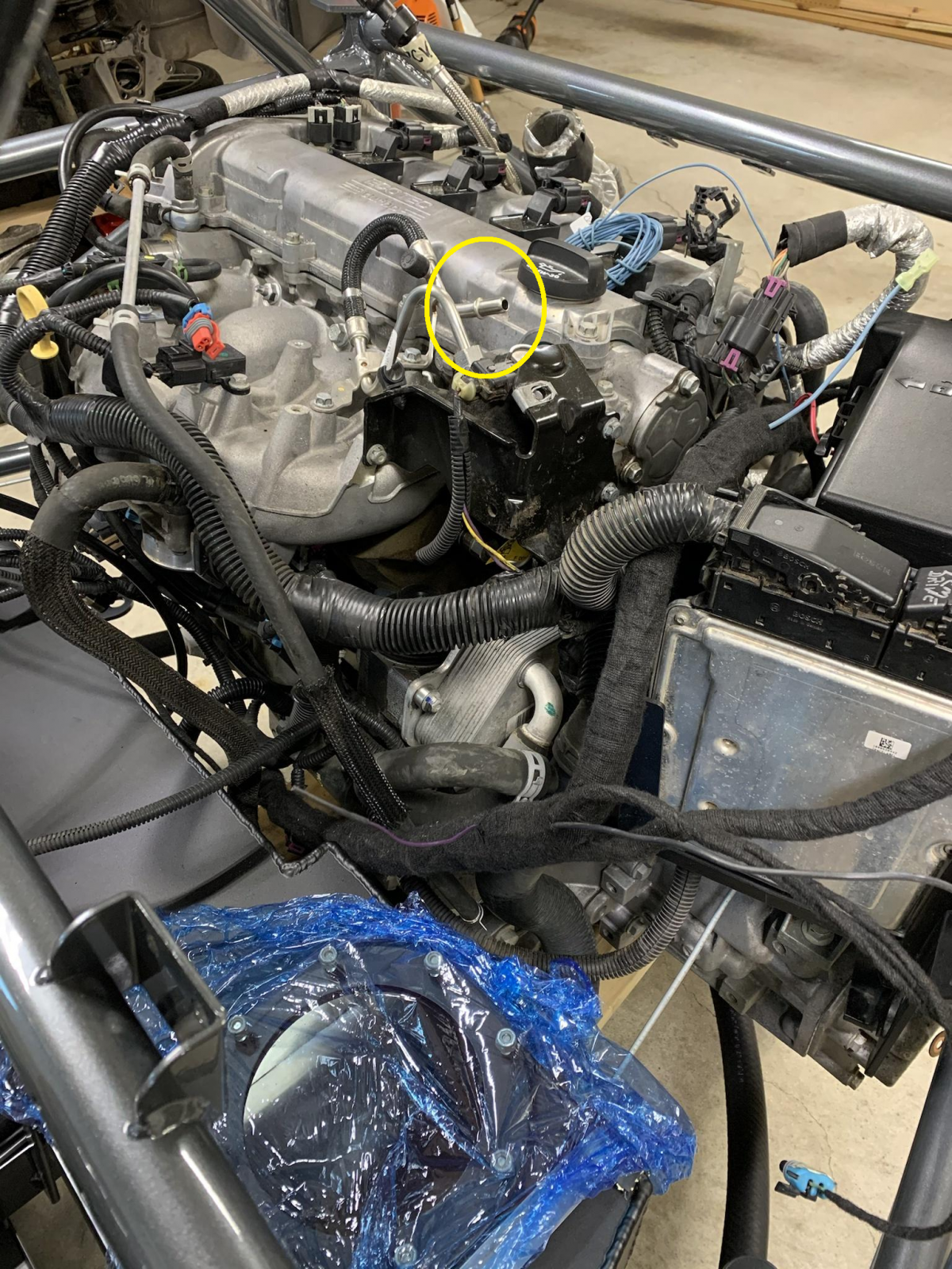

  2. The intercooler brackets hits the hard fuel line and vaccum selenoid on the intake manifold. What am I missing?

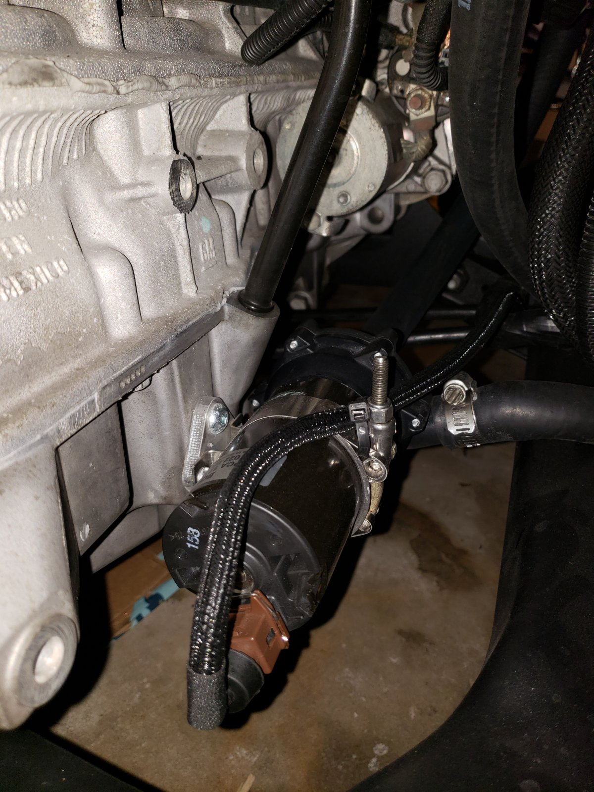

  3. How do the fuel lines run on the 08 SS/TC LNF since there is no external fuel filter?
  2. I think you might have the brackets misaligned/backwards. Mine were a tight fit against the vacuum lines, but definitely did not hit the hard fuel line.
  3. fuel_line.png There's a weird plastic line from the donor with two fittings on either end, that plug directly into the fuel pump on one end, and onto the circled connector at the other end. I plan on replacing this line one day if I can ever find a source for the fittings.

For #3, I used dorman fuel line (800-075) and two dorman connectors (800-086).
I havent done a first start yet so it might not work but it seems to connect right up. It was a cheap solution since I thrashed the original fuel lines.
I did have to trim the base of the connector that I put on the fuel pump to get it to snap on.

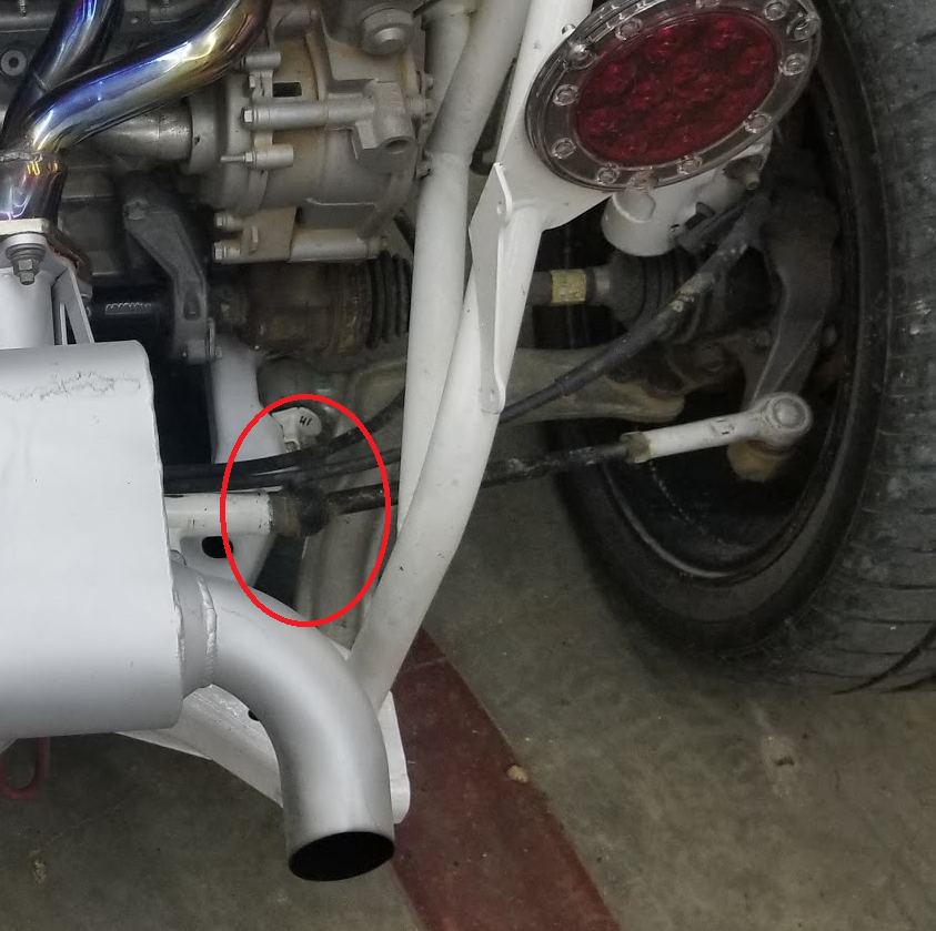

Tie rod question. Is it just the ends that need swapped? I originally thought it was the rods and ends?
What do people do for boots on the back?
PyroGuy923
@Ross the circled part to protect the ball joint. Didn't know if there was a particular bellow/boot since the diameter of the tube around the ball joint is much smaller than the steering rack.
