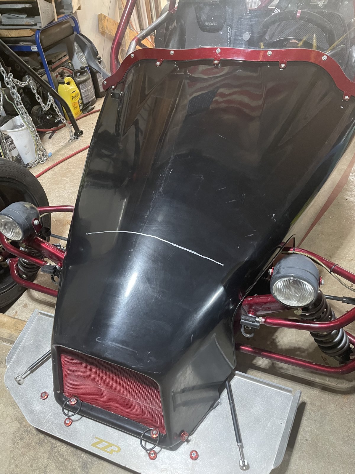

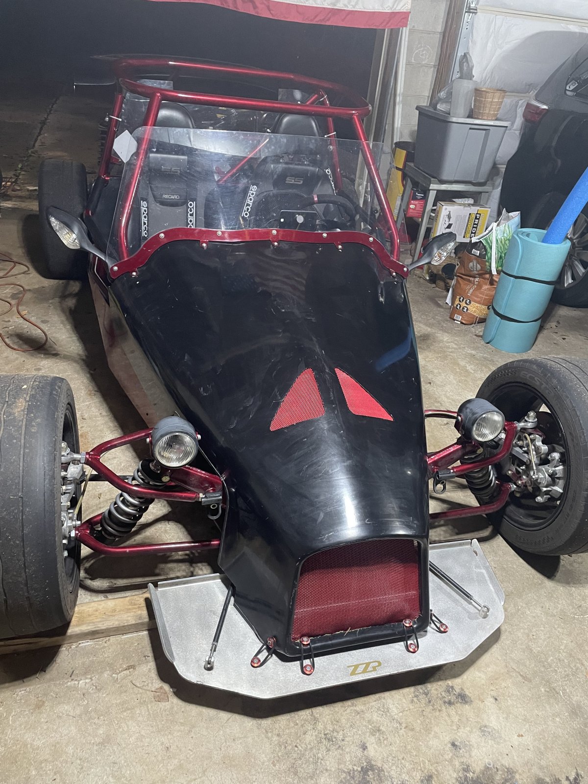

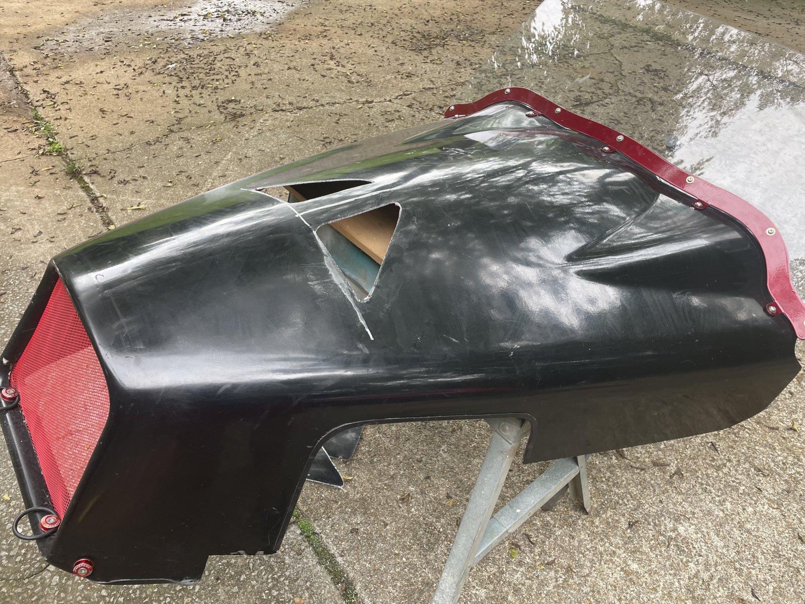

Getting ready for the Rocket City Octane car show on Saturday August 10th. I did fix the front grill and lean back the windshield a little bit. I may lean it a bit more but it looks much better. I never liked the straight up/down that the stock one sits at. Also, cut some 'nostrils' right behind the radiator to help let some heat out. It made a difference, so the holes may need to get bigger. Sill need to paint the muffler and touch up the valve cover then do a full detail plus clean the seats. Also need to start tracking the items to get ready for GoblinFest 2024 in October. Had a great time last year so really want to get back up to see the crew again.

Grill and Vent Holes
What was your technique to lean the windshield back?
Put the bracket in a vise and bend the 5 tabs back. I did heat it a bit so the powder coating wouldn’t crack. I used a angle gage to get them all close.
I also had to slot the holes in the windscreen.

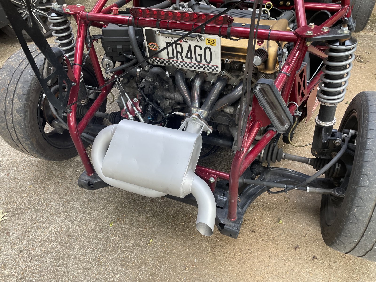

Sanded and painted the muffler last night. Sanding all the rusty spots took some time, even using a random orbital sander. Wire wheel on the joints and areas the sander couldn’t get and last was hand sanding places the others couldn’t reach. I may need to polish the header now. Tips/tricks would be greatly appreciated.

Going to a carshow? The header could be polished up, but it will still 'rainbow' again with more heat cycles. Keep in mind the more the header heat cycles, the deeper into the metal the color will reside.
Chrome polish and a buffer wheel - one small enough to fit the gaps between the pipes - could get you there for a nice shiney finish. But it would take a lot of work to remove all of the color.
