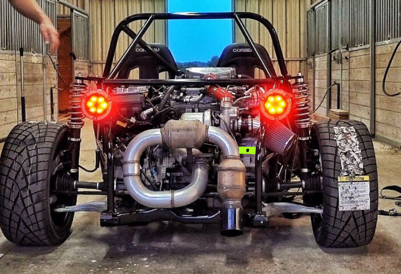

I know this has been discussed at least once on this forum, but is all of the weight hanging off the exhaust header ok? The turbo and down pipe alone are at least 20 pounds, and the exhaust adds another 20-25 to that. I am thinking I can somehow weld a flat bar to the rear right side subframe mounting tube, and meet it with another bar welded to the exhaust then bolt it together. I have the solid mounts so the engine shouldn’t move and move the exhaust either. Any other problems I’m overlooking?
