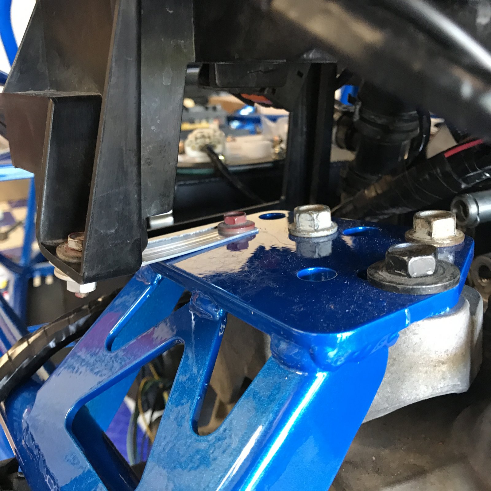

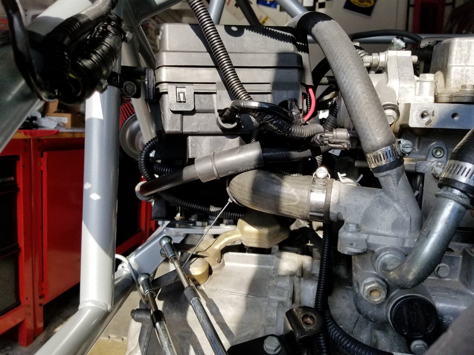

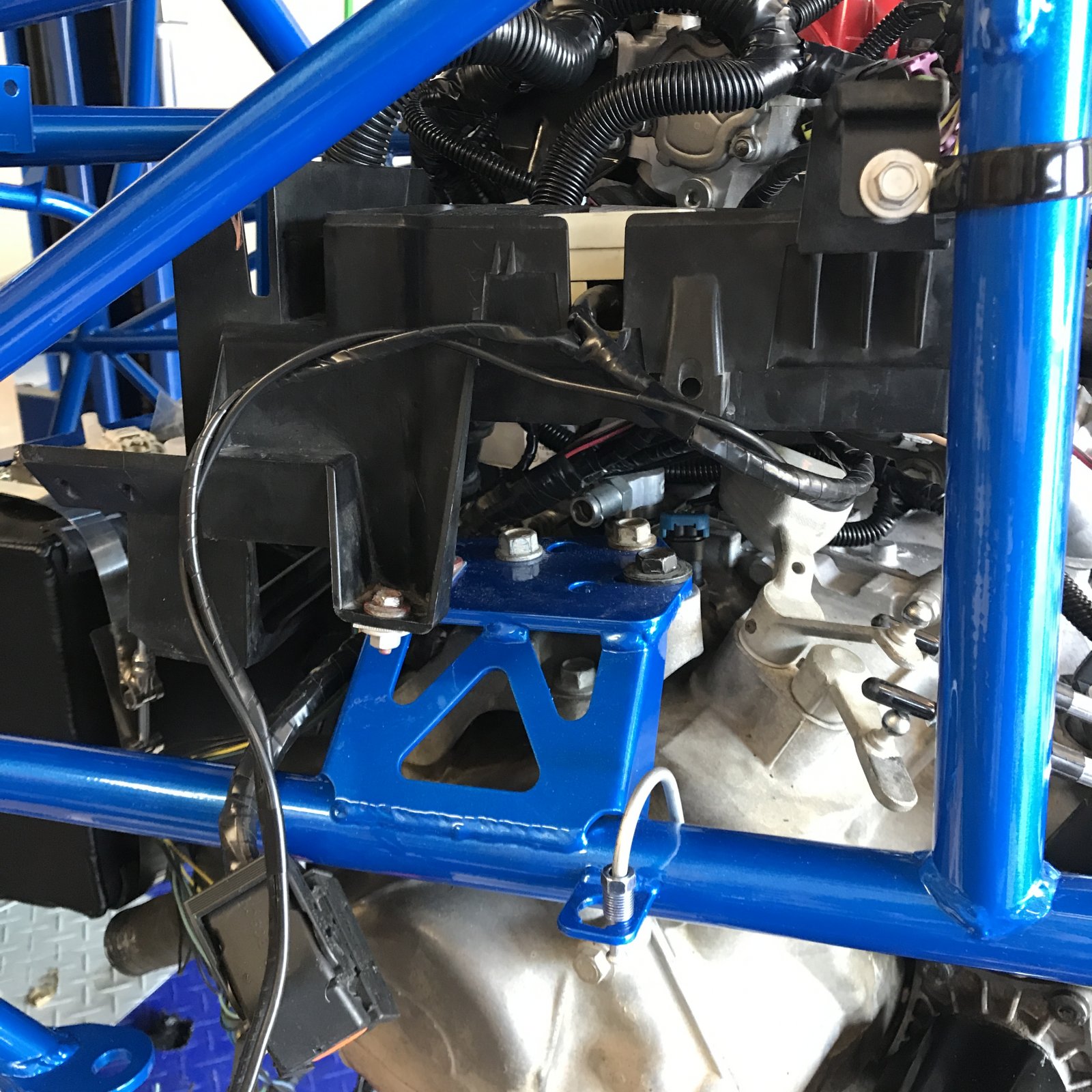

It's been a while since I last updated something and unfortunately I cannot say I have solved the problem of mounting the fuse box to the transmission mount. I just don't have enough clearance with my hose routings to mount the box the way it was intended :mad:. But Thanks to Rich for helping me out a lot on the coolant hose mounting.
Waterdriver
It's been a while since I last updated something and unfortunately I cannot say I have solved the super easy but impossible for me problem of mounting the fuse box to the transmission mount. I am clueless why I am stuck on this, but I am. I just don't have enough clearance with my hose routings to mount the box the way it was intended :mad:. I just don't understand why this is such a problem for me but super easy for others. But Thanks to Rich for helping me out a lot on the coolant hose mounting.

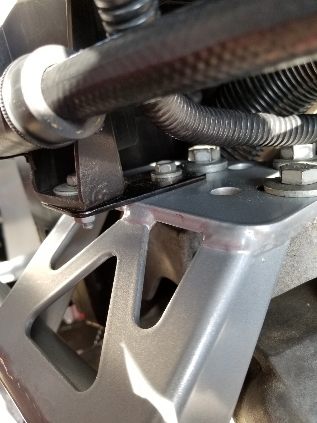

I had to move the fuse box over to gain some clearance. I made a small bracket for that lower mount to move the fuse Box over, out of some steel flat stock.
The fuse box was--and still is--a huge PITA for me too. I can't seem to find a good way of mounting it so that it feels sturdy.
I like Carl's idea of a piece of flat bar. I'll have to look into that.
dperkins
I tried making an extra support but somehow it broke. I think I need to make it out of really thick bar so it doesn't break again.

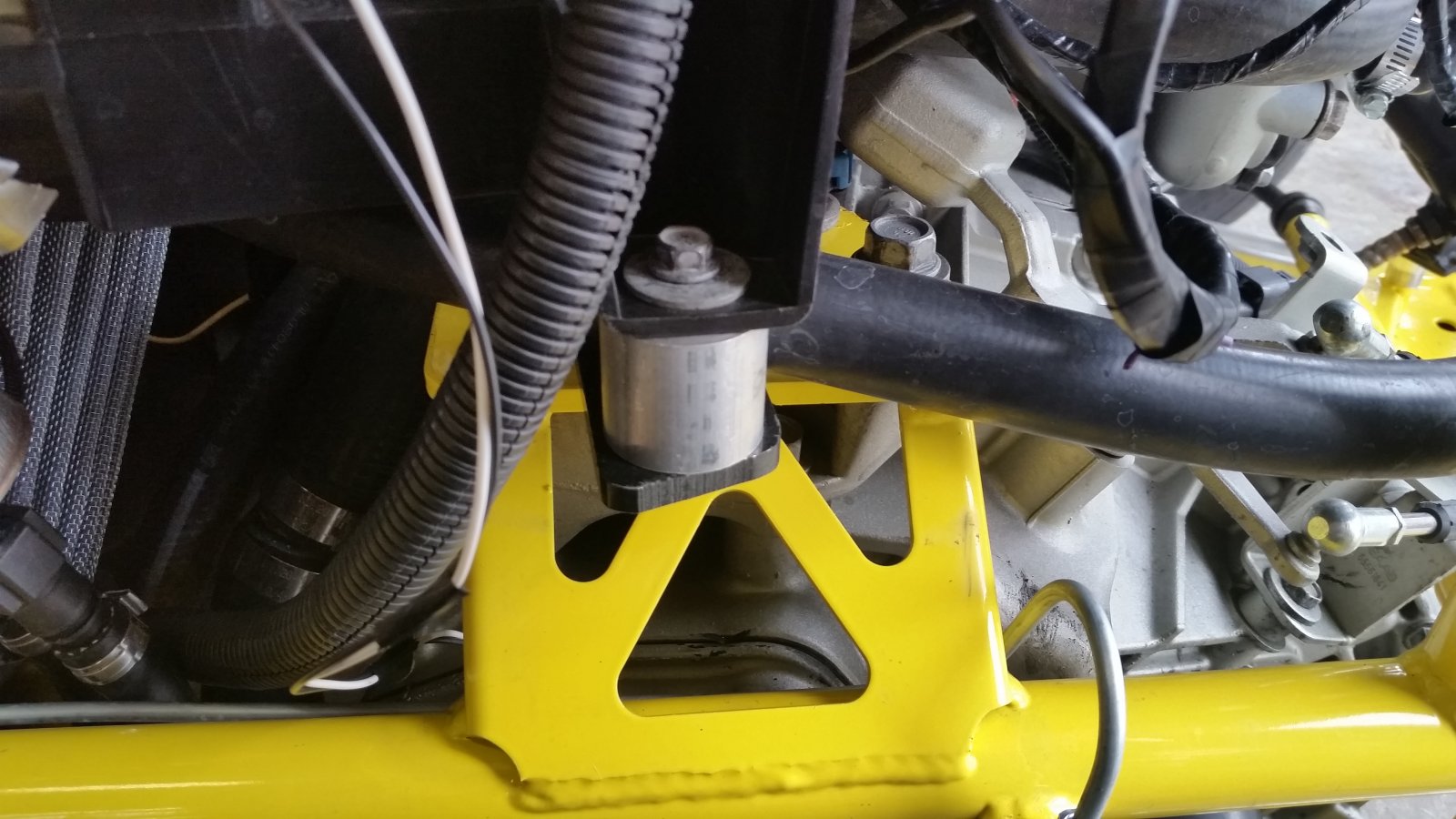

This is interesting because it's another one of those areas where each tend to do it their own way. I had welded a tab on the upright tubing instead of using the "L" bracket and drilled a custom hole in the trans mount. This did limit the hose routing but was able to make it work. Sorry, no pictures.
dperkins

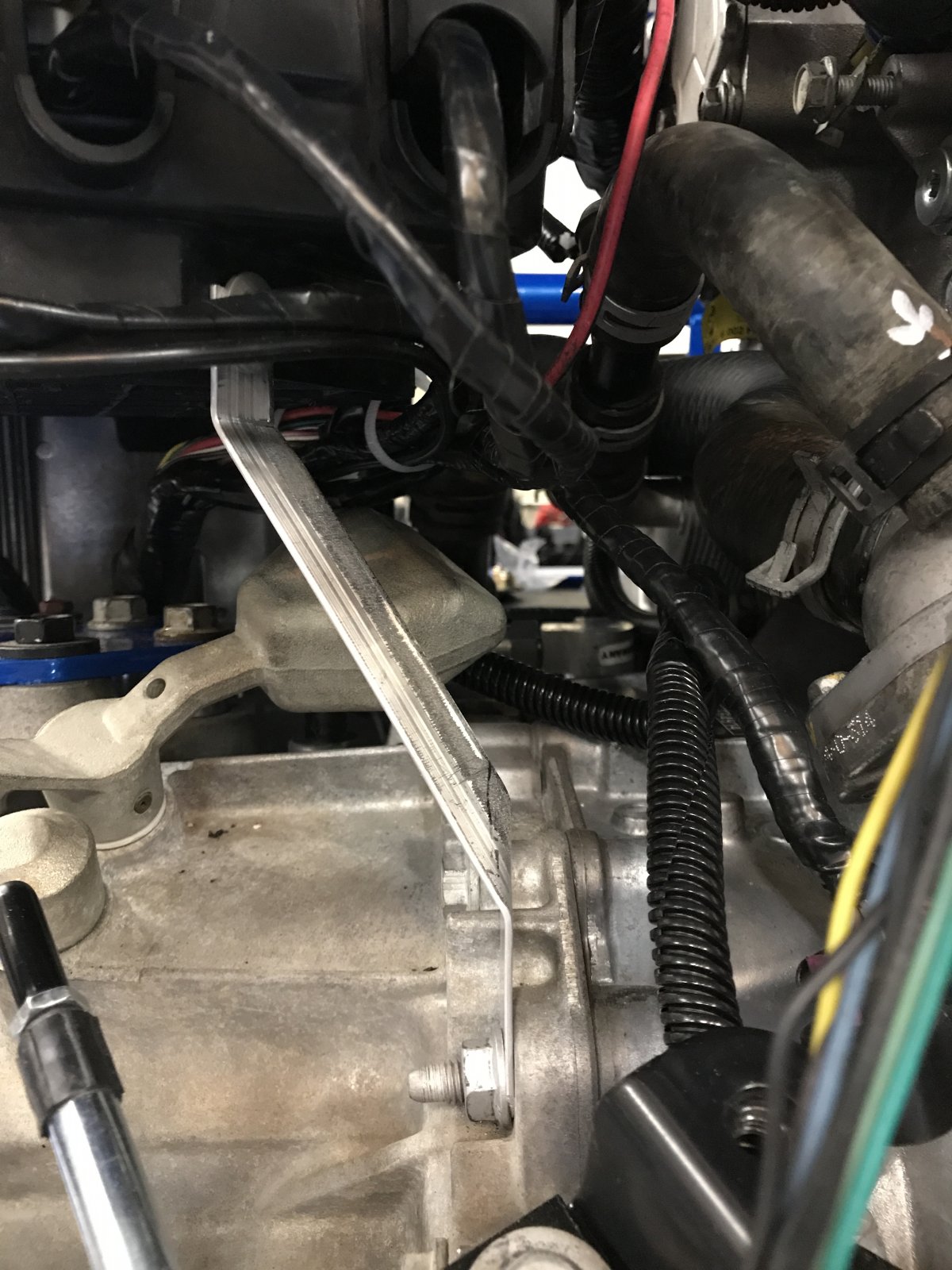

After a trip to Home Depot I finally got something that sort of works. It's not my favorite and it doesn't look amazingly sturdy but I might redo it when the car is actually running.
dperkins
Pretty much ready to do the first start. All I need now is my fuel line to be delivered and then I can get rolling with that start. While I am waiting I am doing some wire organizing underneath the fuse box. Some of the wires are getting caught on the shifter counterbalance weight. Is it ok to cut it off? I know JSTAX took some of his off, just want some input on what the results would be.
dperkins

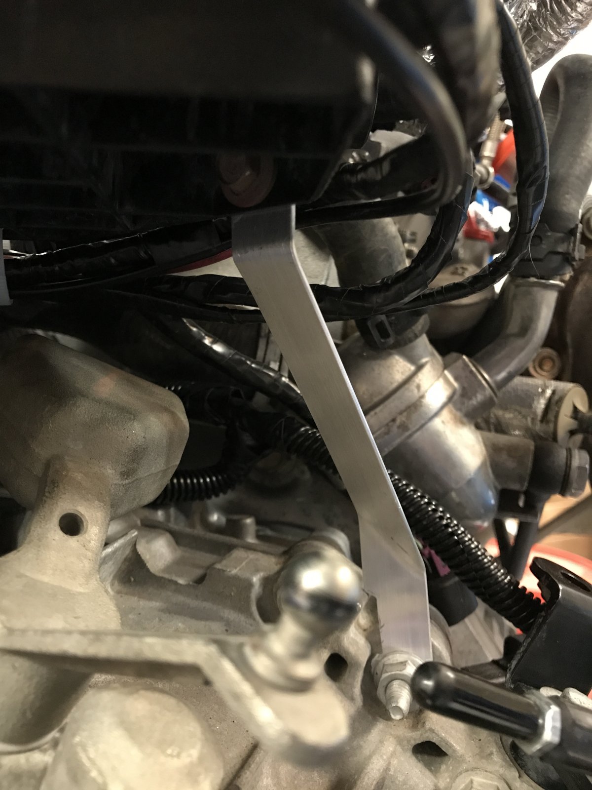

Ok disregard that question about the counterbalance I have fixed the issue. I decided to fix the weak fuse box mounting problem by custom fabbing a bracket to bridge the end of the box to the transmission. Took me 15 minutes to make. I think DF should provide something like this in the future since it's to easy to make and solves a common issue.
