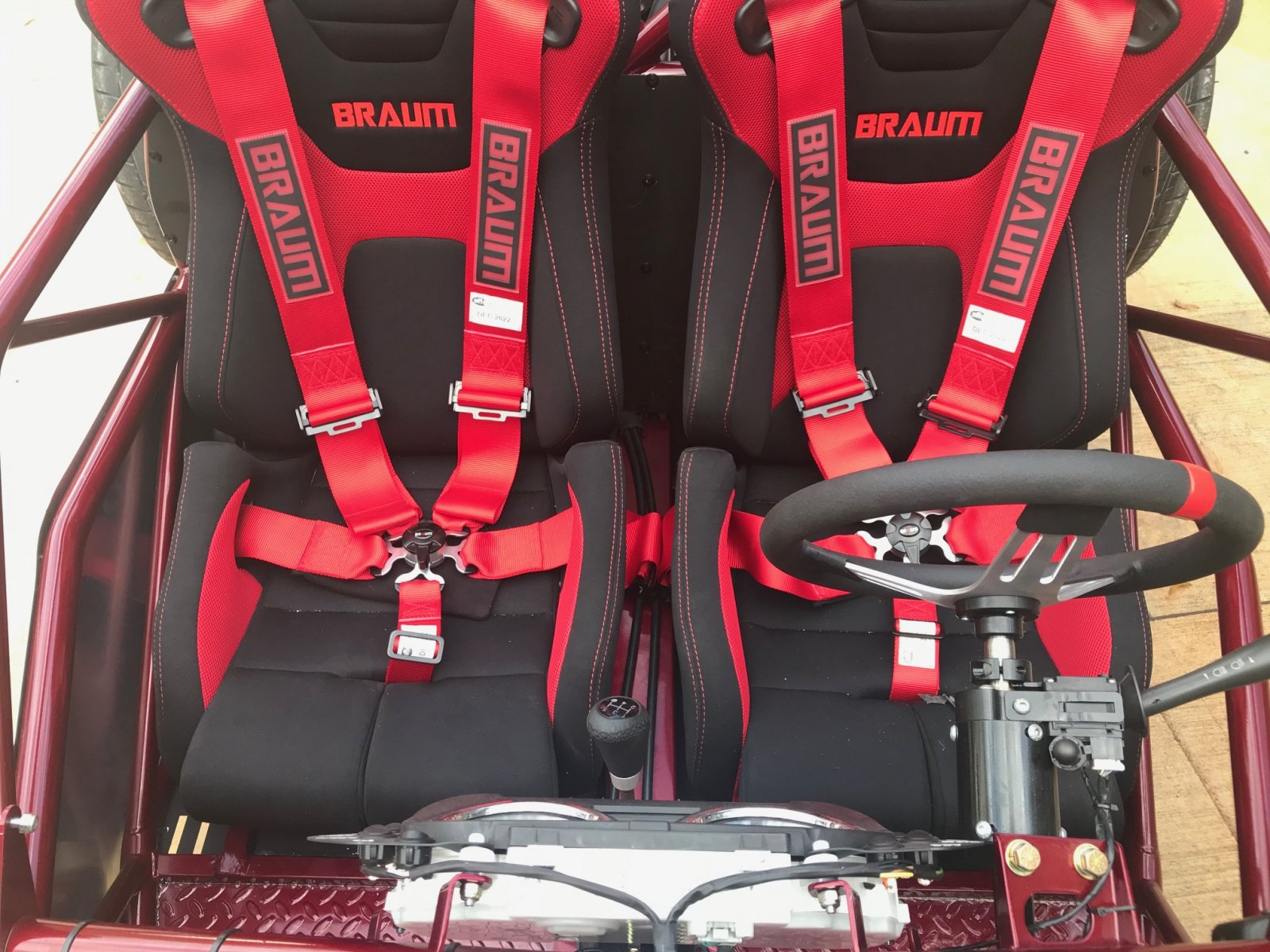

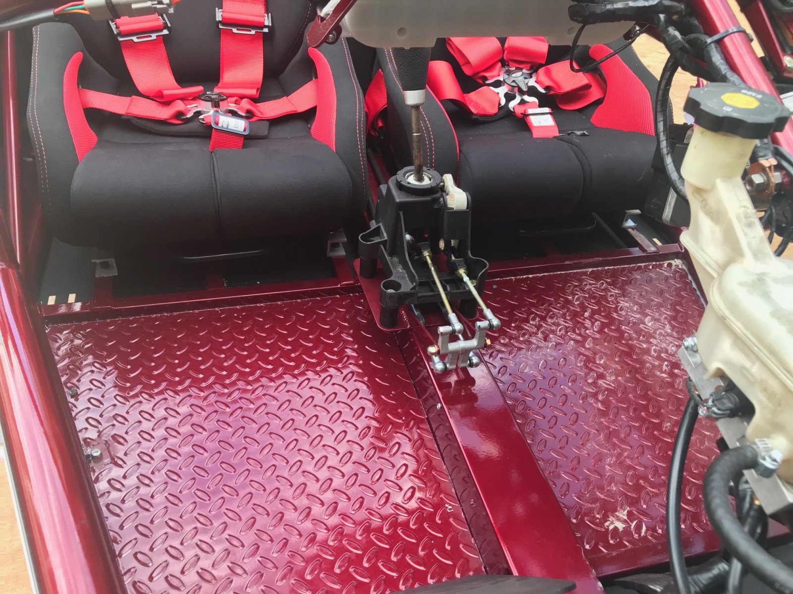

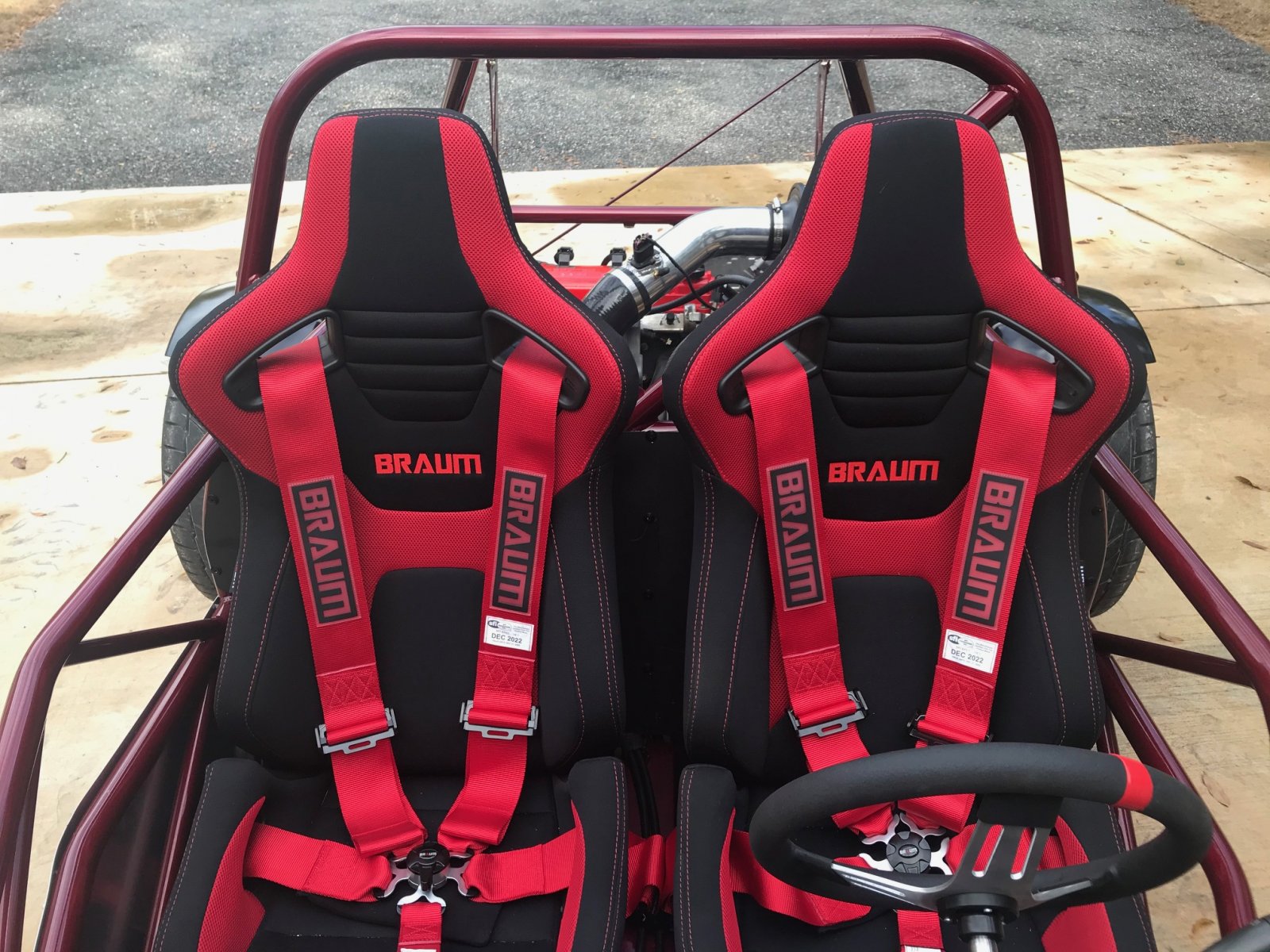

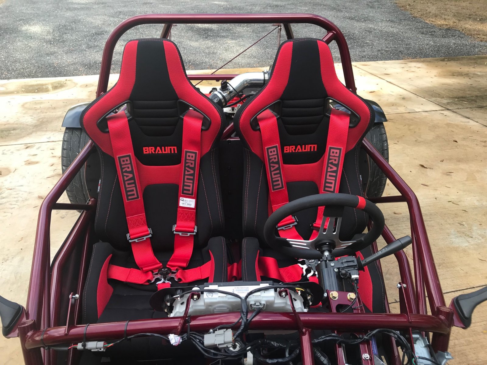

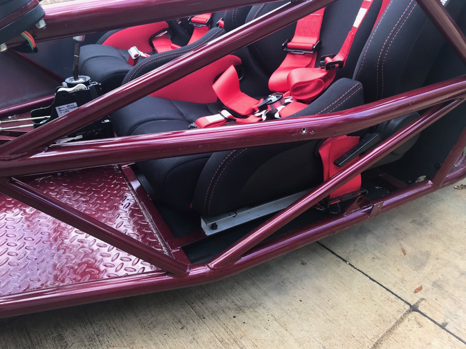

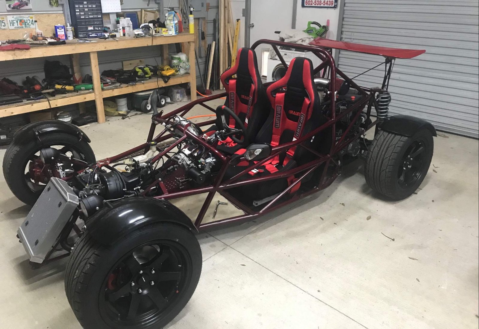

Could you please post up some pictures of your seat fitment for us? I'm looking at Braum seats at the moment myself, but the ones I want are out of stock for a few months so trying to use your seats (and the measurements provided by Braum) to find another set. My biggest concern is the bottom of the seats mostly. At 20.5" overall width, it looks like there is minimal space between the seats for the e-brake with the Elite-R series seats.
CaptFrank2001
Hope this helps. I probably could have mounted each seat 1/2" more to the outside of the car. Let me know if you need some other angles.

R
These are exactly what I was looking for, thank you. Doesn’t look like you have the e-brake handle installed? Either way, looks like it will be a tight fit itself fitting between the seats, let alone with a handle grabbing it normally.

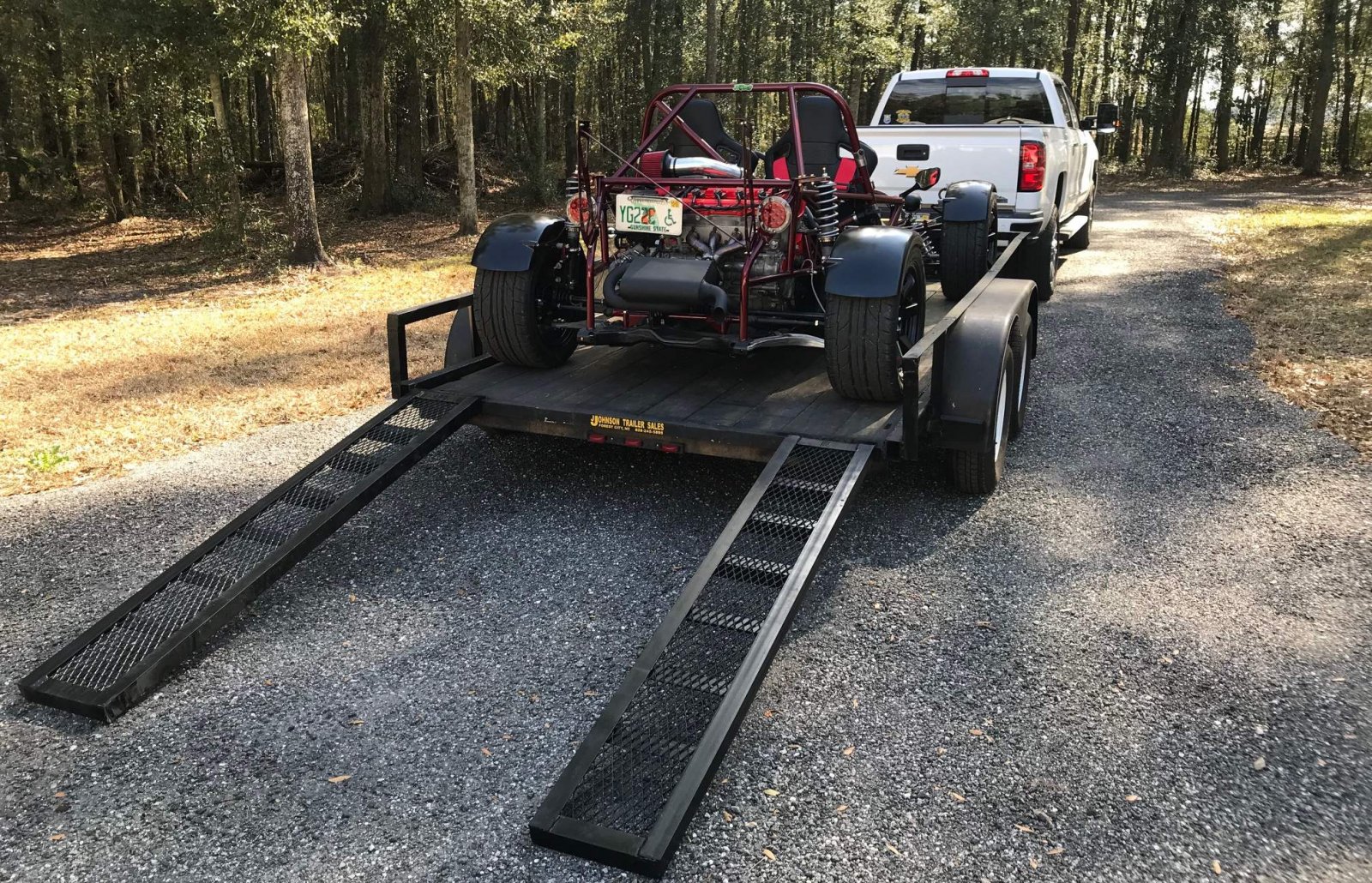

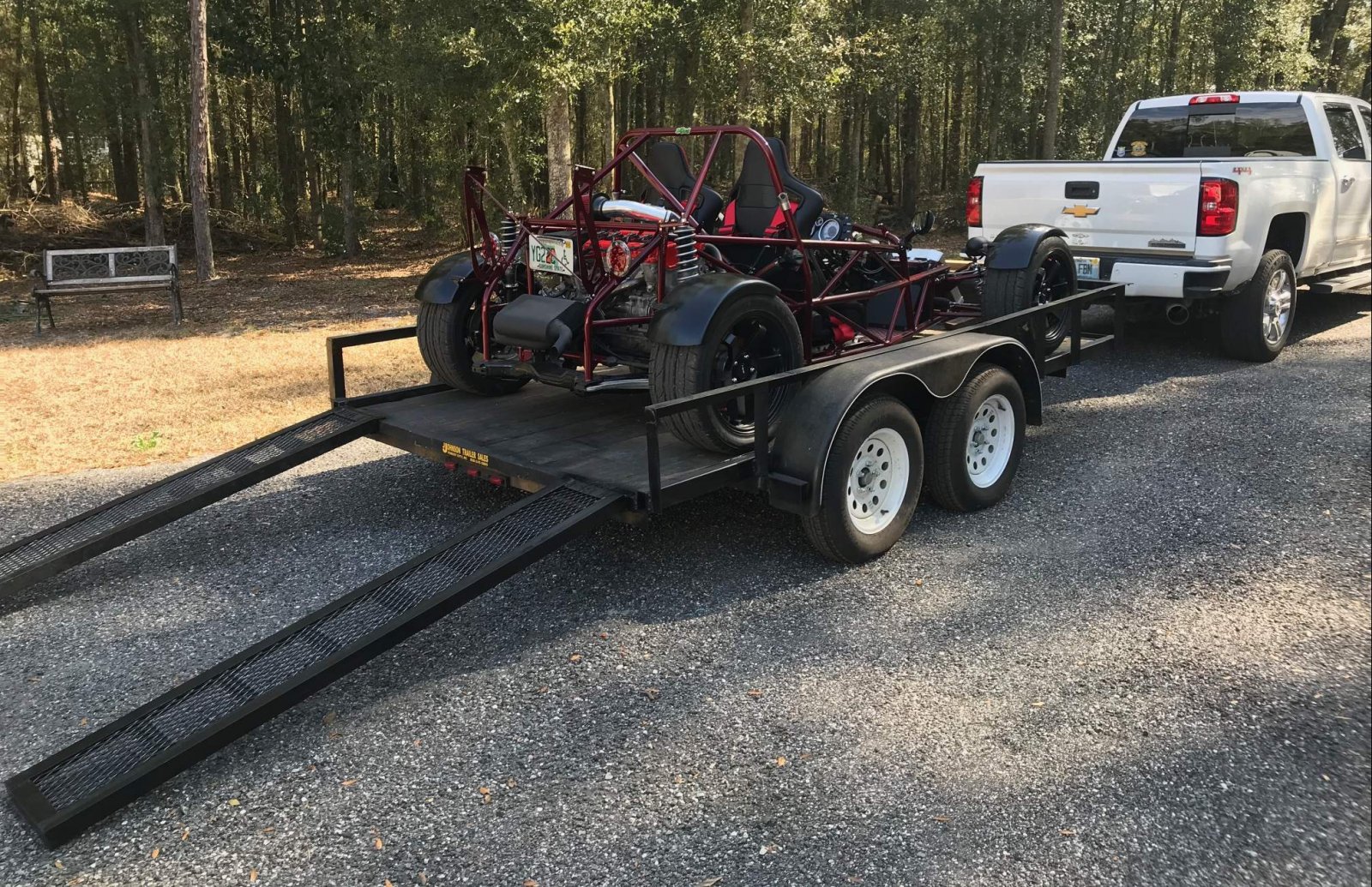

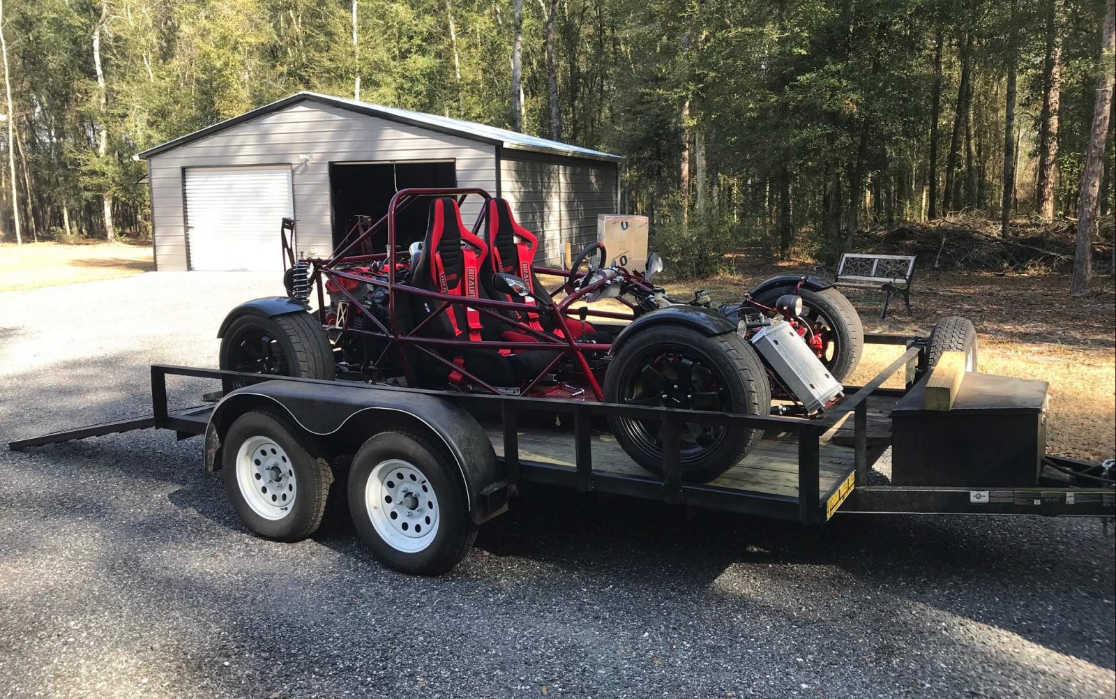

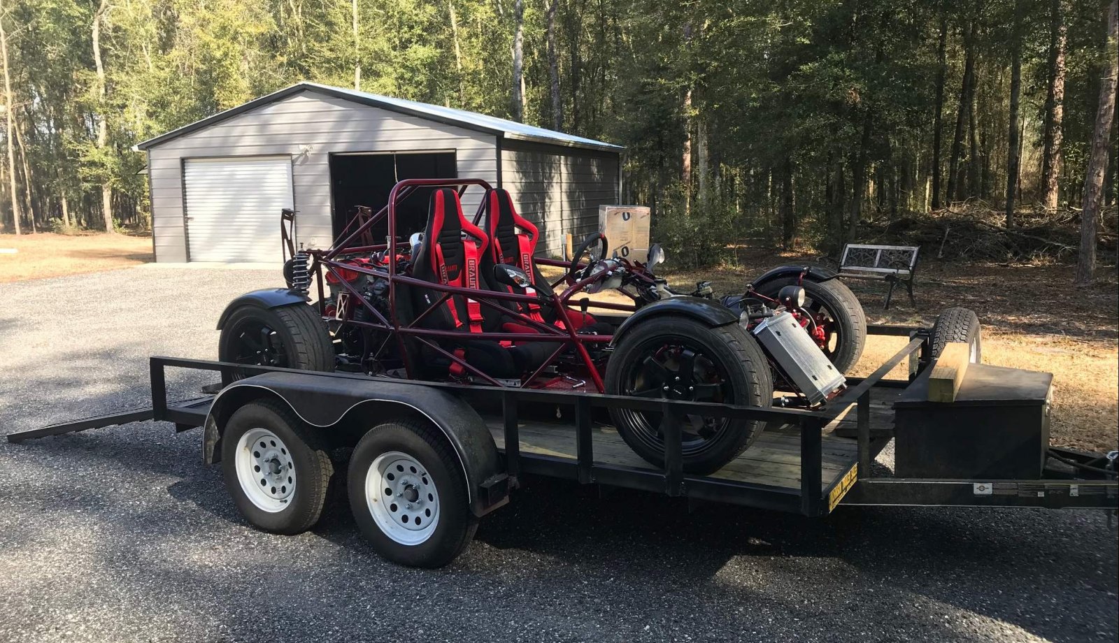

Trailer - Well I decided a dedicated trailer for the Goblin would be nice. I priced a small car hauler trailer and had sticker shock at close to $5,000. Easier solution was to widen the trailer I already had by 2-1/2 inches per side and just go that route. About 50 hours of my labor, $300 in steel and $40 in welding gas did the trick. Still have to wire up the lights.

ELITE-R Sport Series Racing Seats ( Black & Red Cloth). They come with sliders and also recline. https://www.braumracing.com/product/elite-r-series-racing-seats-black-and-red-cloth/
Thanks!

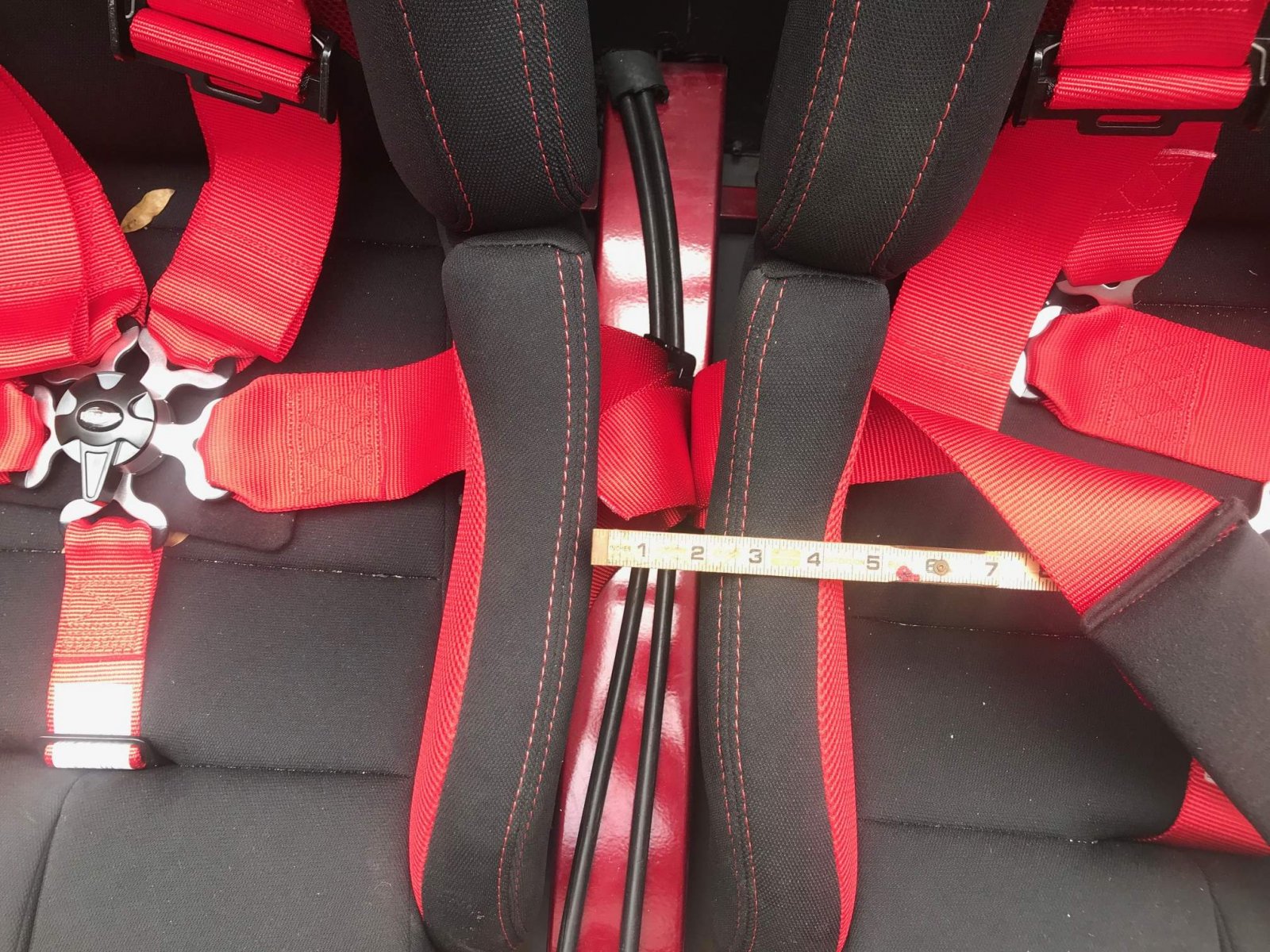

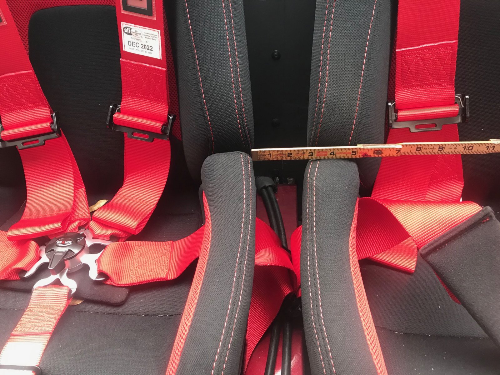

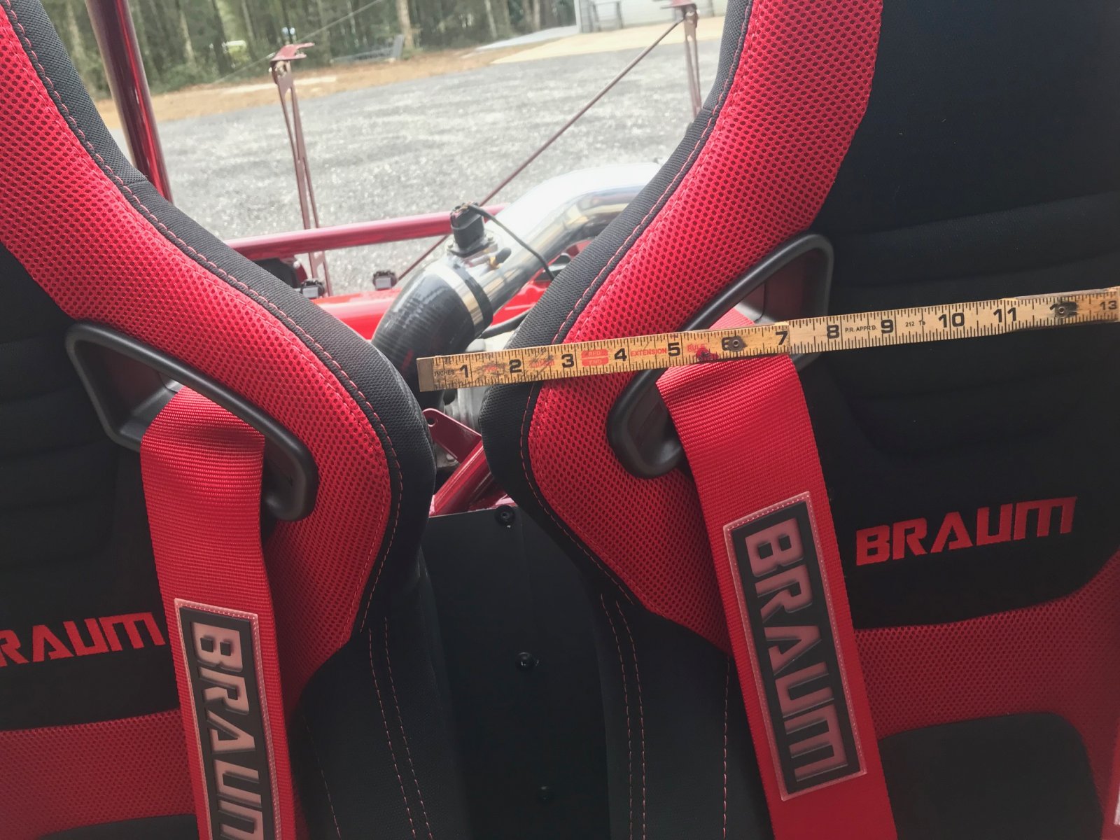

The seats I'm looking at are the same width at the thighs (20.5") but are slightly wider at the shoulders (24.5" vs 22"). This means compared to your seats I'll need 2.5" of space between the two seats at the widest part of the shoulder. In your photo it looks like maybe you have 1.5 to 2". Would you mind measuring that gap for me? No real rush.

Is this what you need?

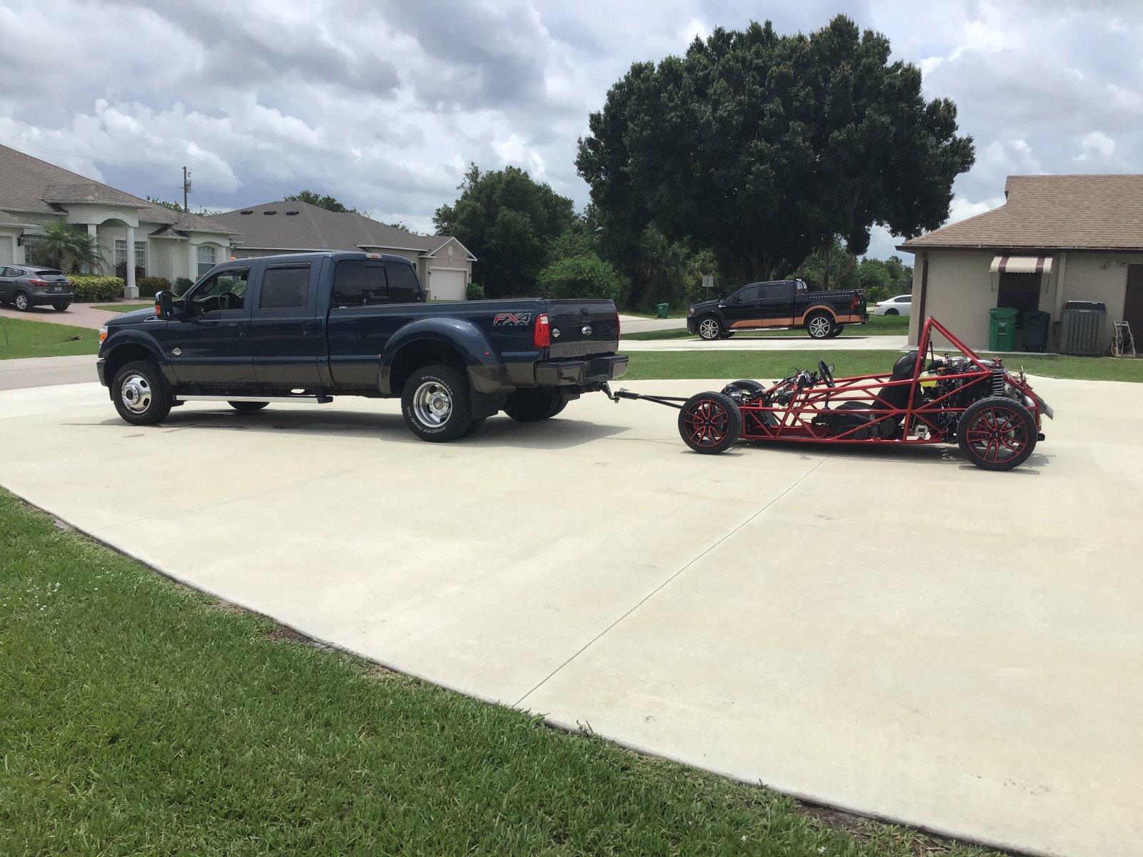

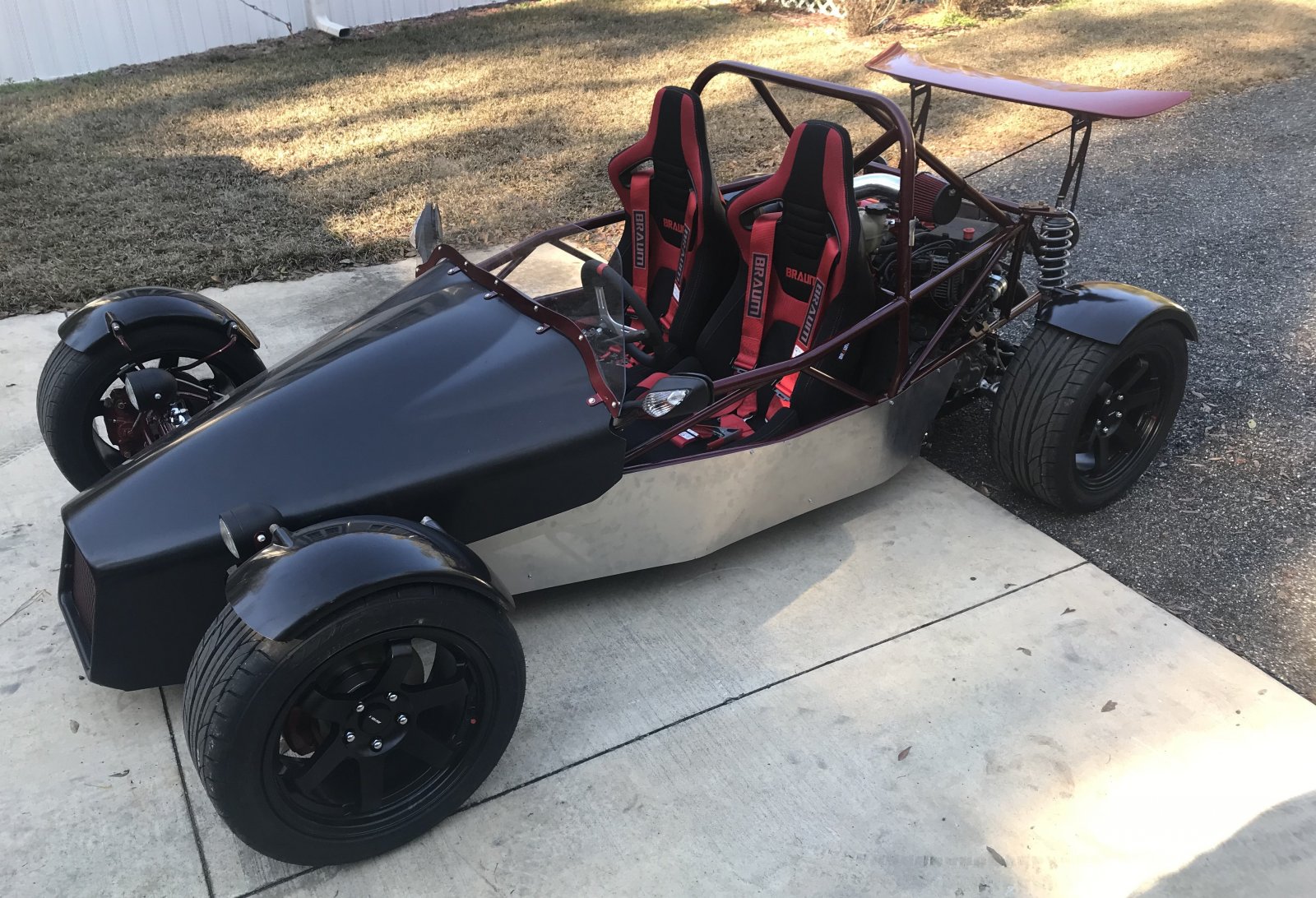

I didn't realize you got it registered too! Did you have to go to Tallahassee? The fenders look great. And was that the trailer that you used to pick up (and deliver) our frames?
No, I just put that tag on so I could make up some brackets for mounting the real tag (some day). Also this trailer is one I had. I borrowed a larger one to pick up the frames.

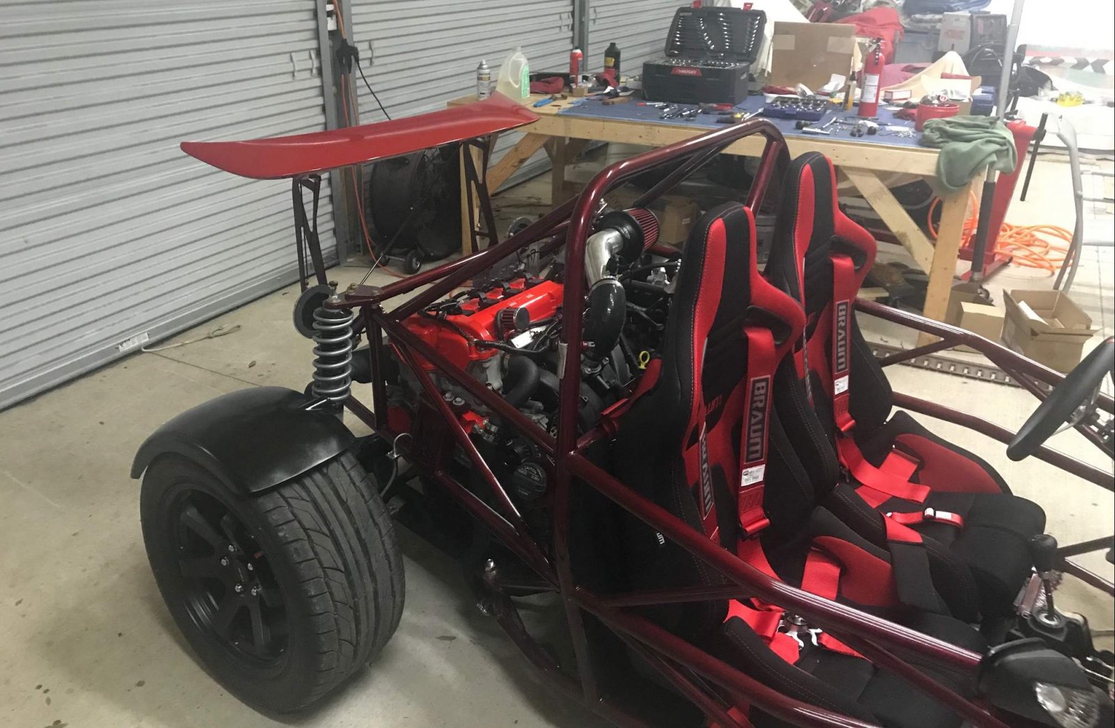

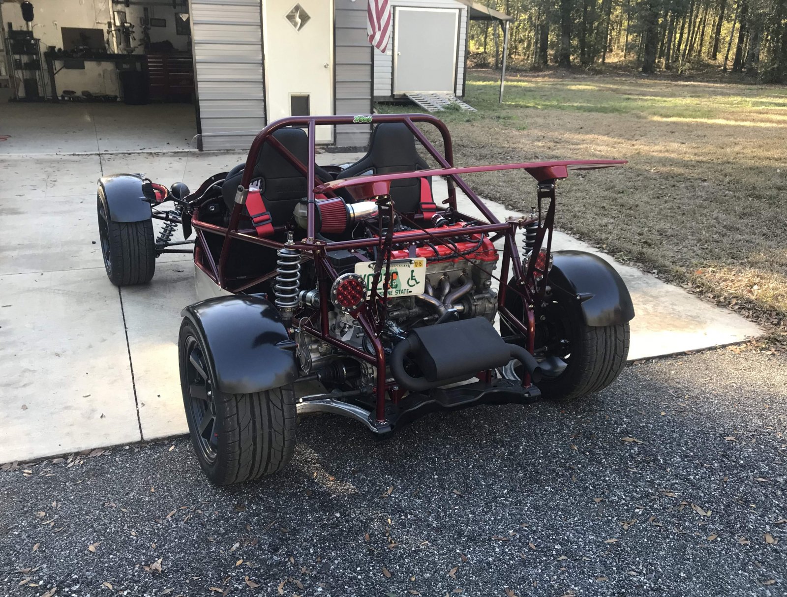

Try and find a Seibon Wing anywhere on the planet. I had one paid for & it was shipped from BlackOps. Guess what .... FedEx lost it. So for now it's the wing off of the donor until I can find one.

Towerdog
FedEx did a big investigation and came up empty handed. I did get a full refund from BlackOps. Losing artwork must have reall sucked. Hope FedEx reimbursed you.
No, didn't see a dime from them. Said they would cover the shipping cost but they didn't even do that.
USPS destroyed a sewing machine I was shipping back to the seller to get worked on... It was insured but they would not cover it because I didn't return their fax! Who has a fax anymore?!
R
I ordered mine through vivid racing back in December. They estimated a March delivery and it is gonna be drop shipped by Seibon. They’re just back ordered ~3 months so I’d find someone who can place an order to get you in line
