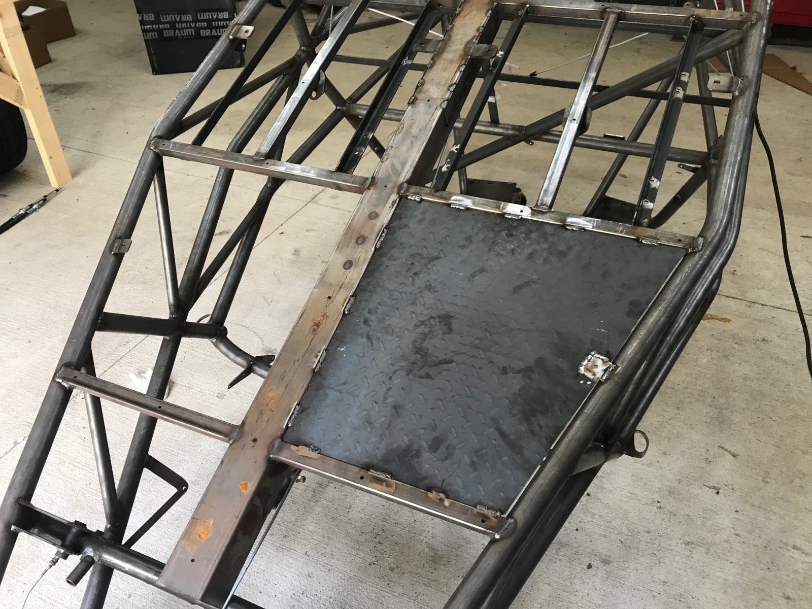

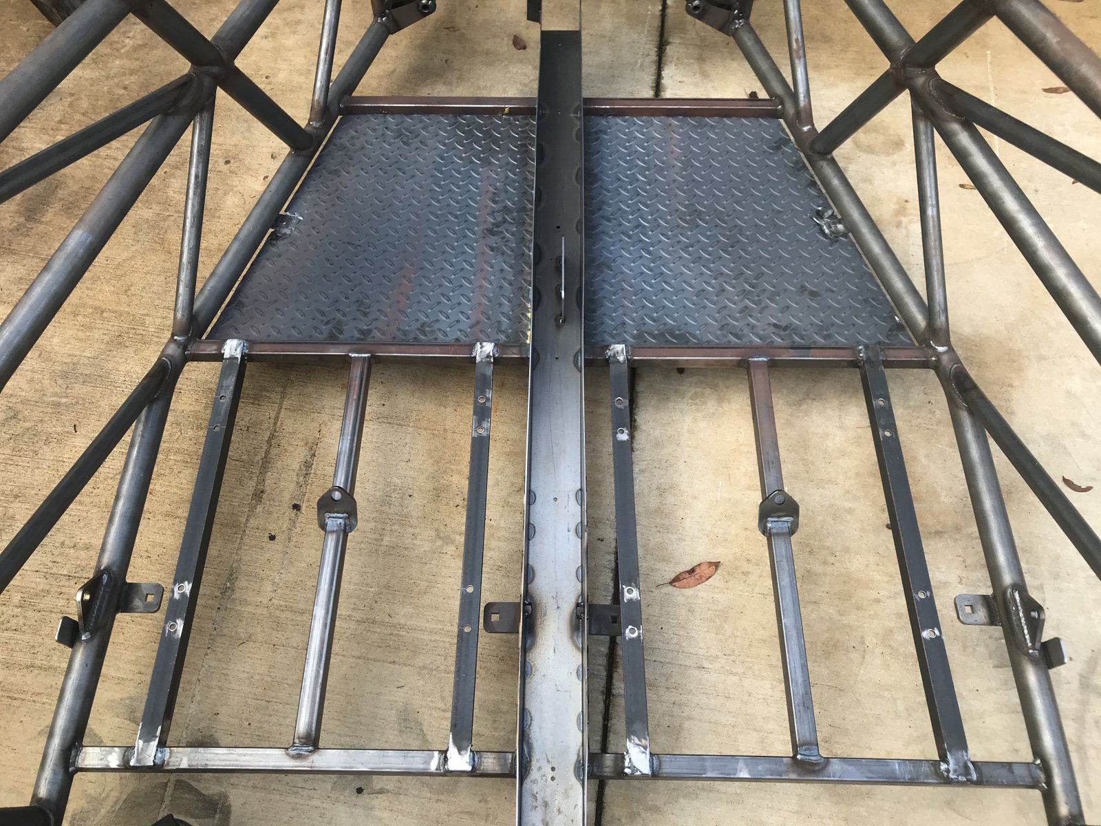

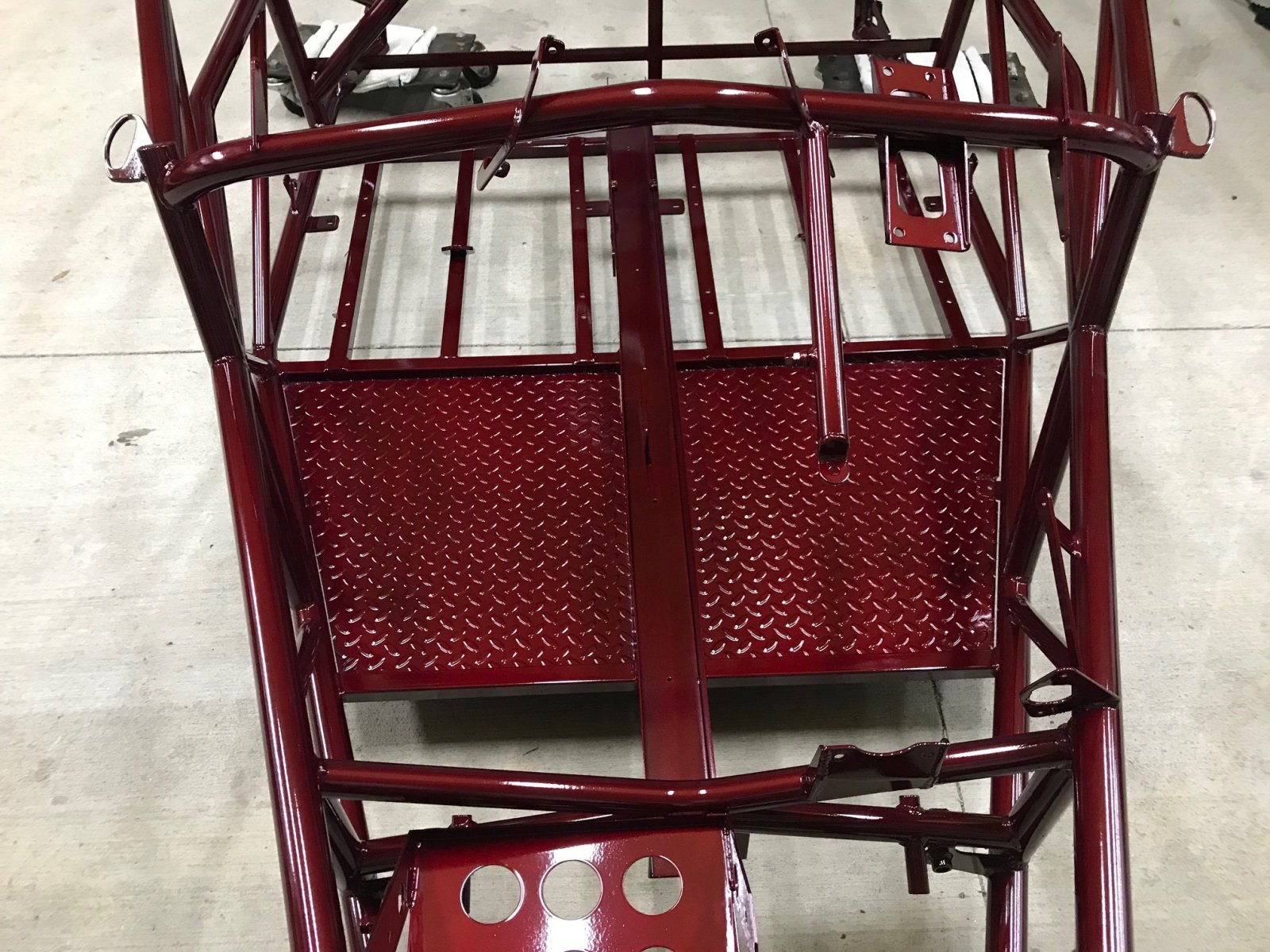

Did you just ditch the two tabs for the floor brace when you welded in your floors?
No, I cut a notch in the Diamond-plate and left them in place. I didn't want to weld to the outside frame tubes so I welded to the tabs. I also used the provided cross brace even though it was just overkill.

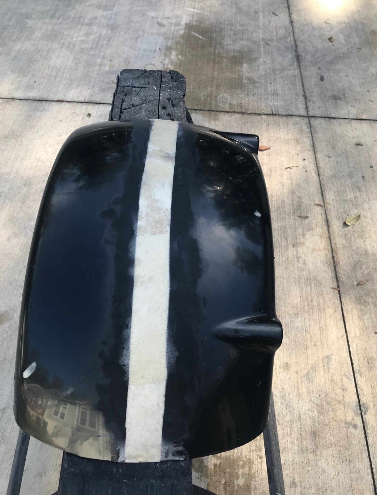

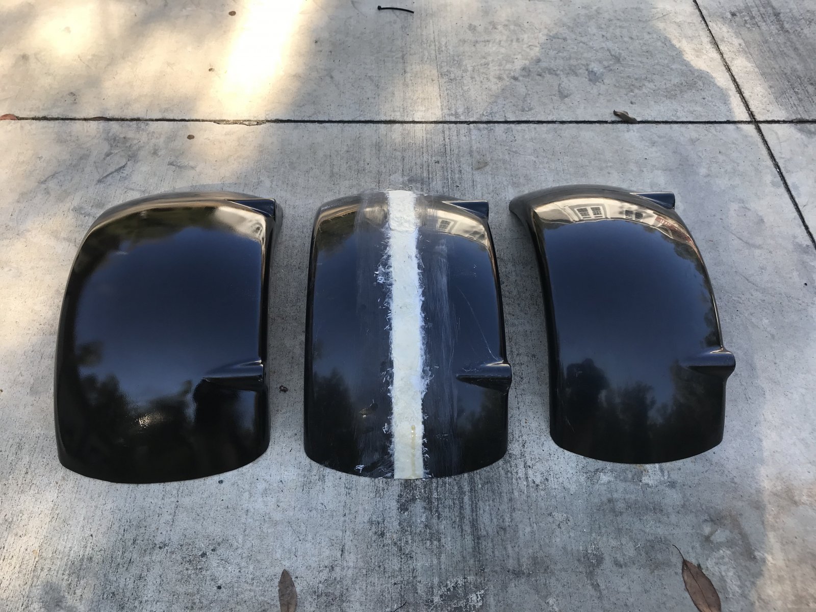

CaptFrank2001
Still working on the fenders. Had to widen the rear fenders 1-1/2" for the 275 tires. Here is a before, during and after picture of the process. Also had to make adapters for the front fenders to raise them one inch and move them outboard by one inch to fit the 245 tires. It's getting there.

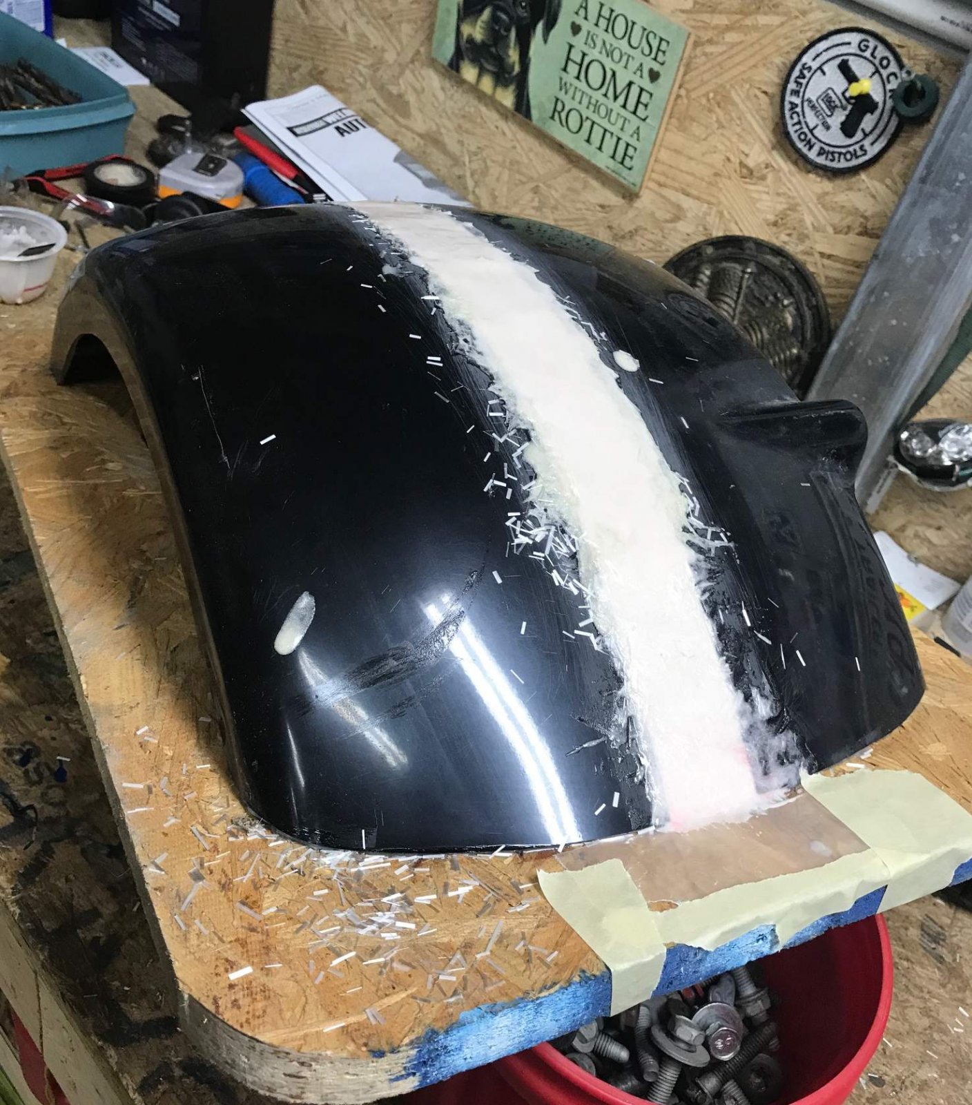

CaptFrank2001

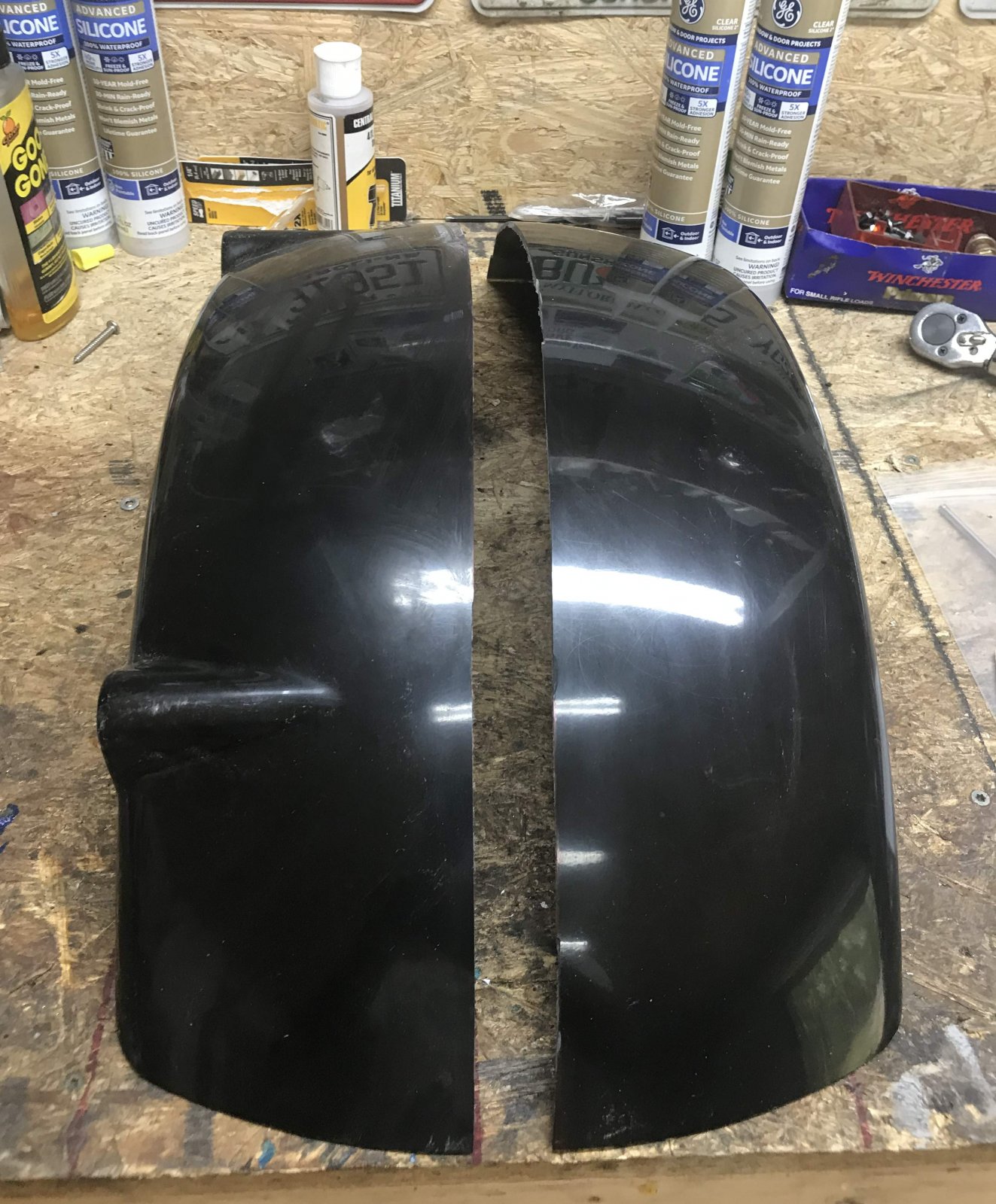

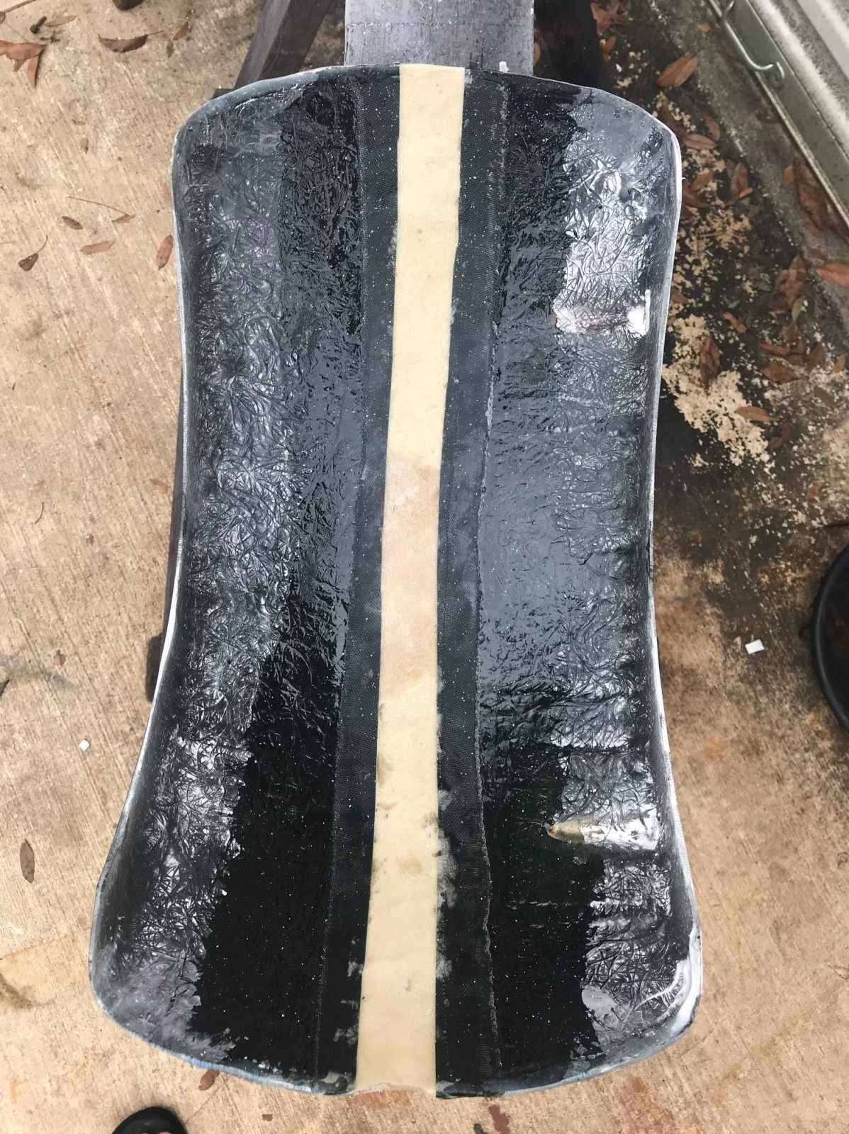

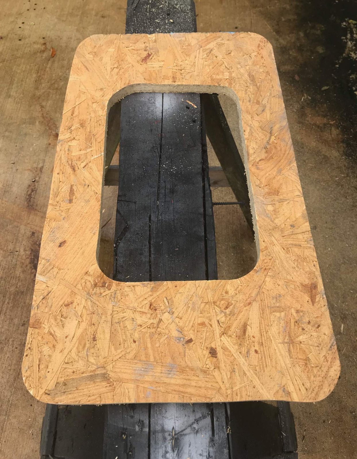

Thank you. Actually it was easier than I thought. If you lay the fender on a flat surface you will notice that the front & back actually lie perfectly flat. So once you split the fender in two, both 1/2's will also lay flat. This make it easy to spread the 2 half's, in my case 1-1/2" apart and they line right up. I then epoxied the two 1/2's to a piece of OSB. Then I went to work. I'm far from a fiberglass expert so I think if you can build a car you can do some fiberglass work.
