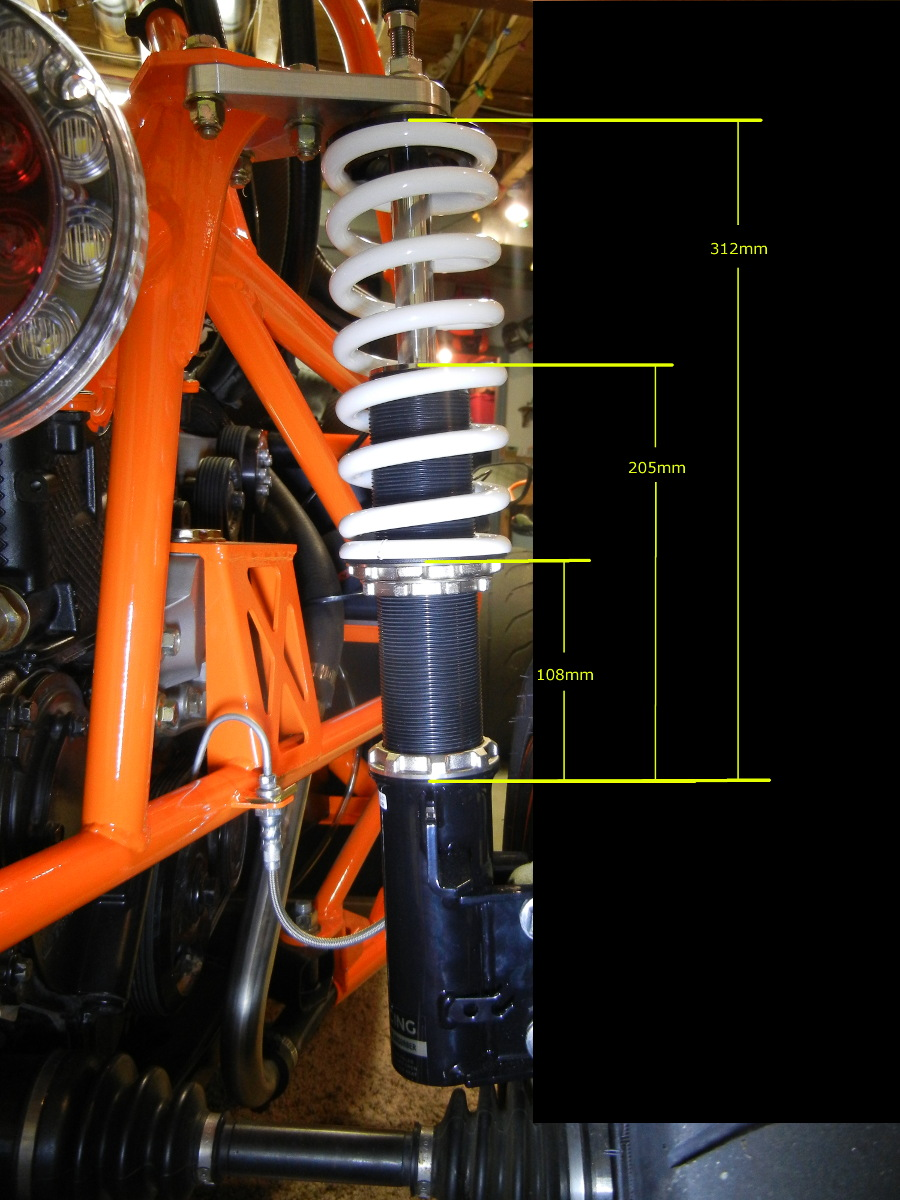

Does this axle angle look okay?
Nuker-
So I guess I need to screw the coil overs up further? They are getting hard as heck haha
Nuker-
Take the weight off of them when you adjust them. Also screw the shock body out of the lower mount. Don't adjust the spring.
See my post here for a great starting point on the adjustments.

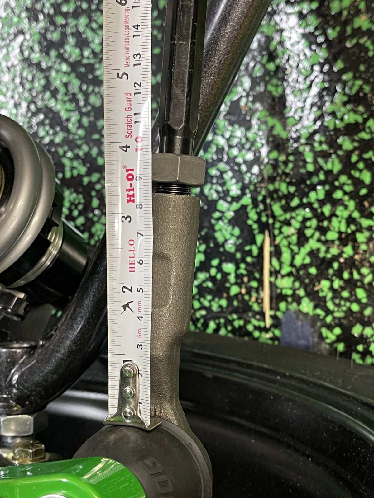

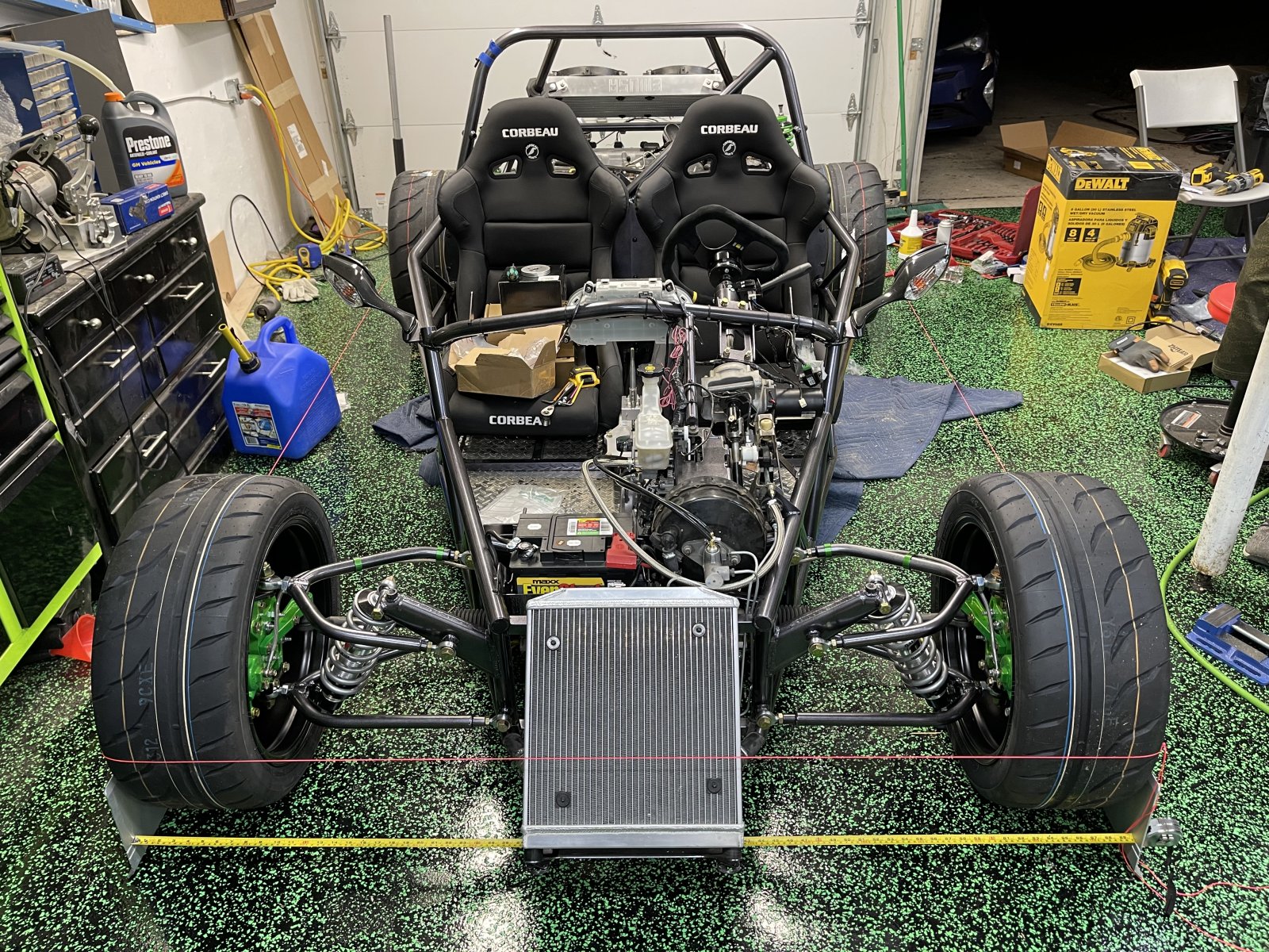

Okay this alignment is killing me. Tried the string method and the alignment plates. I can’t get the front and back measurements closer then 3/4 inch. I always run out of travel on the rod ends too far in.
What am I don’t wrong this can’t be this hard?
Nuker-
What rod ends are you using? The DF supplied rod ends go on the front and the donor rod ends go on the rear. If you use the donor ends on the front, they are too long.
TheNuker
Yep that has to be it , Thanks guys! My brother SWARES he put the DF ones on the front :P But looking at them they sure look like the moog ones I bought to replace the donor ones :D
