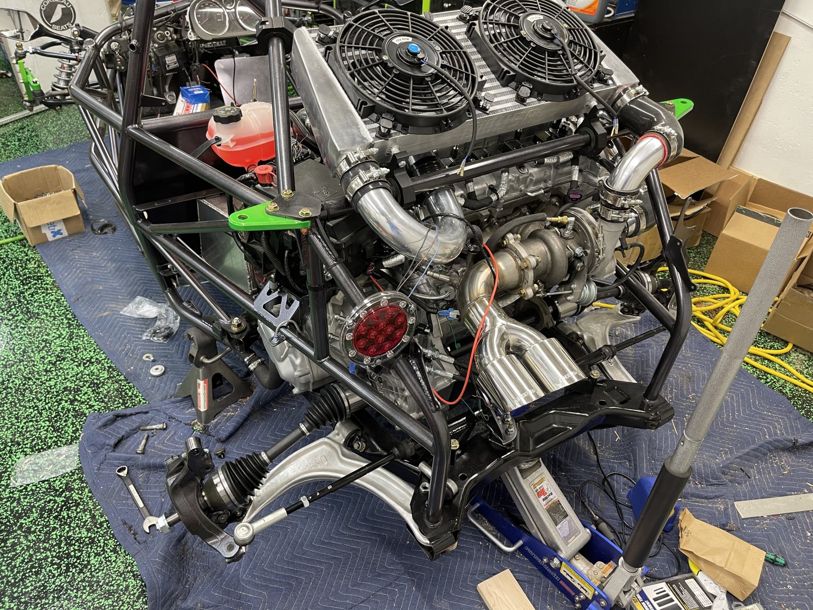

Looking good. You may want to put some kind of heat shield on the charge air tube coming out of the intercooler. It looks like it's about 3-4 inches from the exhaust pipe and the up to 1200 degree radiant heat will really warm up your charge air that you are trying hard to keep cool.![]()

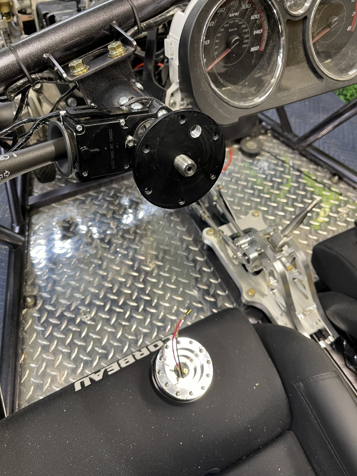

I just put mine on and ran the nut down. The Crome adapter bolted right over the top of it. The center is tight around the nut but fits.Got a bunch done tonight, brakes and clutch bled.
Started on the steering wheel but the DF quick release does not seem deep enough to connect to the spline adapter after you out the nut on.
Any ideas?
Thanks!
