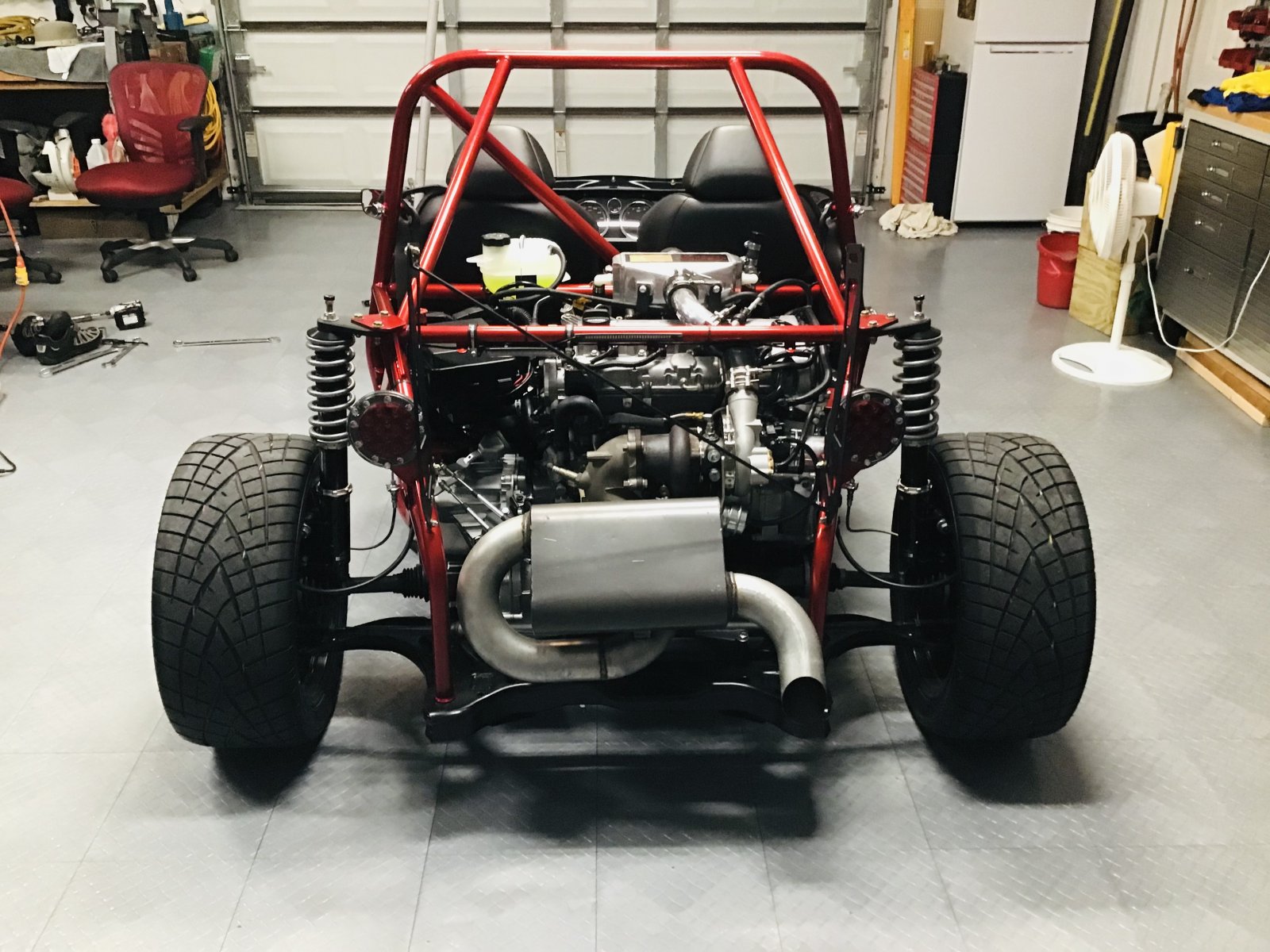

So after letting my Goblin sit in the garage for a week+ I noticed that inside the wheel there is a small pool collection of break fluid. It is NOT leaking out of the bango bolts im 97.3% sure of. 2 of the wheels had these pools. Not big but enough that I can wipe my finger through it.
I guess this is why I can't seem to get the **** breaks to bleed good. I pressure bled them 6 times tell no bubbles but they still feel like **** after 2-3 break cycles.
Any idea where this might be coming from? When I got them powder coated they got a little inside the lib where the seal goes. I sanded the powder coating off with 600grit very lightly and locked the seals+ lock rings back in what I thought was good. Could this be the route cause?

Maybe the bleeder bolt on the brake caliper is leaking?
I can try to change the seals again, The clutch bleed is perfect so it has to be the brakes. I don't THINK the bleeder valve is leaking because I put some powder on there to see the drop lines and none from there. It really appears to be the piston seals? Could this put air back into the system? I'm going to take off one of the culprits tonight and look at the seals again....

As long as you don’t mash the brake or loose much fluid, you would just need to bleed the one your working on if a lot of fluid leaks out .

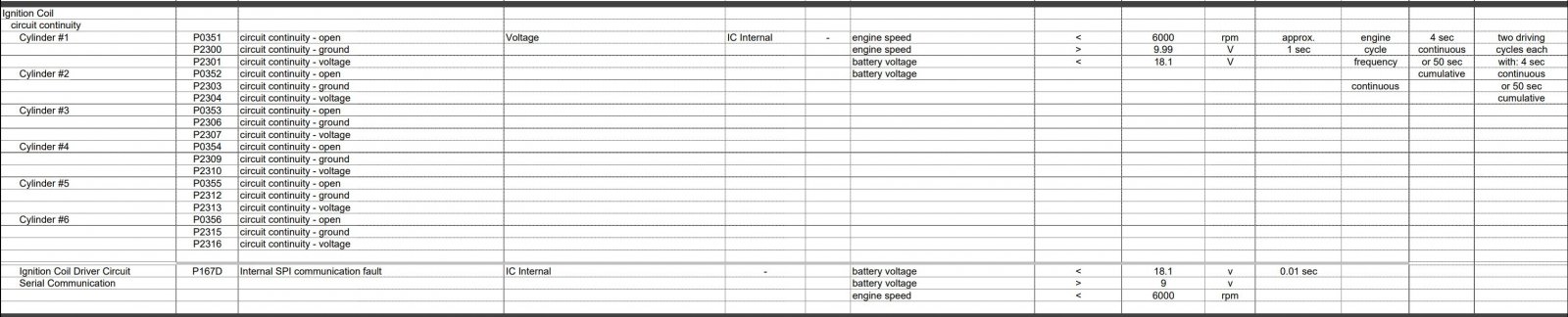

So I found this on a random google search of my code P2301 - Ignition Coil 1 Control Circuit High Voltage (Pending, Current, Old)
What is interesting is it has a note that circuit continuity - voltage then a note saying "battery voltage" enable value is over 18.1v so wtf is going on here!
I would think that if the battery volage was spiking that high it would be killing all kinds of things?
Here is the original site I found this on https://gsi.ext.gm.com/gmspo/mode6/pdf/2008/08 GRP02 LNF Engine.pdf
Nuker-
25069
I think that a P2301 circuit continuity - voltage
is triggered if the circuit voltage is outside of the normal range, which is defined as > 9.99V and < 18.1V
The rows in that spreadsheet look to be off a little...
engine speed > 9.99 V ??? That doesn't make sense.
You have already checked your car's running voltage?
I wonder if the high voltage (>18.1) is a flyback voltage spike created by the coil itself.

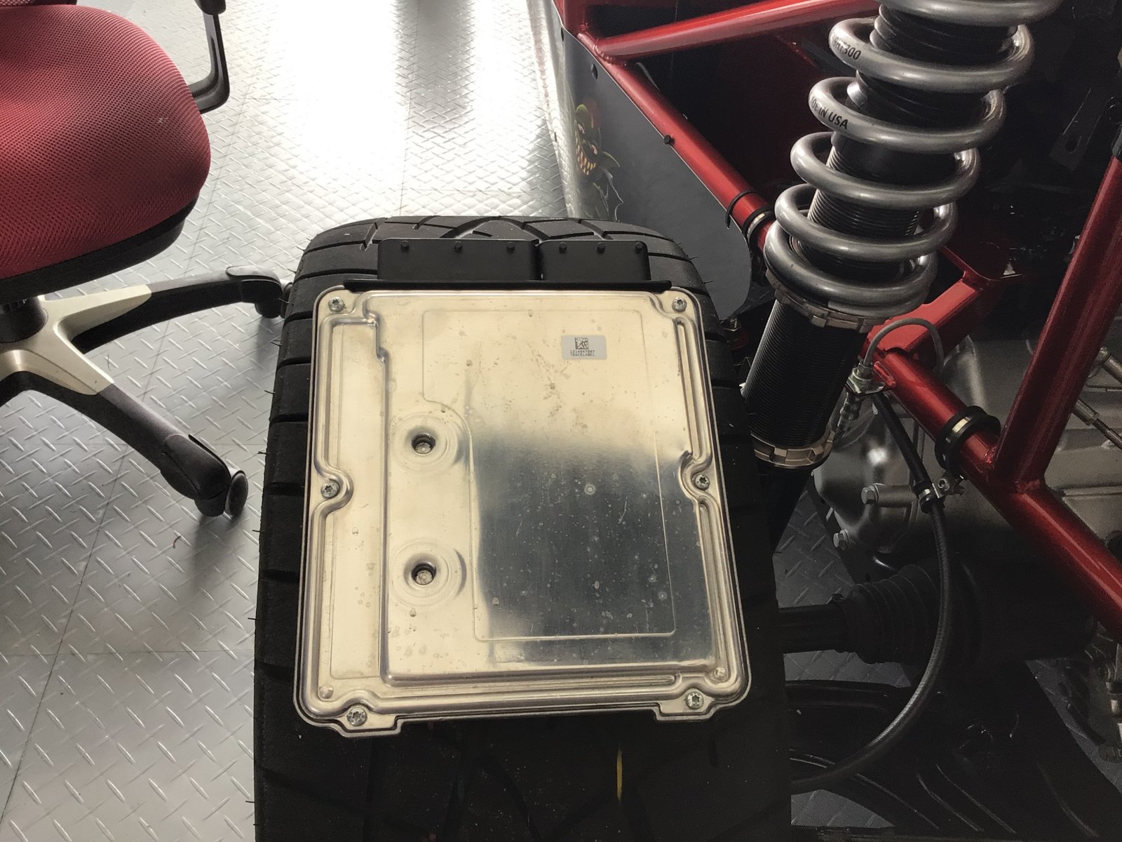

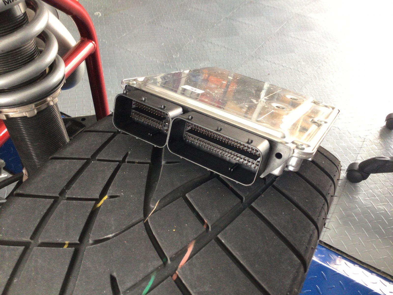

Hello Nuker
Is there anything I can take off my engine that you haven’t replaced and send to you to try,
Engine harness, coils, alternator, PCM , MINE RUNS So we know everything works.
Mine can be down for awhile, I just want to help you get yours running. So you can enjoy all the hard work you put into it !

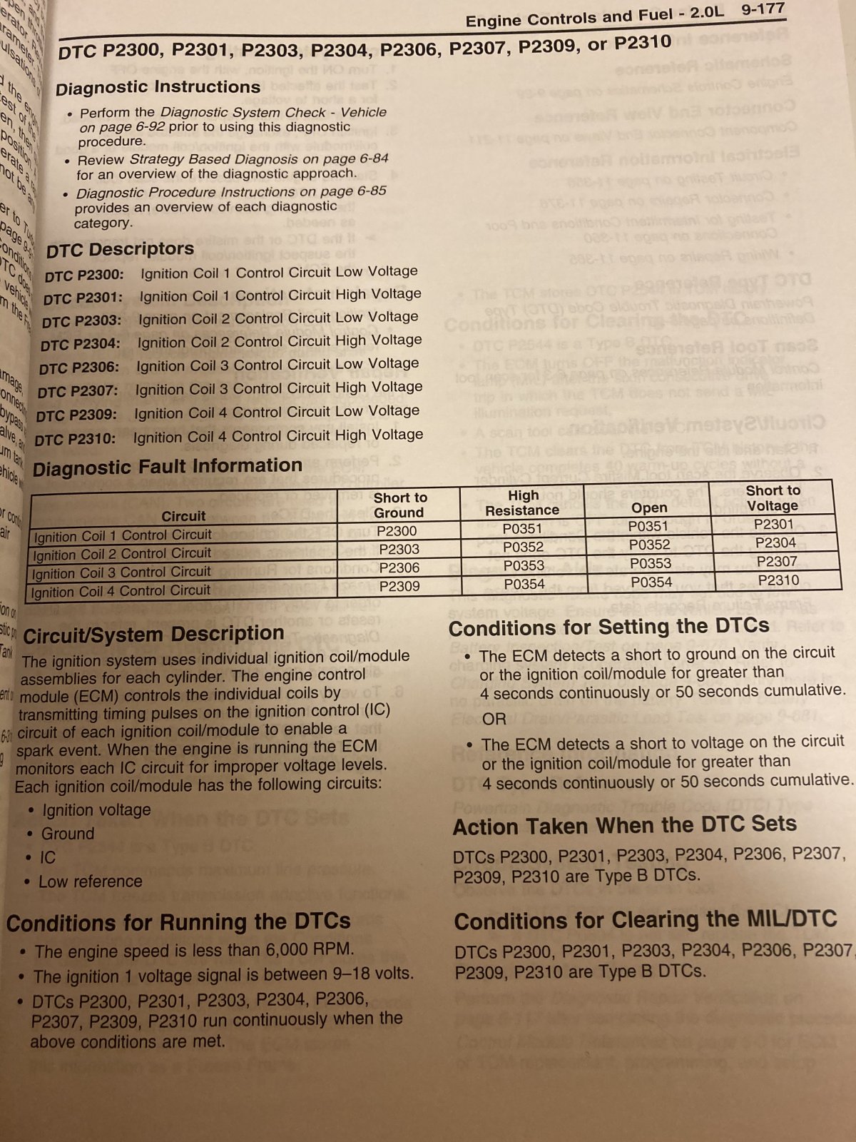

I think what the service manual means by “high” voltage is that it is seeing voltage when it’s not supposed to see voltage. It may getting full time voltage on the signal voltage wire causing it “fire” continuously and burning out.

Okay should get it registered tomorrow, So I can do some real testing. First thing I'm going to do is remove the serp belt and eliminate the alternator/voltage regulator.
If I have another failure while the belt is off, Already new plugs. I can buy the new ECU again and try it, Besides that body harness, BCM? Any chance either of those 2 could be causing this feedback?

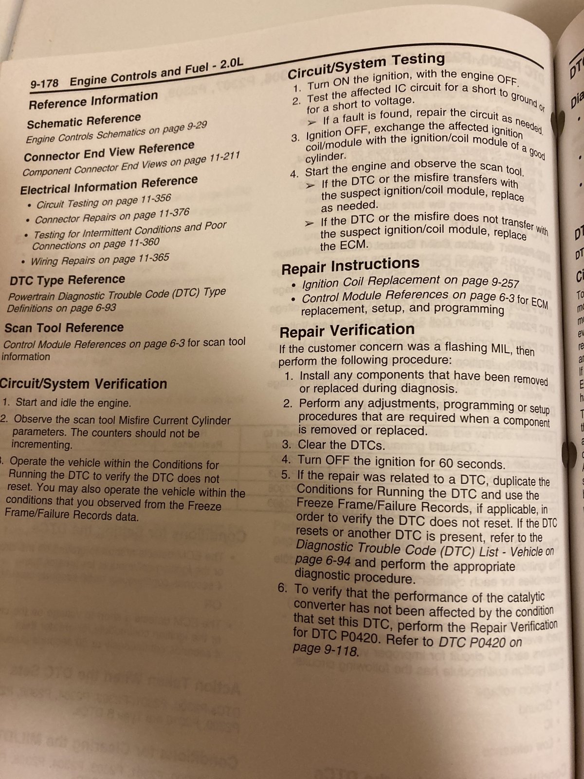

Does the trouble code P2301 show up with ignition on but not running? If so you should be able to check for 12v at pins B & C per the diagram in post #308. If it doesn't show up all of the time, I would run all 4 wires new from pin on one end to pin on the other or at least pins C & B. If it still happens swap the coils again to see if it follows. if it doesn't follow then ECU. I don't think there is anyway the BCM could cause the problem. (someone may need to confirm the repair procedure I posted with your ECU, but I think it should be the same)
There is a chance the P2301 is a coincidence with your problem, but I think you need to fix the DTC before you can move on.

I have this PCM with a Z54 turbo tune just sitting here, Tune fixed by Chad !! Before you buy one , try before buy .
I went back to the stock KO4 turbo, and stock PCM —— I just want to drive it like I stole it :D:eek:
