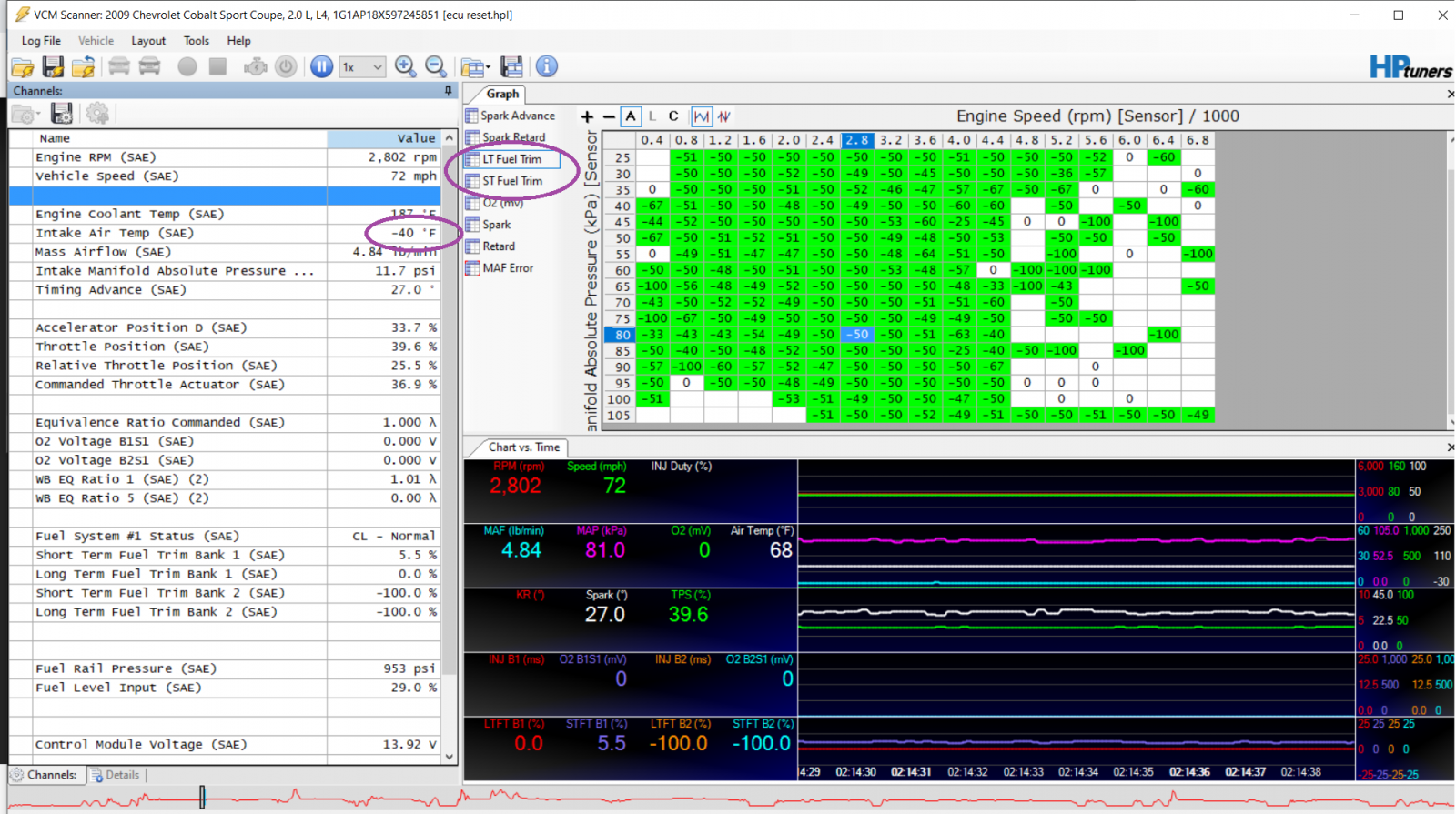

Your intake air temp stays at -40F, and the fuel trims are a long ways from 0... nearly maxed.
Fix a few sensors, and it will be a lot happier. I'm amazed at how the ECU can compensate for missing info. My engine was running with a MAP sensor that was equal to outside air pressure instead of intake air pressure... somehow it was able to compensate for bad data!
Isn't the IAT read in the MAF? I just replaced the maf with a brand new one..... You also see that the o2 sensor is not reading anything also right?

Yes, the O2 isn't reading for me either. Usually the IAT is in the MAF, but I'm not sure on a LNF.
Yes, you want to keep the upstream O2. After the catalytic converter O2 sensor can go, as most of us don't run the cat.

No IATs is a problem... that is info the ECU needs, and will affect fuel ratios. Maybe see if there is other parameter fields in HP Tuners that are being populated. Sometimes I grab the wrong param, and in reality, the data is actually populating. With your trim tables maxed, the ECU is not getting everything it needs.
Can anyone confirm how many grounds there is on the LNF engine harness? I can't believe the MAF would read one but not the other. So **** frustrating.

Most of those are expected.
Fix these two, and see what left.
0x544: U2113 (Current, History) - probably from the missing O2 sensor data
0x7E8: P0113 - Intake Air Temperature Sensor 1 Circuit High
You can turn off reporting of most of those codes. Of course ABS module is missing, emission missing, AC pressure sensor isn't hooked up to your wideband O2 sensor yet...
