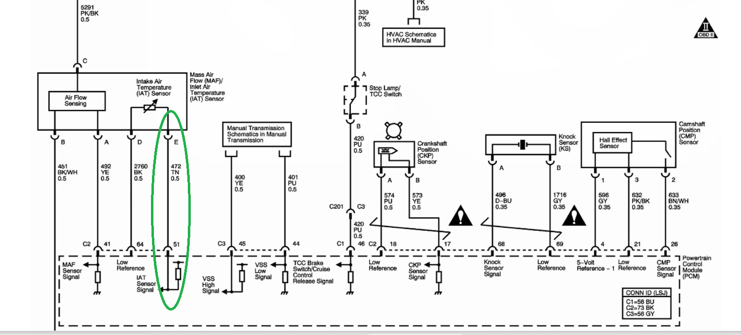

So, From what I read when I jump the light blue and tan wires together from the MAF plug, the IAT1 should read 300, when i un jump them -40. But when I jump them HP tuners just still reads -40..... I'm getting the proper 12v power but just no IAT temps..... New MAF same thing.
Nuker-

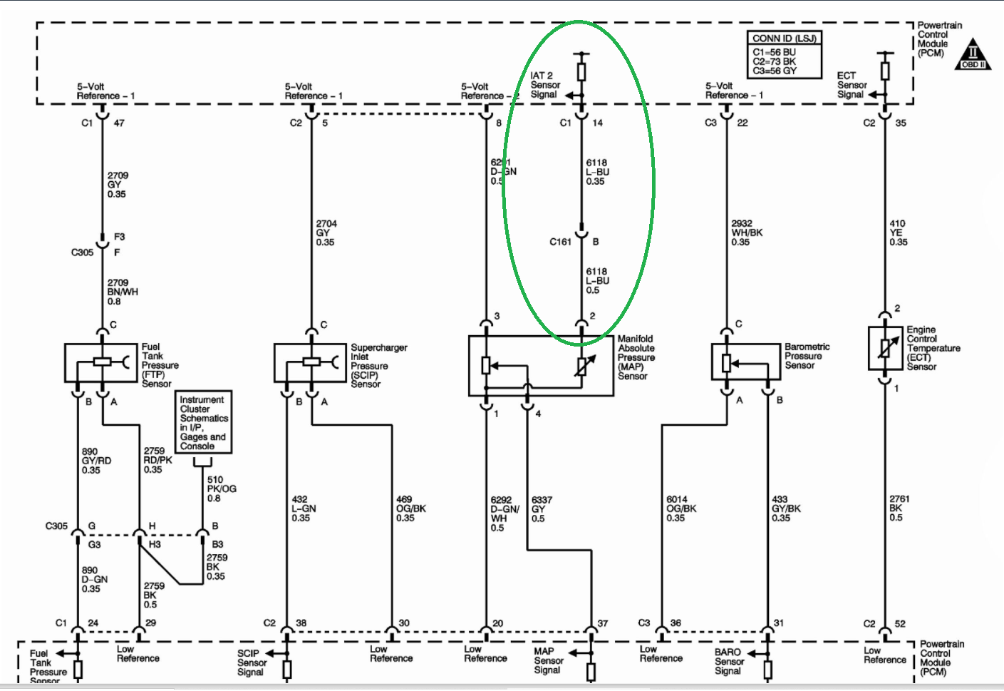

Is it using IAT2 from the MAP sensor in HP Tuners?

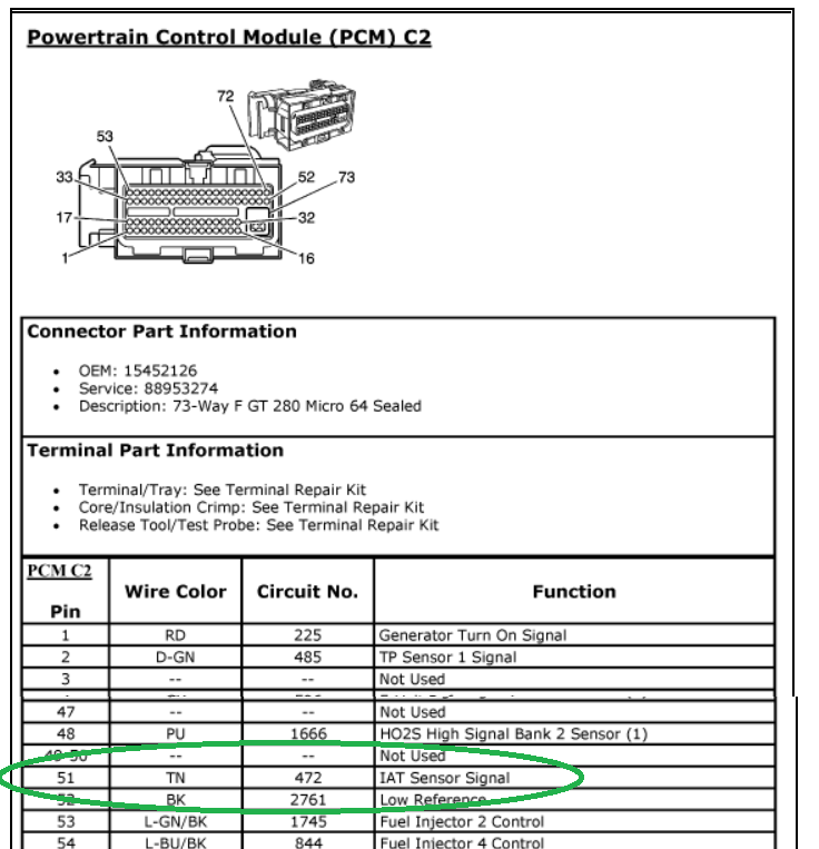

If it is using IAT from the MAF, is the signal getting to the PCM?
This is electrical diagrams from my 06 LSJ... which has the Tan wire going from the MAF to the PCM, C2 connector, Pin 51.

I believe I was getting the 5 or 5.5 volts on the tan and blue. I'll confirm again tomorrow. It should be the IAT1 I'm guessing. I'll have to see if I can find in HP tuners where to see both IAT1 and 2 I guess I just assumed it was IAT 1.

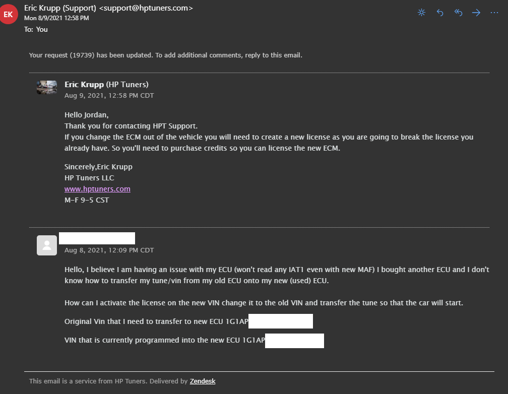

Also look at this BS from HP tuners. Basically sorry you had to buy a new ECU you can't transfer **** so give us 100$ more credits.
Unfortunately, that's not surprising. For every honest customer that has a legitimate need to do a transfer, there are probably a hundred "tuners" that would abuse that ability to avoid paying for credits for each car they tune...

They got me also , I didn’t know mine was locked and before I even started trying to do anything with HPTUNERS I bought 2 credits. That ended up being useless unless I figure how to unlock it

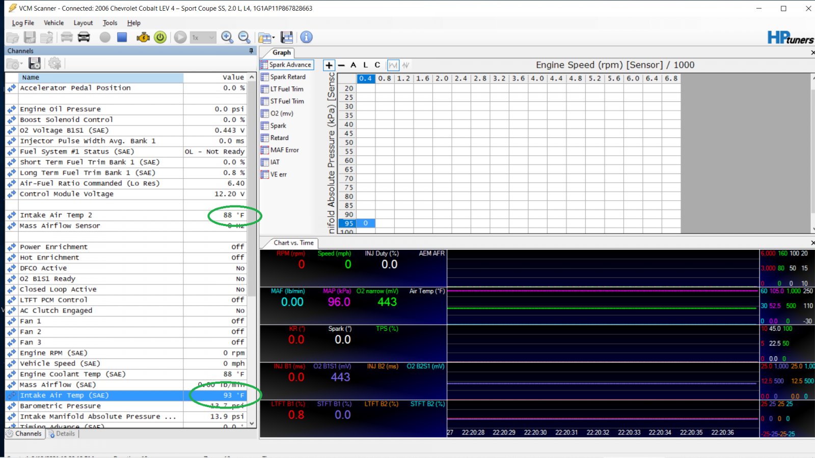

Can anyone confirm that their IATs read when ignition is turned on but engine is not running? Just trying to do more testing without starting the car 100 times.
Nuker-
If the engine is cold, and the system is calibrated, the intake air temperature will be ambient temperature.
My shop is 78F.
Right. I turned on the key, and could see my IAT and IAT2 without the engine running. I did start logging in VCM Scanner.
Oddly, the ambient air temp sensor wasn't showing up on the graph.
