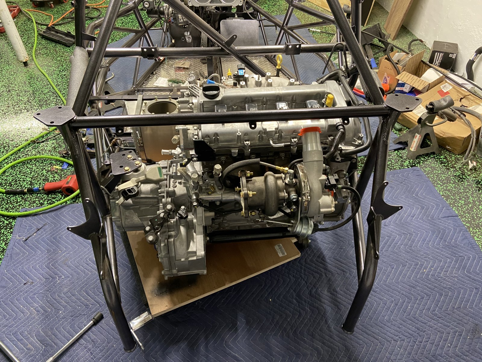

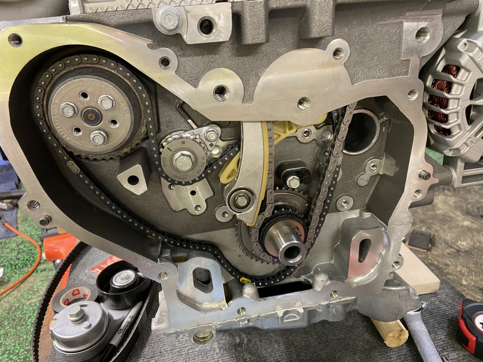

Is this side engine mount bracket tilted on other LNFs just making sure This is the right part...
Thanks,
Nuker

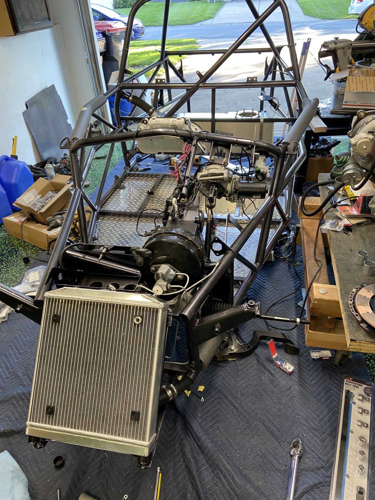

Got a few things done today, kinda in holding pattern until ZZP sends back my defective lightweight flywheel.... nothing like RMA taking 2weeks....
Nuker-

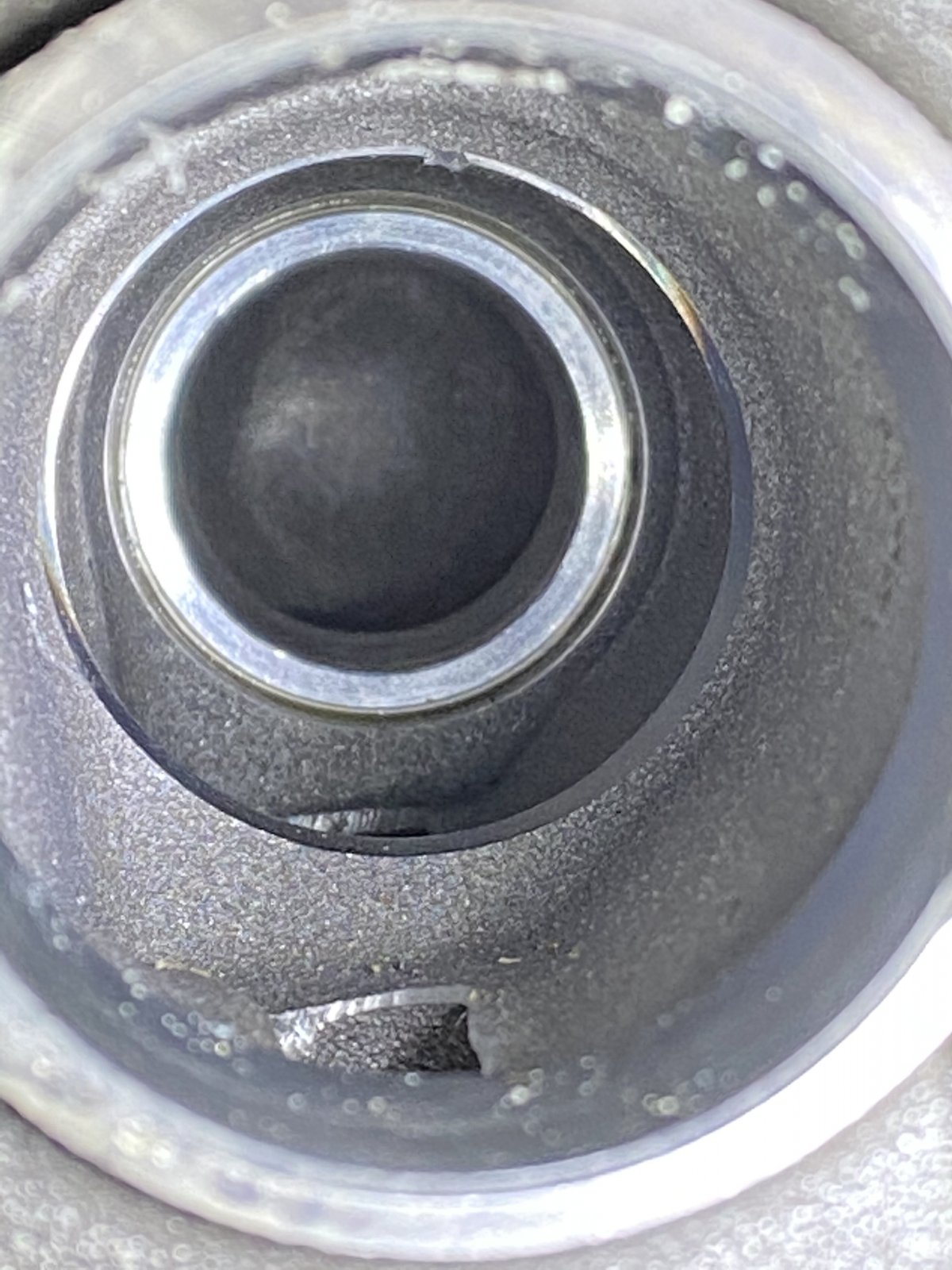

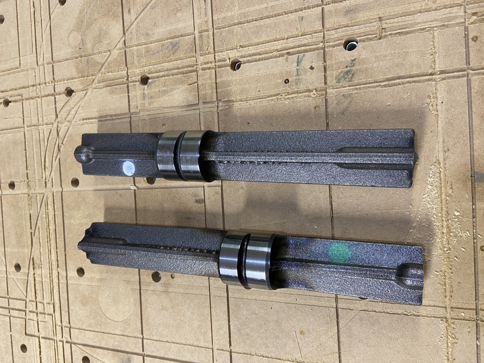

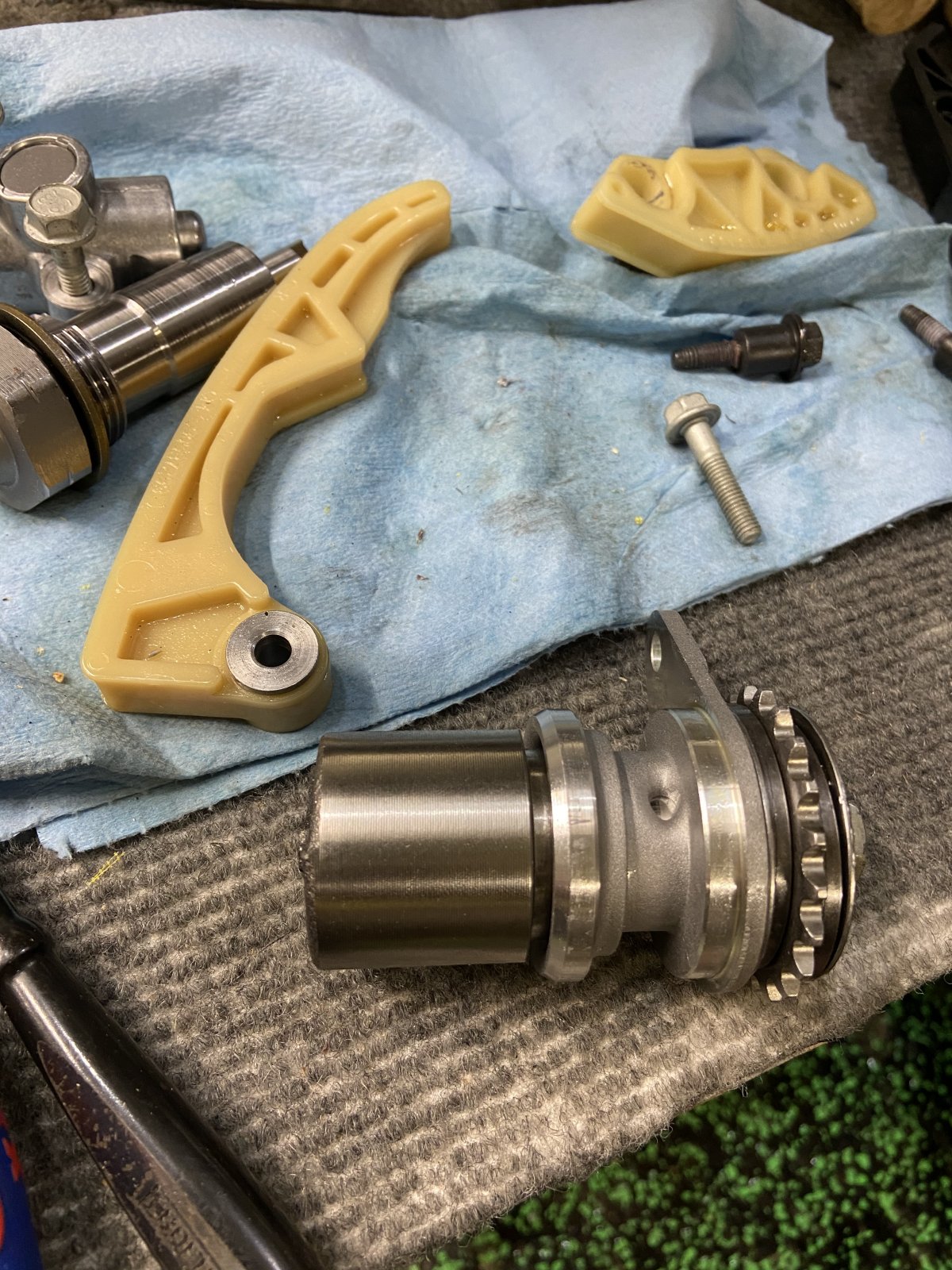

Balance shafts! Who needs those!
had to tame that beast to get the required torque on the crank pulley!!!
Nuker

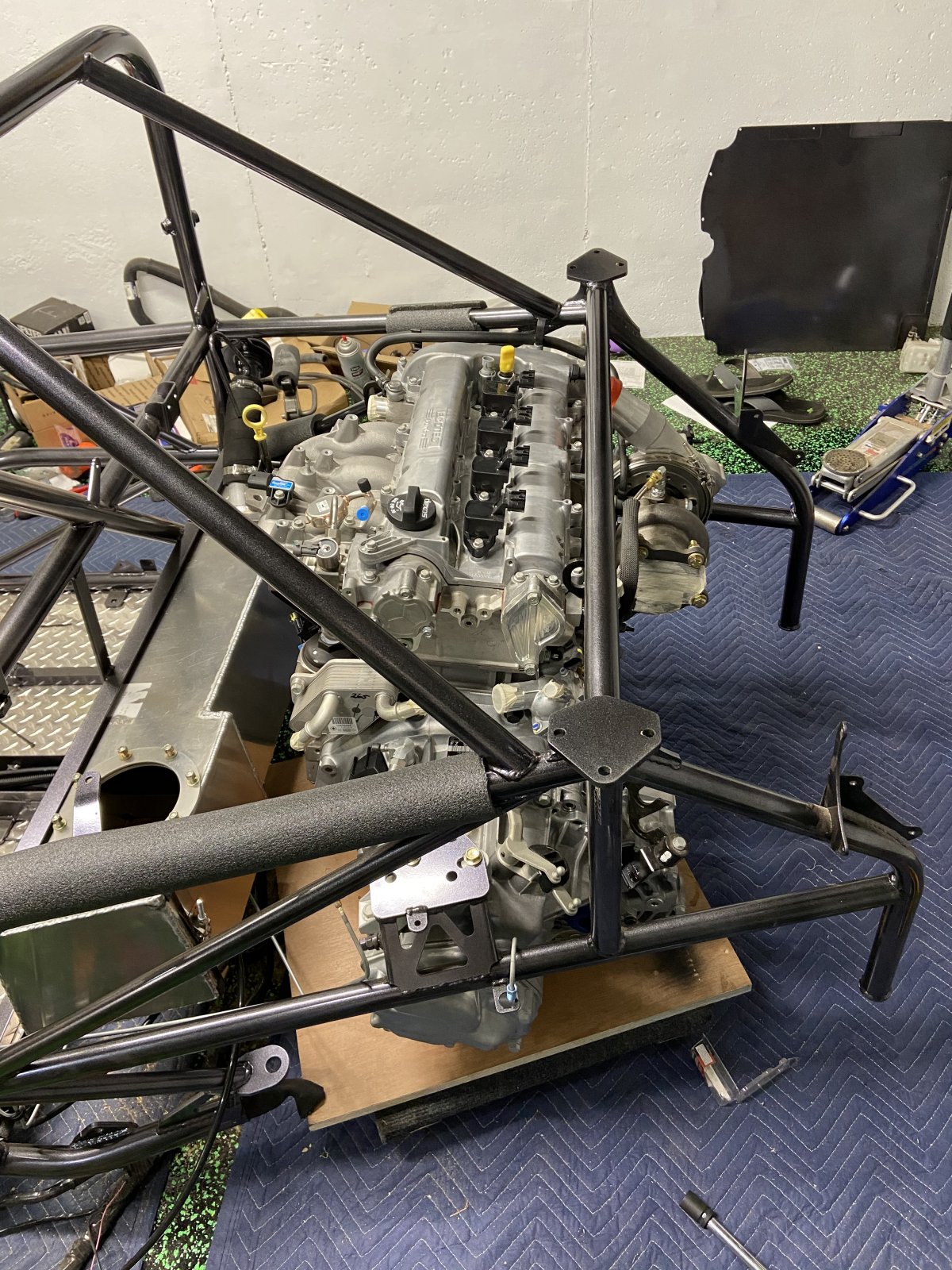

TheNuker
It was a struggle hahah, Hoping to get the engine in finally as the **** flywheel showed up after 3 weeks waiting for a replacement from ZZP!

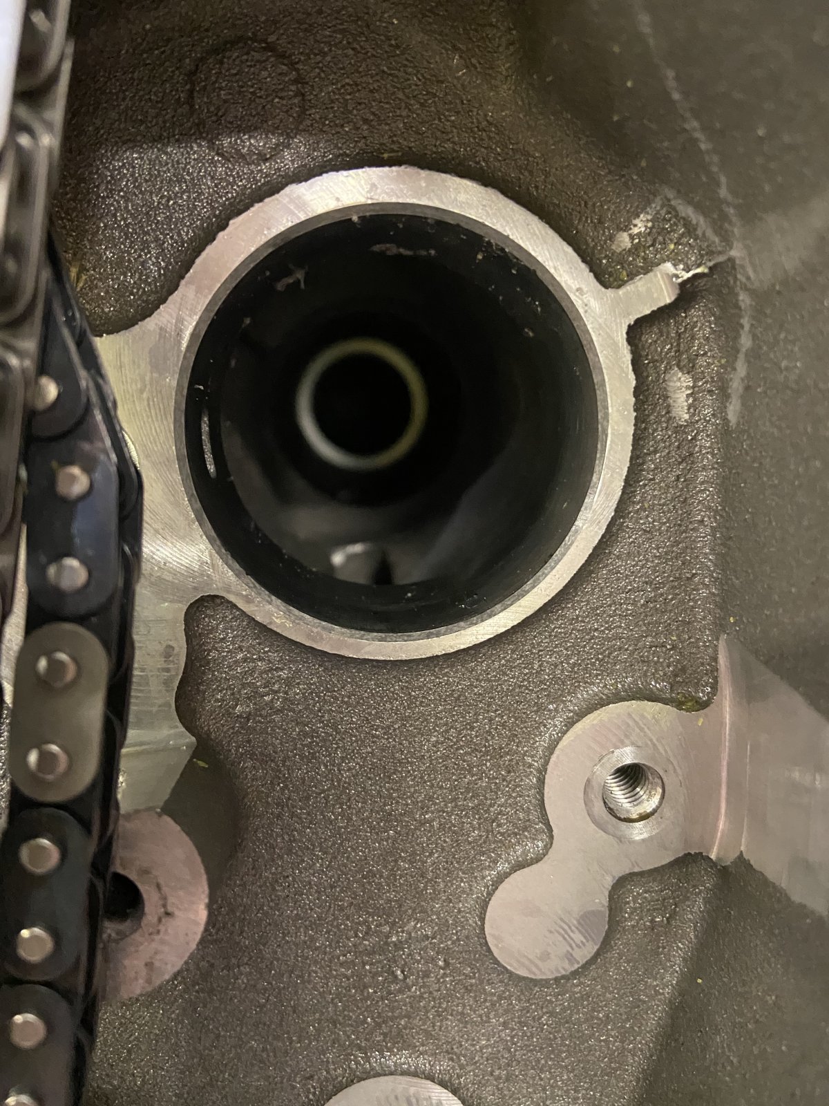

Hope this one fits. :) Assuming the black 'shafts' in your 6th posted pic is the oil galley mate up to keep correct flow and pressure?
The black shafts in that pic are the balance shafts I took out, I forgot to take a picture of the sleeves I had to pound into the block before they were in. The picture looking down into the engine picture 2 shows the sleeve seated in the block. I 3d printed a special adapter to put them in centered. Those block the oil flow and keep your oil pressure up.
So I was able to free up about 9 more pounds of weight on the rotating mass! That with the flywheel I've lost 18 lbs!
Nuker-

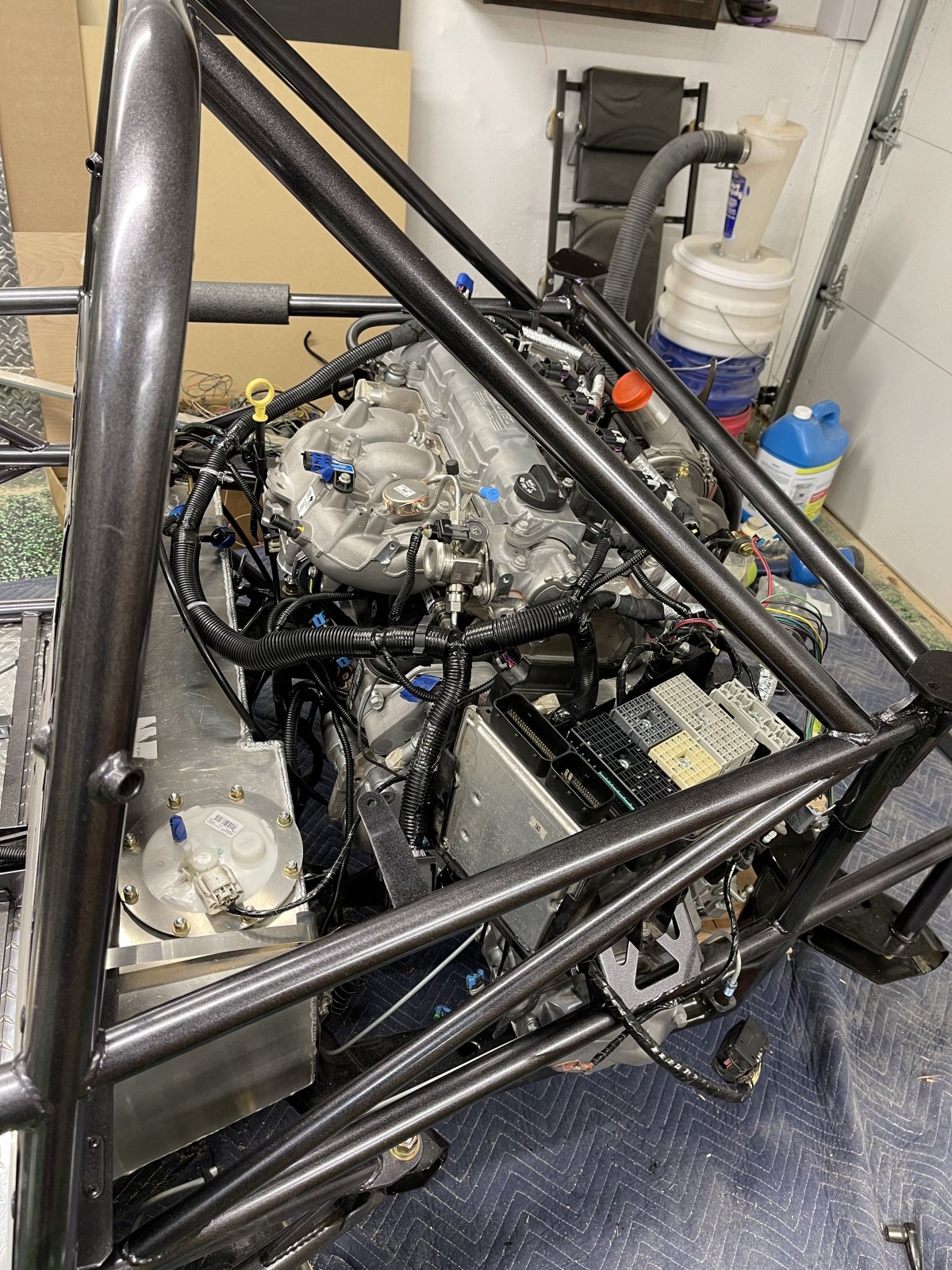

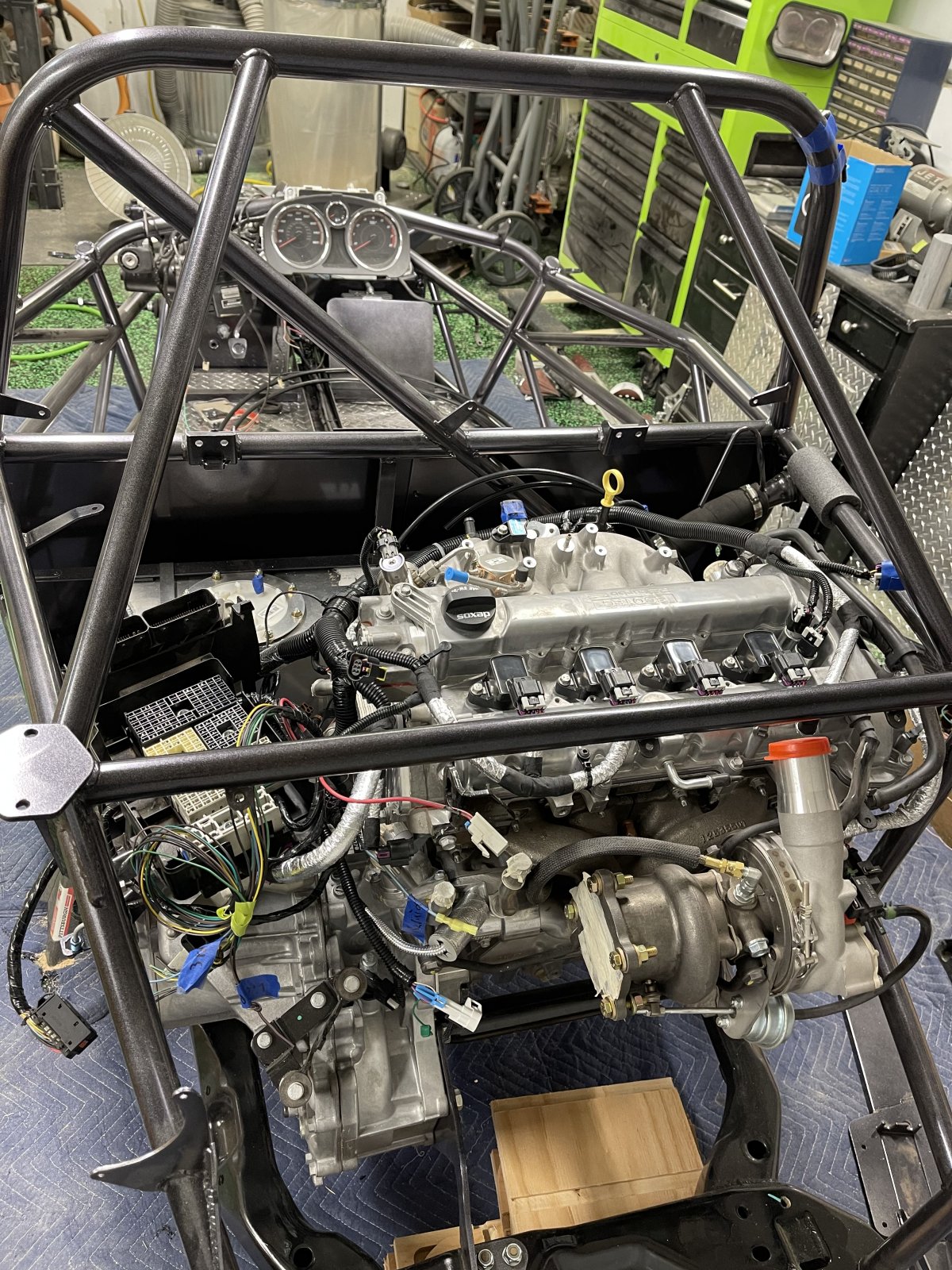

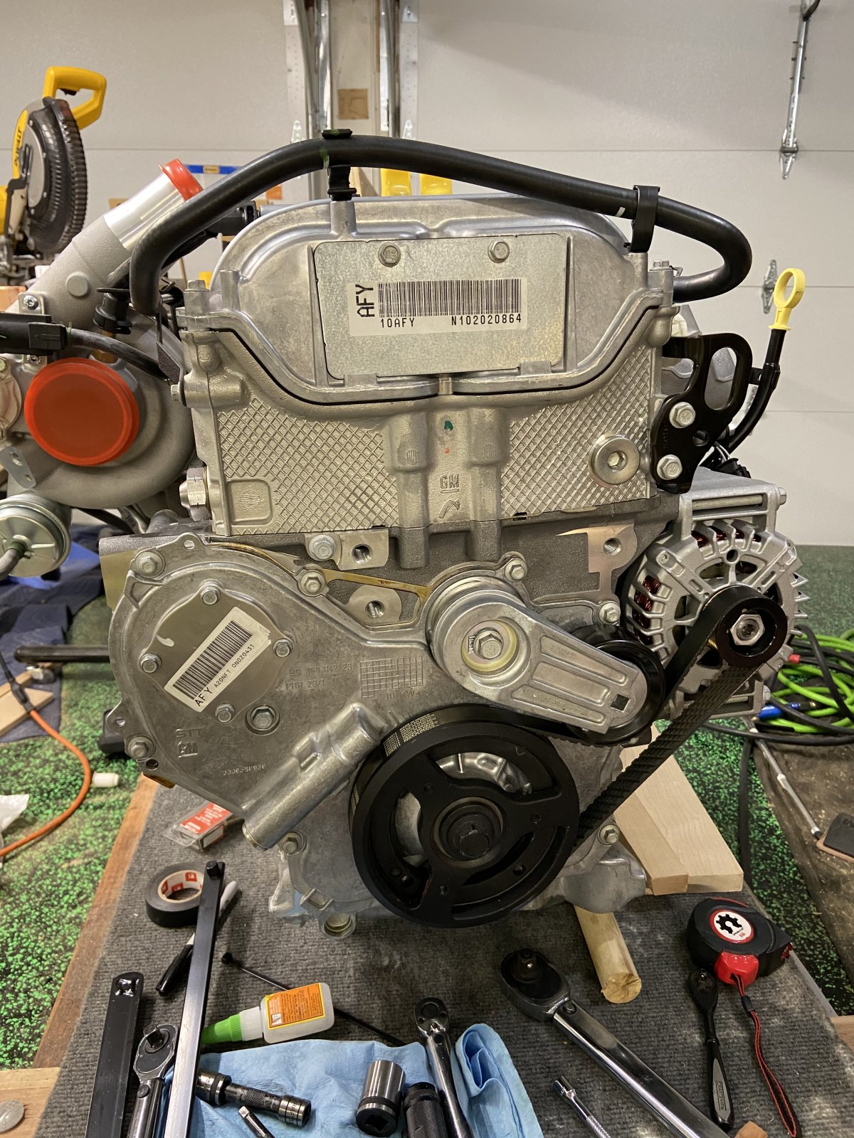

Phew its been too long huh! Got stuck in PH again haha, Back to this artic cold and making progress.
I gotta get this thing done before spring for my own sanity..

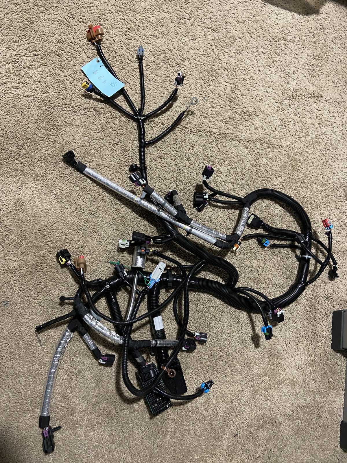

Got a bunch of the wiring done and inplace today. I'll work on fuel lines and all of the hoses on the engine. If anyone has pics showing what hoses go where that would be great!
Also where can I get a flange that bolts to the turbo exit so that I can have a custom exhaust built?
Thank!
Nuker-
