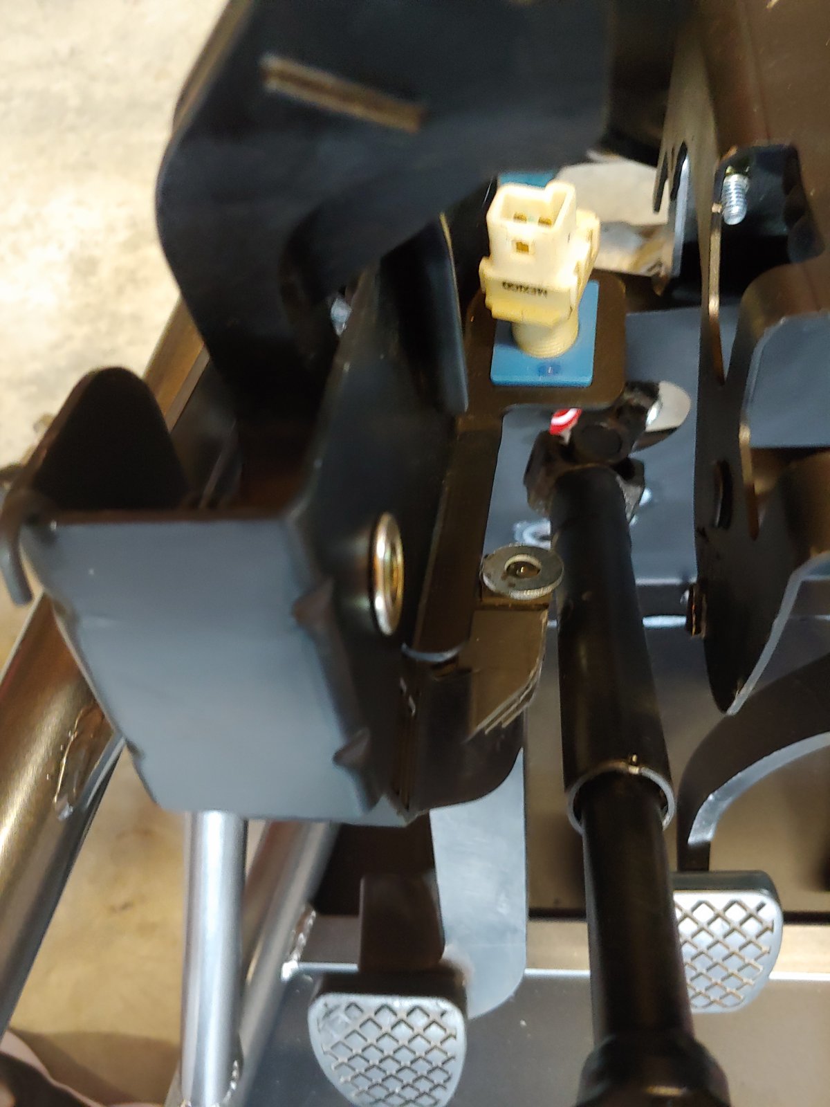

Its powder coated. I opted not to move it when I was making mods.
The bolt holes are not seen and somewhat protected. A little nail polish to cover the bare metal and no one will be the wiser that the powder coating had been removed. Easier than trying to grind off the plastic on the clutch pedal that would likely weaken it.

Here's what I did for my clutch pedal:
21834
I didn't want to bend the mounting bracket because I wanted the pedal throw to be straight, not an arc. I used. Grinder to shave down the side and then epoxyed an washer up to to maintain the button press surface.

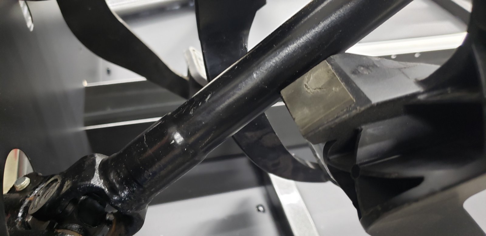

So has anyone had this happen? The boss for the bottom clutch switch is hitting the steering shaft before it is even in place. And of course the switch hits on the outside of the boss so it cannot be trimmed. 07 SC donor

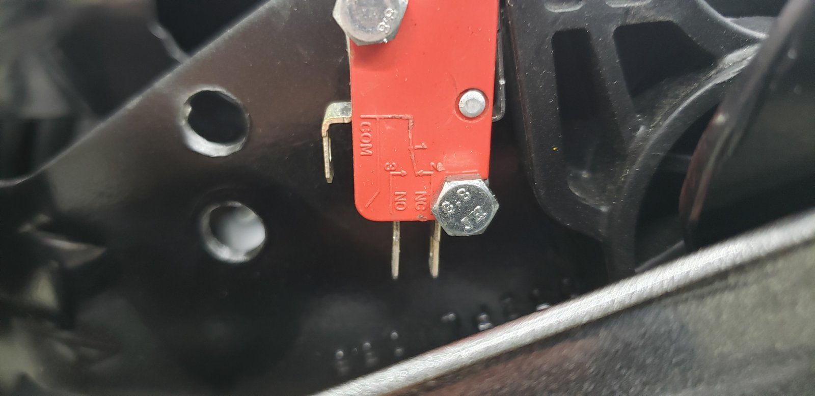

My top switch fix has both N/O & N/C is it possible to wire both to the one micro switch? I know that the purpose of the bottom is to ensure that the clutch is ALL the way in before the starting circuit will be energized.
I had that issue too. I bent the clutch mount a little, trimmed the plastic clutch arm a little, and called it close enough.
Towerdog
Went the route of trimming the boss down a bit,,,, Part of the problem was I needed to grind down the top section were it bolted to the firewall as it was hitting the DF mount and tweaking the angle.

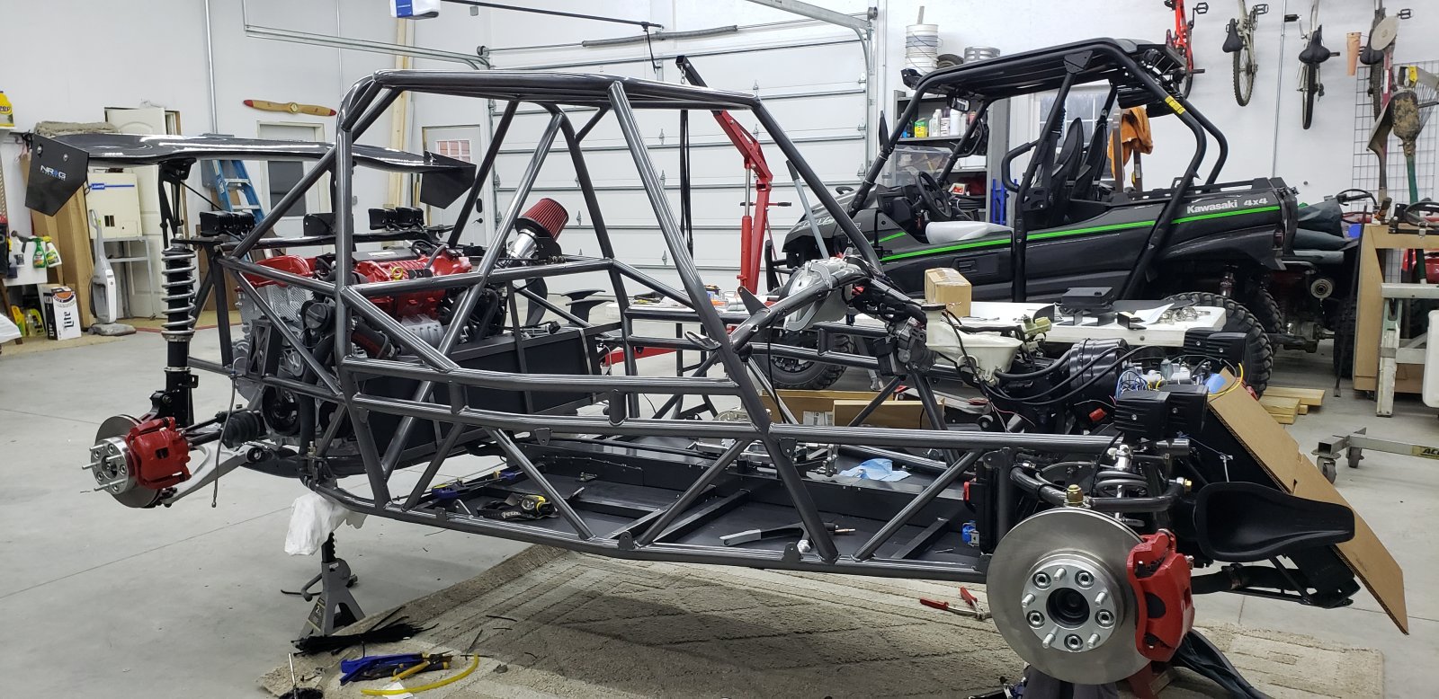

So my build is pretty much at a stand still aside from a wire here a bolt there. I want to mount my fuel tank and get the engine in but I have a few unanswered questions on a few things.

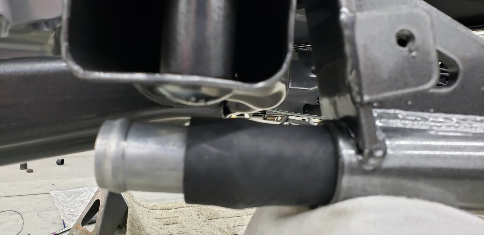

How does the supercharger heat exchange lines connect to the Pex in the tunnel?
How is the clutch line supposed to be routed in the engine bay? I think mine got bent in transit

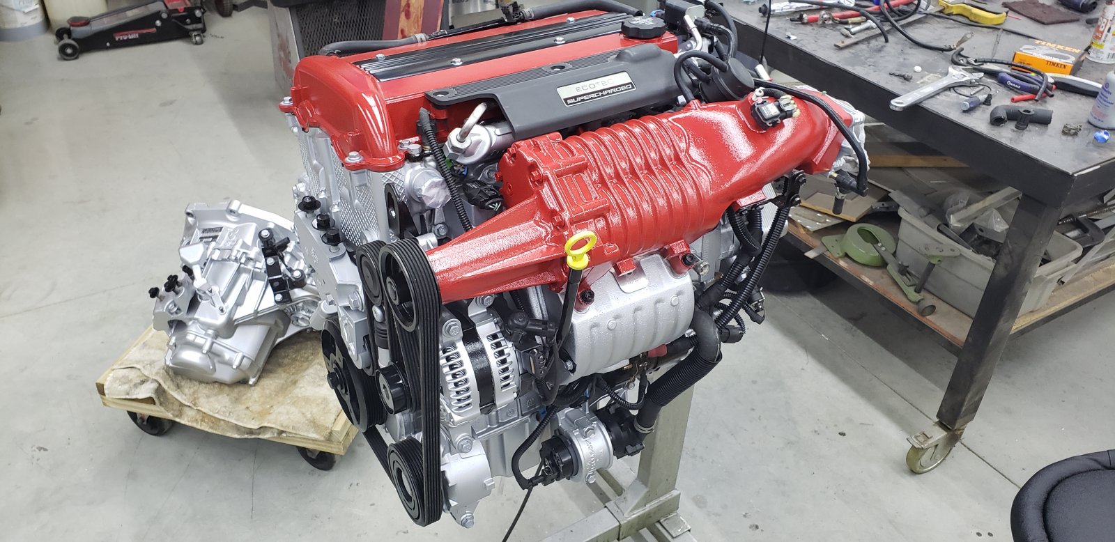

Well its about as far as I can go with it till the clutch kit gets here to re-mate it with the transmission.
It came out beautifully! I saw you cleaned the plastic ecotec/SC fuel rail cover, How did you go about this? What did you use to paint the engine? Did you powder coat the valve covers and SC? I can only hope I'm able to get mine half as pretty.

I just washed the fuel rail cover w dish soap then hit it with F11. The engine is Duplicolor engine primer and paint.

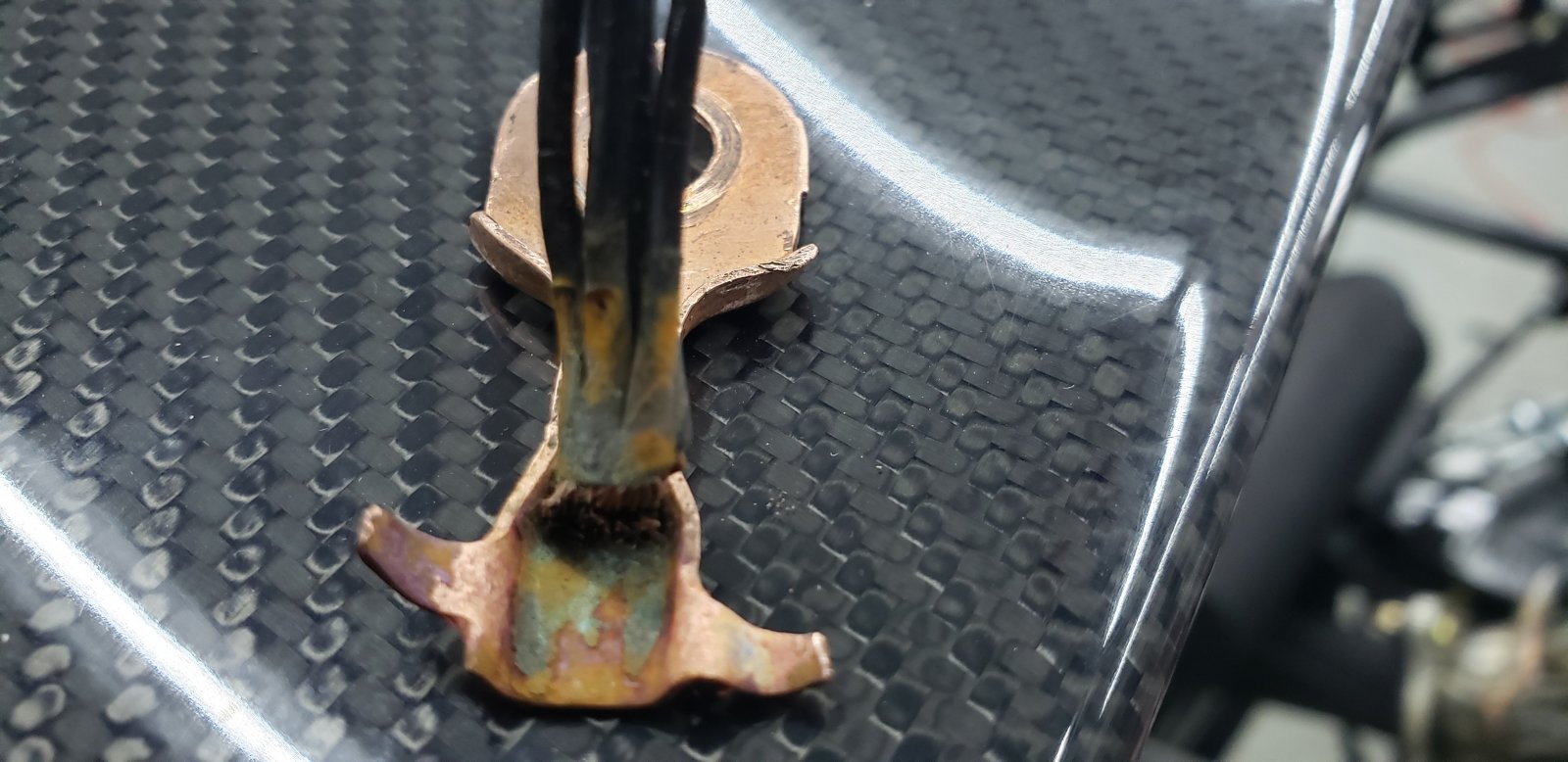

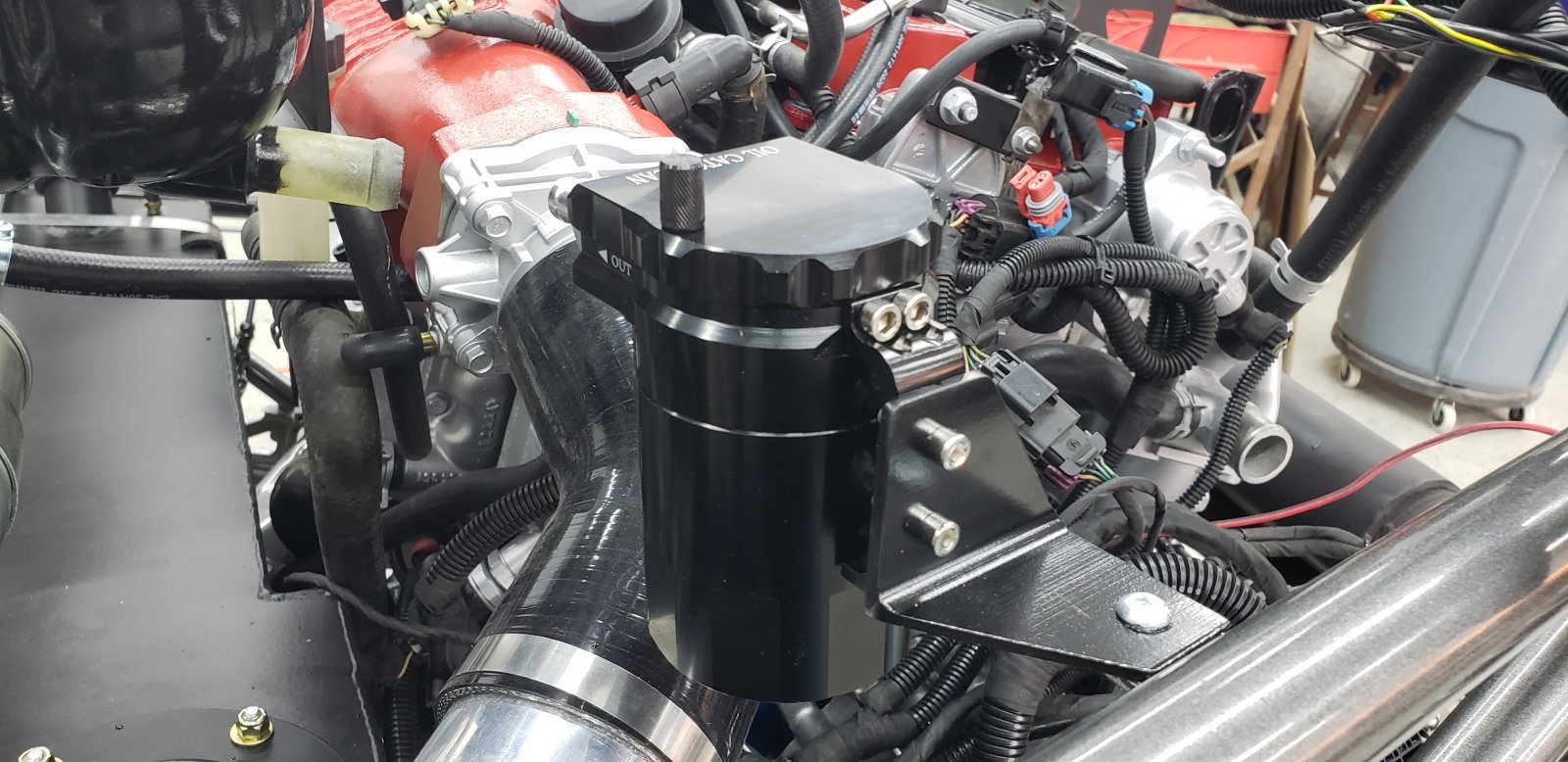

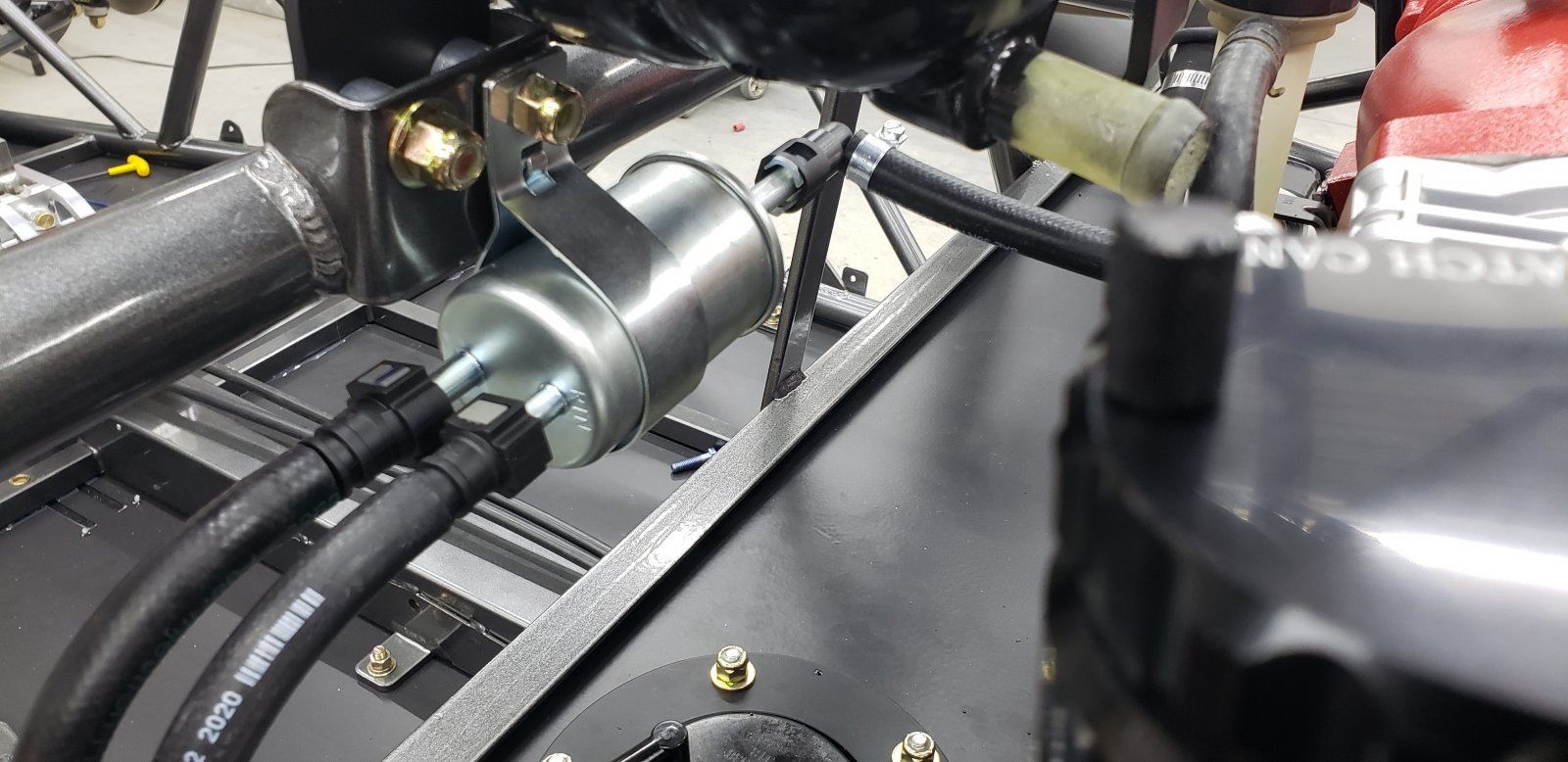

Today I found the gremlin that was causing the tail lights to do wacky things..... Corroded ground wire! The rest of the progress on the car consisted of finishing the headlight wiring along with the what was left up front, (going to have to get a raccoon plug in my horn for me!). Making a mount for the catch can, and mounting the fuel filter and running the lines, Bleeding the clutch and brakes.
