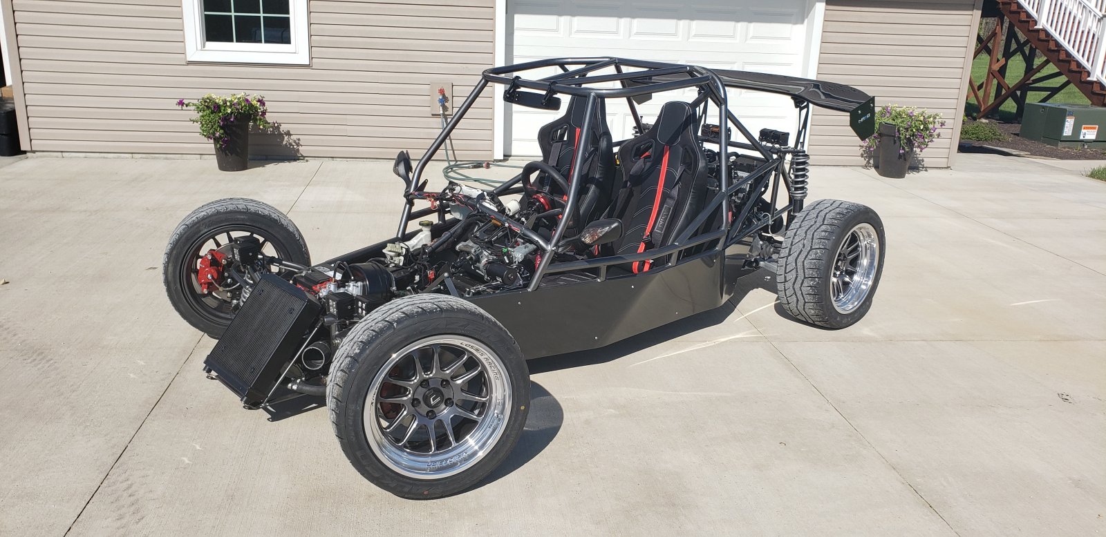

Well an update... I had this week to partially work on the car, Gave it all its fluids today with only one slight leak and one explosive one. The slight leak of course was the intercooler plumbing and it was a connection in the tunnel so I had to drill that out to get to it. The explosive leak was the high pressure fuel line at the filter..... The fittings were just slid on and not seated a few weeks ago due to not having hose clamps for them yet. Took that blast right in the leg!
I am still waiting on some cheap seats off eBay to show up since NRGs are BO till mid July, All the wrap material will be here next week, My tires came in yesterday and I was planning on doing the alignment tomorrow, Even had a couple friends that were coming over to sit in it while I did it. But the tire shop is booked out till next week so maybe next weekend.
I have a trade show to do in Dallas next week so I set it up with DF to stop say hi and get my MCO.. Put a call in to my neighbor to come and inspect it to apply for a title. And luckily was able to keep my calendar clear for the week after next so I should be able to wrap it up then.
Ohh yea forgot to mention.. I started it today. One touch of the key and she came alive and purred like a kitten... Well almost the idle was a smidge high when it first fired but my guess is that had something to do with the gas fumes on the air filter from above mentioned gas leak.

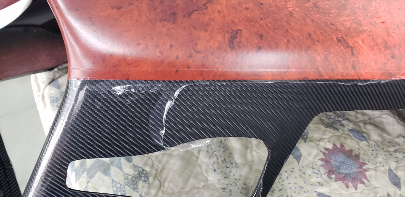

Well this week so far I managed to slip some time to the Goblin and got the two side panels wrapped and installed, Ad some $17 farm store rubber floor matts, Finnish the alignment and take it for a spin!
The Pros: It tracked straight didnt seem squirrely at all, Trans ran smooth... Big relief! Had planned to keep it under 40mph but 2nd gear at moderate throttle puts it over 60 pretty quick!
The Cons: It felt like the clutch was only disengaging at the very end of the stroke so I put it back in the shop. Sure enough there is brake fluid leaking out from the bottom of the bell housing where it meets the block.. Can't tell were exactly it is coming from, Going to have to wait till I can get someone to cycle the pedal while I watch with the camera to see where it is leaking.... The worst place possible to have an issue. If its the slave cylinder or the clutch pipe I have to drop the engine and pull the tranny off!
