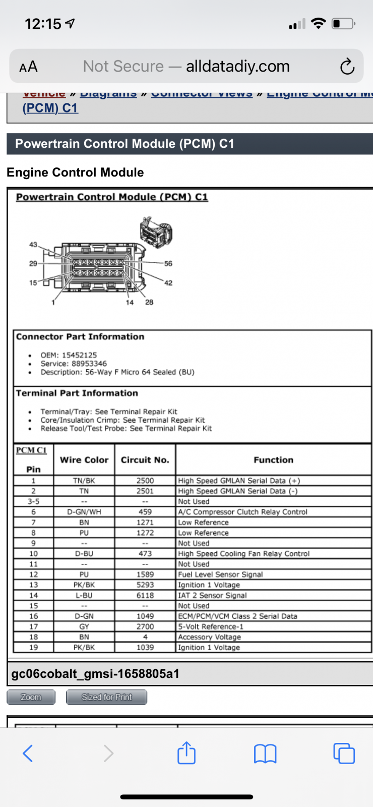

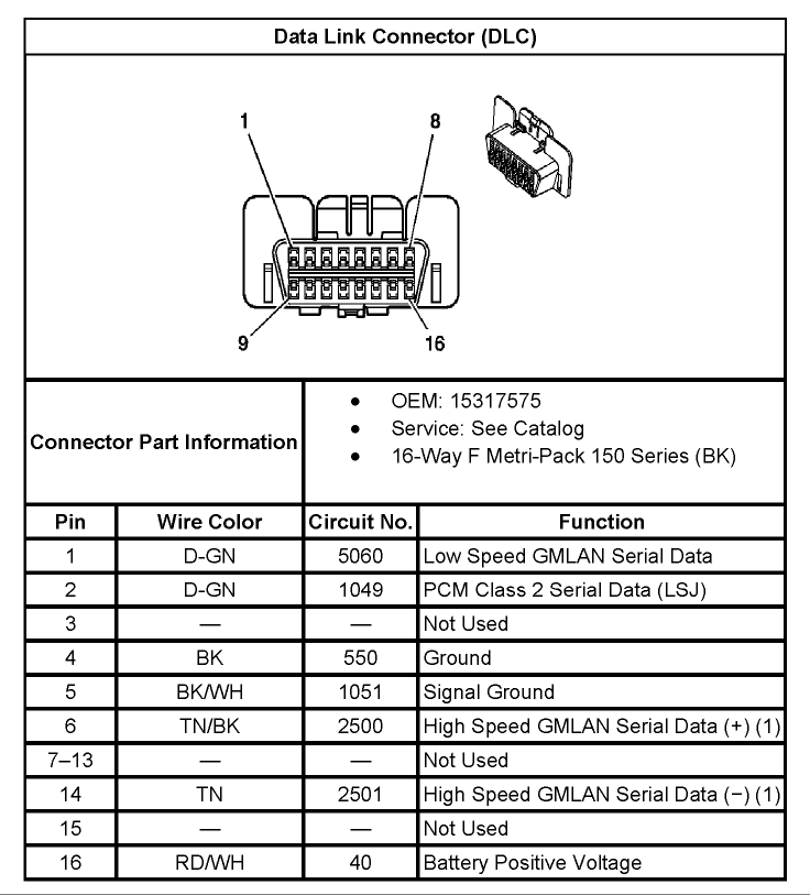

Check continuity from pin 2 on OBDII and pin 16 on PCM C1 Pin 16 (blue connector at pcm).
Pin 2 on the OBDII is a serial data connection on the LSJs and it’s the exact same color as the low speed GMLAN wire on Pin 1. @ToxicBill and myself both soldered these with the rest of the low speed GMLAN cables which causes the OBD to have connection issues when using a reader or HPTuners.
As far as the fuel pump goes, I’ll have to pull the schematics from alldata, but at least this may fix your OBD issue.

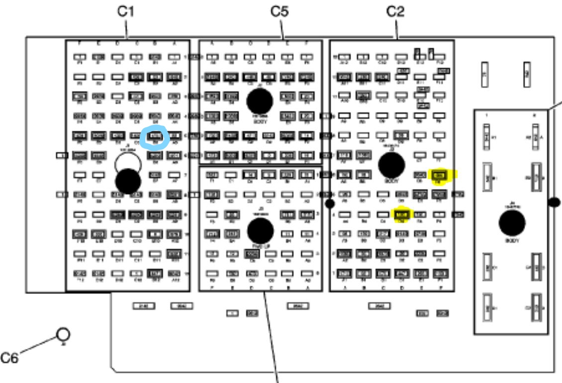

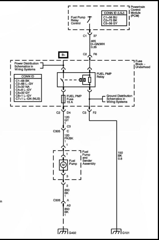

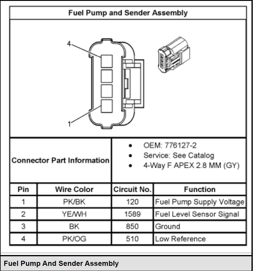

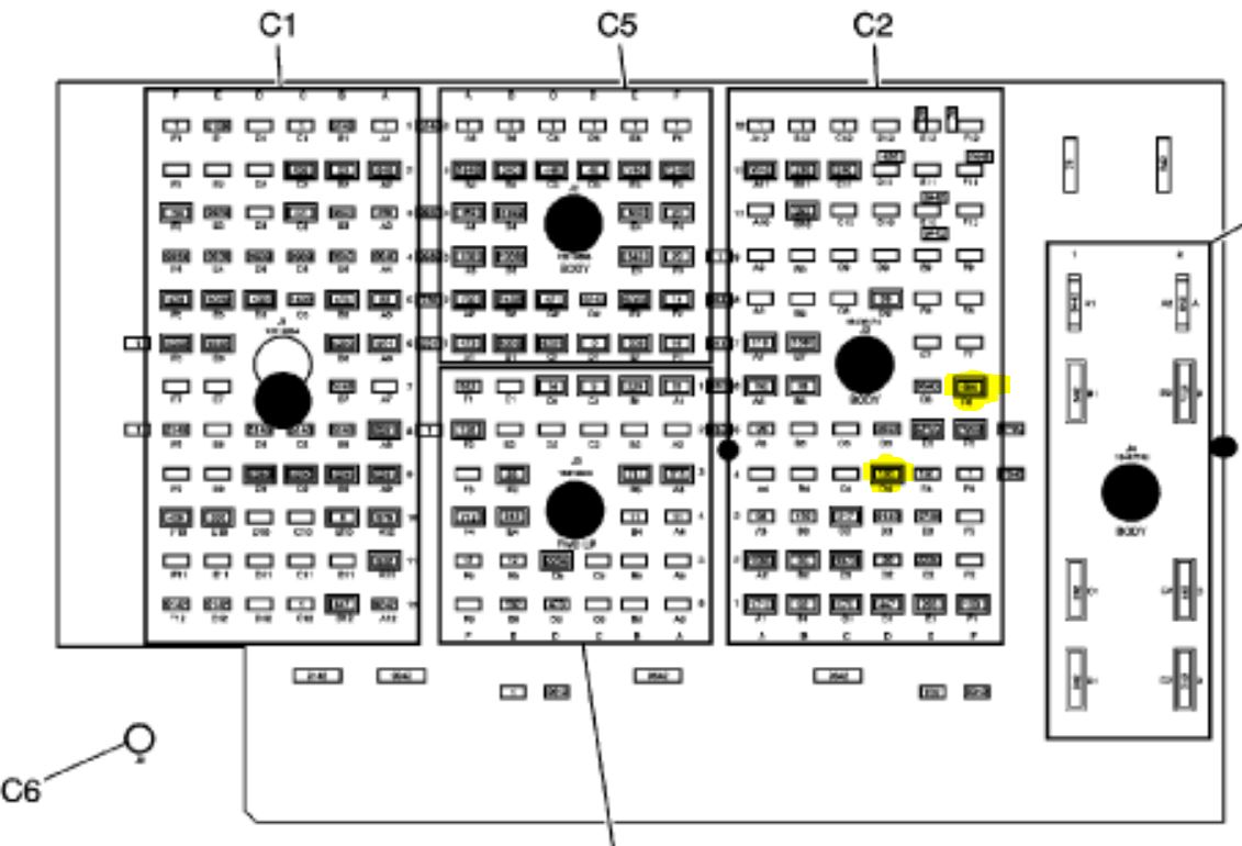

PCM C1 Pin 37 is the Fuel Pump Relay Control and goes to fuse block C2/F6 (C2 is the block that has the corner cut out of it and closest to the power distribution block in the fuse box). so check continuity between these 2 connections.
This is where it hits the relay and signal will come out at C2/D4 going to the fuel pump connector on pin 1. Check continuity here as well.
The quickest way to test it is just test continuity between pins 1 and 2 in the OBD2 port.

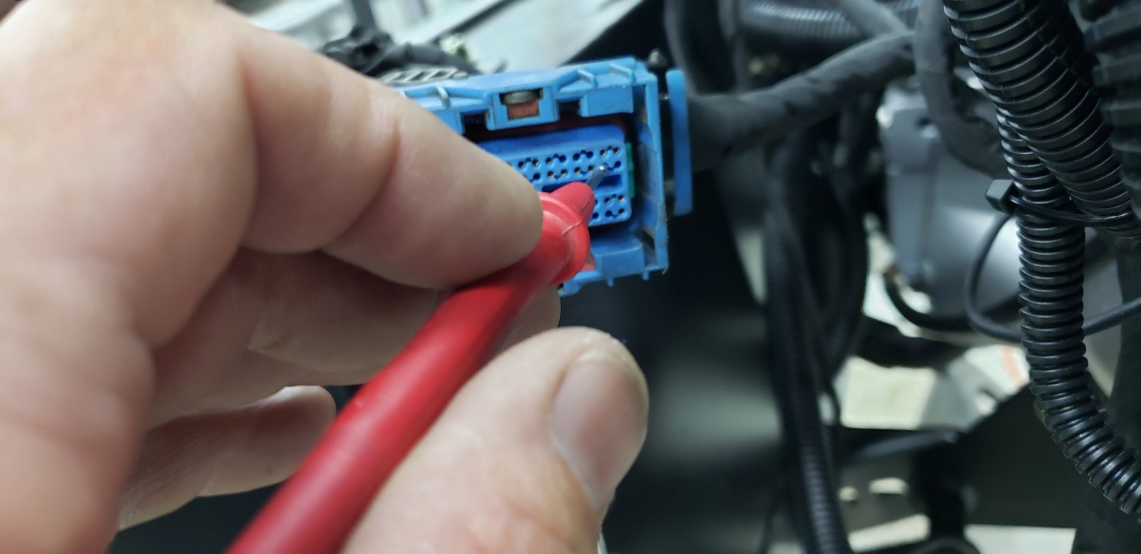

Ok I do not know how the blue ECM plug pins out but I have continuity from the OBD II pin to to this pin on the ECM blue plug. The wires come out of the right side in pic.
R
No, pin 1 is the low speed gmlan, pin 2 is the serial data connection directly to the PCM.
I was fighting a connection issue to the PCM using an OBDII bluetooth adapter and with HPTuners this past weekend. Everything else on my harness worked except that. Once @ToxicBill pointed me to the pin issue I found my issue and resolved it.
I have cont. between 37-C2/F6 but not 1-C2/D4
