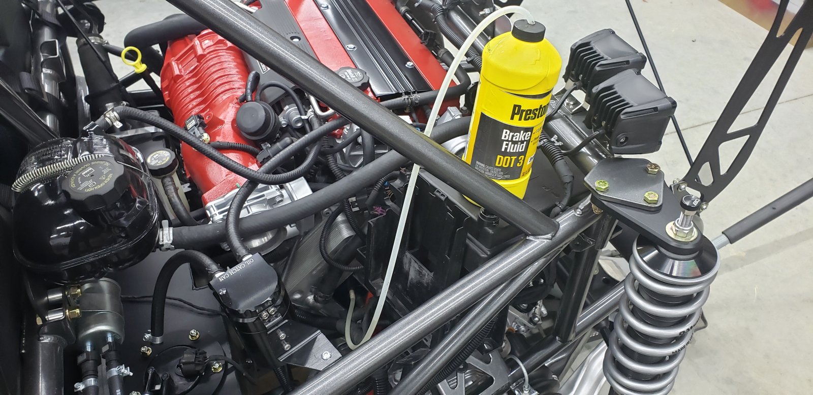

Try bleeding without that bottle added to the top of the reservoir that continually adds fluid. Just thinking out loud, if that’s sealed, I wonder if that keeps from flowing fluid because without air the bottle will hold the fluid. If that makes sense.

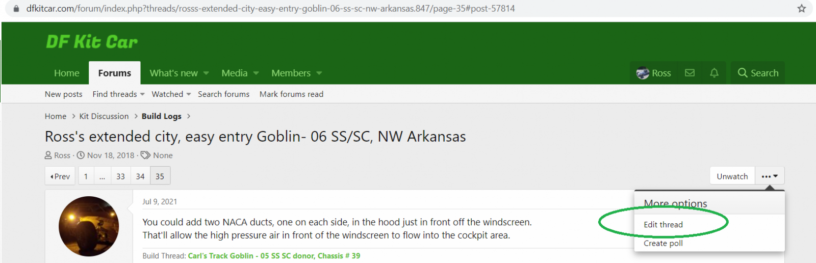

Since you started the thread "2021 Complete Goblin for sale",
you can change the title. Maybe "Not for sale"
Above post #1, Choose edit thread.
It is not sealed... and I just add every few pumps of the pedal to top it off. I know it shouldn't leak and has not in the past but I want zero chances of fluid in the car. Good thought though.

So I was able to convince my client to let me cram 2 days of training into 1 long day. Got home and dove right into the Goblin. Tearing the intake, ecu, and fuse box out has become second nature by now. This is the setup I have....
I have already slowly pumped a half a quart through it and still have constant bubbles. I think they are getting less but it seems like alot for such a small line. I have the car at about a 20° angle up in the rear to alow any air to float up the hose. I am going to leave the bleeder cracked all night and let any air out that I can. Will continue to see if pumping with the bleeder cracked gets me to a point of no bubbles in the morning.
Any input would be great.

Are we talking about bubbles half the size of the diameter of the hose, or little tiny bubbles entrained in the fluid? It probably took me a quarter of the bottle to get through the bigger ones and then another half a bottle to get through the tiny ones. I'm planning another bleed here soon to see if I can get more of the tiny ones out by giving them a chance to rise. I'm thinking I had air in the slave and then all the cycling of the system mixed the air and fluid enough that it will take some time for it to all separate again.
No we are talking up to 4" of air voids in the hose even this morning.
