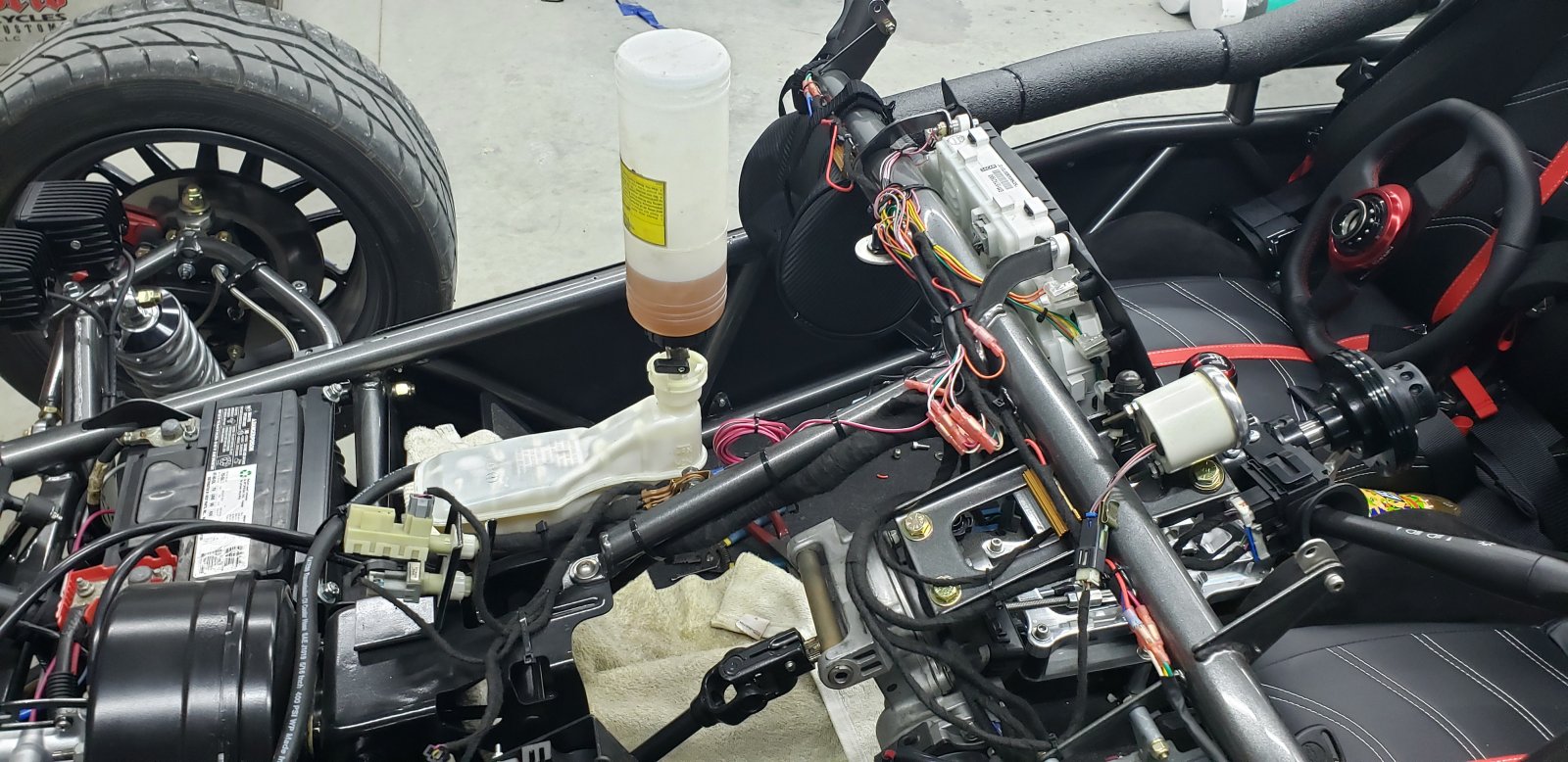

So I had a six hour flight to Alaska today and have had time to ponder, think and read! Some Miata guys were complaining about the same thing.... someone stated that the long horizontal run across the firewall will hold air... well mine was "fine" until I went down my steep driveway then gonedy. So I think I will bleed it one more time with the back end jacked up, Vac it then pedal pump.

I used a vacuum pump on both my brakes and clutch. I haven’t had a single issue yet. I will tell you it took 2 quarts of brake fluid to fill the system and to remove all the air.

Lonny has stated a couple times on here that the stock reservoir requires a high level of brake fluid in it in order to bleed the clutch, otherwise it starts to pull air again. My recommendation would be to change to a dual reservoir setup. That’s what I will be doing during my build. But I’m also switching to manual brakes and going to be using the Wilwood kit: Tandem Remote Master Cylinder - 7/8" Bore,Black https://www.amazon.com/dp/B01MUR2AH...abc_K0XM5GC8WXP52AC69MTG?_encoding=UTF8&psc=1
Towerdog
This keeps it full..

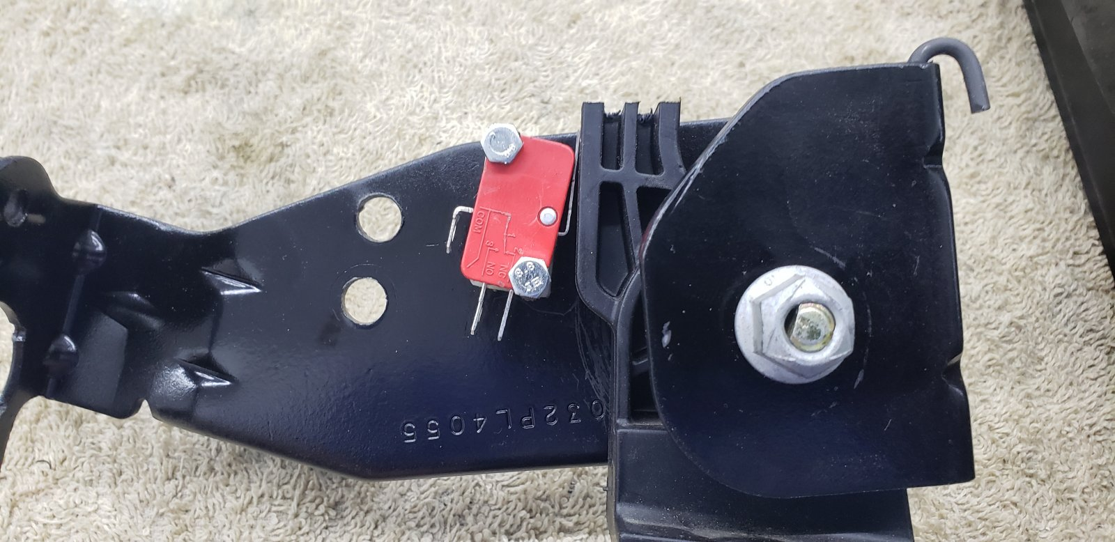

I was looking for pictures of your brake and clutch line set up at the front of the car, and ran across this picture. Are you sure your clutch pedal is fully extending to the released position? Chad had issues with his brake pedal not fully releasing and causing bleeding issues on his brakes.

And I had to weld a washer as a shim in front of the pedal housing to keep the pedal from over extending. It currently is slightly over what stock was.
