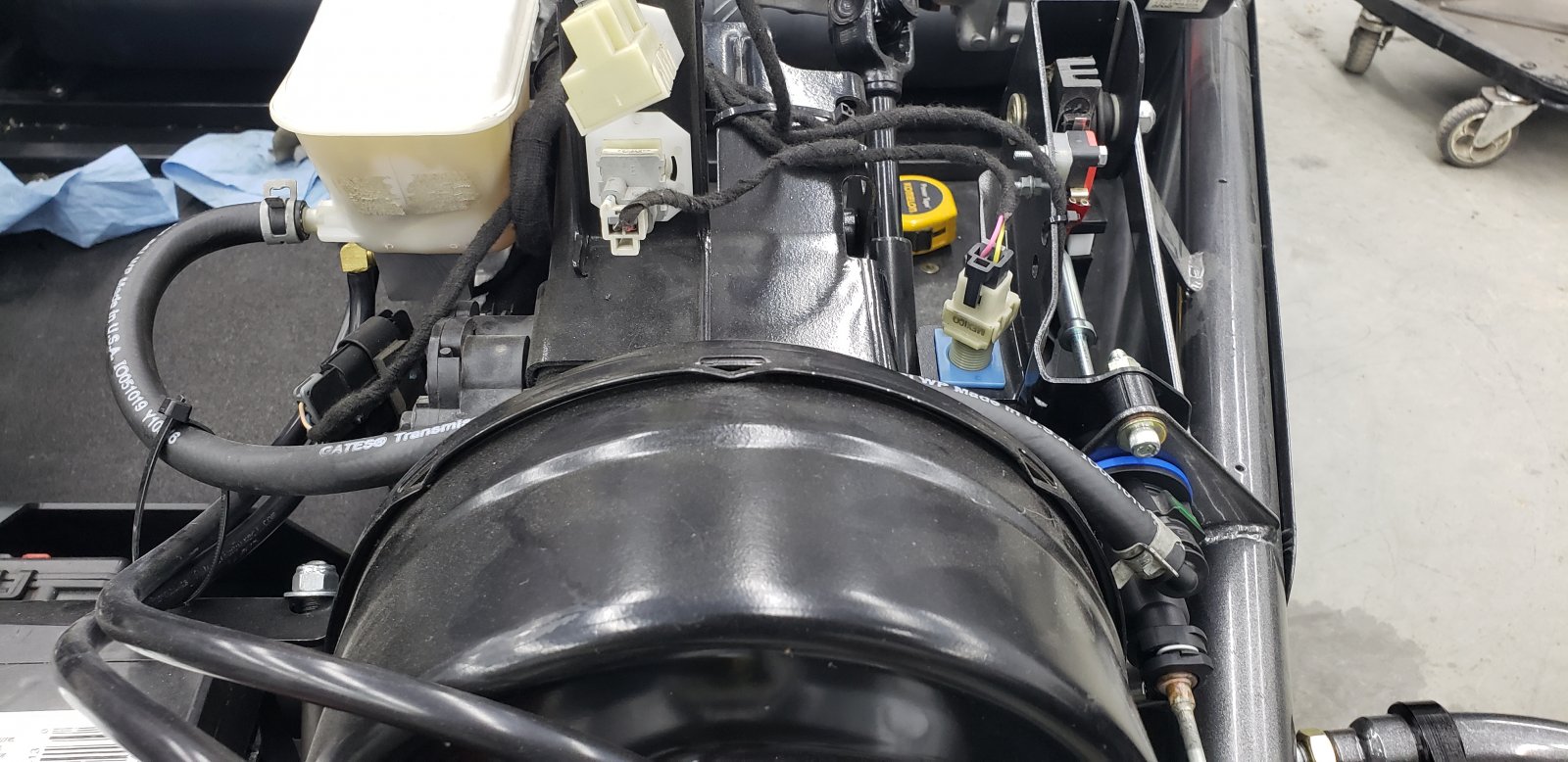

It is not leaking fluid anywhere that I can tell. It sat for a whole week and not a drop. After hours and quarts of manual bleeding I put it back together and tested it,,,, Barely and movement of the pedal for full engaged. So I tried GMs recommended vac from the reservoir and as soon as the vac got to 20 in mercury the bubbles come and you could pump the pump until the cows come home and the bubbles are not going to stop coming. You can pump the dickens out of the pedal to get pressure back but it is not enough to even be able to get it in gear.
And I dont know how to upload video's.... And I do not have a you tube account. But the plunger on the master travels a little over an inch,,,, The same as the other new one that is out of the car.

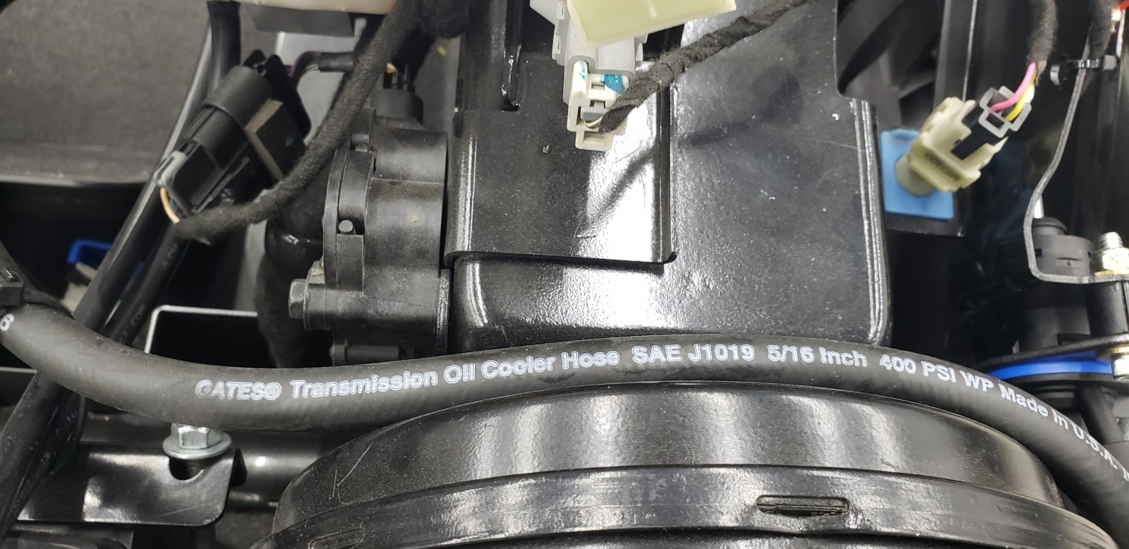

Not sure if this is proper tubing,, After looking at it closer it is trans cooler not trans.

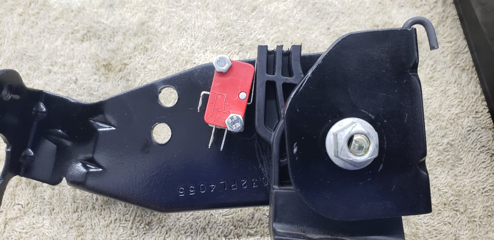

I was looking for pictures of your brake and clutch line set up at the front of the car, and ran across this picture. Are you sure your clutch pedal is fully extending to the released position? Chad had issues with his brake pedal not fully releasing and causing bleeding issues on his brakes.
When vac pumping from the res the brakes are involved in a way..
And I had to weld a washer as a shim in front of the pedal housing to keep the pedal from over extending. It currently is slightly over what stock was.
