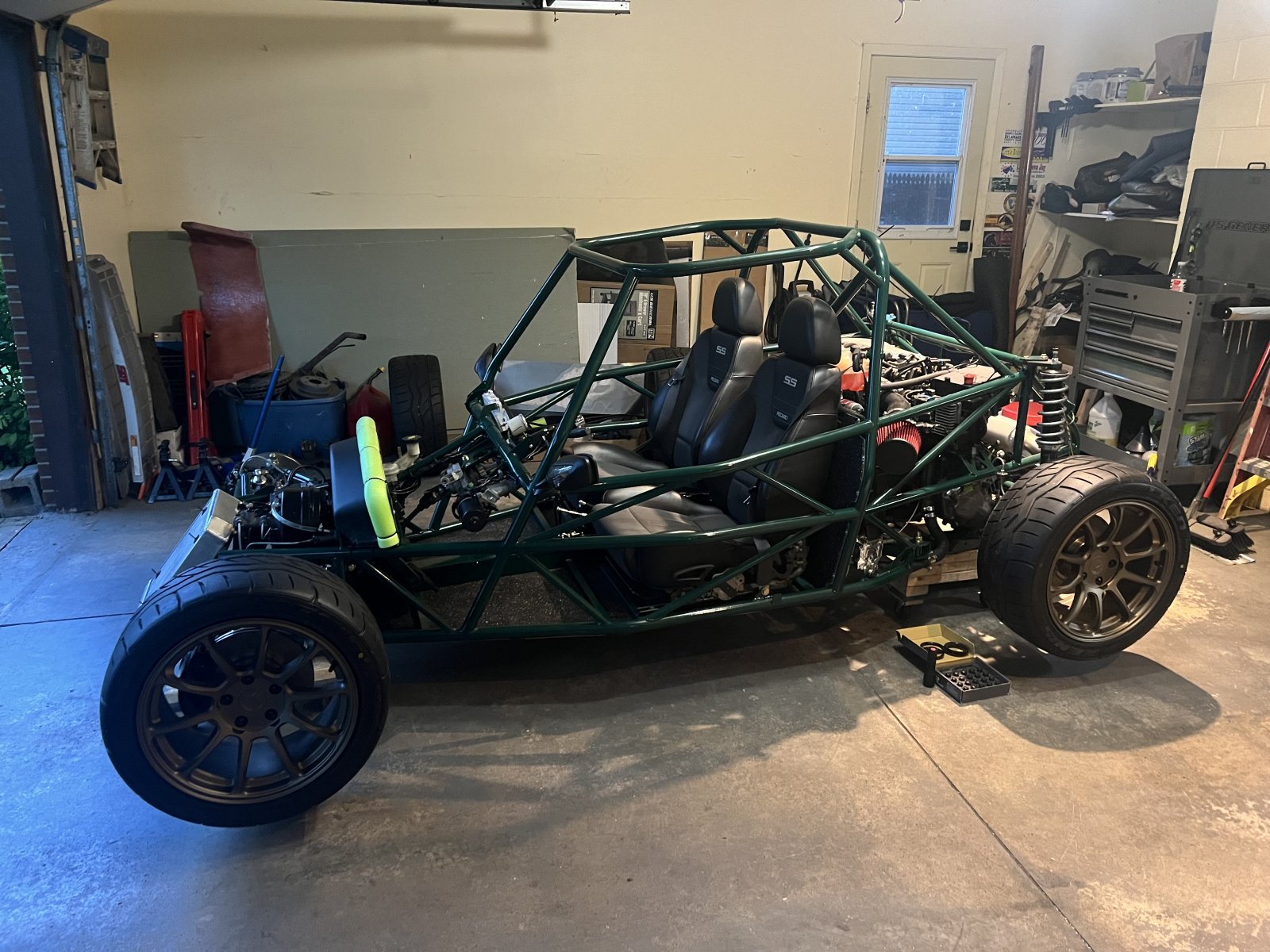

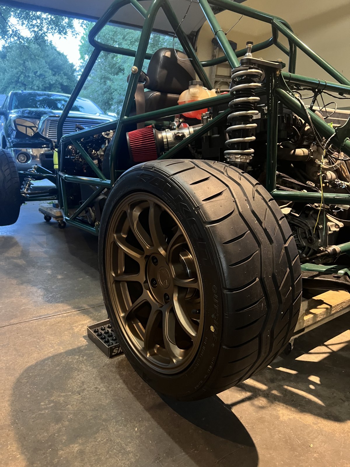

Picked up my wheels today. A quick (7 hour) trip to Michigan got me a set of Bronze Aodhan AH06 wrapped in brand new Azenis 615k+. This is just a mock up but woooooah momma I’m happy with them.

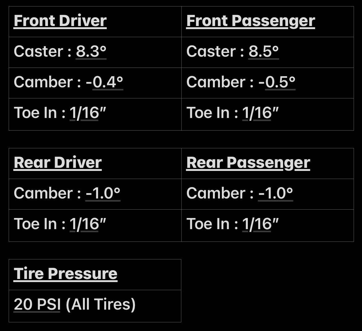

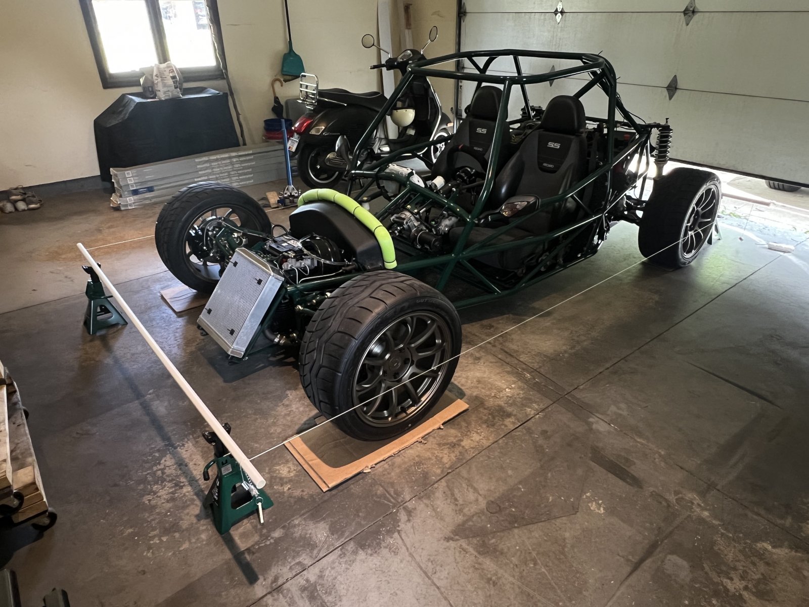

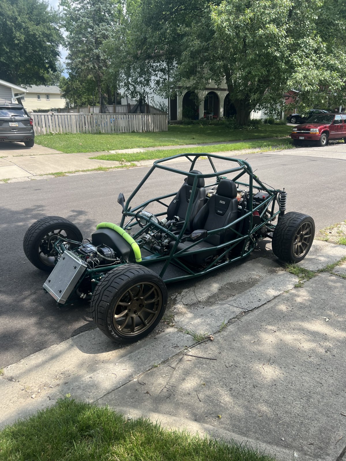

Well, first drive was a success! I had no one to take a video, unfortunately, but here’s a pic at the end of my driveway haha. I will be keeping a close eye for leaks and get started on the alignment this week.
This morning I did get all wheels at least even in the front and back to the frame rail. Rear camber is incredibly close to 1.5° but not much was checked up front.

Did you have any weight in the car when you aligned it? I only ask because adding 10% of the weight of the car with a driver can change things. Looking good!
Traé
Uh oh. No, I did not have any weight in the car when doing the alignment. I didn’t see a mention of it in the DF alignment threads, unless I missed it. Are the changes made with weight enough to be concerned? Handling / excessive tire wear issues?
If so, I will have to redo this and figure out how to add my body weight to the seat.
