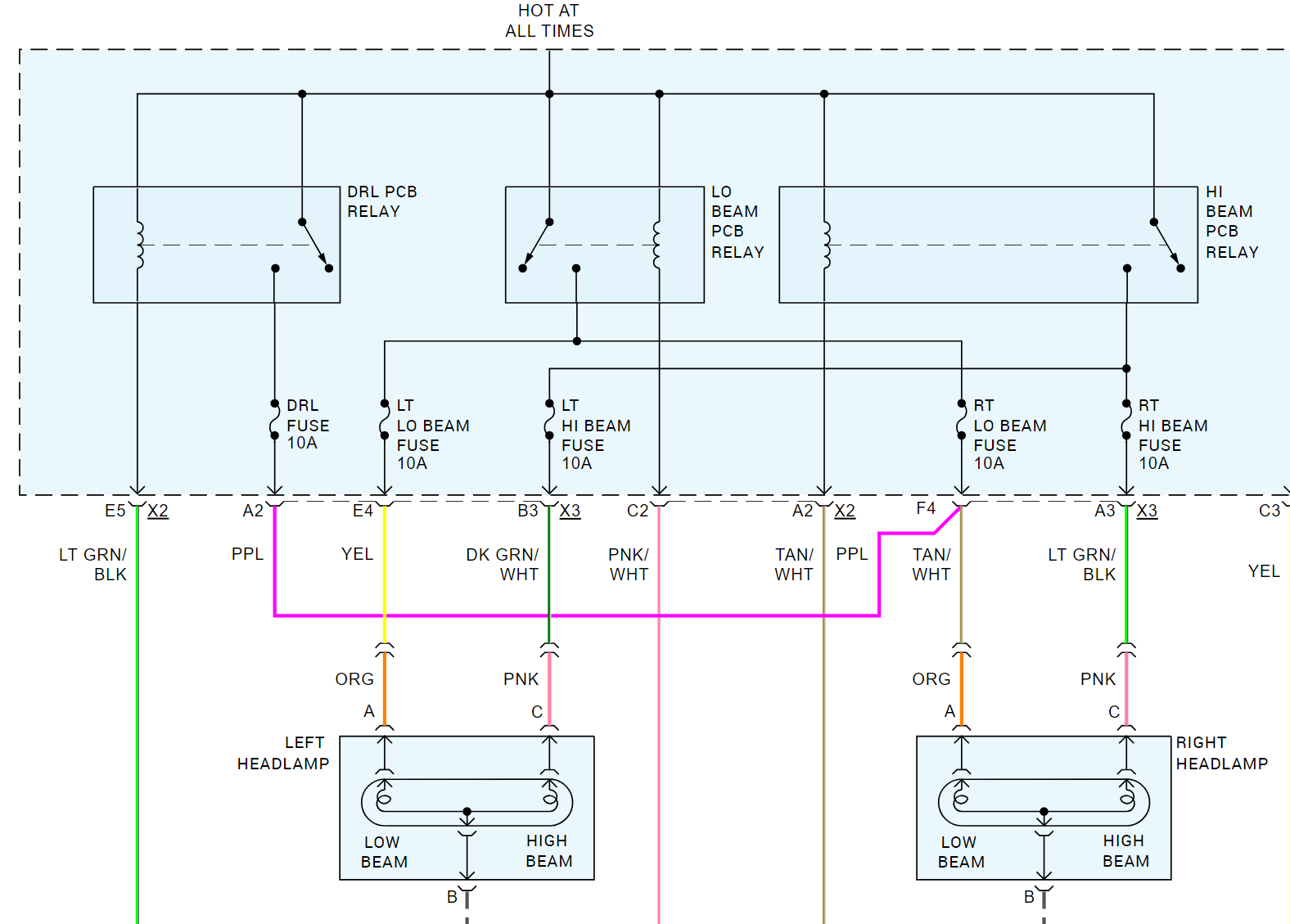

I’m looking at a few different headlights, 5-3/4”, one has DRL lights and the others don’t.
Are the DRLs as easy as running key on power to that leg? or does it get more complicated than that??
You shouldn't use just key-on 12v, you should use the actual DRL circuit. I think I ran an additional pair of wires from the BCM to get my DRL's working. I mean I guess you could use key-on 12v, but then you couldn't turn them off at the headlight switch.
From what I remember and info I can find, I have 4 wires color coded per DFs videos;
White - High Beam
Yellow - Low Beam
Brown - Parking Lights
Black - Ground
I remember saving the looped bundle of DRL wires, they were either purple or dark blue. The wire harness video mentions cutting them out if they are burnt, or discolored, something of that nature. I will have to rewatch the videos and see if they hook into that somewhere.
Edit: Now that I watch the videos again I may have cut the DRL wires out of the headlight harness :confused:
Where did you tie into the BCM to run DRLs? The headlight harness comes from the fuse box it looks like.
I wish I could give you more details, but I just don't remember at this point ... but I think brown is what you want for DRL's.
For the 2008 SS it is the purple wire A2 to F4 to apply power to low beams. Not certain about the wire color for earlier models.

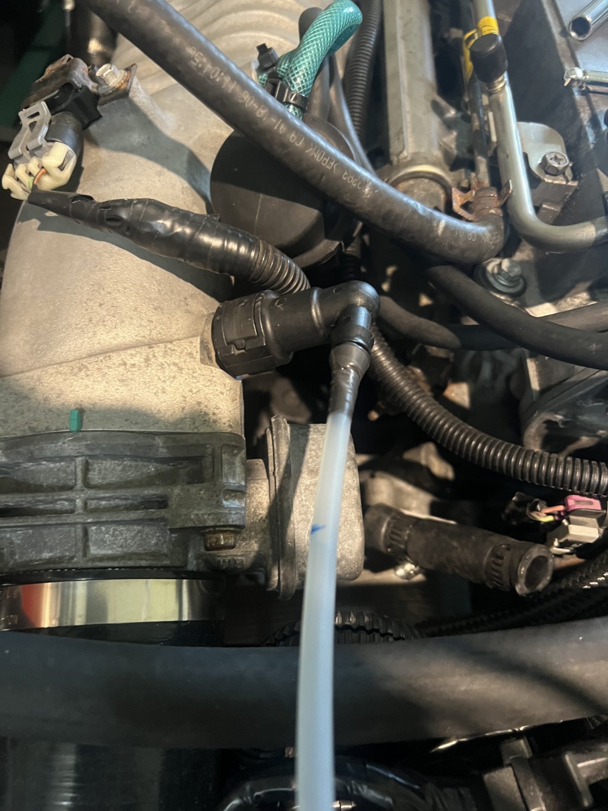

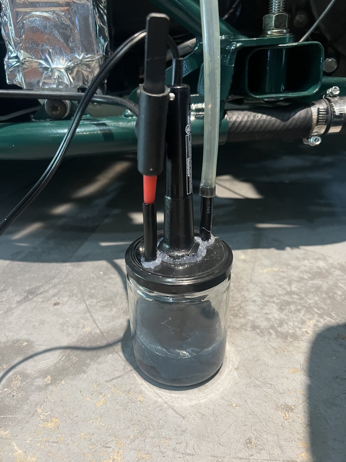

With the erratic idle continuing, I made a smoke machine today to test the intake for a vacuum leak. It “worked” but the smoke was a little thin.
48354
I hooked it up to a bicycle pump and tested through the port where the vacuum line to the brake booster hooks up. I was mainly concerned with the fuel injector cups as I removed them while cleaning the engine and they were definitely original. I have replaced pretty much every gasket on the engine and intake besides the head gasket.
48355
I then tested the vacuum line going to the brake booster.
I did not see any leaks at all other than a bit from where the tape didn’t seal 100% around the hose feeding smoke and the end of the intake.

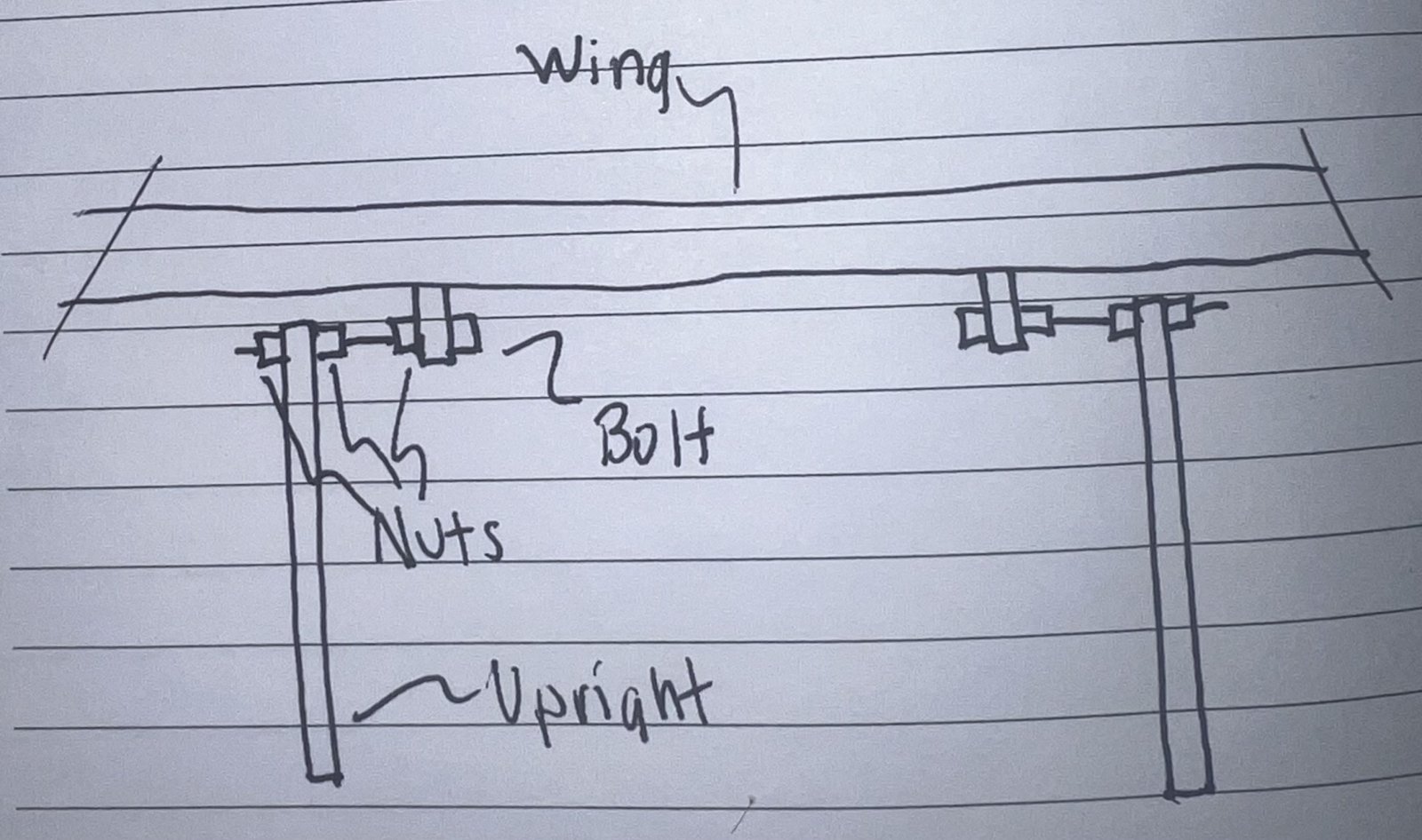

Question for the masses;
I found an amazing deal on a carbon fiber spoiler down the street from me but the mounting holes are only 22” apart. The uprights from DF are about 26.5” apart and with the 90° bracket make it about 24”-25”.
Has anyone drilled into carbon fiber to mount a wing? I’m not sure how thick it is but my thought was utilizing rivnuts if I can get them to grab (worried about the strength of that) or getting a longer bolt and using spacers to make up the difference.
I would not count on riv-nuts to hold it. Imagine the damage something like that could cause if it came loose at speed. Maybe if the endplates will come off you could sandwich it with plates and bolts strong enough to hold. Otherwise, you need to figure out how to adapt to using the provided mounts.
Traé
Thank you for confirming my questionable approach.
My next thought was to use a long bolt and 3 nuts to sandwich the wing mount and the upright. Do you think this would be strong enough? I’m having a tough time finding something with the correct spacing other than getting a WingLogic or something similar and welding the mounts on myself at the correct spacing. This is probably the smartest thing but just had the opportunity arise and figured I’d entertain it.
48365
Don't make it look cheesy. Use spacers. Or a piece of capped off rectangular tubing. Or a piece of channel. Or bend the Uprights to squeeze them in. It looks like you need about 1.5" per side.
