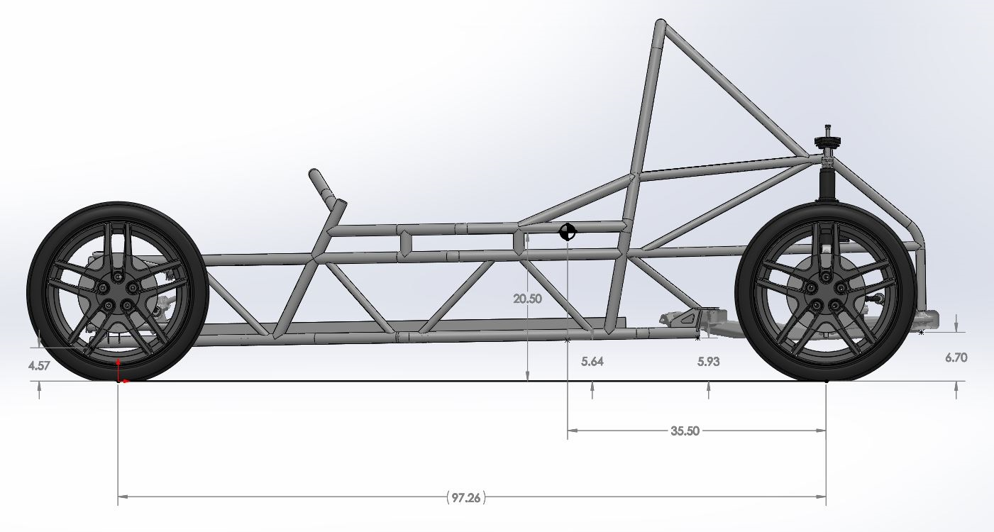

This is probably what you're going to want for ride heights(4.5"-5" in the front and 6.5"-7" in the rear):
48278
