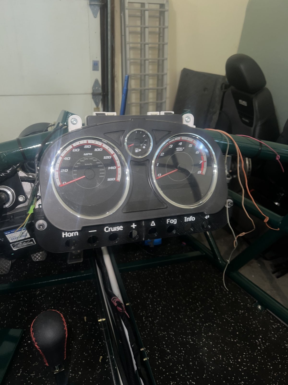

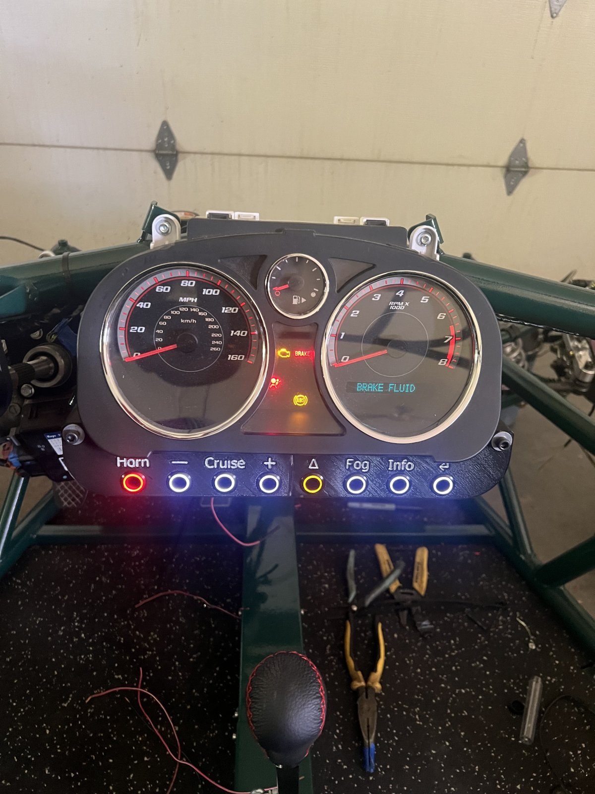

Can you show a picture of your button panelI have gotten some shiz done the past few days;

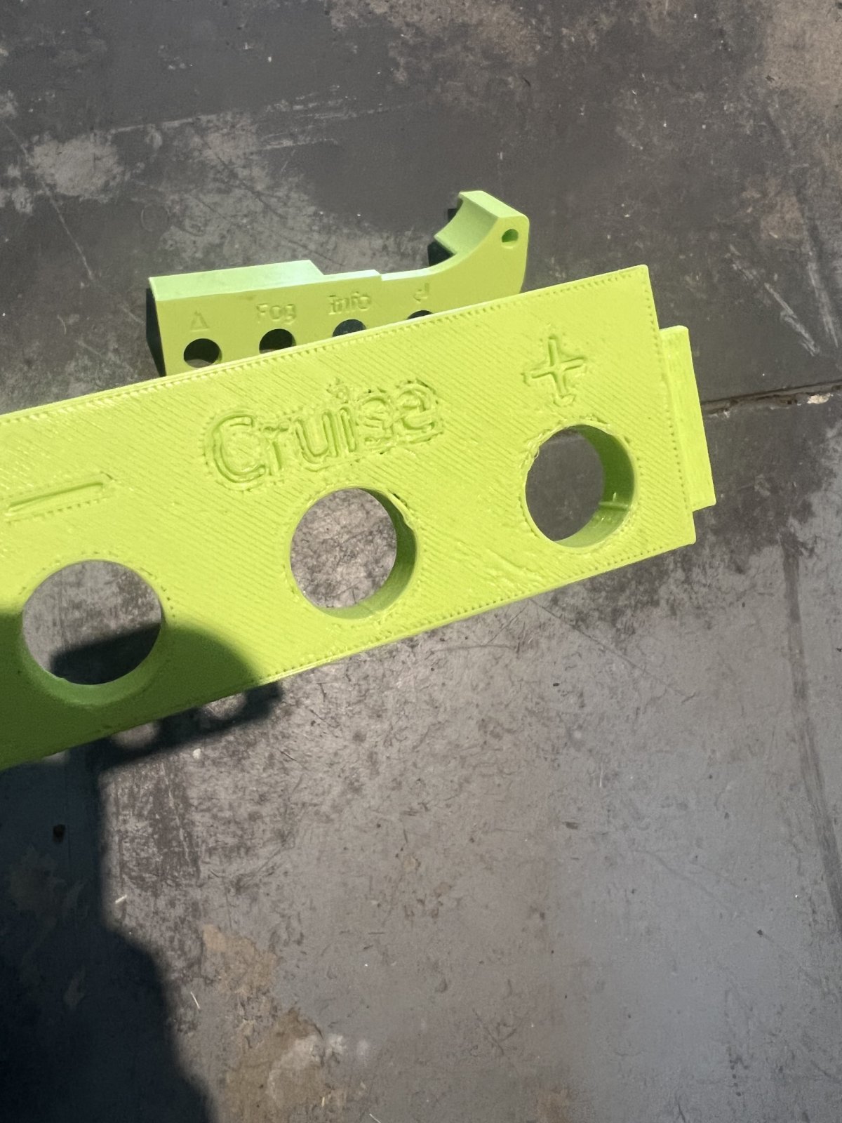

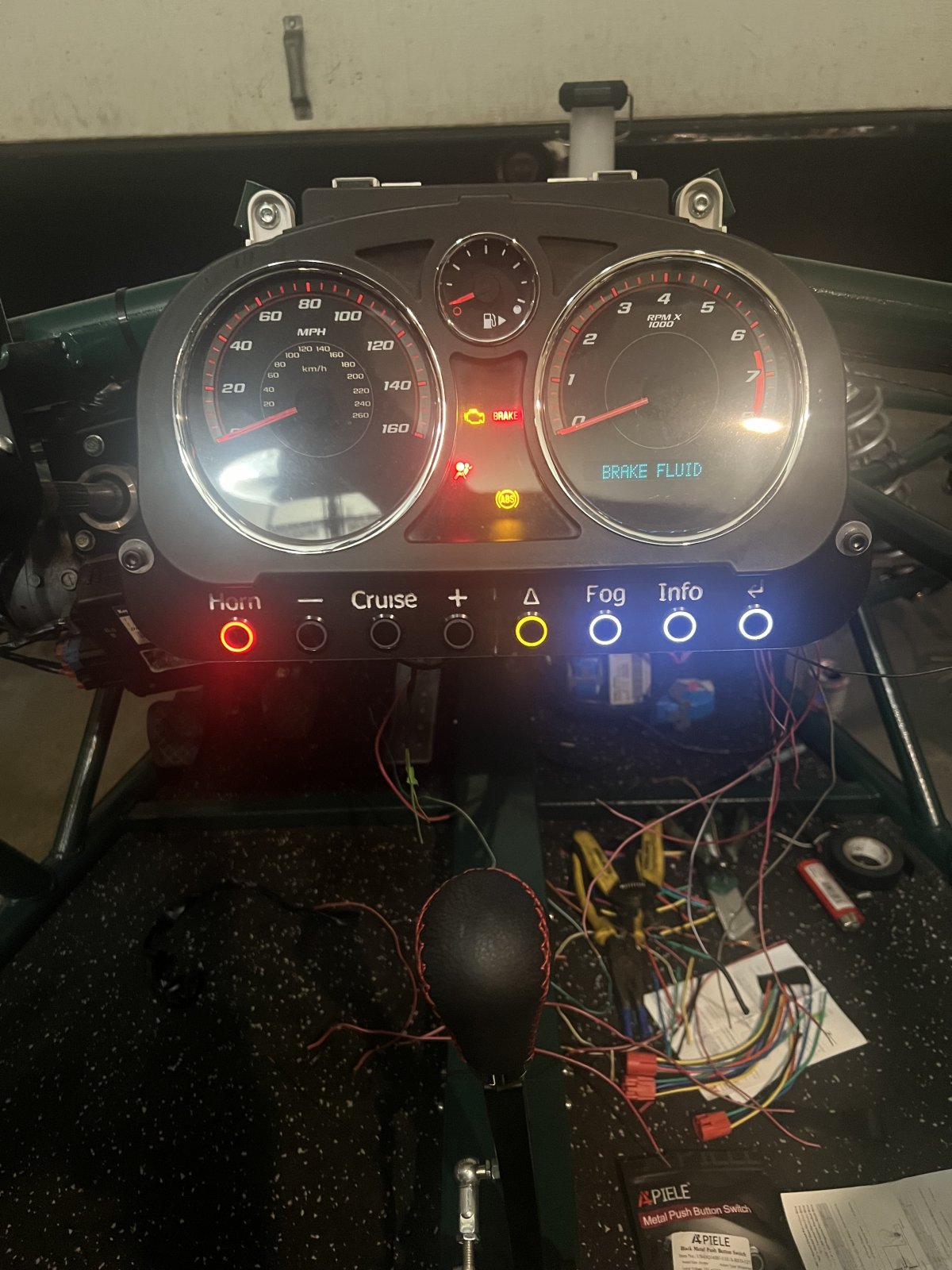

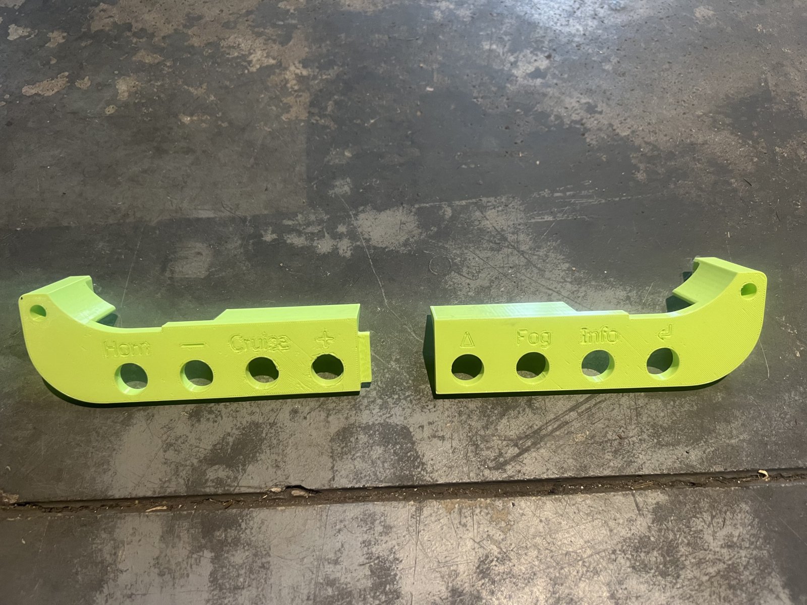

- 3d printed button panel was installed
- Buttons arrive saturday
- resistors will need to be sourced for cruise control

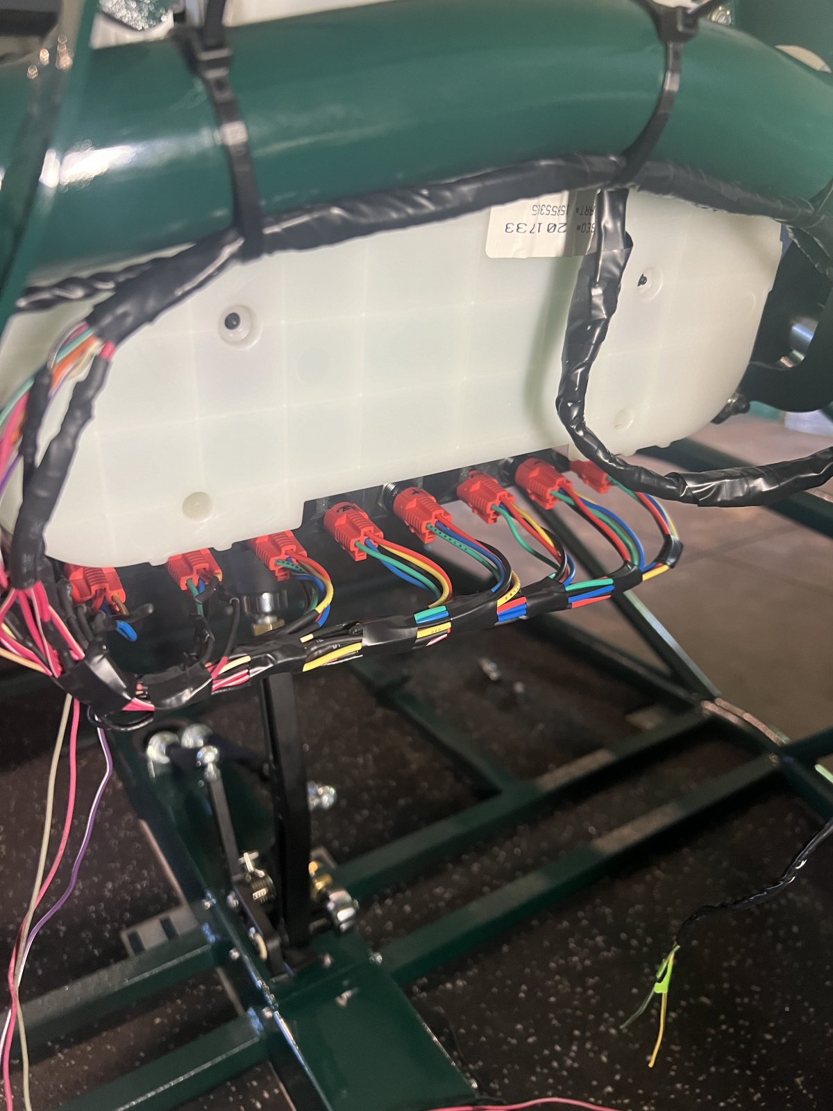

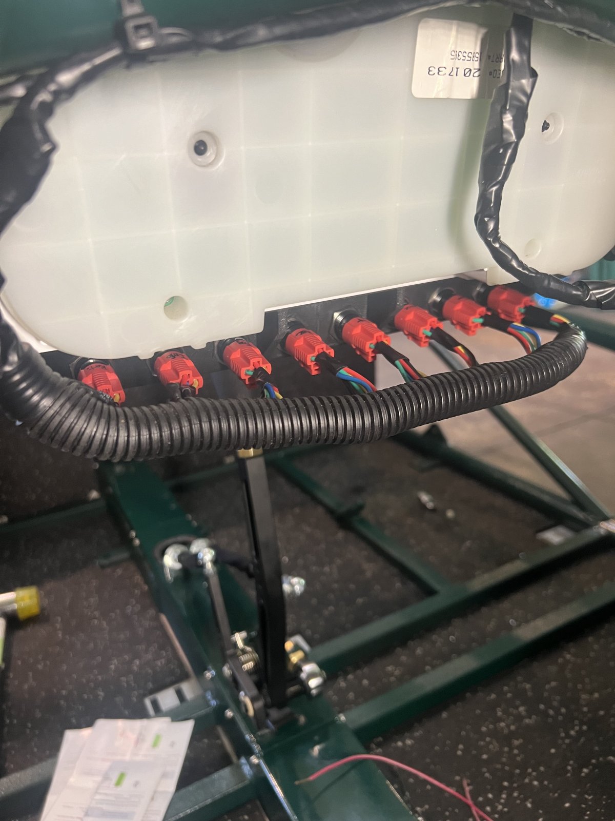

"Be cautious of what you do well, you will likely be forced to do it all the time"You're hired! Your electrical wiring and routing looks top notch!

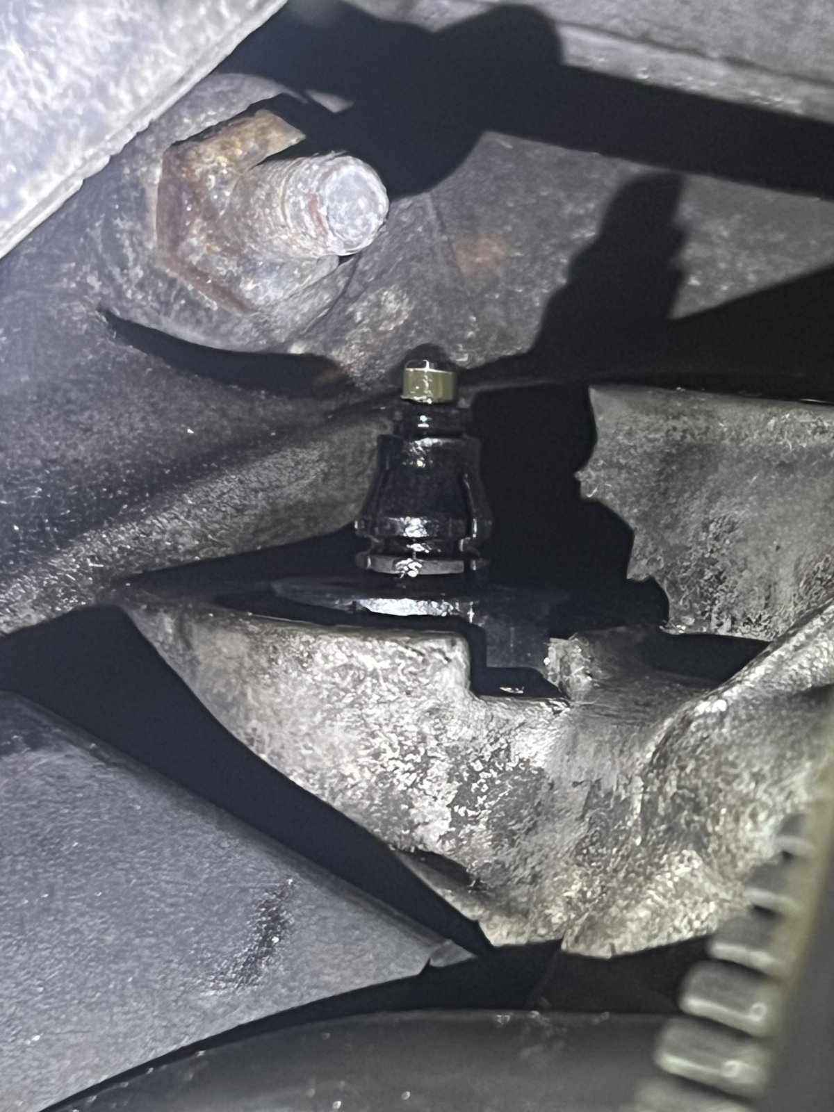

Ahh that link helped tremendously. I don’t have the seal for the top of the nipple sticking out of the transmission.Looks like the o-ring is in the top groove - good. Is there anything inside the elbow, like another o-ring? Is the spring clip installed correctly into the elbow slot before trying to press the elbow onto the nipple? A couple photos of the elbow may help.
