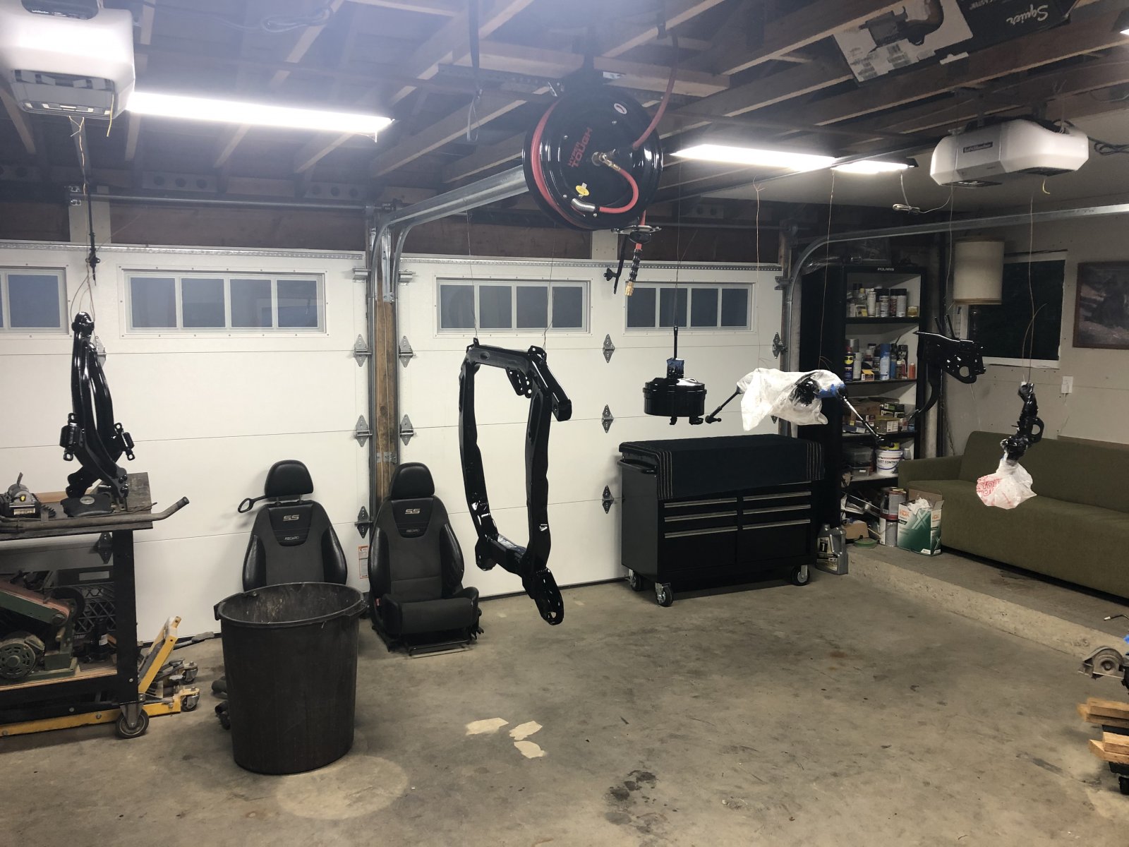

V1 Whidbey Goblin, track chassis for the streets. 05 SS donor.
Whidbey Goblin
Prepping parts. Chassis is supposed to ship on the 14th!

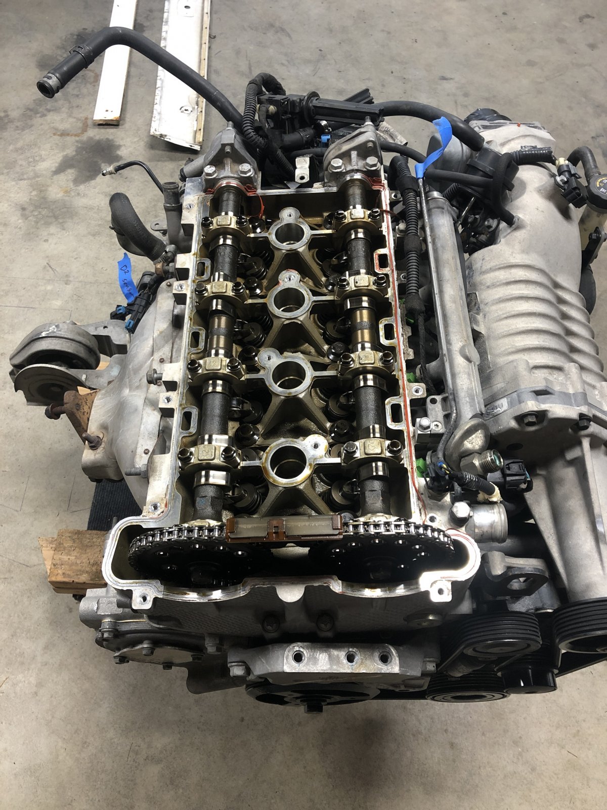

Doing my timing chain tensioner. Clearly someone has been into this motor before. They used RTV on the valve cover gasket, I was under the impression these type of valve cover gaskets didn’t need RTV. Does anyone have any input on whether I should use RTV when I put it back together?

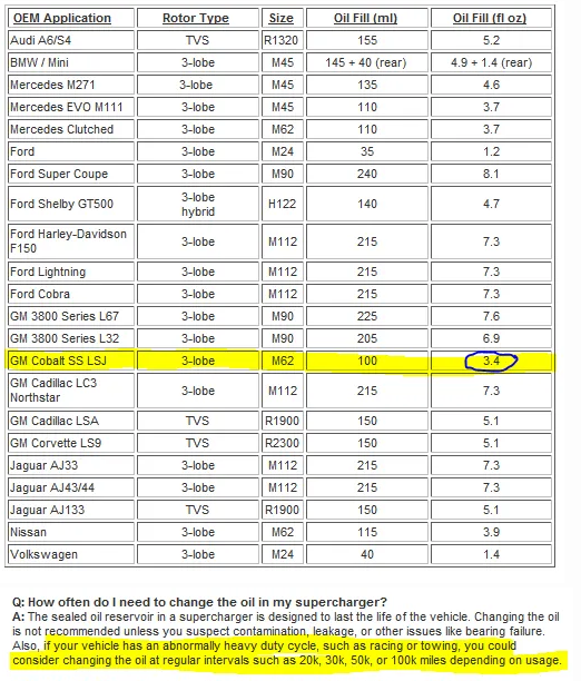

Has anyone change the oil in the supercharger? I took a small hose to try to pull out the old oil but I can’t seem to grab anything. I’m actually concerned my supercharger barely has any oil in it. Is that Phil
Start in the middle front and back and work your way to the left/right end
20 ft-lbs
turns out 20 foot pounds breaks them off.
I have changed the SC oil. I drained everything I could and filled it with the specified amount. Sorry I don't remember what the amount is and the moment. I also used the GM oil just to be on the safe side.

Use a spray bottle tube and trigger. Stick the tube into the supercharger and spritz the fluid into a can or bottle, there won't be very much fluid. @ ounces?
20 ft/lbs?!? I'm pretty sure it's much closer to 20in/lbs!
Edit: according to alldata it's 89in/lbs

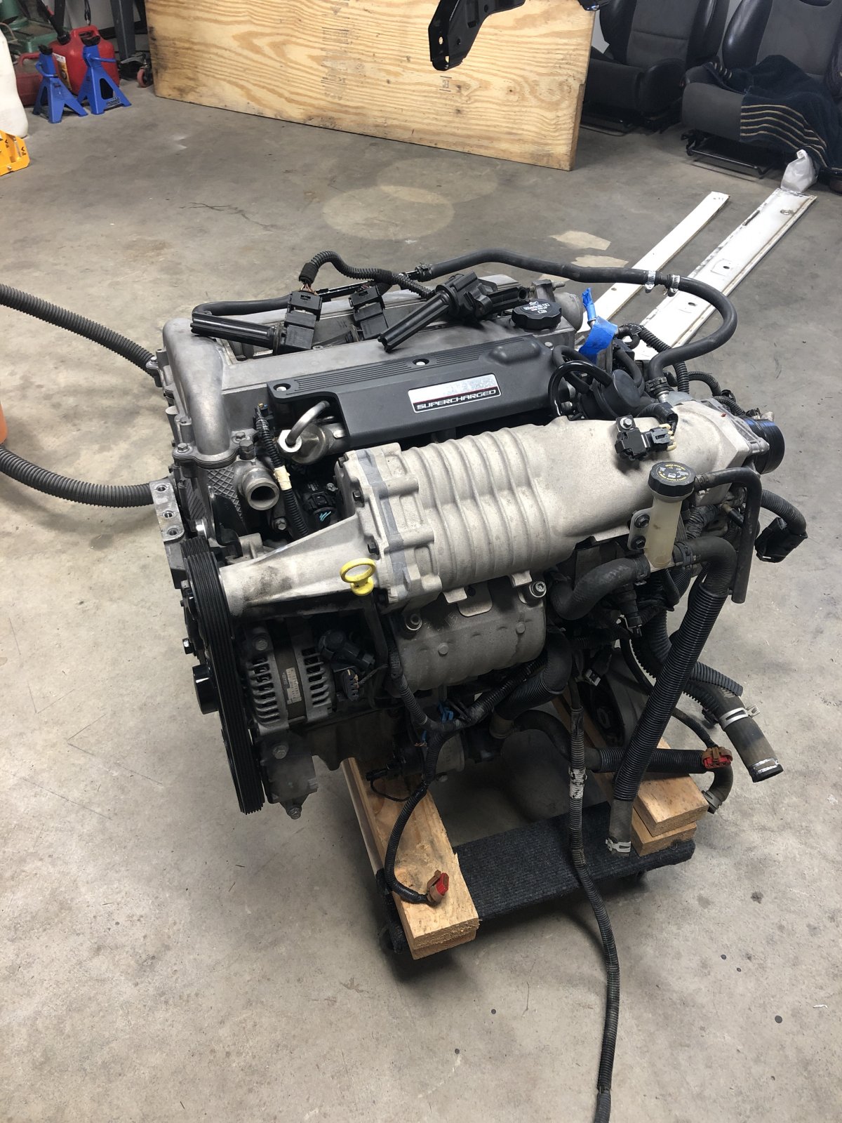

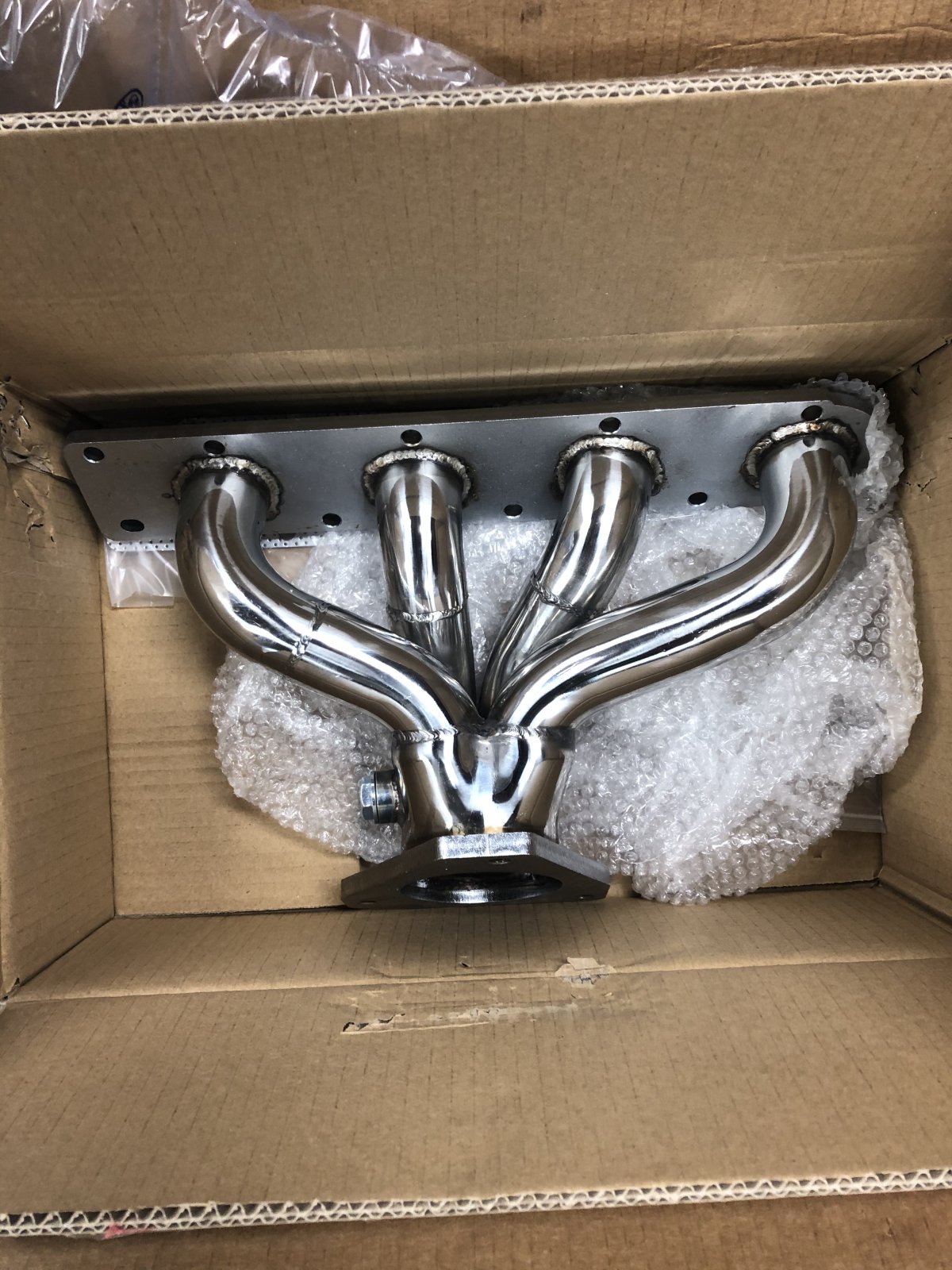

More progress. Painted some more bits. Got the timing chain tensioner and guide bolt installed. Ordered my header. Ordered stage two from ZZP. Picked up new axels. Shipped wiring to DF. Shipped TCM to ZZP. Chassis is supposed to arrive late next week, it will go immediately to powder coat.

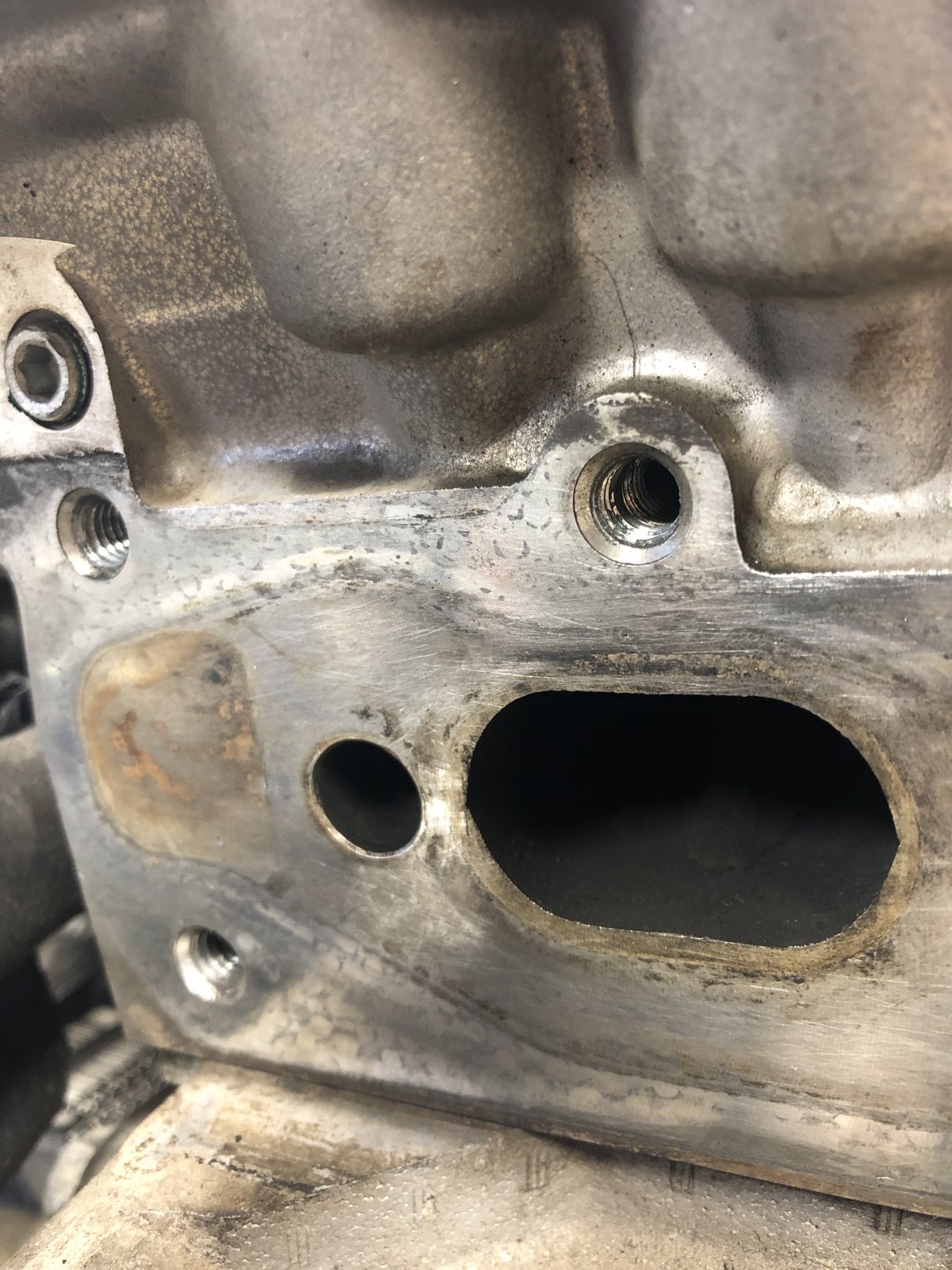

Prepping my motor to install the header. What is the small hole next to the exhaust port? It appears with my new header and gasket the small holes will be blocked. Is that bad?
