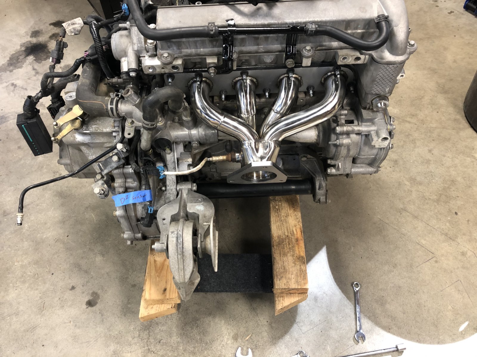

Overall I’m really happy with the Amazon header. Looks great, heavier duty than I expected and seemed to lineup pretty well.

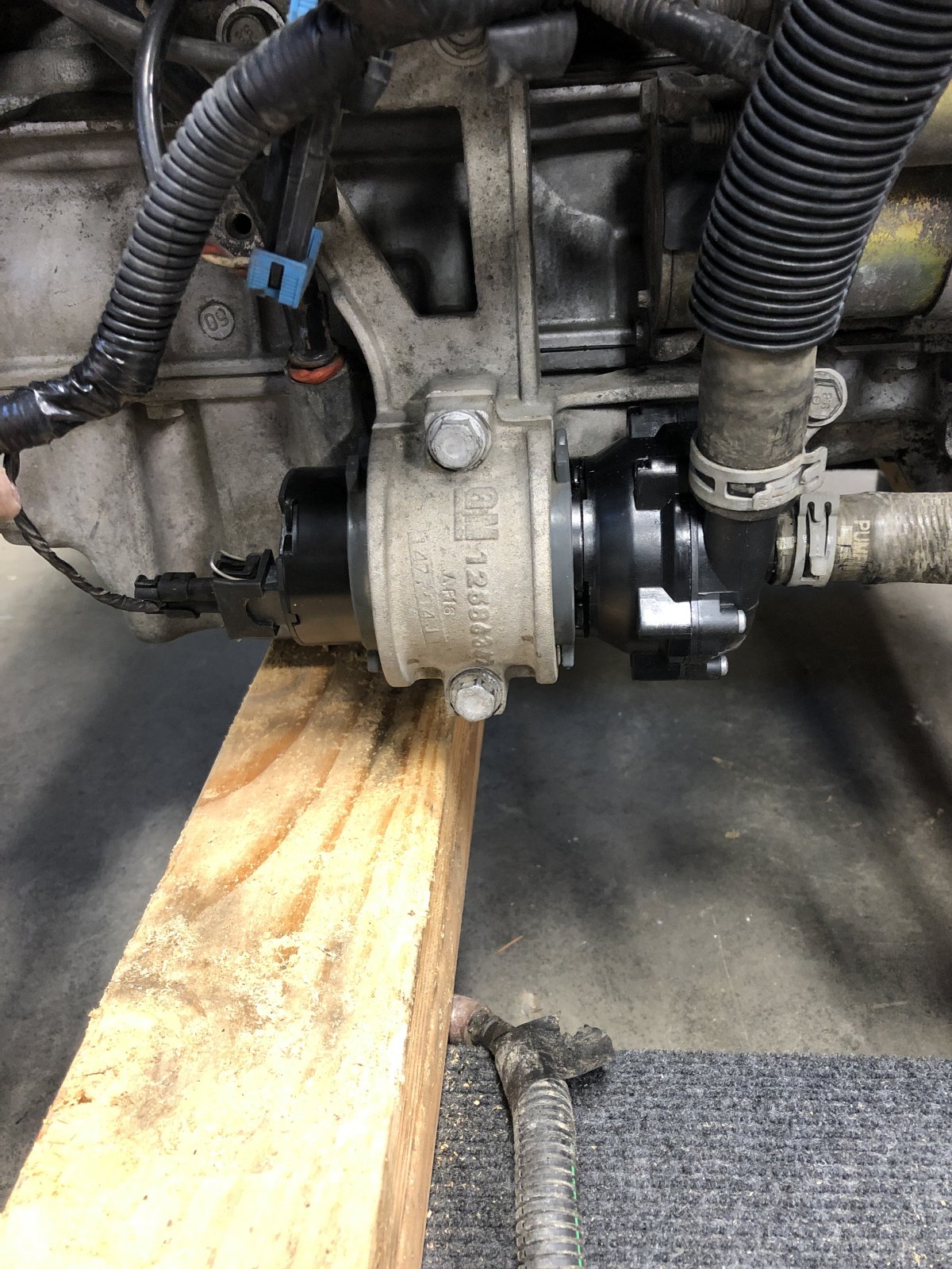

Just replaced the water pump for my supercharger. If I want to check that the polarity was wired correctly on the motor, without power going to it, can’t I just check continuity between the block and what should be the negative terminal on the plug?
If you can find the - and + on the Bosch pump, then check the cobalt wires, you are probably good. They are small, but they are cast into the housing.
Apparently some cobalt cars had the wiring backwards on the stock harness.
The water should enter the center of the pump impeller, and leave on the outside of the impeller.
