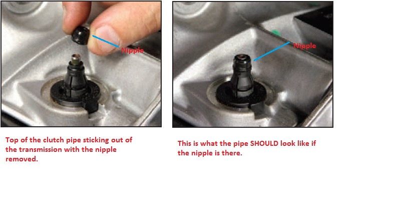

So my clutch issue has reappeared. Went for a drive on Sunday and I could tell that there was next to no clutch left. Get it back in the shop and sure enough a puddle on the floor the next morning. Worst of it is I cannot see where it is leaking,,, The clutch pipe to elbow seem to be fine, clutch pipe to slave shows no sign of fluid... Kinda lost at this point, guess I need to have my wife sit in it and cycle the pedal while I look with the camera......
Towerdog
When I had to problem of two o-rings in the elbow, it showed no signs of leaking other than the puddle in the floor.
You just gave me hope!
This is where it was clearly leaking last time.... And now that you say that I remember it being hard as heck to get the thing to go down and snap on.... If two were in there,,,,,,
Not so lucky, Only one in there.

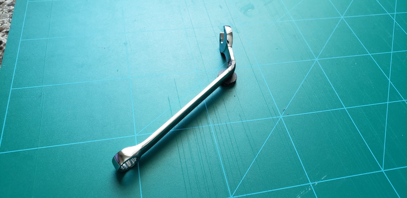

Im hoping and believing the clutch pipe seal was not installed on the pipe itself there for not sealing completely. I have installed a new elbow/distribution block and made sure the seal was seated properly..... Now I need to run to town and get a cheap 9mm wrench so I can bend it to be able to get it in there.... PITA!
Towerdog
The "Goblin clutch bleeder wrench" made that process so much easier.. Got them rebled and it seems to be holding pressure with no drips. We will let it sit overnight and see if there is any fluid on the floor.

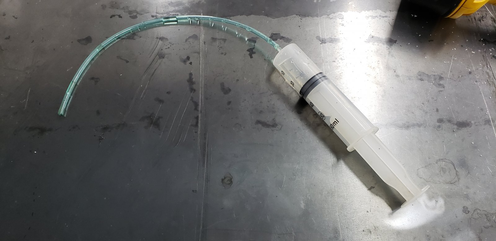

Found a way to add brake fluid w/o taking the hood off.
Sounds like you need to work on a hood hinge system. ;):D Believe @Torchandregdoc put together something workable using donor hinges(?).
