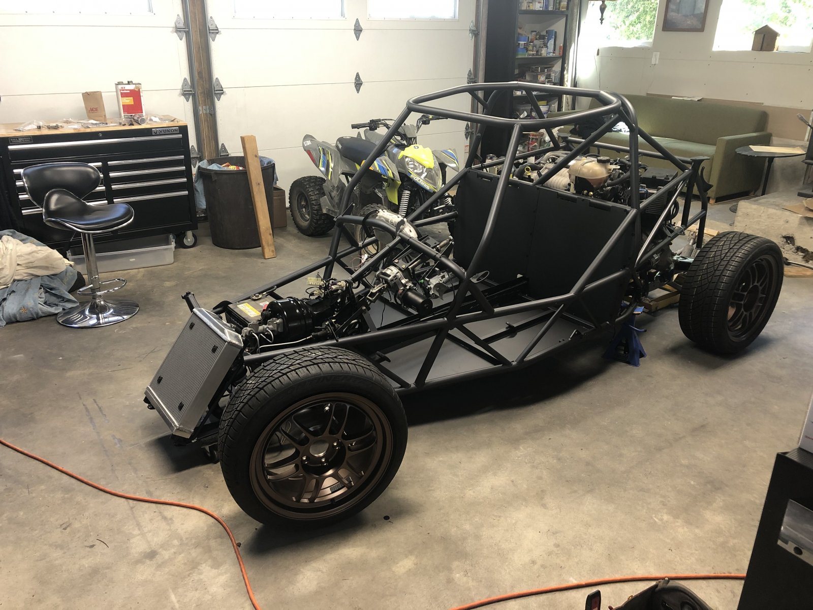

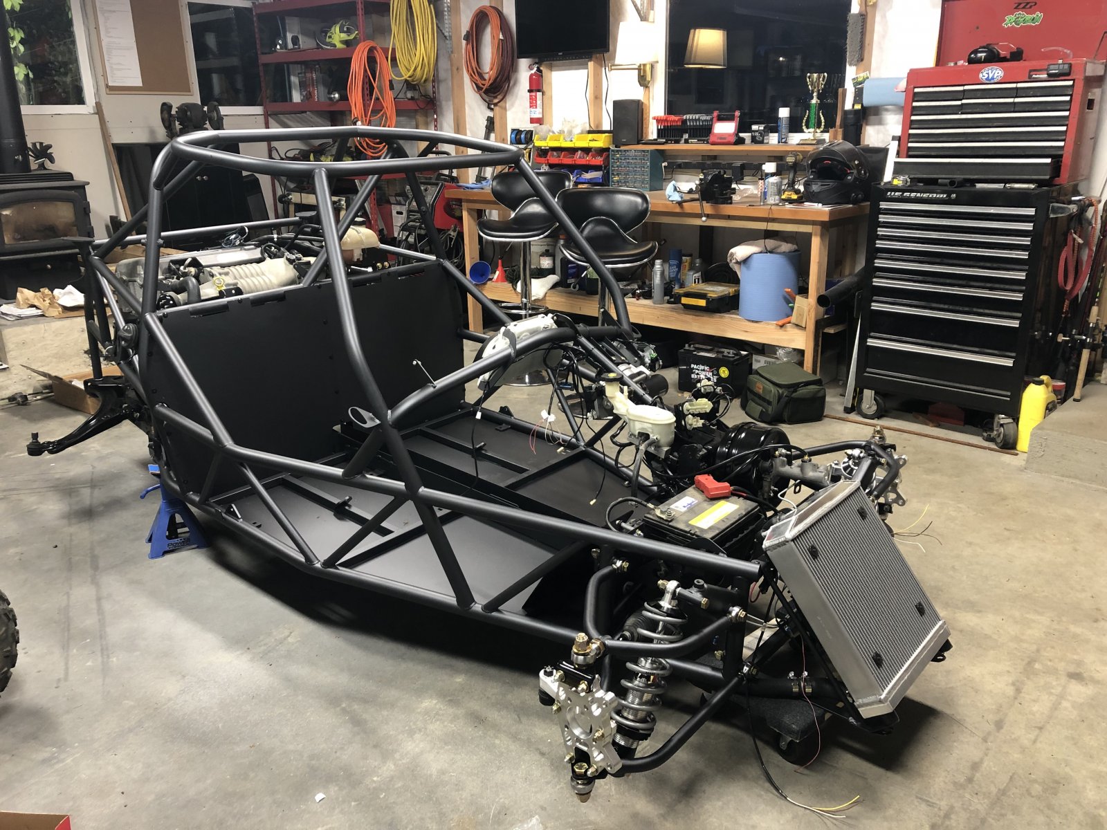

Finally pulled the wheels out to get a sneak preview while I wait for parts.

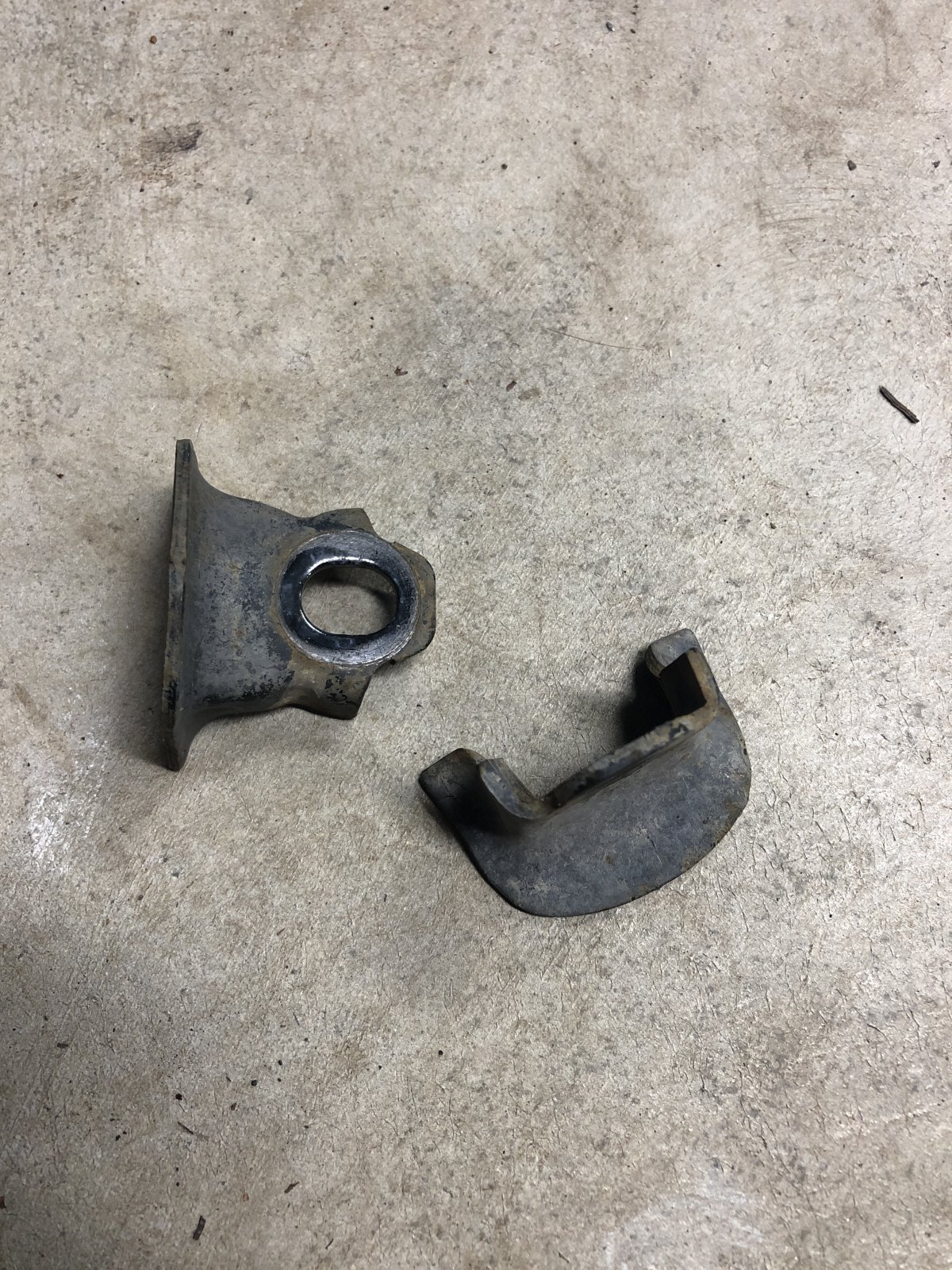

Whidbey Goblin
These are the little retaining clips for the rear control arms. (originally front control arms in the donor) Are they necessary? Did everybody use them or did most people pitch them?

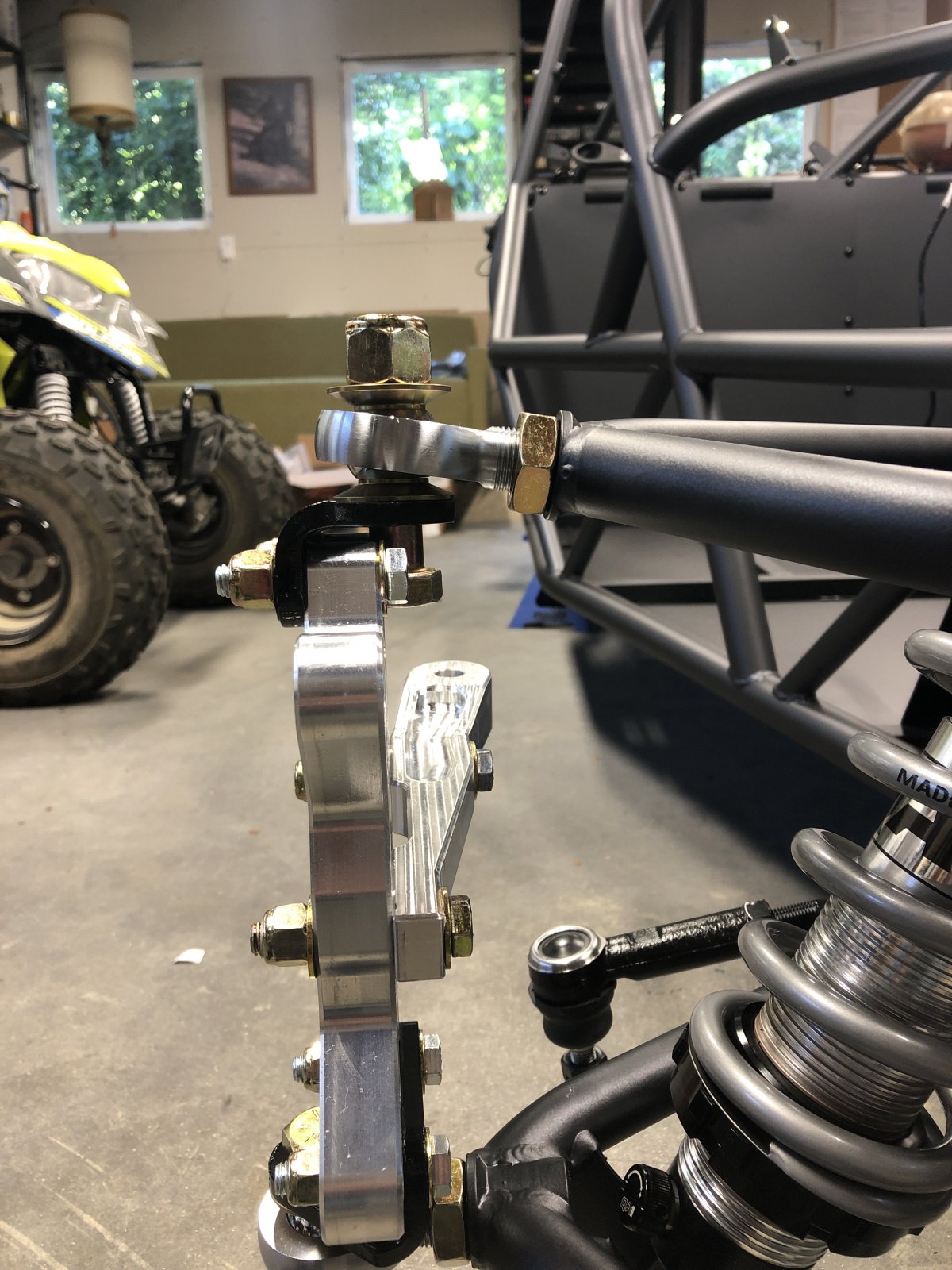

Whidbey Goblin

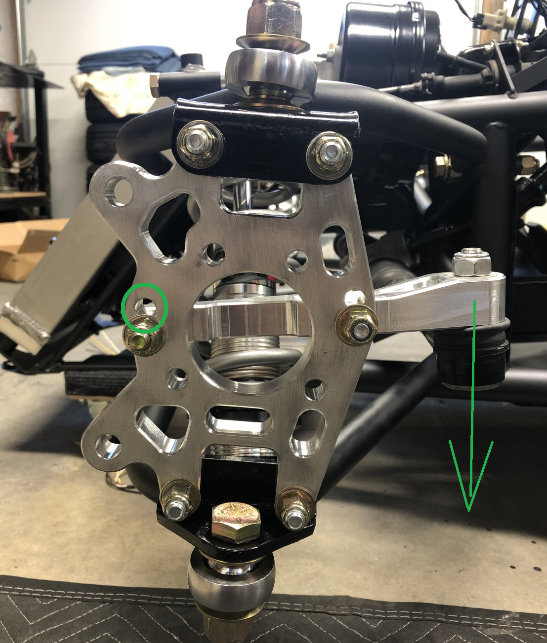

This just doesn’t seem right. It looks like with a little bit more travel it’s just going to bind at this heim joint. I’m pretty sure I assembled everything correctly, passenger side is worse than the driver side. Did I get a bad set of upper arms?
That looks good to me. Remove a shock/strut bolt, so you can move the suspension up and down by hand. Check the maximum height, check for binding, check it is smooth.

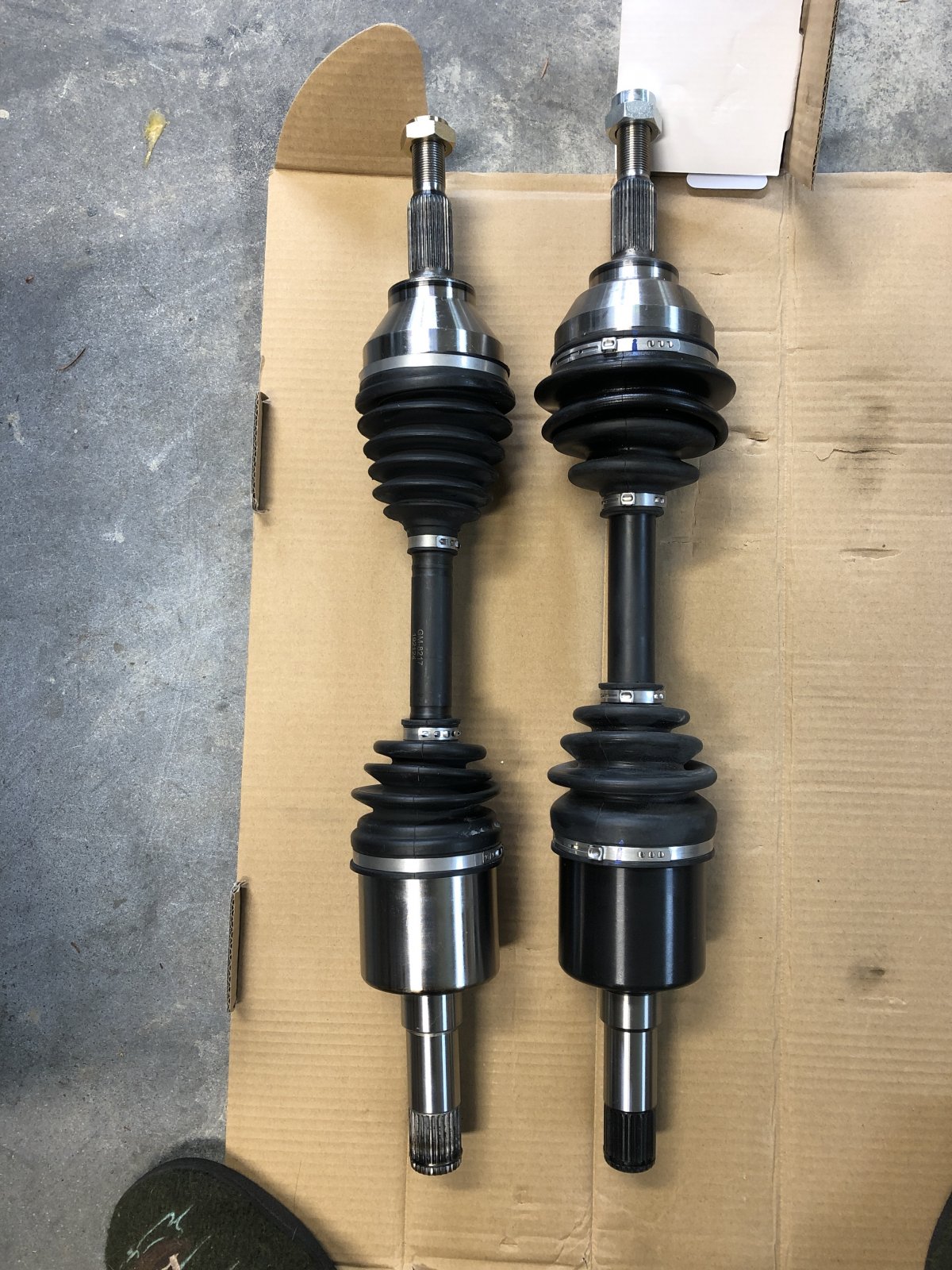

The thicker shaft diameter is a SS/TC shaft, the thinner one is most likely a SS/SC shaft. Since the Goblin is so light, the difference in shaft diameter will likely not create any torque difference issues (the thinner shaft will have more rotational flex).
Just me, but I would use the thinner one on the driver's side to (theoretically) be closer to the flex of the intermediate shaft and passenger side shaft.
