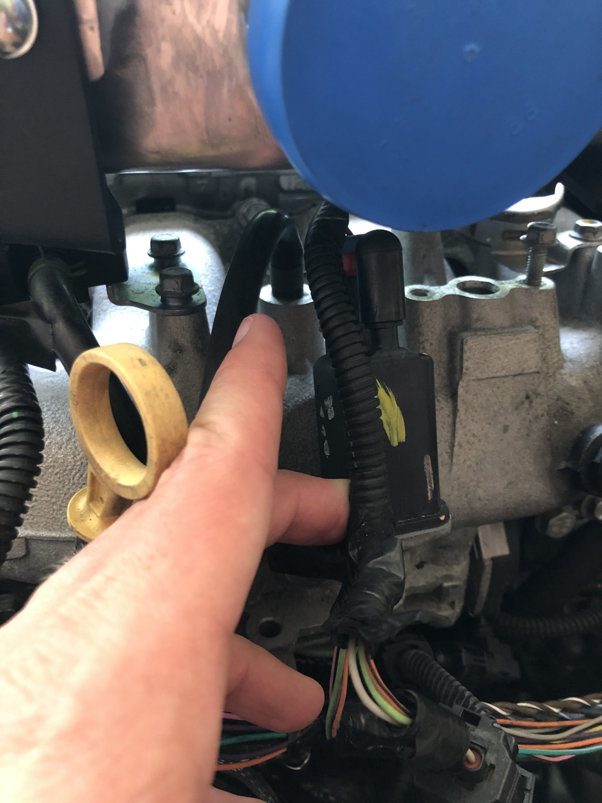

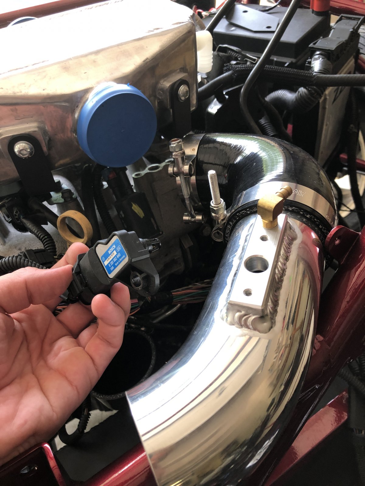

aaronbuley
Does this belong on the intake manifold or the turbo pipe between the IC and butterfly?
It looks like people are moving it and the pipe will hold it but what do I do about where it used to be and why are we moving it?

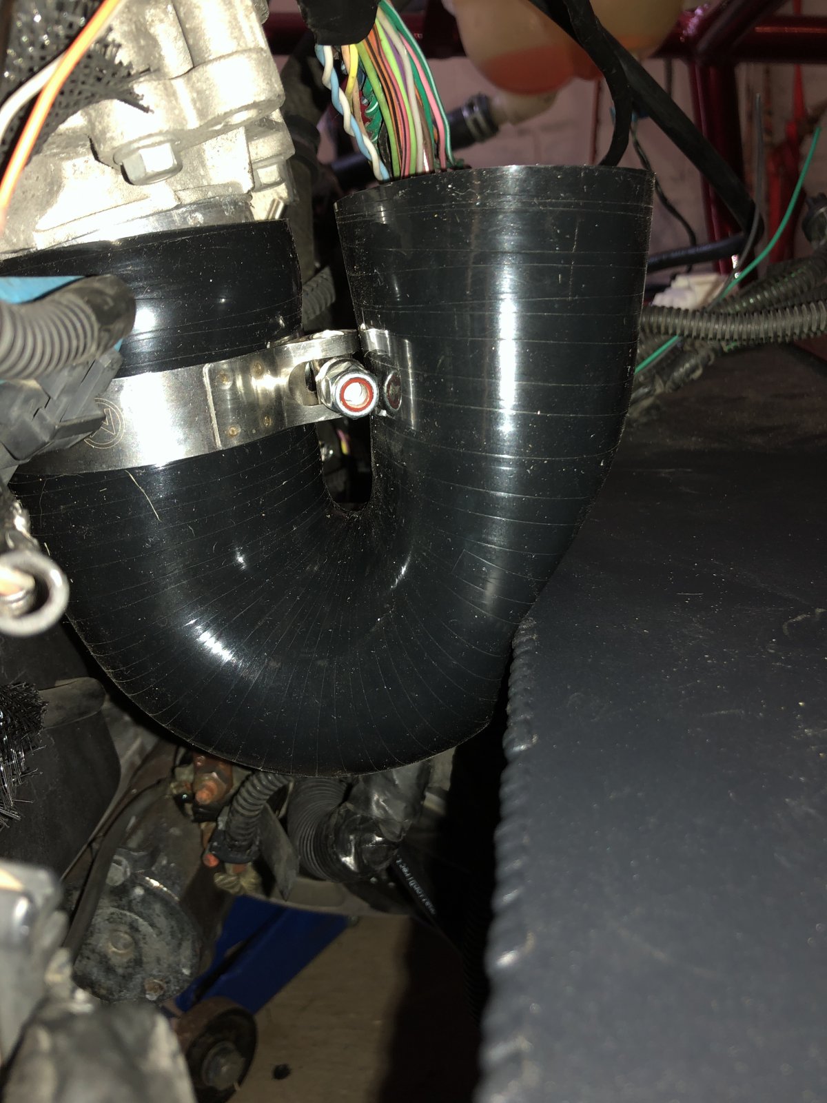

aaronbuley
Intake getting serious restriction from the fuel tank. Am I doing something wrong or is this normal?
On your donor intake tubing there should have been a MAP sensor and vacuum line near each other that will be switched over to our MAP tube.
aaronbuley
There is a rubber donut thing that slips over. I almost lost mine too.
Sorry for the non-technical term. I have no idea what it's actually called.
that's what i thought... sigh, ok. i'll work to find it or buy a new one. i'm starting to regret letting people 'help me' take it apart at times. Lol
