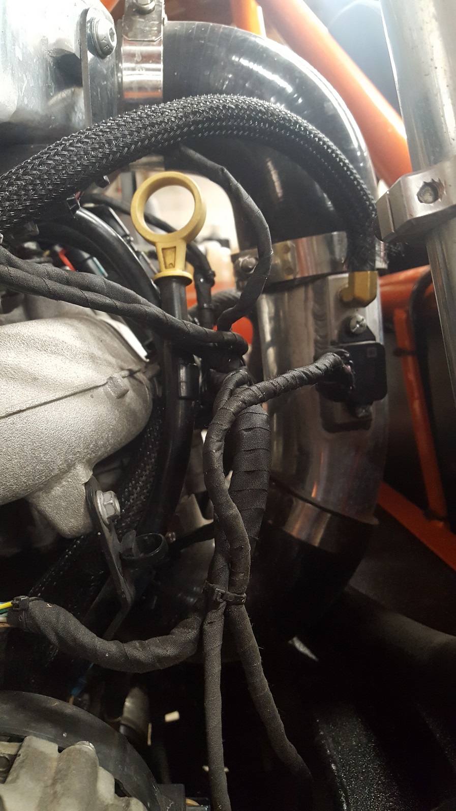

There is a 3-port solenoid right by the dipstick for the bypass valve. The port that is nearest the valve cover has a hose that runs to where you're talking about on the throttle body pipe. The other port runs to the vacuum canister in front of the engine, and the third one runs to the actual bypass valve.
*Edit* It's hard to tell with this picture, but it should get you in the ballpark on where the line is.
