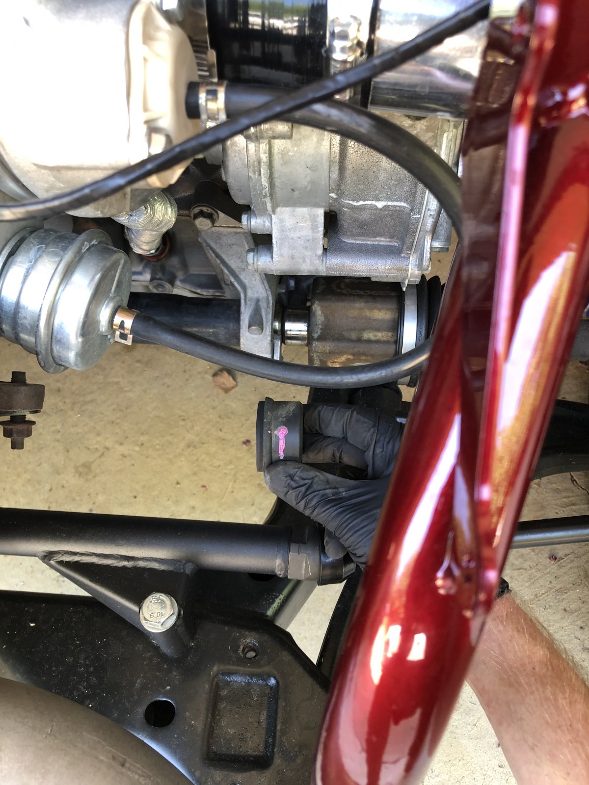

I'm pretty sure this is it.
That looks to be the seal in the transmission.
There should be a slight gap there, that is the bigger portion of the axle that doesn’t slip into the jackshaft. I also don’t believe there is a cover for it. I have never seen one.
aaronbuley
Hah! Found it. Now to take eeeevvveeerrryyyything off. Lol

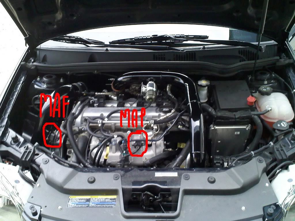

Turbo plumbing is complete except for the MAP and the hose that connects right next to it. I'm lost on that piece and (I'm imagining it's because of that) now that the charge pipes are all hooked up, the revs surge from 1k to 2k and drop continually. Does anyone with a Turbo mind showing some video or pictures of where the MAP and hose (connecting to the pipe between the IC and intake manifold) connect?
Lonny, I was thinking about trailering it down there this week so y'all could give it a look over if I have any glaring mistakes.
